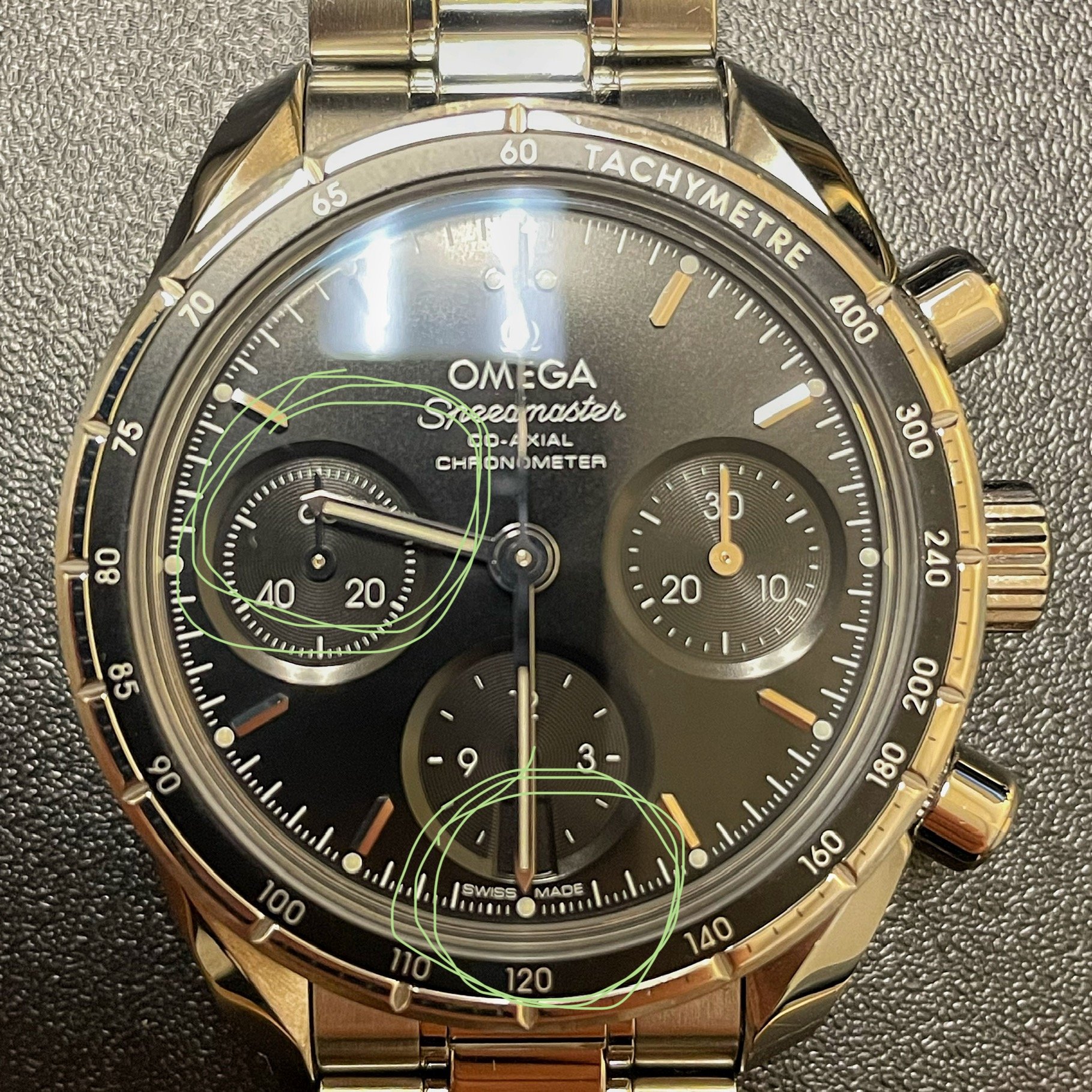

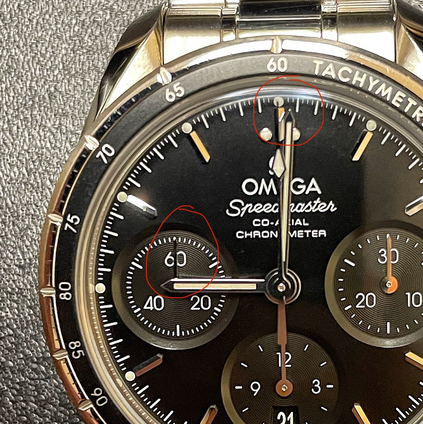

Here’s a snap of the watch today, taken at 09:00:58. Seconds are about +2 ahead of NIST. Minute hand catches up about 15 seconds later (looks more like 30 in the snap). I set both to NIST about 24 hours ago.
Did you set the watch as I have described in my first post above?
