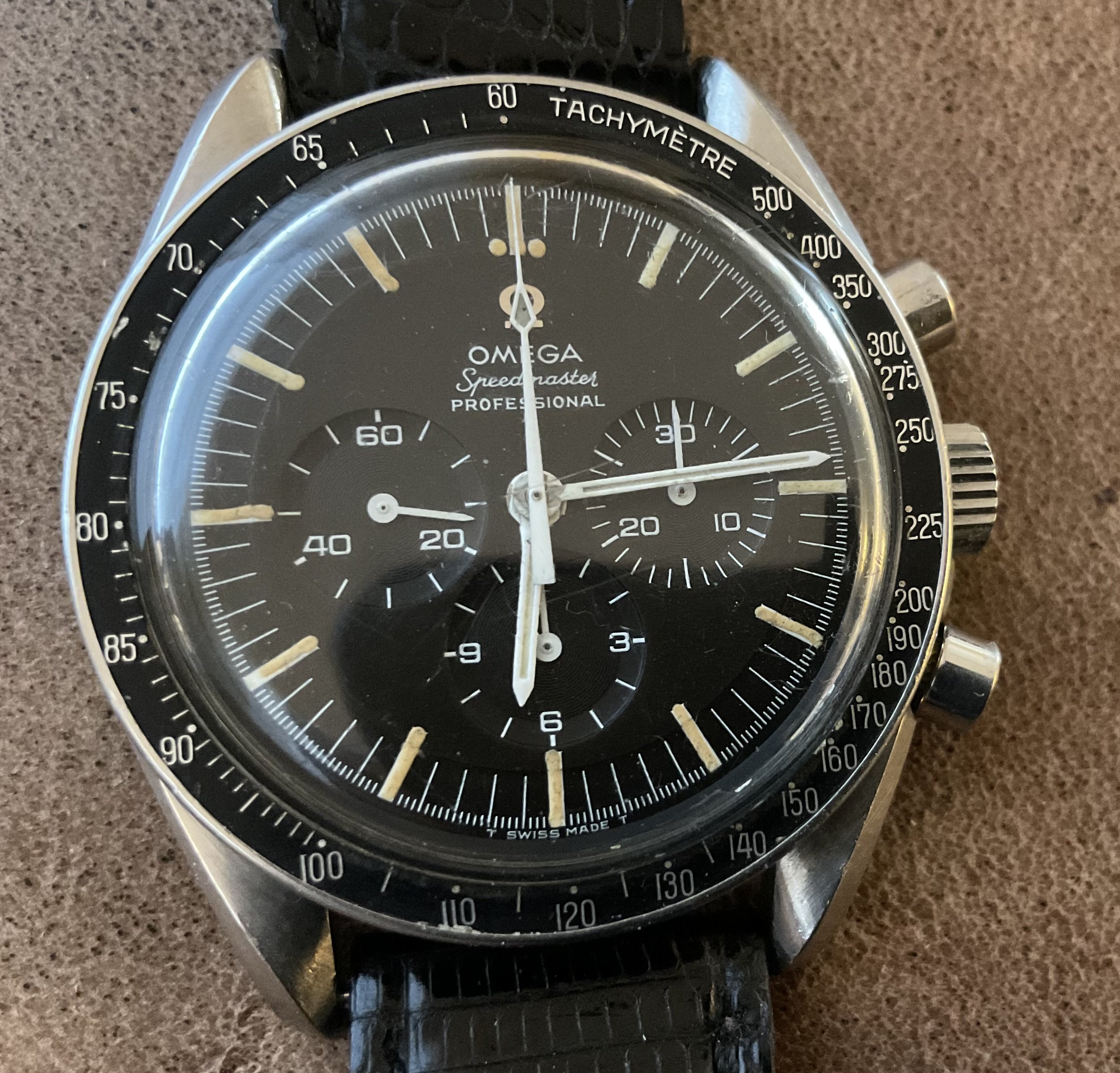

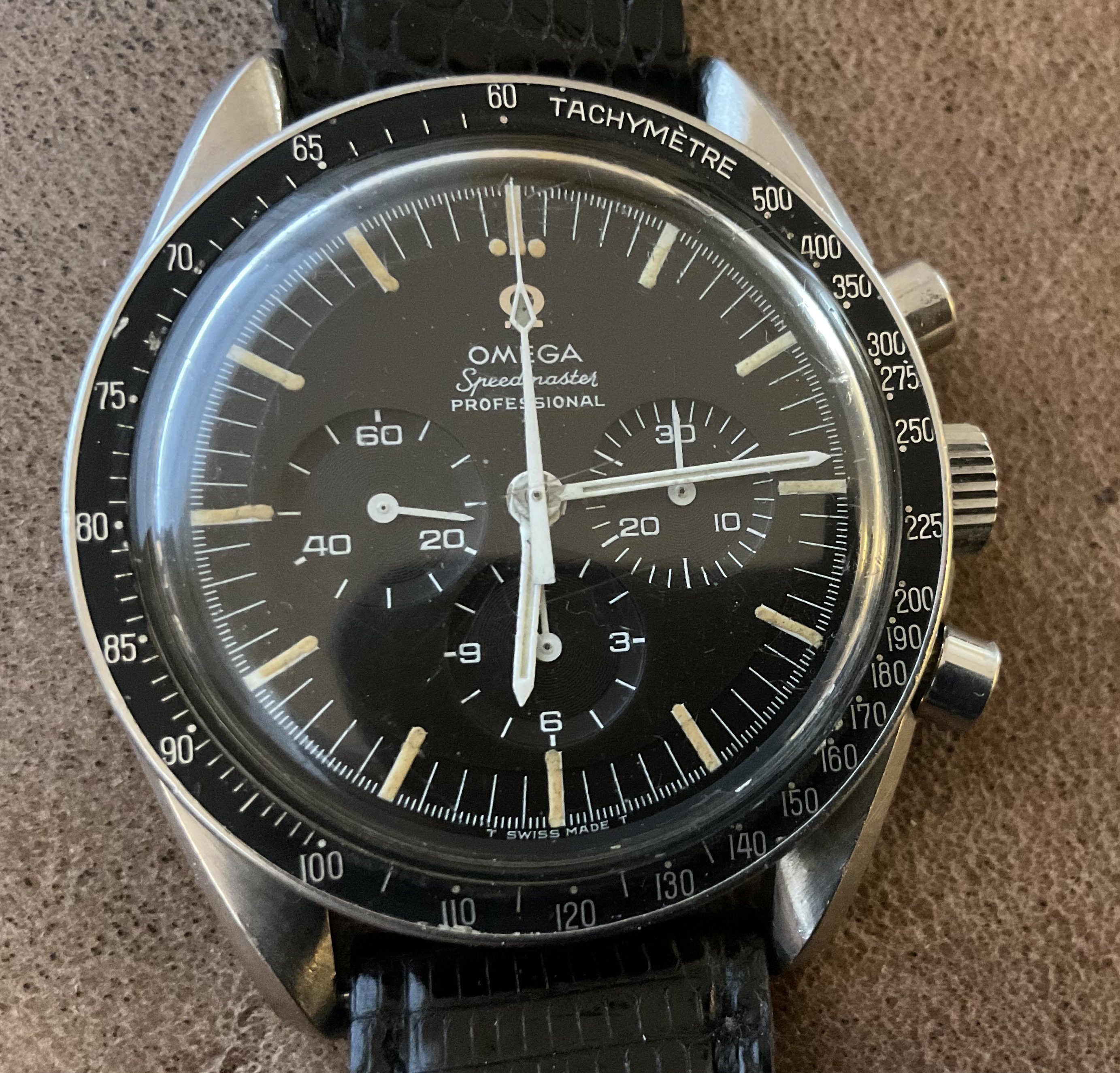

I’m solidly in the “no” camp as well. I think the point of buying a cal 321 Speedmaster is a certain level of originality. I’d love to own a museum piece, but I buy watches to wear. So realistically I expect some aged tritium, paint loss on the hands, a bezel ding or two, and stuff like that.
As a data point, I recently bought this 145.012-67 from a nearby (~40 miles away) auction. I believe it to be all original, on a strap (so basically head only). Cost me about $5k shipped, including tax, auction fees, etc. IMO not a screaming bargain, hopefully not an egregious overpay, either.
584
748
Seems like a pretty good deal (edit: but I also just noticed the missing lume at 1 o'clock). Is the serial number in the right range? How are the case edges? And is the crown flat-foot/24-tooth?

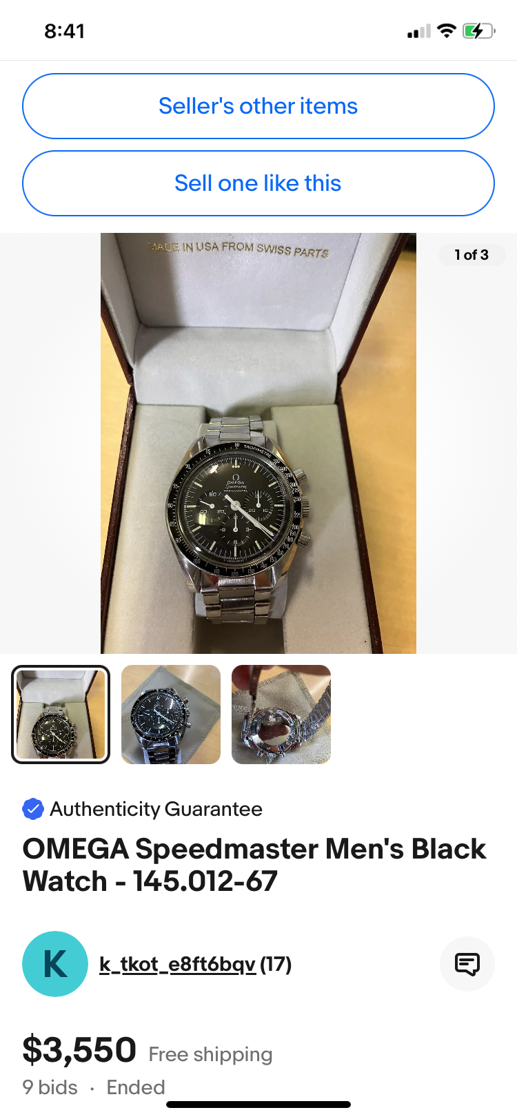

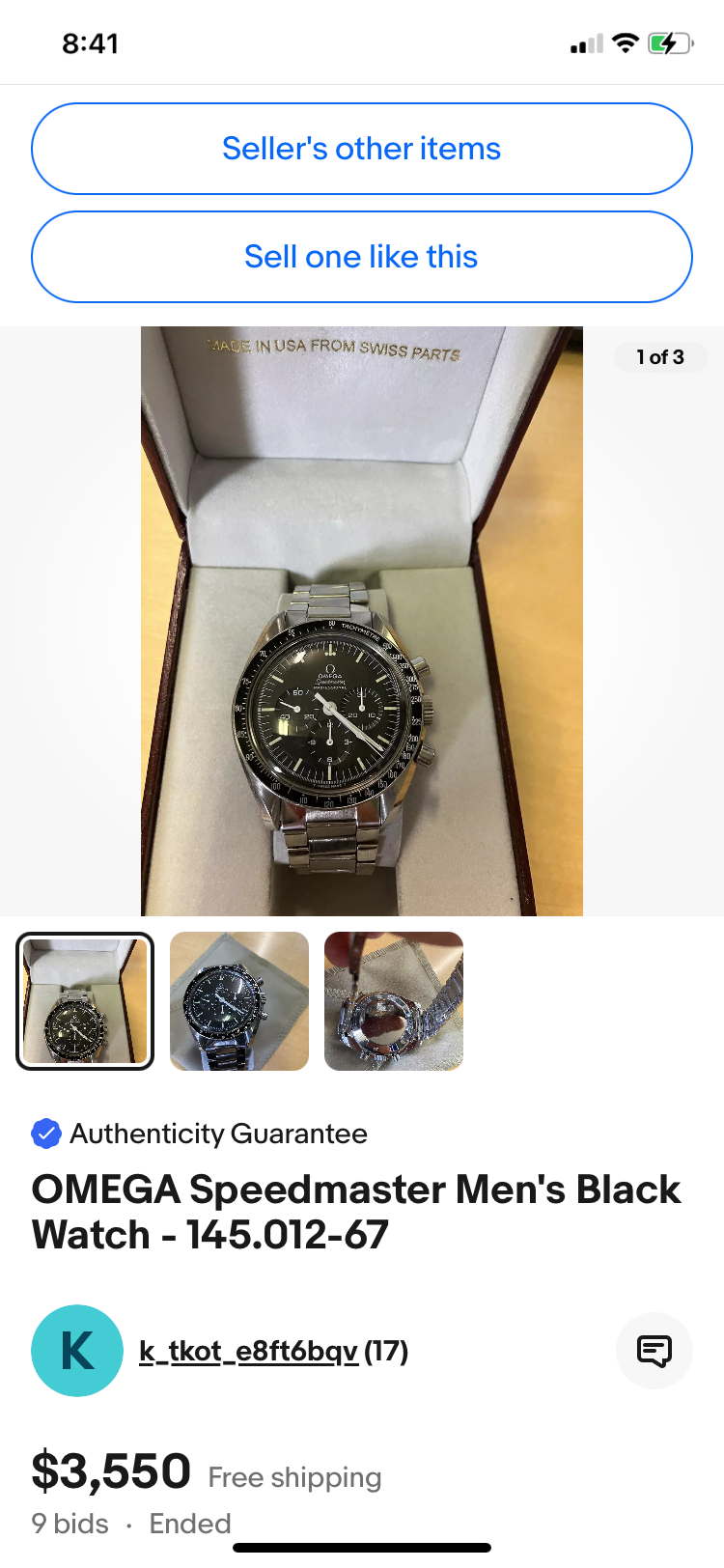

That sounds about right to me … FWIW, here’s another 145.012-67 with a ton of service parts that recently sold on eBay:
https://www.ebay.com/itm/315330354771
I had been in contact with the seller, who told me that he got $4,200 for it.
Case edges are pretty good - I don't think it has been polished, just normal wear. 24 tooth flat foot crown, 2654xxxx serial number (in range). The lume loss on the 1:00 marker was the biggest issue that I saw, and it's pretty hard to see on the wrist. I think this is a good honest watch to wear, not a safe queen.
(Gee, I wonder why it's running fast? And yes, it's on its way out for service)
