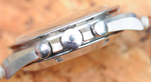

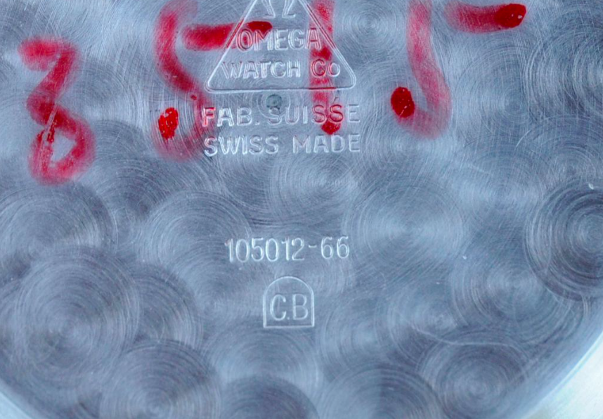

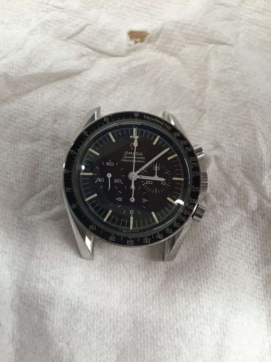

I've come across what has been described to me as a 105.012-66. The case back shows the maker CB and I would thus assume that it should have the facet edge on the lugs. This is my first foray into vintage Speedies and while comparing to SpaceFruits site I cannot decide whether if the facet is present or if the case has been changed or if it is no longer as obvious due to polishing. Any opinions or photos of yours for further comparison would be appreciated!
View attachment 160019 View attachment 160020
957
3,177
Thanks for the reference @JohnSteed. It appears to me that the lugs are not the same. Could this mean a replacement caseback or is a replaced case more likely? Hmmmm.....😒

Well, one possibility I can venture, is heavy polishing,
2,266
4,262
OP's watch is not a CB case. I think @greekbum should be interested in this one, since he has a CB case with an HF-lid.
NB, you need to see the caseprofile too, to be really sure
12,978
22,514

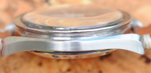

Yes it helps to see a side view as the CB cases have a slightly different profile, tapering to a thinner edge. Of course this might've changed if the case has had a good old polish.
237
1,679

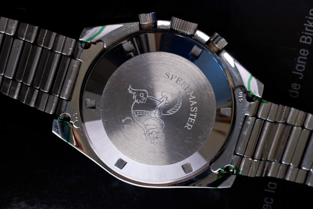

Another possibility to distinguish a CB case is to see if the lugs have a flat on the rear side.
On my CB :
12,978
22,514
Yup. That looks like an HF case to me.

I don't think this particular mid-case is even a polished CB case though. The sides on CB cases have a very thin profile, which looks different to the HF cases.
As Naidu mentioned above, CB cases also have the little flat section on the reverse of the lugs which this doesn't have.
I wouldn't completely rule out CB realising their cases were different and removing the vertical facet on the front direct from the factory, but I'd be very surprised if this happened. Even if they did change the polishing for the front of the lugs in the factory I'd be even more surprised if they went to the effort of changing the cut on the rear of the lugs and the sides of the case.
I think it's certainly most likely that all CB cases had these extra facets and they have since been lost through polishing. In the case of the OPs watch, I simply think it's an HF mid case.
