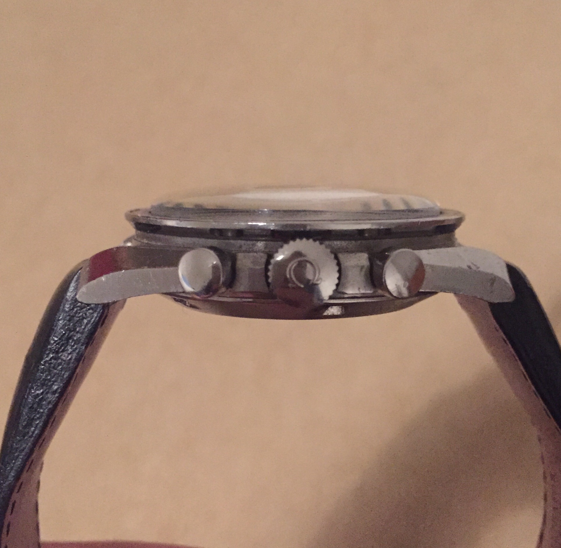

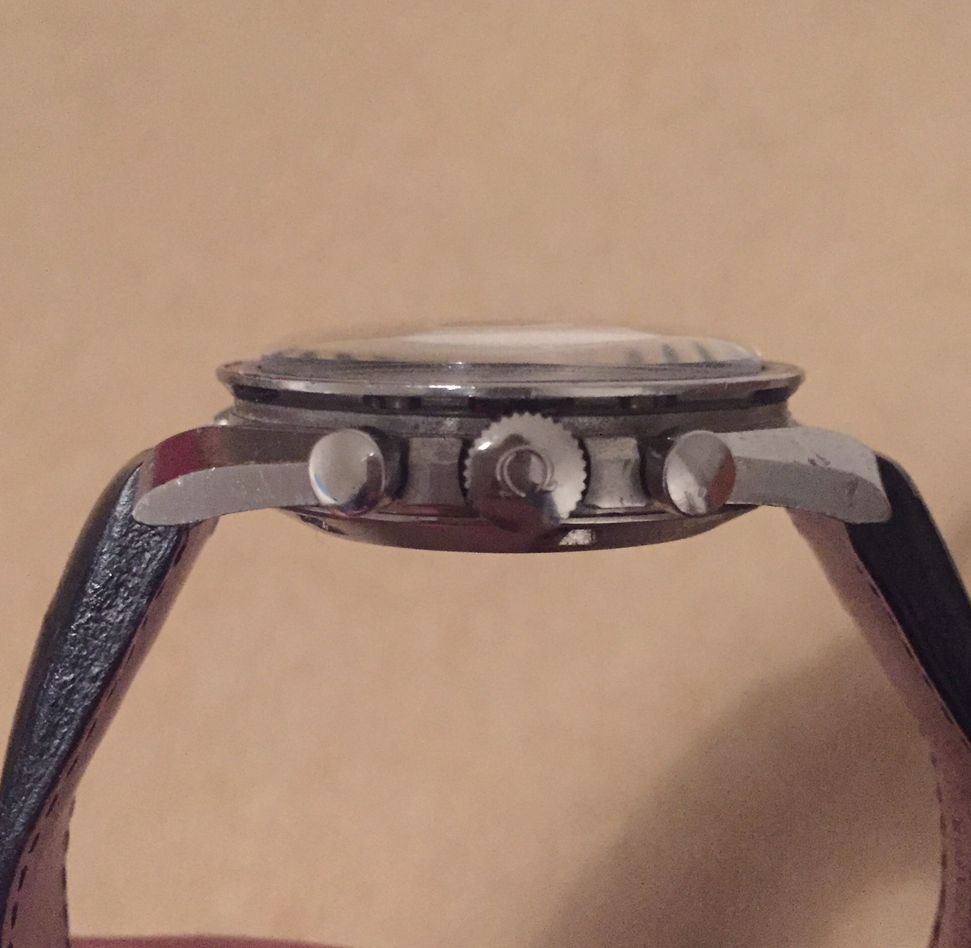

Poor pictures but mine clearly has the facets on either side of the lugs as well as the thin, uniform width sides.
Anyone else care to share theirs? Particularly those without the facet on the front b

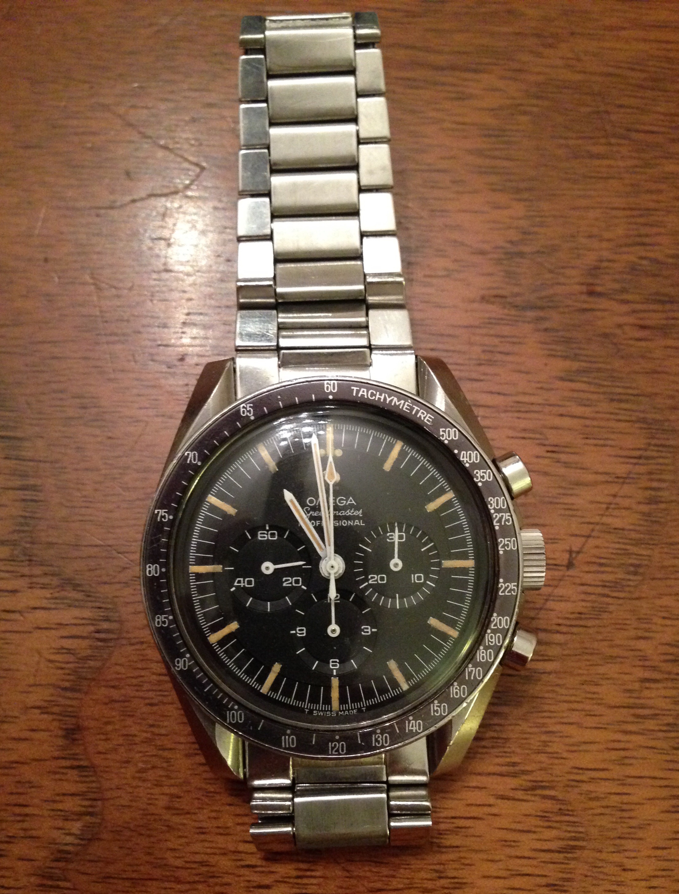

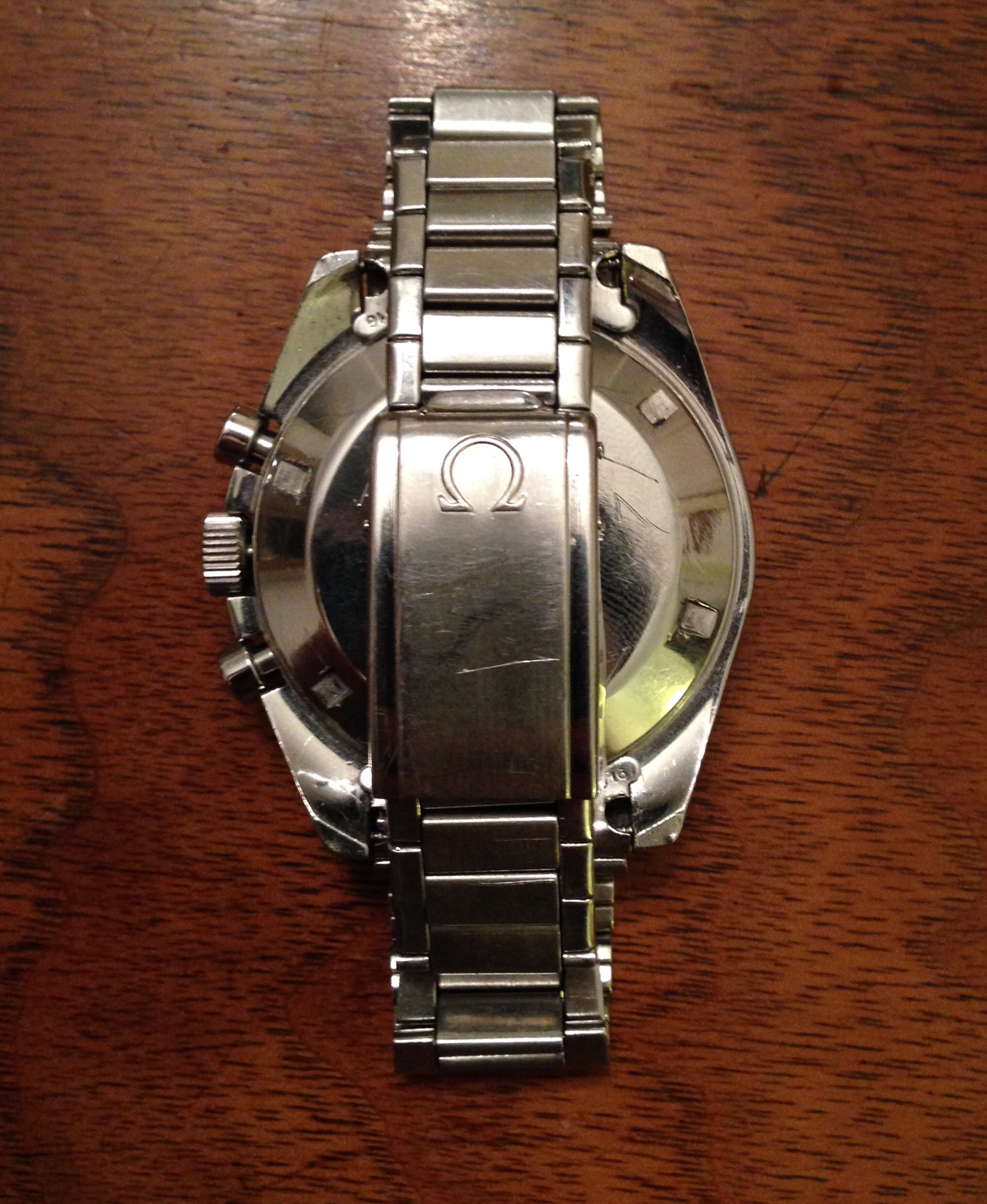

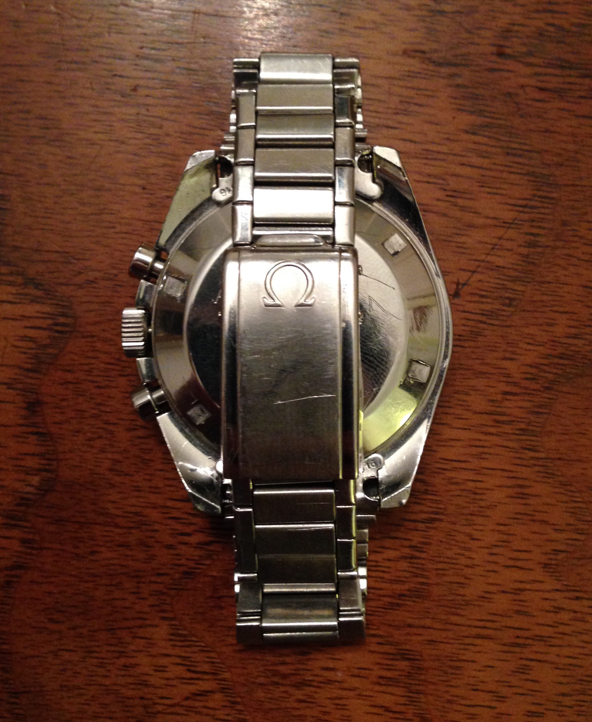

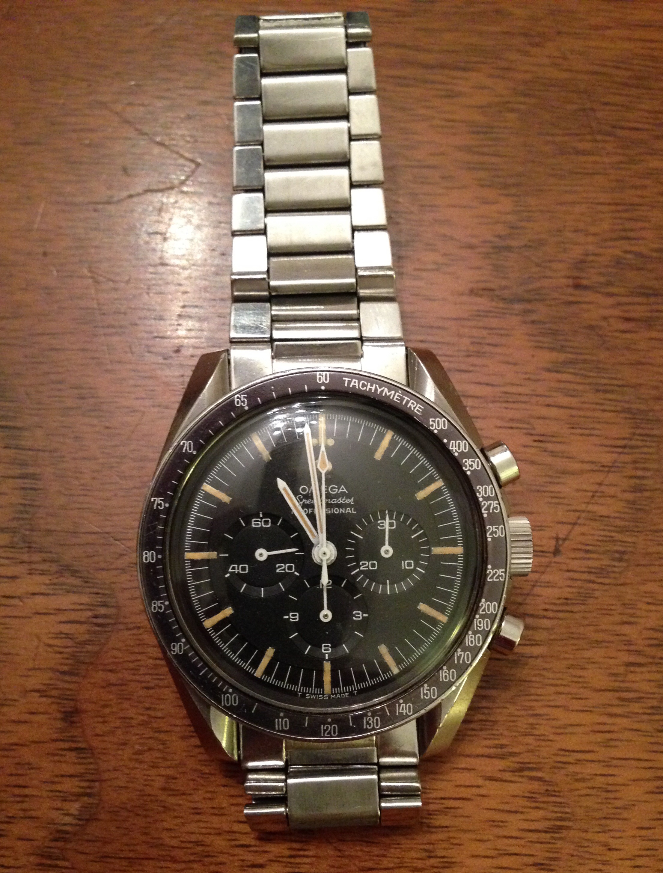

This sums up my thoughts at this point. Very appreciative of the opinions shared. I'm guessing to some this is a Franken but could the issue be "looked past" by sourcing a HF caseback? In the end it's really just how much the buyer (maybe me) likes the watch and if the price is right.
2,876
1,963
I think a 66 speedmaster that has faceted lugs but has a HF caseback would be regarded by most here as having a wrong caseback.
Bingo! Can someone show me an example like that? I don't recall seeing one instance of the flat top lugs with the 66 HF backs at all. So the theory that those CB backs with the normal twisted lugs, of which there are many, were the results of case back switching or mixed up just doesn't have a foot to stand on since if it were the case, there would similarly be a lot of the other combination floating around.
As to the possibility of polishing away those facets, we would need to examine each individual example, but I think it is unlikely possible, especially for that many examples. Since all those flat top lug CB cases also have the thin side profile along with the flat cut at the lugs bottom, like David observes, just polishing away the facets would still leave those features behind, along with usually obvious polishing evidence.
957
3,178
OP's watch is not a CB case. I think @greekbum should be interested in this one, since he has a CB case with an HF-lid.
Decided to pass on this one. If @greekbum is interested, or anyone else I'd be happy to share via PM.
