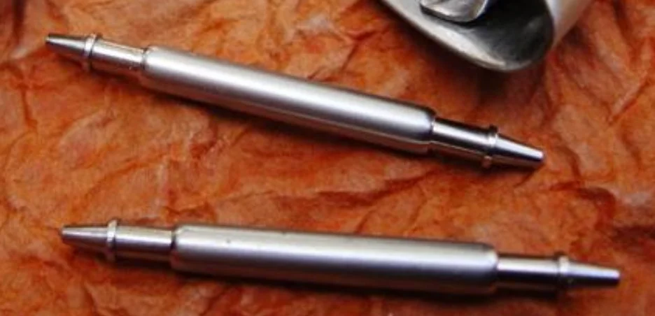

I'm hoping someone can help me with the lobster bracelet for this reference.
I understand these were attached to the watch by a special cone shaped spring bar rather than the usual kind.
Does anyone know the Omega part number for these spring bars? I was given 068 ST 9907 but a quick Google comes back to a bracelet not spring bars.
Any help would be much appreciated!

The bracelet part number is 020ST1212203.
068ST9907 is a spring bar, and this is the information given for it...
BANDWIDTH L1 : 17.00 MM
BODY DIAMETER D1 : 2.50 MM
PIVOT DIAMETER D2 : 1.60 MM

Thank you Archer! A local jeweller who I've used for various Omega parts can't find the spring bars on the system using that reference. I'll have to have another think...

If they know how to use the Omega Extranet, then it's easy to find just by putting the number in the way I stated it.
It is in there, so either they don't actually have access, or they don't know how to use the system.

I seem to remember a "rounded" spring bar on mine, not something "cone shaped".

Might be a difference in how things are described by different people?
