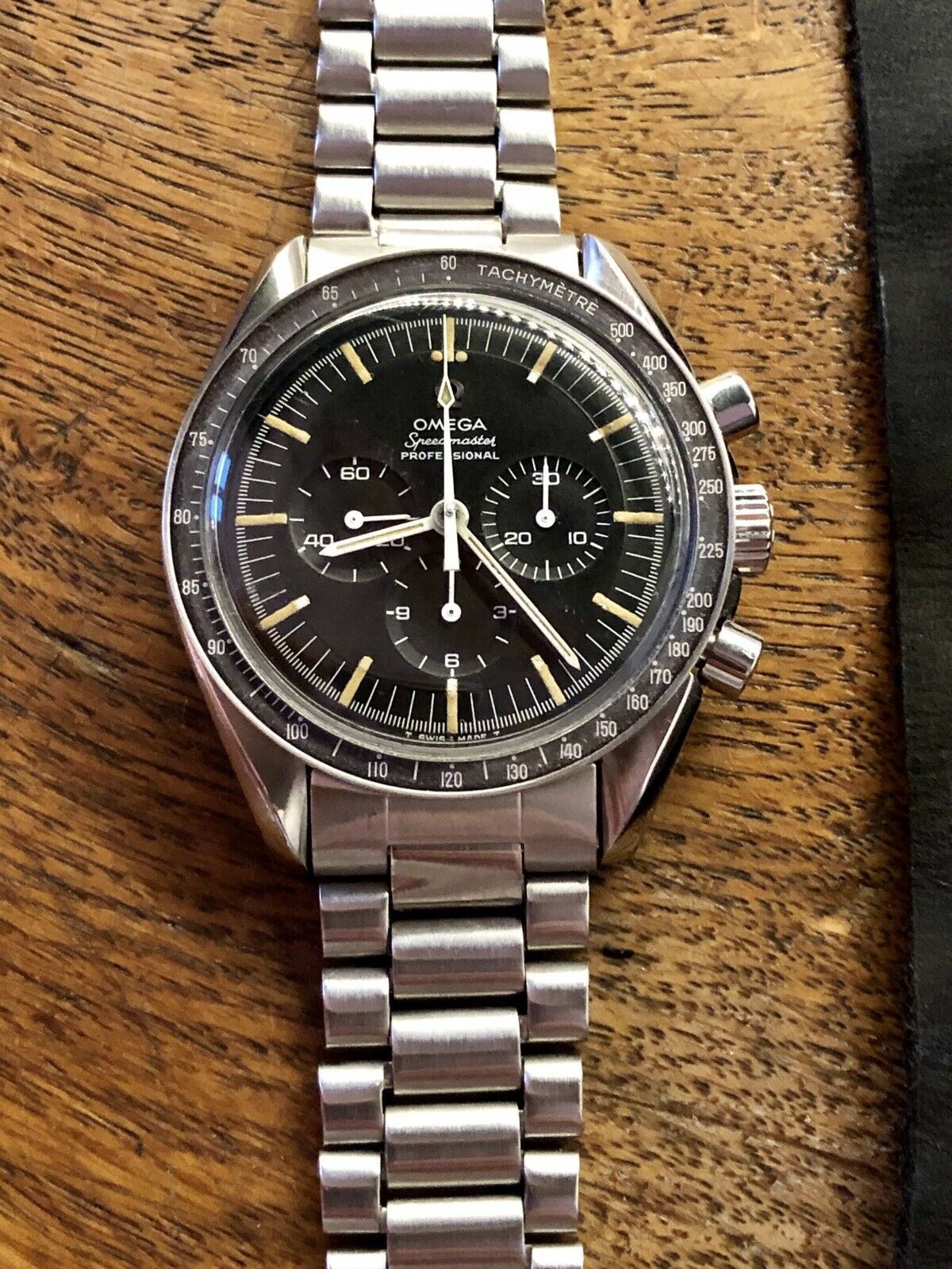

Some help would be great! Extract is refused on the Omega Website because the serial number is not long enough..... The serial number of this particular watch is: R. 38810.
These "R" serial numbers do not come up with any result when I try to look them up on the Omega Extranet, so that isn't much help.

I got an answer from Omega. Not what I hoped for but anyhow it solved the mystery!
Answer from Omega:
As far as the extract of the archive is concerned, it is likely that, at some point in time before you acquired the watch, the movement was exchanged with a replacement movement (movement number beginning with R.XXXXX) and therefore we regret to inform you that no extract of the archive can be ordered.

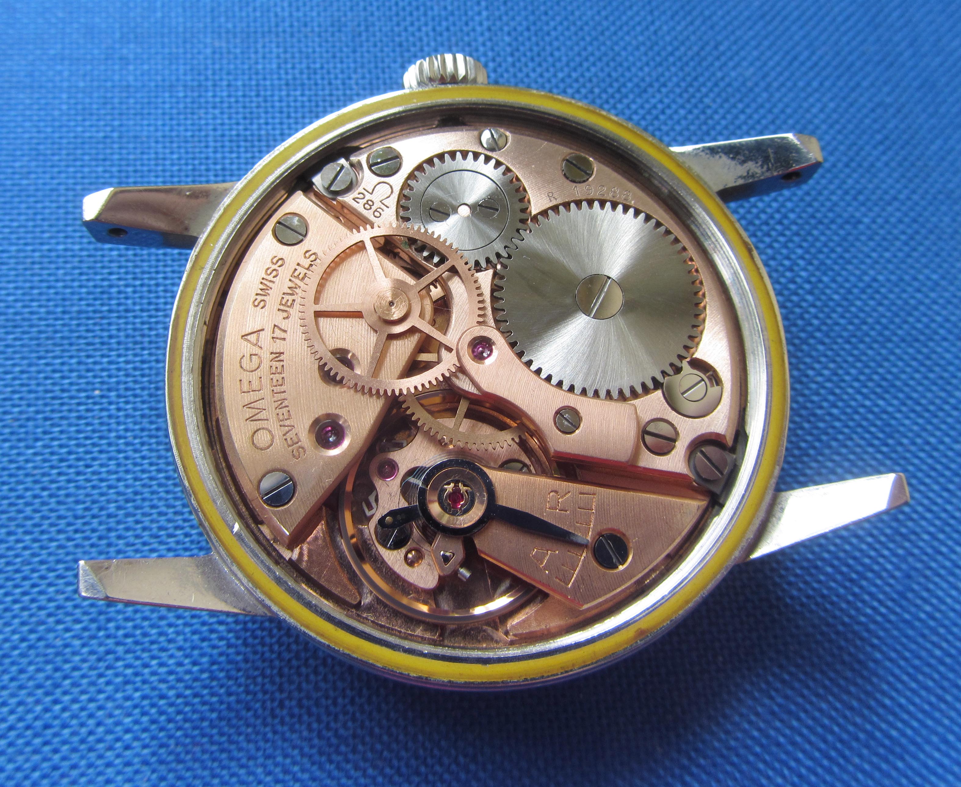

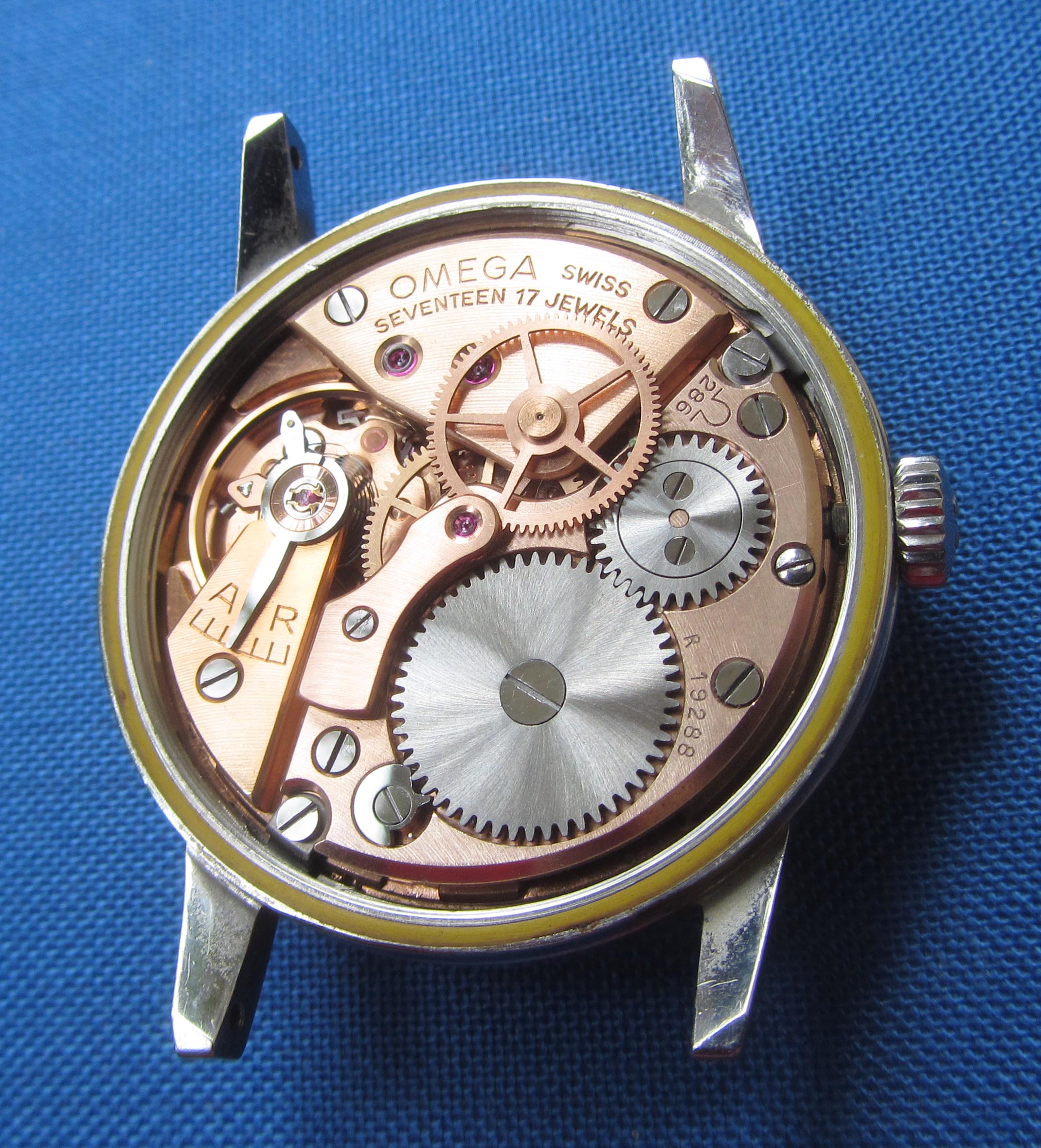

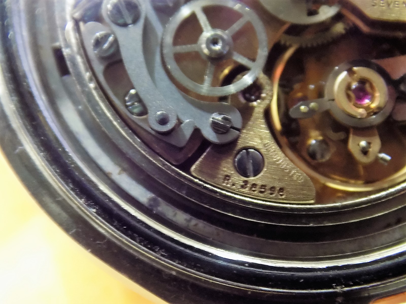

Strangely enough I have just found another of these.... Numerically speaking not a lot of difference between them....
36
63
wow! How interesting. The movement looks not to be rhodium, as mine, (or is it?) but the R-number is very close, only 176 movements apart.

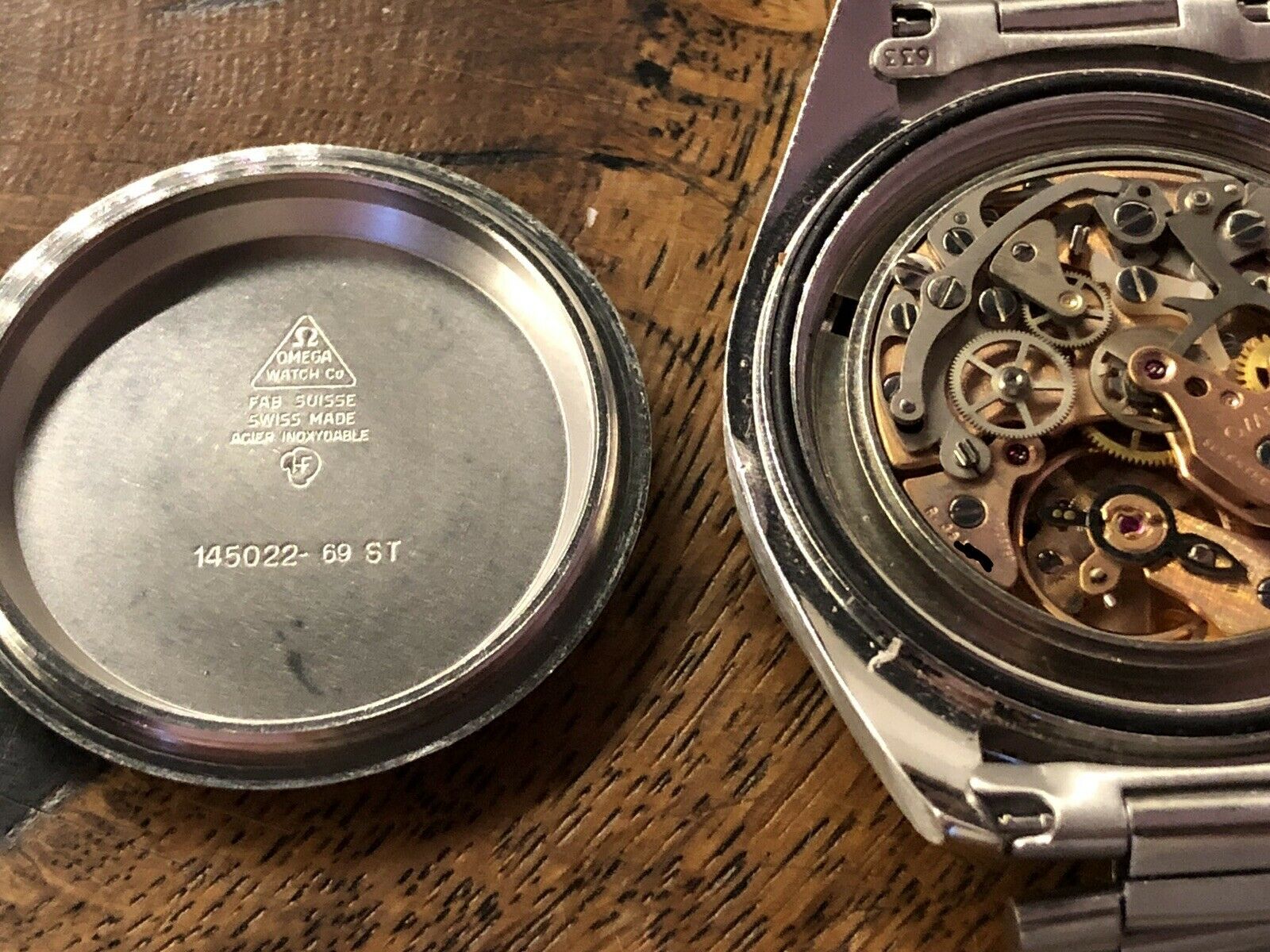

Hi, This is from ST145.022-69. This supports the theory that these are indeed replacement movements. To suggest that yours is a one off seems too much of a coincidence to me especially given the proximity of the numbers....

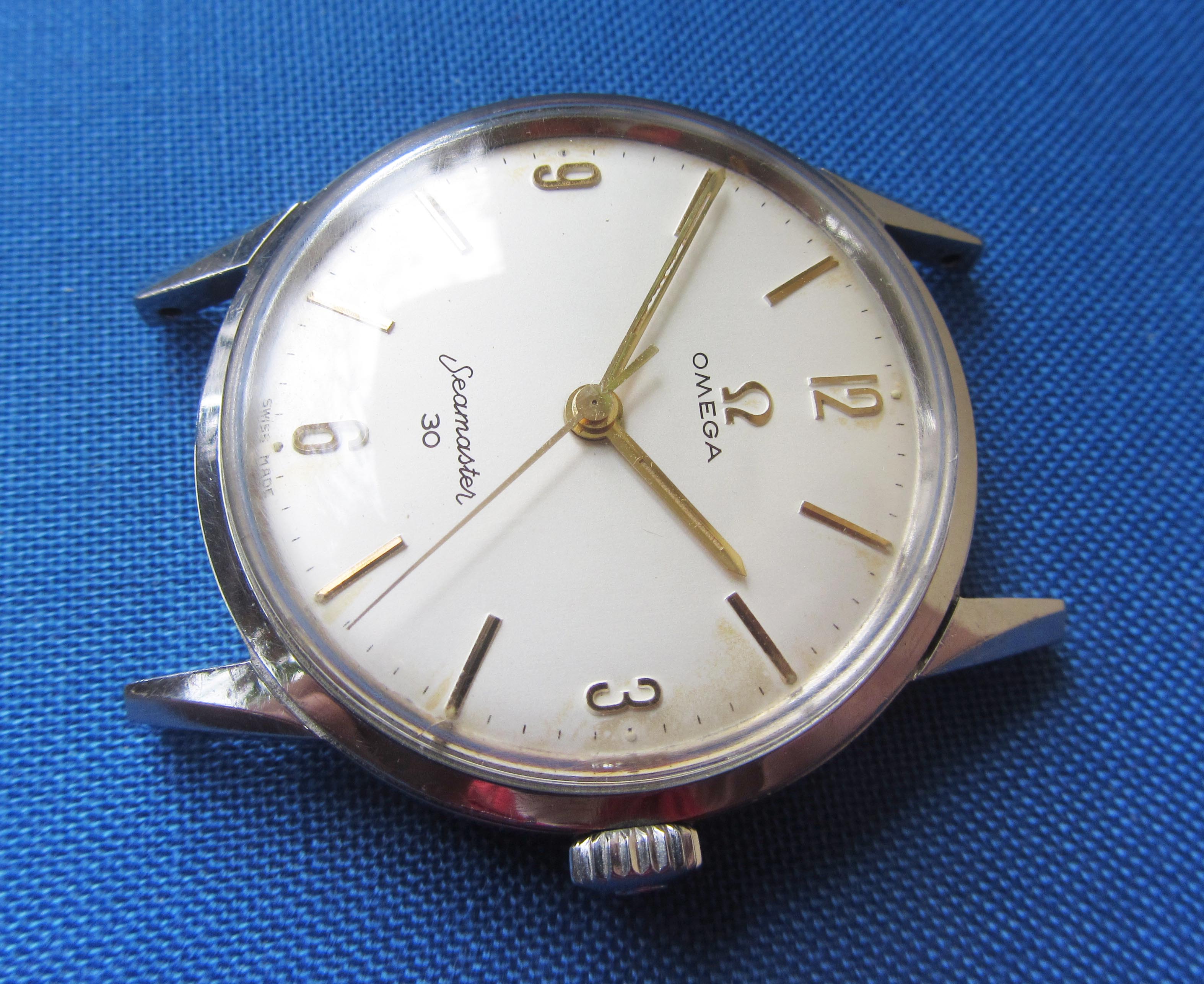

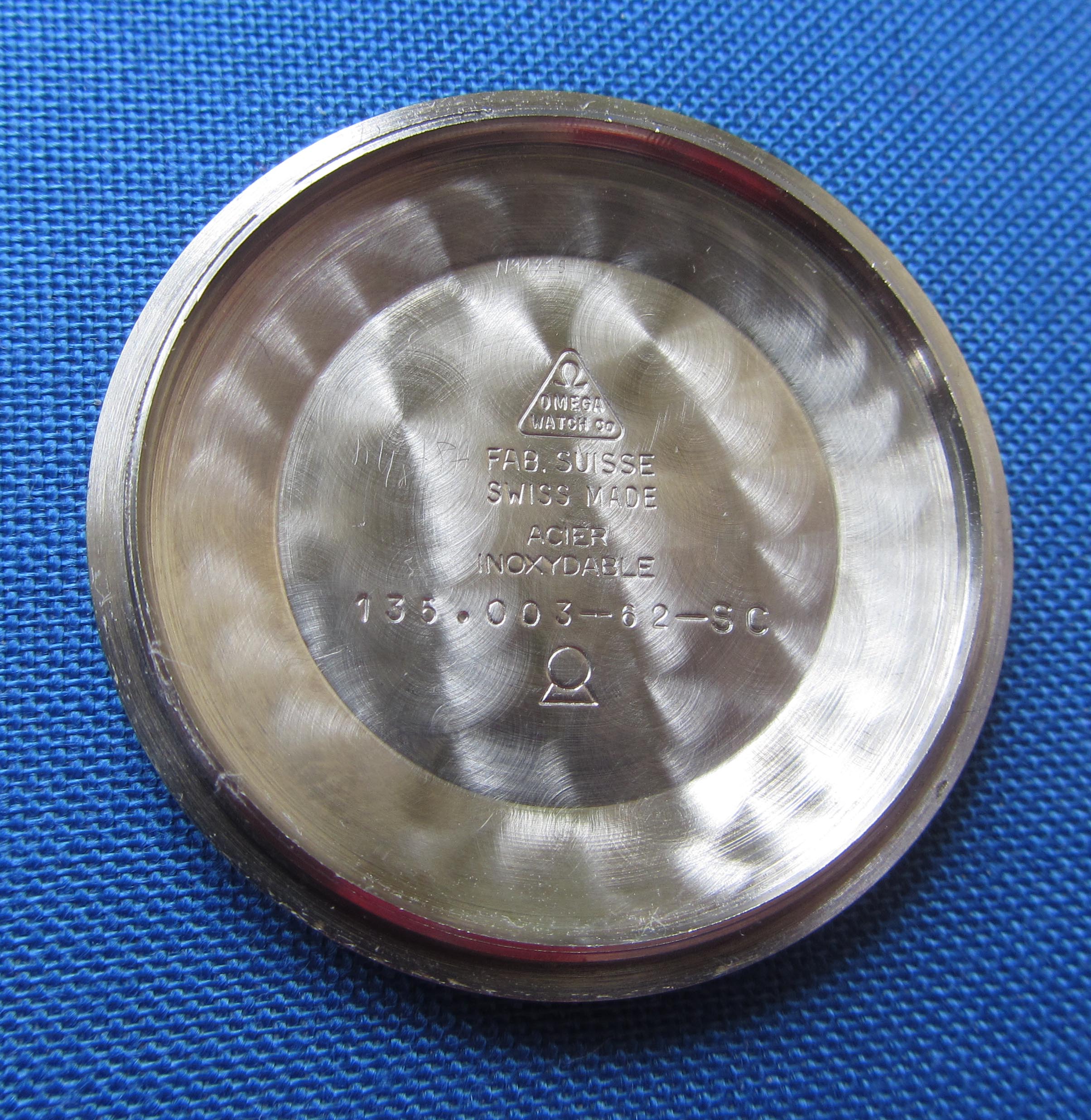

...today I get a 135.003-62 SC (Seamaster 30 from 1962). My 1st R-movement...I thought "replacement", that seems to be correct?

Having the R serial number doesn’t necessarily mean that the entire movement is a replacement.
It could be that only the piece containing the serial number was replaced. Some automatic Omegas has the serial number on the rotor and those get replaced quite often.

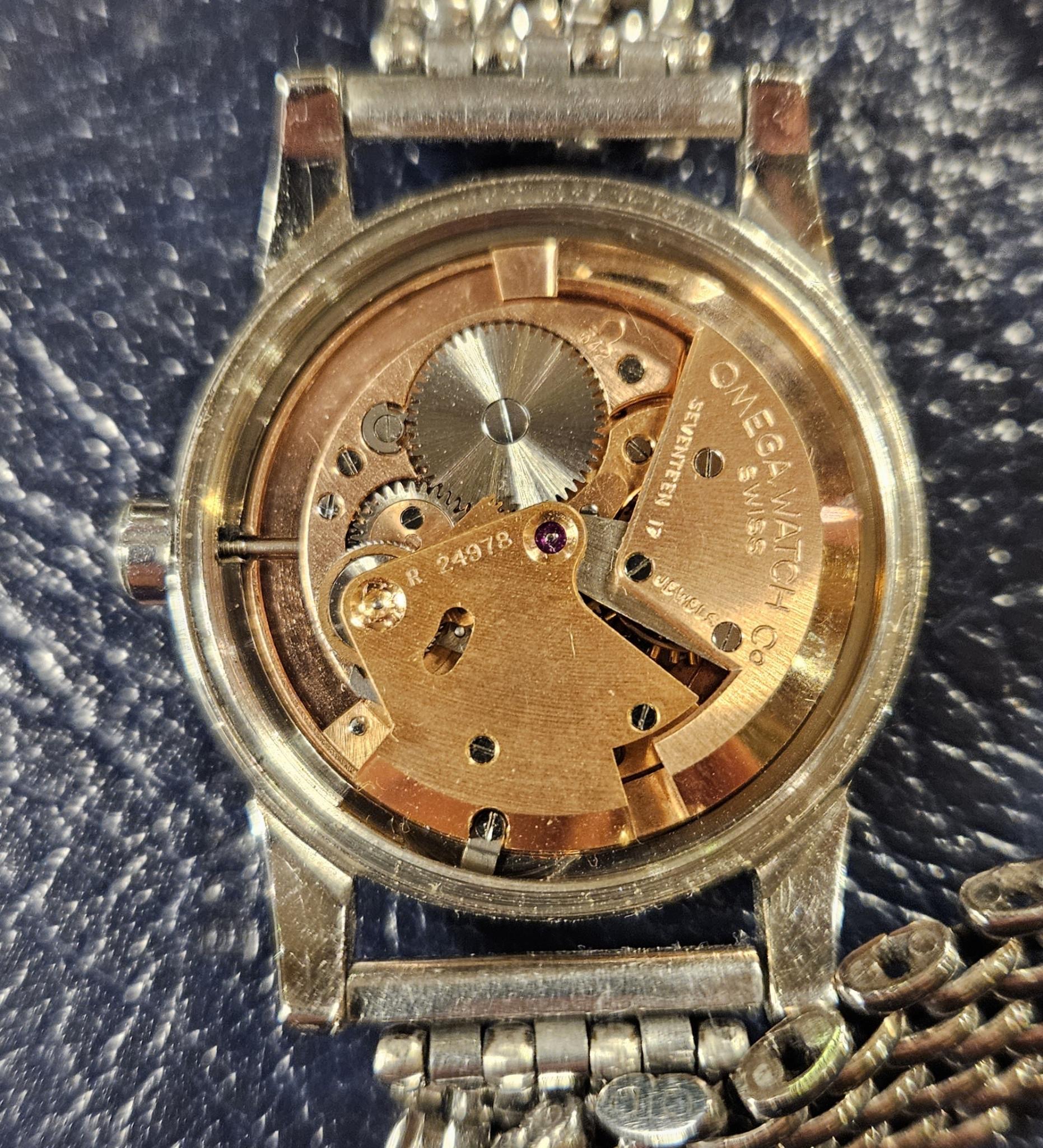

Sorry for reviving this old thread but wanted to add another example. I‘m offered this 2576 with also a R serial number, which I was not familiar with. The seller also said it was a „prototype“, which sounded weird as it was a common movement by then. Reading through this thread, R for replacement makes most sense. I‘m „color blind“ but even I see the different color of the part with the serial number and the rest.
4,440
18,267
I guess the most likely explanation to the "R" serial numbers is that they are numbered replacement parts.
Color blind too, but not that color blind to not see the difference between the stamped bridge and the other parts.
The bridge is holding the bumper rotor, so that this would be worn at some point, perhaps worse on an early design, seem very plausible IMO.
That again would explain it being replaced during a service. Using R-series for replacement parts would make a whole lot of sense as you could still ID the watch, but not having to make new engravings (with the original serial number) to a movement part when replacing it.
