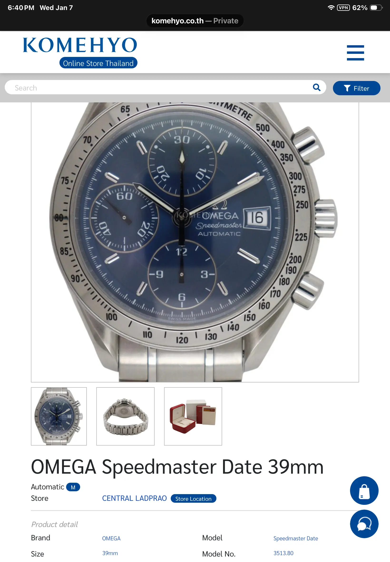

Is this what you are referring to?
I have been looking at their website for the past week, unfortunately all of the shops are about 2 hours from where I’m staying at.
I know that some people are shy about clicking on web links, https://www.komehyo.co.th/product/2600062429474-omega-speedmaster-date-39mm/ but they do have a nice selection of watches. I only wish that they would have better quality and more photos of the watches.
How accurate did you find their grading system? They have two Seamasters that I am currently considering.

Komehyo are Japanese, but also have stores in Singapore and Thailand (and possibly other places). I go to Japan for work and have bought...three watches from them over the years.
Cosmetic grading: they don't exaggerate. An S will be flawless. An A will likely need a loupe to spot anything, but may have had a light re-polish. Bs are more of a mixed bag, could have a scratch on the dial which is a bigger problem than a slightly banged up clasp (to me), but are all bunged in with B category. They rarely sell anything in noticeably beaten up condition though, and don't go in for the overpolished to the point of looking melted stuff that you see online. Overall, I rate them.
Internally, the Japanese big sellers often claim an 'overhaul' and may offer six months warranty, but it's usually their in house team that strips, cleans, lubricates and puts it back together (Okura, Daikokuya, etc do the same). They're happy to show you it running on a timegrapher and give you a print out. That doesn't mean flawless in the longer-term though. Mine lost amplitude a year in, and the (excellent, Omega-certified) guy servicing said it needed a new mainspring and reverser, which together weren't expensive but clearly were put back in quite worn, though anything outright broken will very likely have been fixed before it goes on. That's not unique to Komehyo - I had it with another Japanese seller (bought in person in Japan) too. Fine, but that vintage piece had a strip and clean rather than new bits replacing part worn bits, so it was a little...quirky (inconsistent power reserve, large-ish variation in positions, sometimes the day-date drag caused it to run out of steam if low on reserve near midnight, etc). If you buy older pieces, expect something like that and budget accordingly.
Long story short, I find the quality better than some of the other questionable stuff you run into, personally, and you very rarely overpay.
