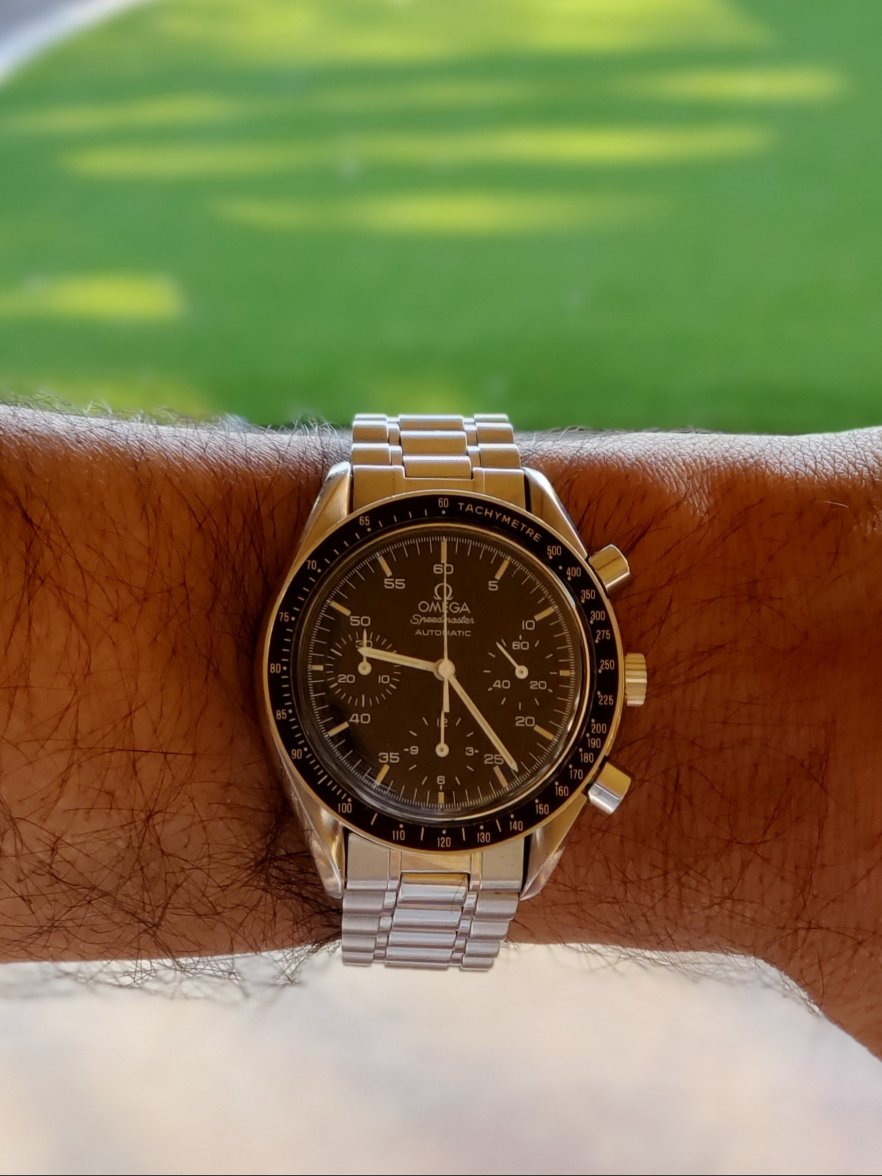

I just picked up a Speedmaster Reduced w/ the 1140 in it and it's in need of a service. It's not keeping good time and the chrono is not functioning correctly.
Since it's a relatively modern watch (production range of 1988-1995) it should be okay to hand over to Omega for service, right? My local Omega Boutique says they ship the watches to Seattle for the work, and the turnaround time is about 8 weeks.
The case and bracelet are in pretty good shape so I'm inclined to ask them NOT to polish them and just keep the focus on the internals, the bezel and the Hesalite. Am I missing anything or does anyone have a good reason for me not send it out to Omega?
