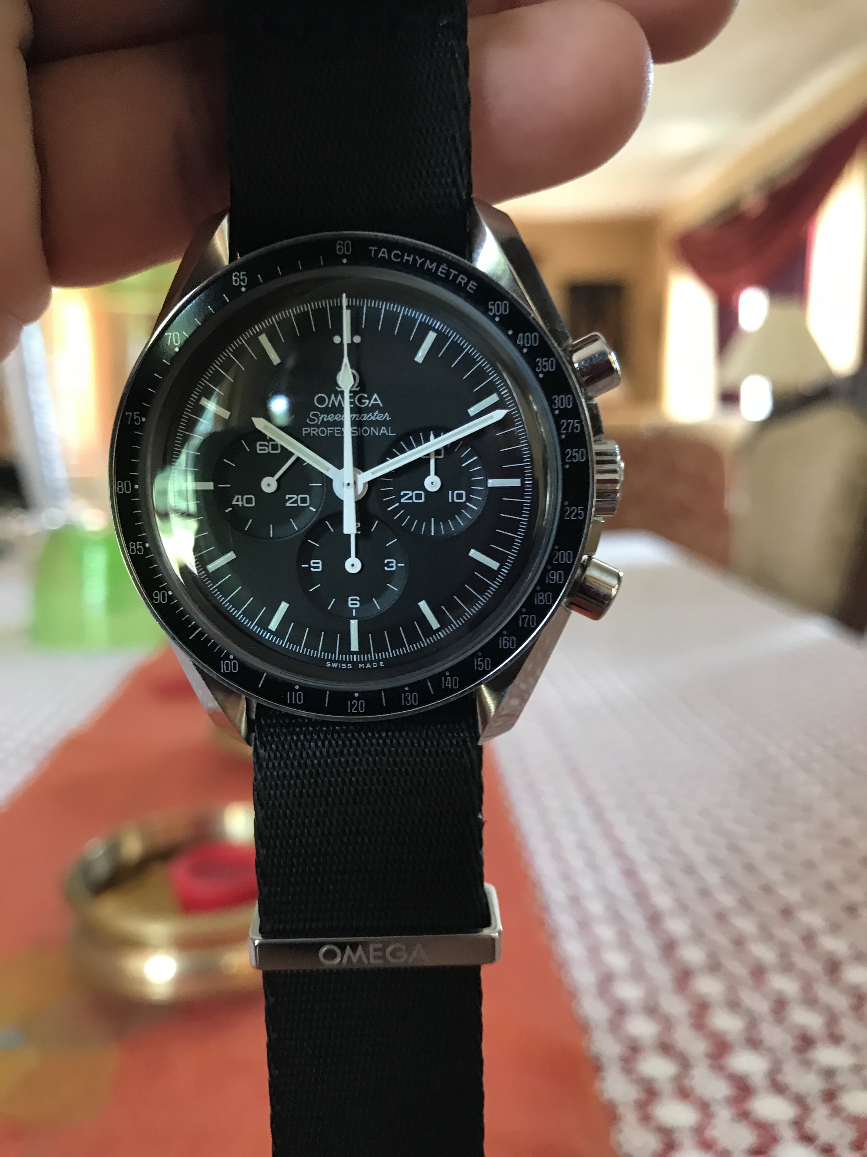

Finally got myself a new (to me) speedmaster and I really like it so far. There’s just one thing I didn’t notice before I bought it. It seems like the Chrono reset pusher is sticking out farther than the start stop one. It’s very slight, and the chronograph works just fine. Is this something I should go out of my way to fix immediately, or should I just stop by the omega boutique in NY next time I’m in the area? The watch is under warranty. Thanks

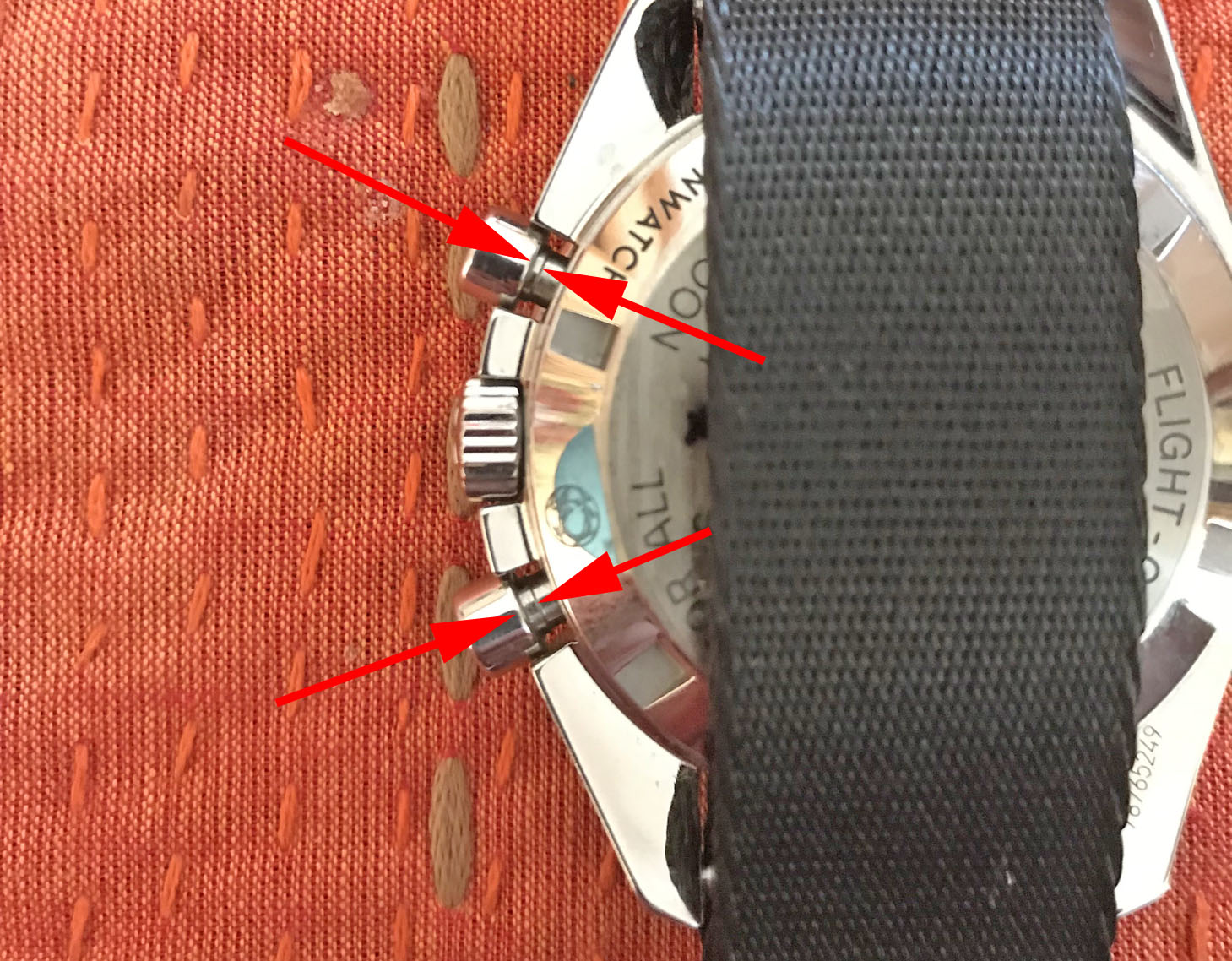

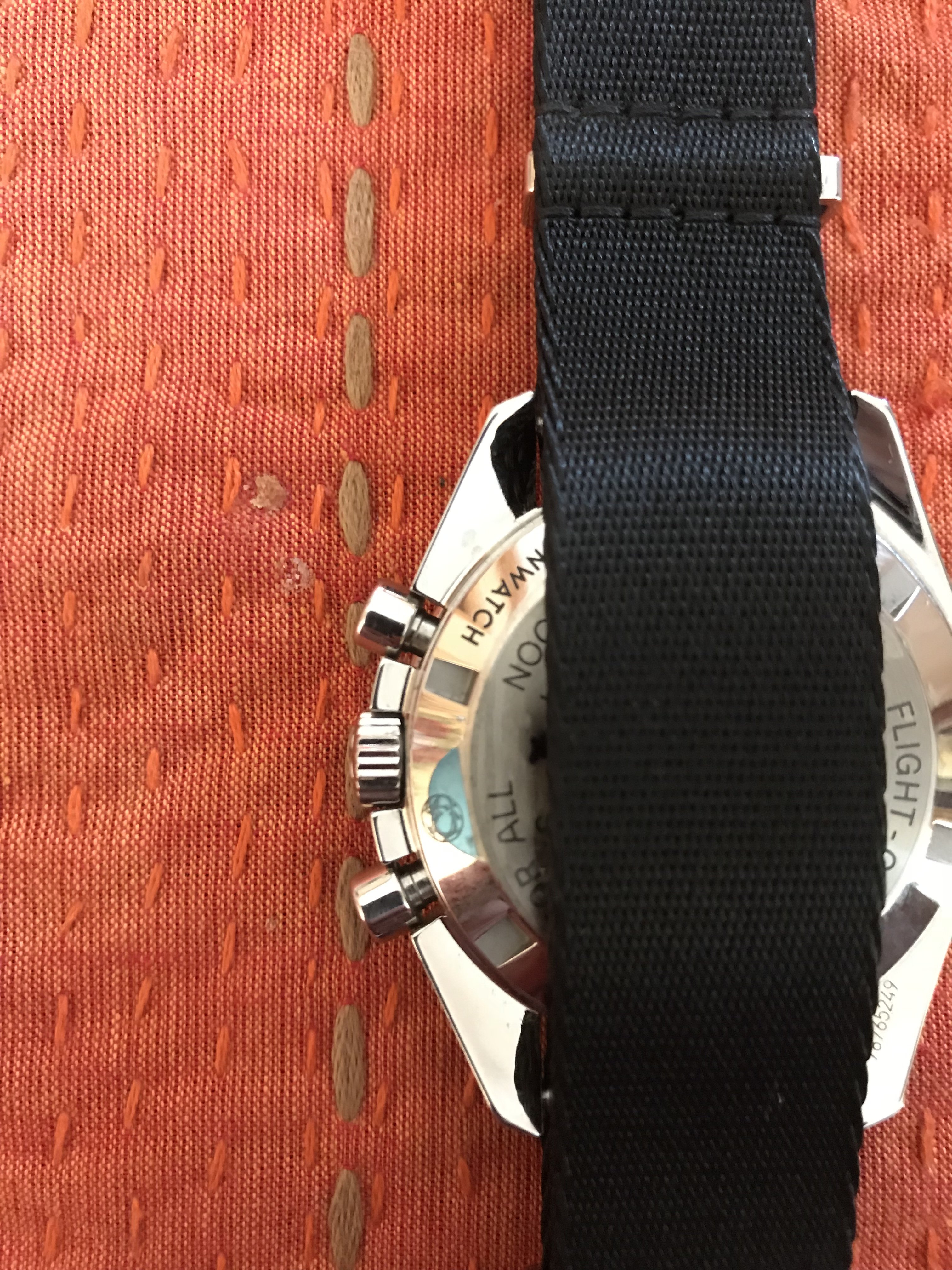

And the very slight issue. I’ll admit I’m probably just being paranoid. It’s pretty hard to see in the pics

The pusher needs to be replaced. Your water resistance could be compromised. 10 min job by an experienced watchmaker.

I'd say that the pusher cap screw just needs tightening. No need to replace anything.
I would agree if it were any other brand but Omega replaces the pusher assembly at every service whether it needs to be replaced or not.. I'm sure there's a reason they consider it as a consumable. If OP sends it in to Omega, they will 100% replace the entire pusher instead of replacing the gasket then adjusting it.
2,828
4,720
You said in your first reply that an experienced watchmaker could fix the problem in ten minutes. You are correct.
You also said the whole pusher needs to be replaced. Sorry, but you are wrong.
What Omega would do at a full service is irrelevant here.
29,259
75,673
Bingo...

From the pic showing the back side of the watch, look at how the bottom pusher recesses into the case vs. the pusher on top. The top pusher is clearly more recessed to me. I would think they should be even. At least they are on all my chronographs.
Lower pusher cap is coming unscrewed...

I'm not looking at the overall height - I am looking at the large difference in gap shown here...
Ohhhh! Yea mine are the same in that regard 😀 Thanks for that clarification! Now I know what to look for.
