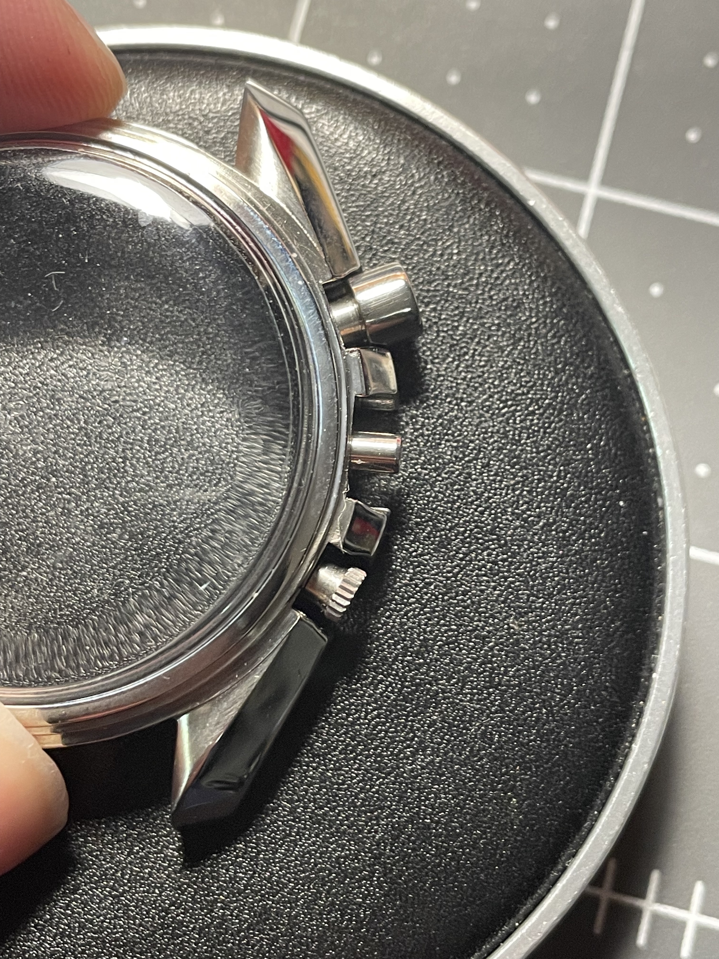

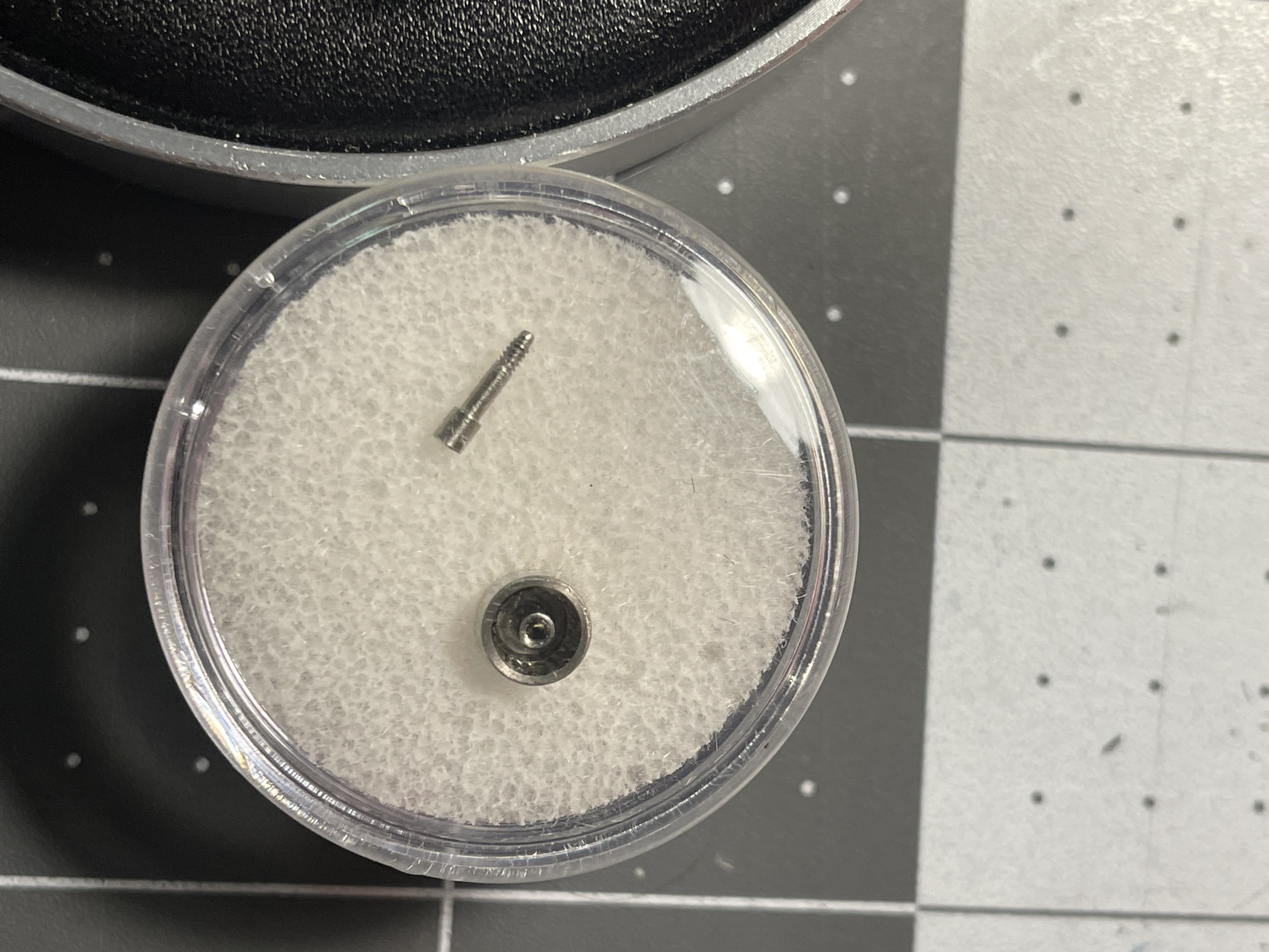

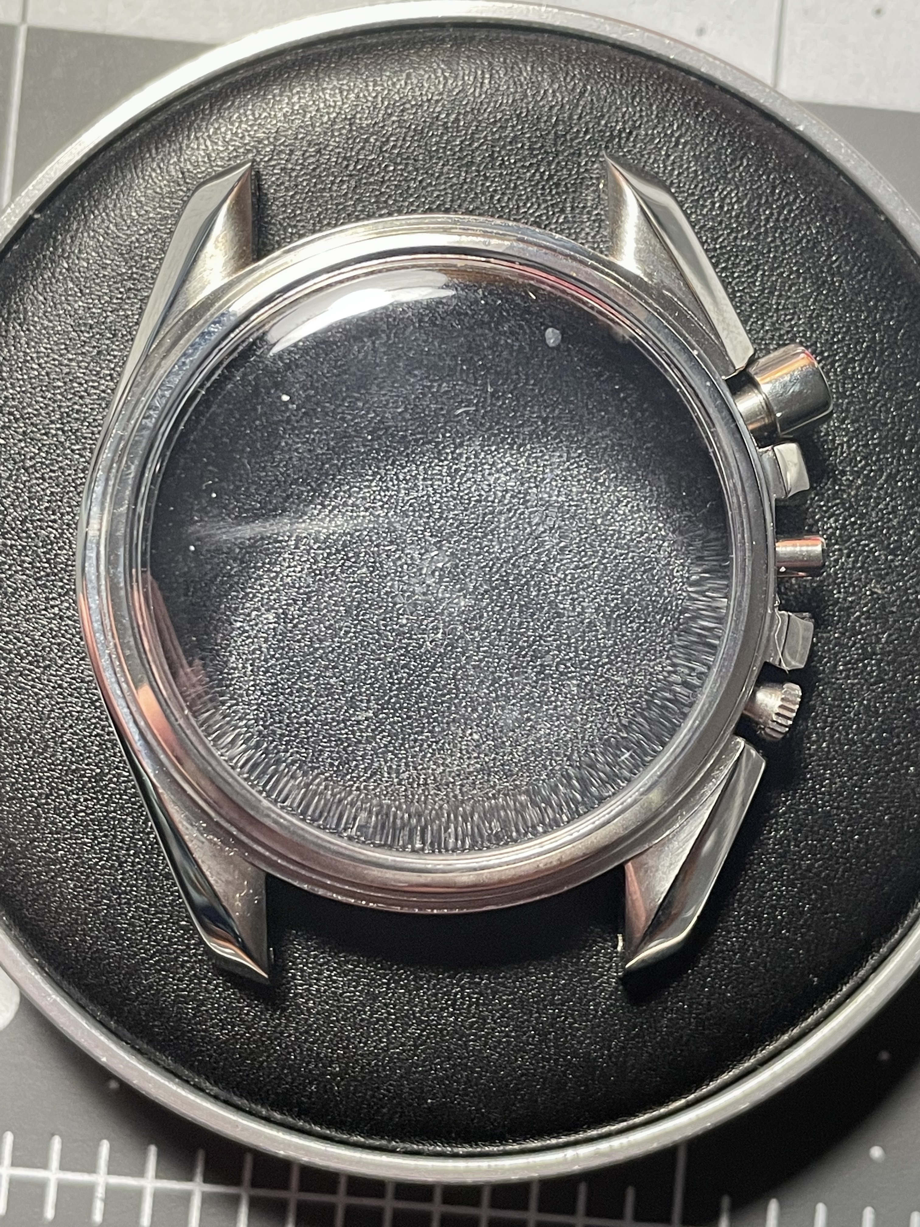

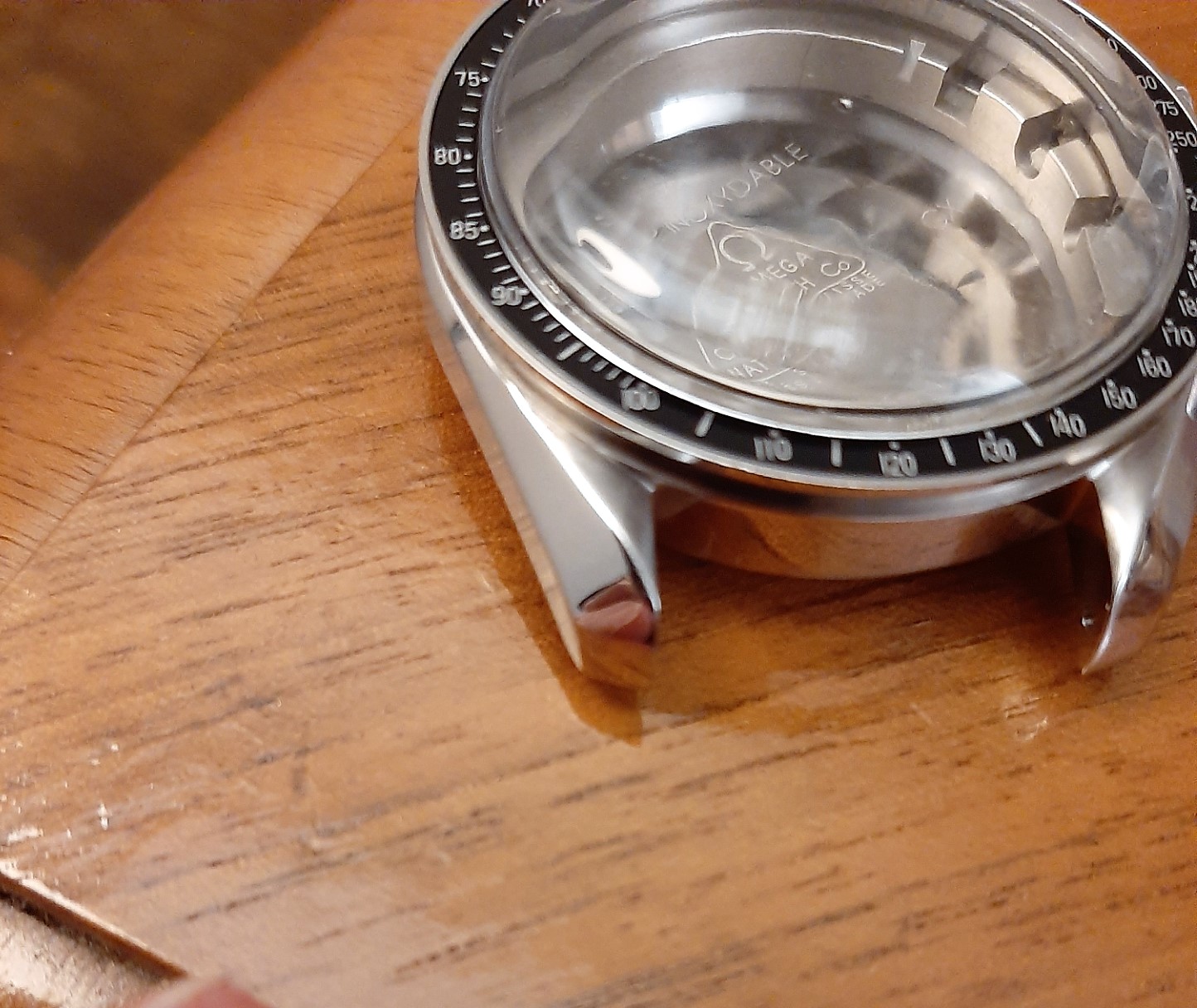

I actually bought one a few weeks ago....I hope I haven't been bamboozled, so I appreciate the thoughts of those with knowledge about these. Below are photos of the midcase that I received. The midcase came wrapped in white tissue paper and for some reason one of the pushers came packaged separately. The crystal looks correct to my eyes and is signed in the center. I spoke to the seller and he assured me that everyone was original and unused and he seems to deal in NOS parts. (My apologies in advance for the dust and smudges)
786
841
@Archer Are these shots from the inside enough?
I think this is quite questionable, unfortunately.
If I look at the photo you posted of the inside of the pusher cap, along with the pusher screw, it raises some red flags. Here's a comparison I did of genuine parts and some fake parts that came in on a watch I received some time ago...
Note how well finished the surfaces of the genuine cap is, compared with the fake one. Here is a comparison of the pusher cap screws:
Again the quality of the machining is so much better on the genuine parts, and note that the thread pitch on the screws is different on the fakes. There are 6 threads total on the fake, and 8 on the genuine - yours have 5 or 6.
The outside of the fakes are slightly different as well - the cap is much flatter where you press than the genuine is:
Machining on the outside of the pusher tubes is also much better on genuine parts:

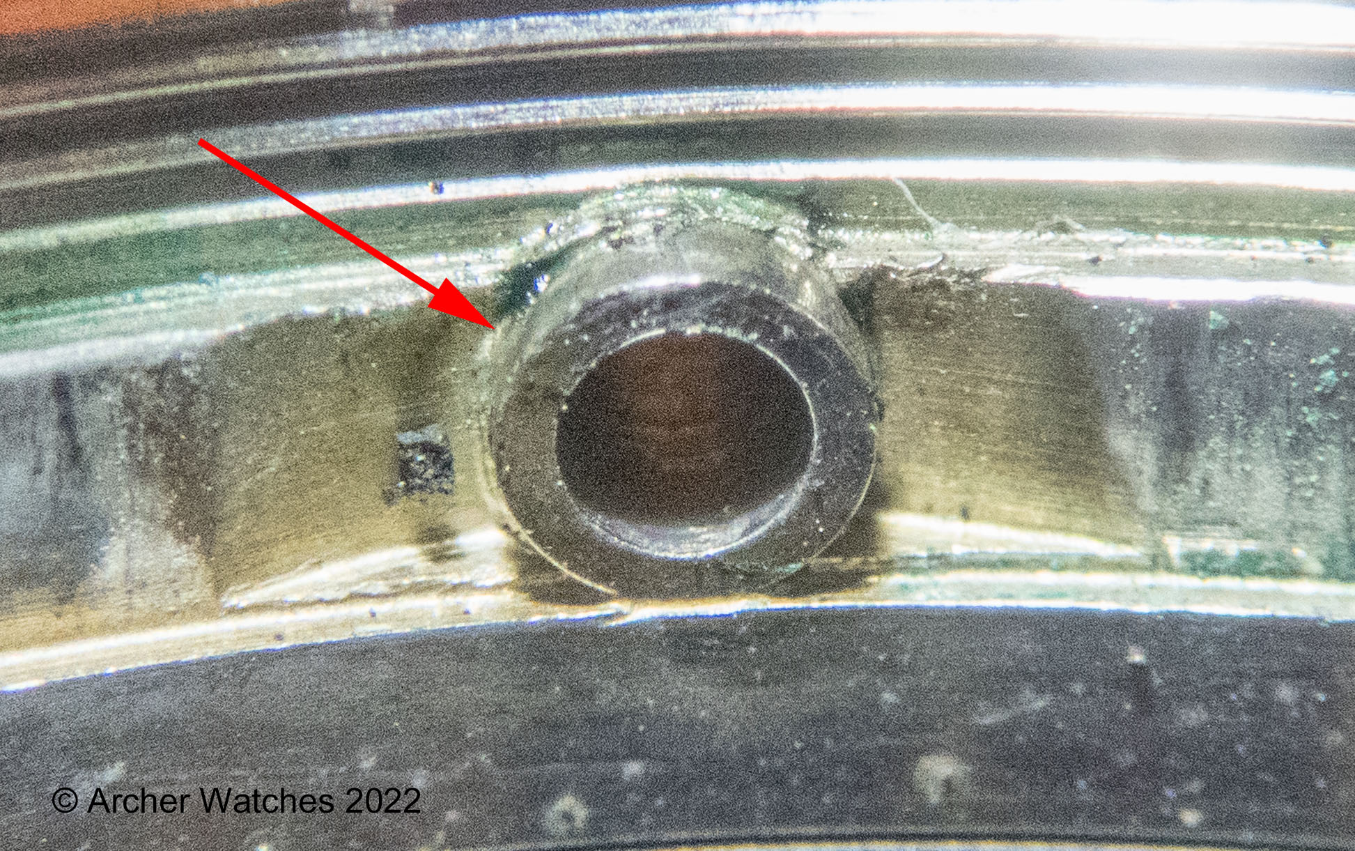

Looking at the photo of the inside of your case where the case tube is shown from the inside, that also raises some questions. I see no evidence of solder there. Here's a photo showing the area in question on a genuine case, and you can see where the solder is around the tube:
The only time I don't see this solder, is if the tube has been replaced. But if this is really a "NOS" case frame, then the tube should be the original from the factory.
So although not having the parts in hand, I can't say with 100% certainty that they are not real, I do have serious doubts.
Cheers, Al

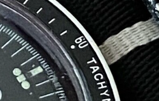

I'm confused by this:
The 60 is obscured by the bezel outer ring but theres no reason (it's not being pictured from wrong side) however on other photos it appears fine:
Suspicious that the pictures aren't same watch or they are flipping parts.

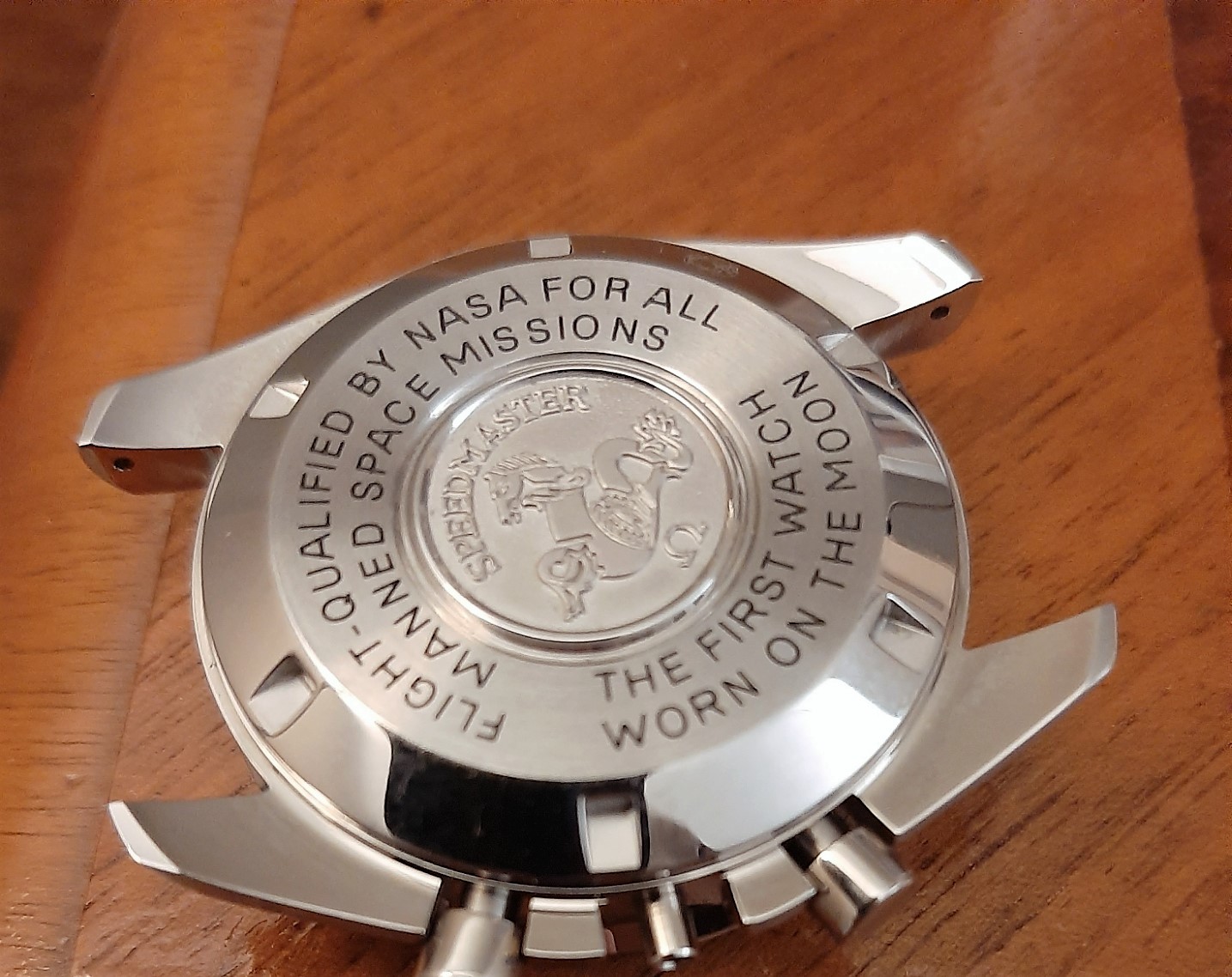

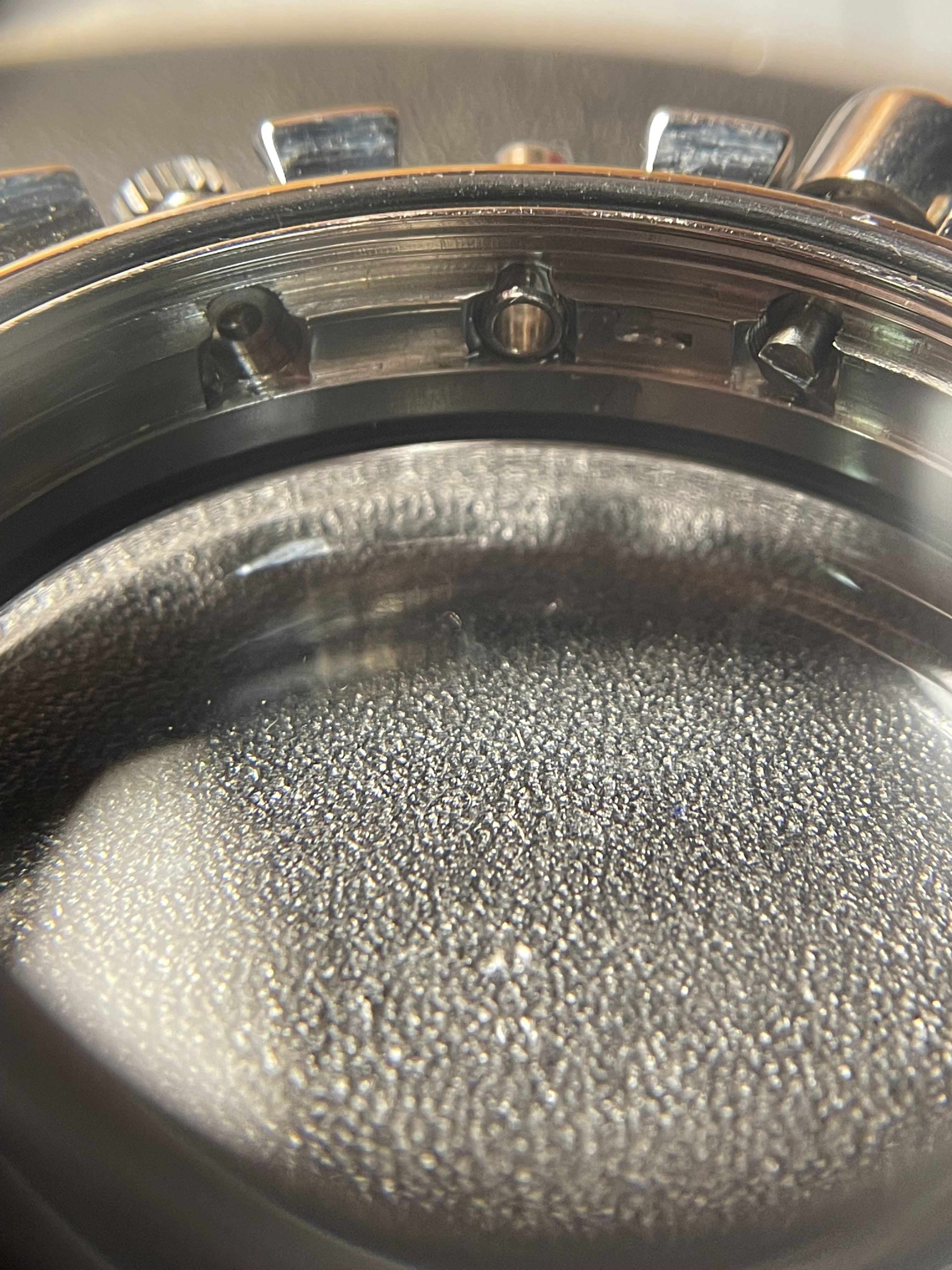

Following up on @Archer observations about these cases i handled one today, it came complete with bezel, pushers and movement ring sold as geniune from a reputable seller in EU, and it looked very very good. But i was concerned anyway as i found some damage on a listed as new case.
Here is what i found.
The caseband on the left side has a non fluid trajectary on the polished bevel lower end, like an almost inward angle, and is to thin compared to my Speedy from 2000`s . Hard to photograph but i gave it a try.
The easier tell is from the case back, if you look at the spacing in the word Mission you will see a gap, cant imagine it would have left the Omega factory like that. And the inside laser etching looks very thin to me but i have no good comparison at hand.
I found several listings with this on ebay and C24, but hard to see on some shots or not shown at all, and i only noticed it after i had one in hand and knew what to look for. Same as with the small "insert" in the body of the Hippo - to large and angular maybe ? The pushers looked good with a sligthly domed top, but i could not see any soldering with a loupe on the inside tube, it could be these are set with Loctite now ?
Anyway, bummer as these are out there and can fool most if not inspected seriously, and of course this case is now returned and seller informed.
If I look up the case on the Omega Extranet...the case specifications include this:
SOLDERED TUBE : Yes
1,910
3,682
SOLDERED TUBE : Yes
Good to have a computeh ! Loctite on the fake one that is 🙁
