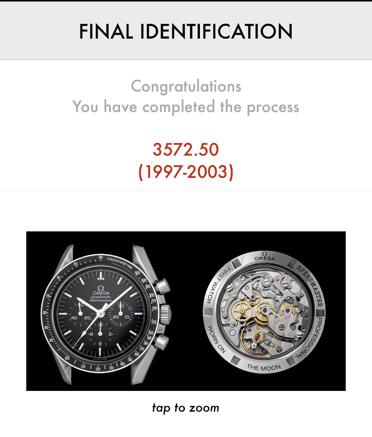

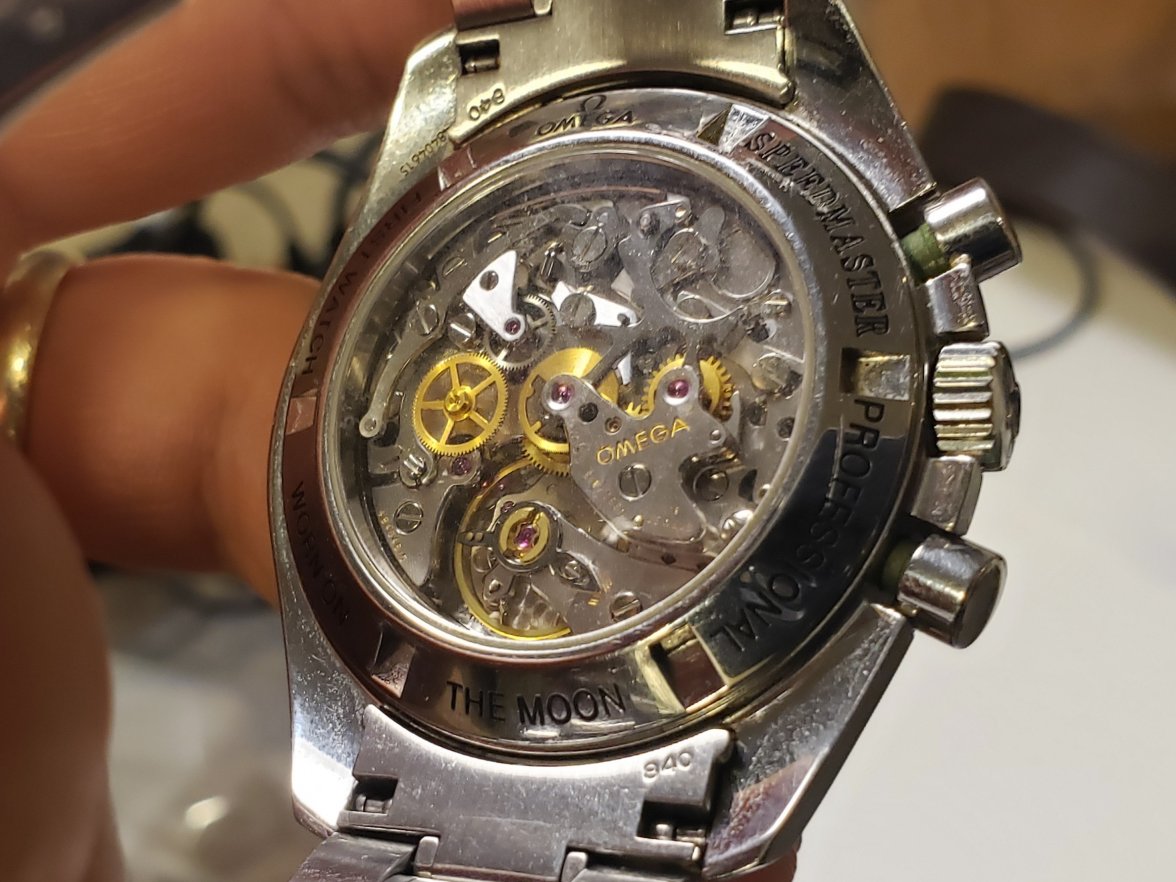

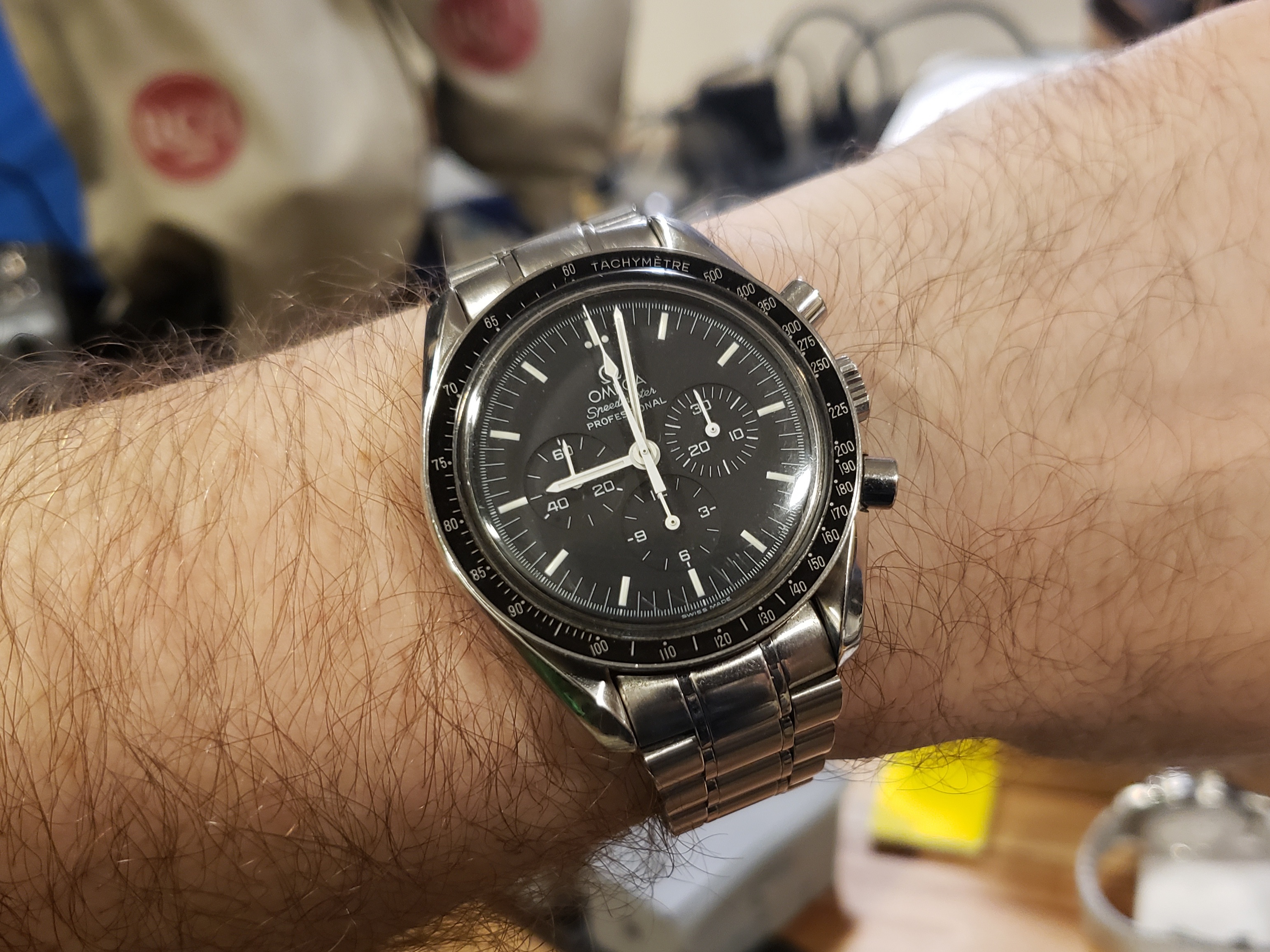

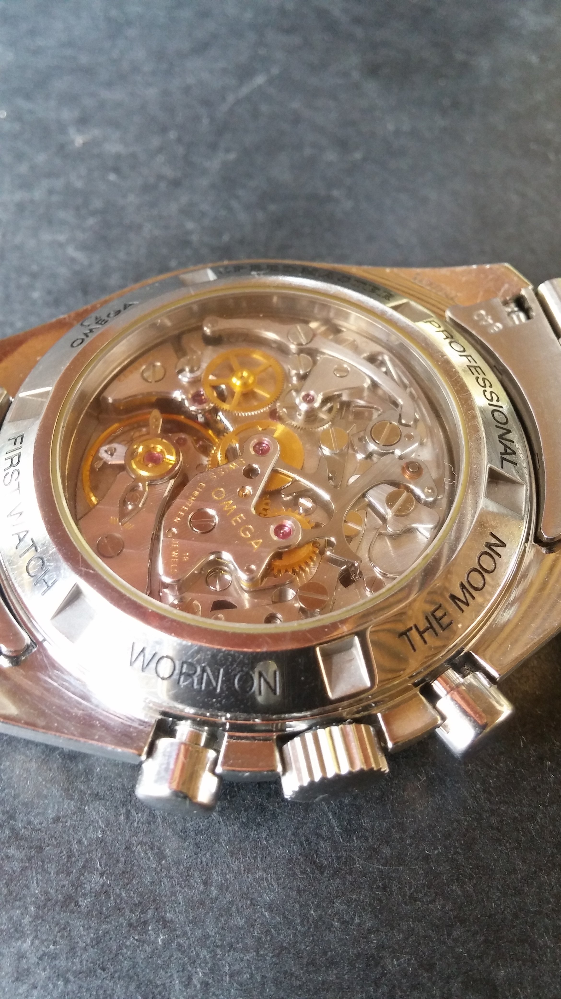

Hey everyone! I'm a Speedy and Seamaster collector and this one has me stumped. I'm being told by an authorized Omega service shop that this ref. 3572.50 "Hesalite Sandwich" cal. 1863 Speedmaster is a clone. The serial number I believe dates it to 1999, and for some reason is not in Omega's database (I double checked with the Boutique). I'm told this happens from time to time with older authentic watches, but is rare and the first red flag. The AD's shop also said that the watch has some innacuracies for an authentic watch, compared to the current issued Speedmasters. I don't have a list from them but they mentioned the caseback writing is missing the word "The" and the case thickness looks different.
I own several new and vintage Speedmasters, I've sold several brand new and lightly used Speedies for years. I purchased this one from a reputable dealer, and he is just as shocked as I am. He has offered a full refund if I get documentation that it is not authentic, but we're both extremely surprised. If it's a clone, it's the best I've seen or heard of. Any thoughts?
(Apologies for the smudged photos. Will be taking more photos once I get the watch back from the shop.)

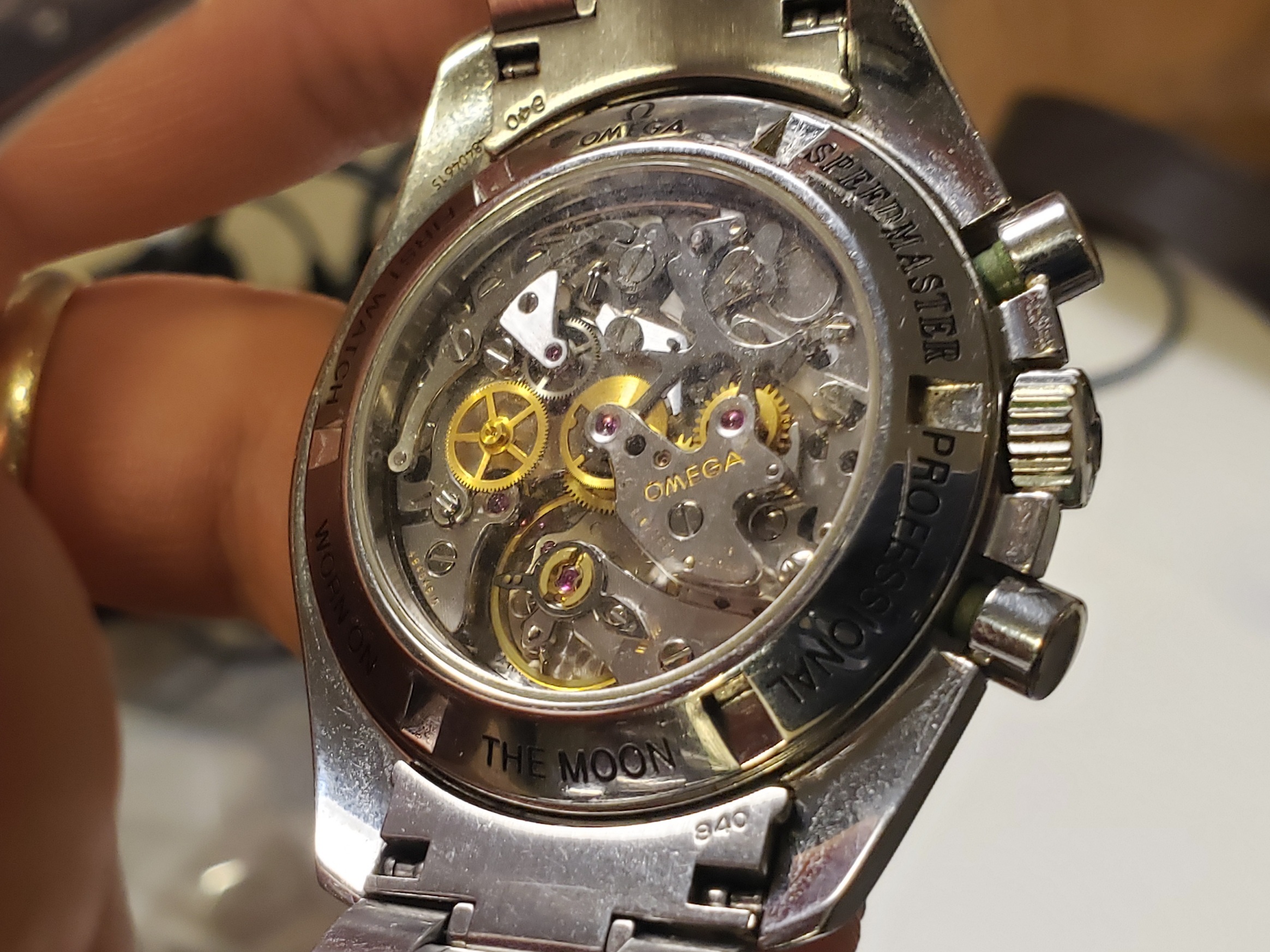

Movement looks genuine. Caseback isn't missing a "The". I doubt it's a fake. Anyway, why is the inside of your pusher green?

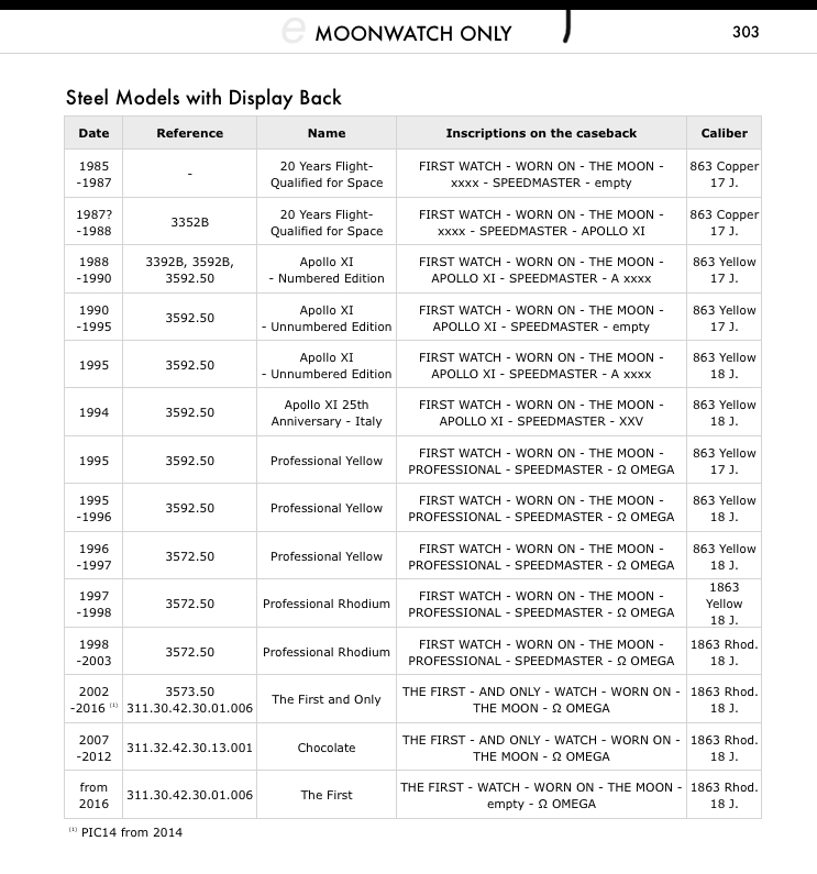

I have the same model as you, which I’ve owned for 20 years. Yours looks correct to me, assuming the movement finishing is visible. The ADs comment about missing “The” from “The First Watch Worn on The Moon” is incorrect for this reference, Moonwatch Only confirms this as per the pictures above. From my perspective the see through case back does makes the watch appear a bit thinner than the standard model, though I do not think this is actually the case, it merely appears that way due to the see through case back.

All looks fine to me. Will be surprised and concerned if they are being cloned
It's some shmutz. It comes right off if I scrape it with a toothpick. I've seen it before on other vintage pieces that haven't been serviced in a while.

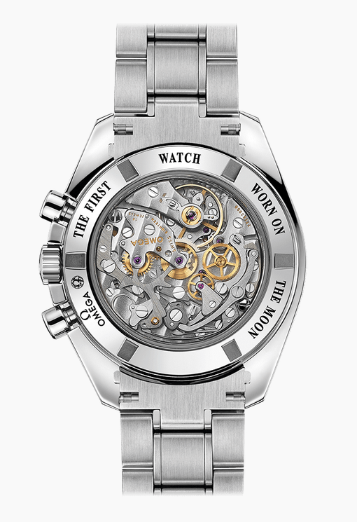

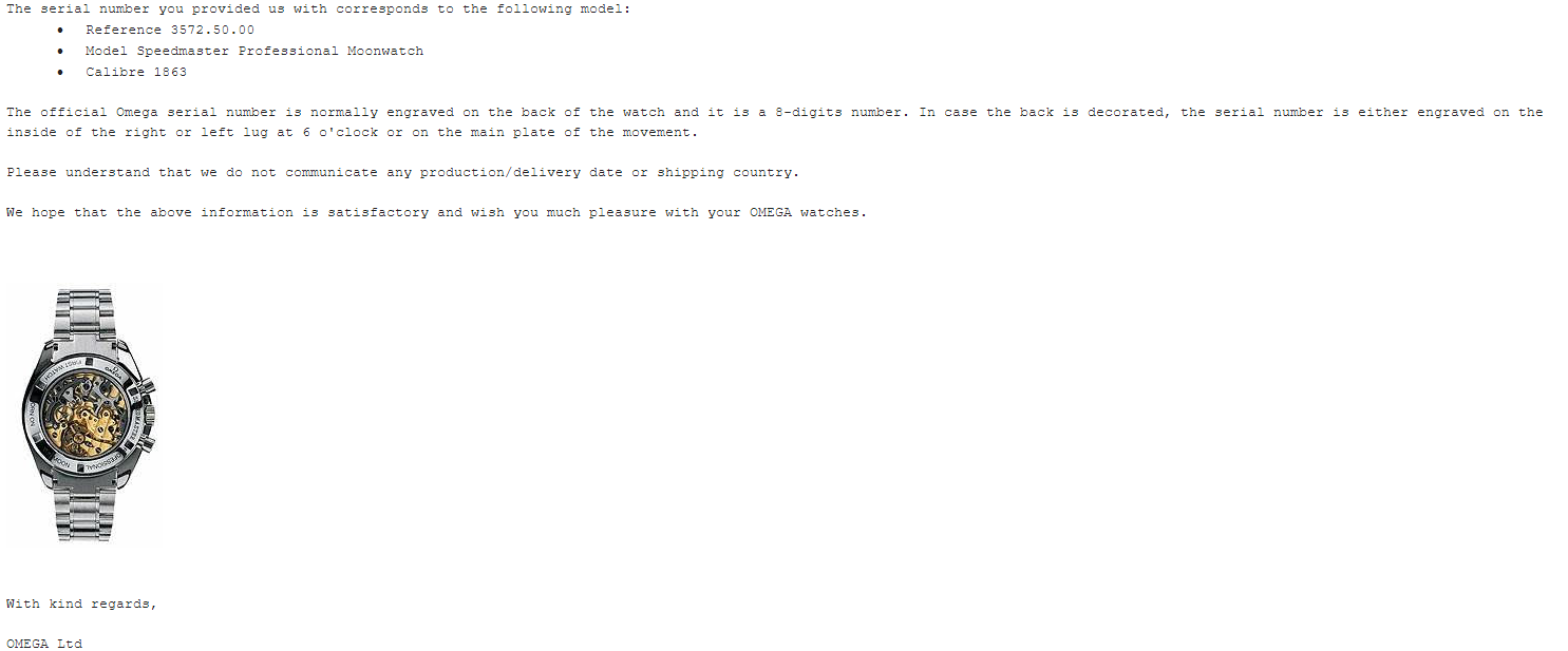

I got this response almost 20 years ago from OMEGA Switzerland. I picked up my watch from a yard sale in 1999 !! $150.00 I gave them (Omega) the serial number . It had Hesalite crystal on the face and the Sapphire back. They only made them for a few years and I found that the common switch was to put on a display case back on a regular Speedy . You cant switch out the crystal to hesalite from sapphire. 1863 movement is rhodium plated and NOT copper colored. ( they sent the wrong photo below ) but Omega verified that mine was the real deal when it went for a restoration years later. It now looks new but some of the Rhodium glitter is gone from mine but my gold lettering is crisp ! BUT I dont see much Cote Geneve on your watch (another poster Nathan1967 ) did a great job in providing that detail). It does look like a lot of the GOLD lettering inside yours is gone though The serial number on the lug should match the on on the bridge. ( visible through the display back )
Did you look up the serial number on line ( chuck Maddox has some ranges of S/N )

Gold lettering and Geneva stripes are all still there, just a bad photo. When it gets back I'll take a better photo with the back off.

That is a year 1999 production Speedmaster and it looks legit enough for me too.

Your AD is an idiot. Take it some place else. I mean, to accuse a customer of having a fake watch rather than considering the possibility of there being an issue with the database THEN providing incorrect information about what text should be on the case back. The thickness is off because they used to dealing with plexi and solid caseback OR sapphire and display case back. The plexi and display case back is a slightly different thickness to both of these.

current Sapphire for reference.
