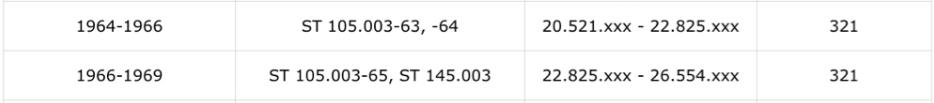

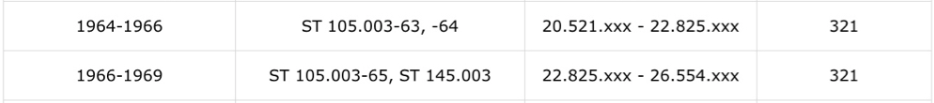

isn´t the serial 25449741 far too high for a -64 ?? I would rather expect more like 20 - 22.xxxxxx
4,106
16,321
It is. And that's why my main theory is complete put-together.
Still, outliers aren't impossible... an old stock case used to assemble a watch in 1967-ish like I wrote above and here we are.
