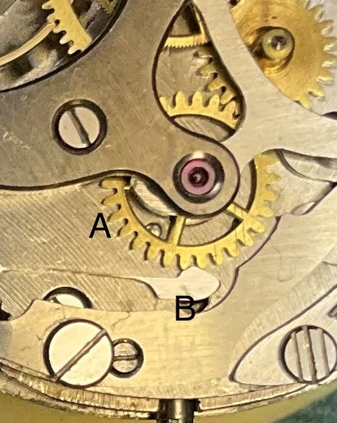

The image is of a different movement to yours, but it may give you an idea of the minute recorder wheel, and the index that holds the wheel in place. It indexes only once per minute while the watch is running, but it remains as shown at times when the chronograph hands have been zeroed, or, as in your case, when the chronograph hands have been “parked”, but not zeroed. The index is on a very tiny spring which could be nudged, allowing the minute recorder wheel to advance. The minute recorder wheel is at A, and the index is at B..

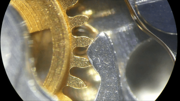

This is the minute recorder on a Speedmaster, showing the jump as the minute counter advances...

Peanut gallery chiming in here. If that “index” is the only thing holding the minute counter wheel in place when not in a fully reset state, wouldn’t the watch be susceptible to the same issue while the chronograph was running? Or is there something else going on when the chronograph is running that would prevent a shock from accidentally unlocking the wheel?
30,185
77,932
It can happen when running also.
