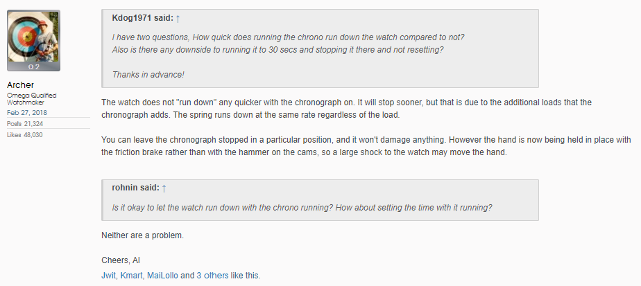

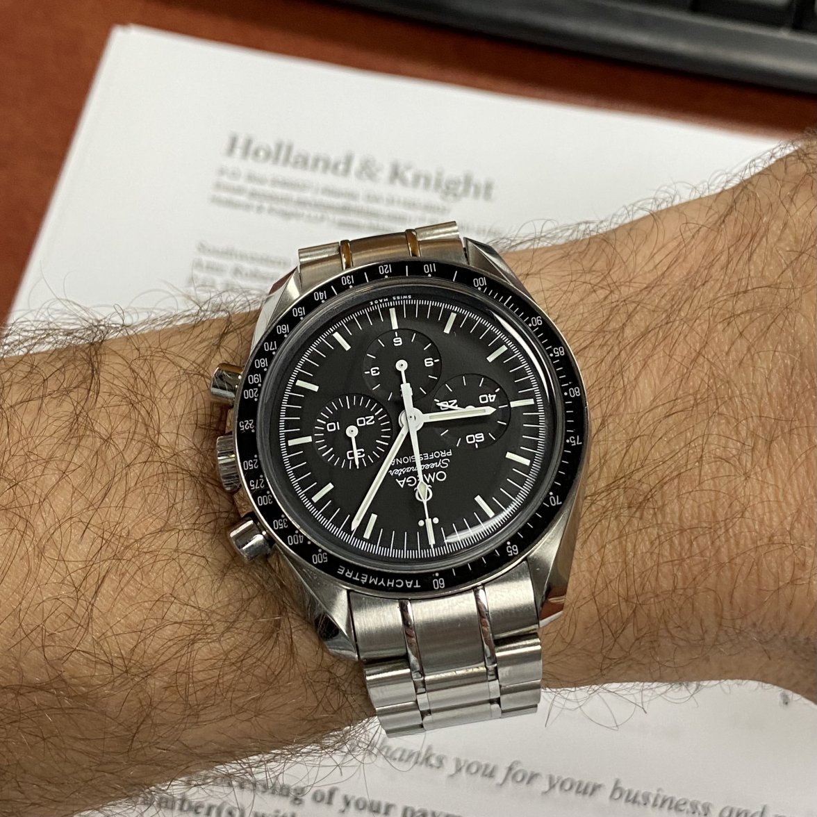

I normally keep the chrono hand ‘parked’ at 6pm like this (so that I can see the Omega logo etc). I assume this doesn’t cause any extra stress or wear but I wondered if anyone knew?
this is the answer you're looking for:
108
81
Thank you, that’s most helpful and good to know.

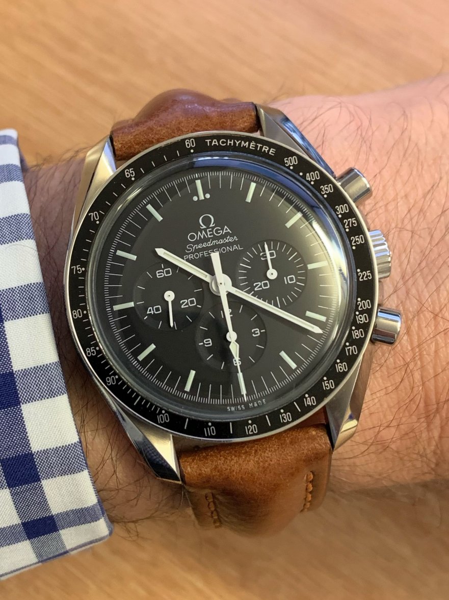

Cheers
I can’t add anything to your question but who makes this strap? It looks great

I think the second hand looks weird stopped at 6.
Same here, don't know why one would want to see the Omega name and logo without the thin hand in the way. I also don't see the sense of keeping the chrono running so the wearer can see it moving. To me the chrono function should be ready to go when a timing requirement occurs and not requiring a reset of the chrono before use. But everyone has their own quirks.
