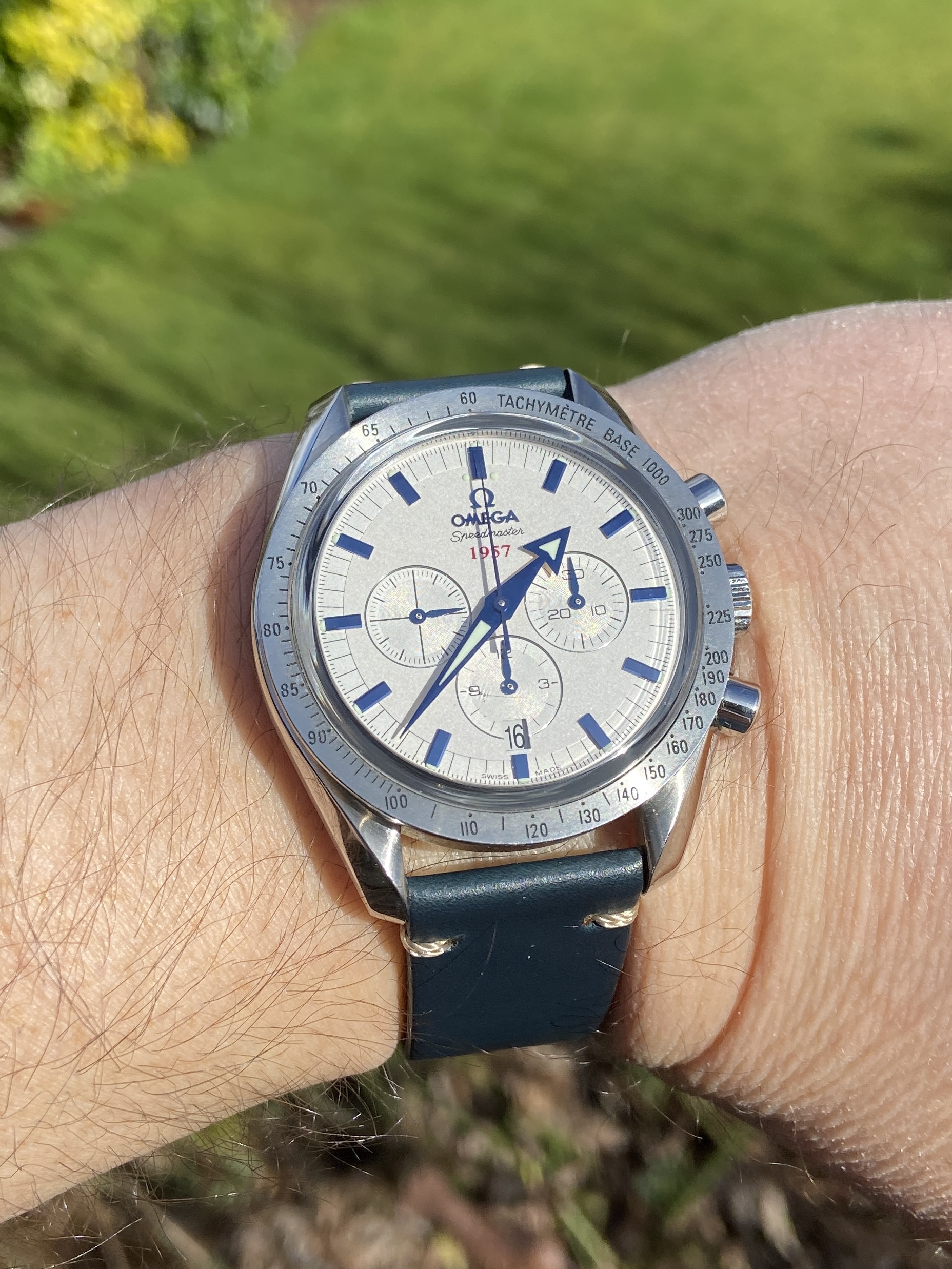

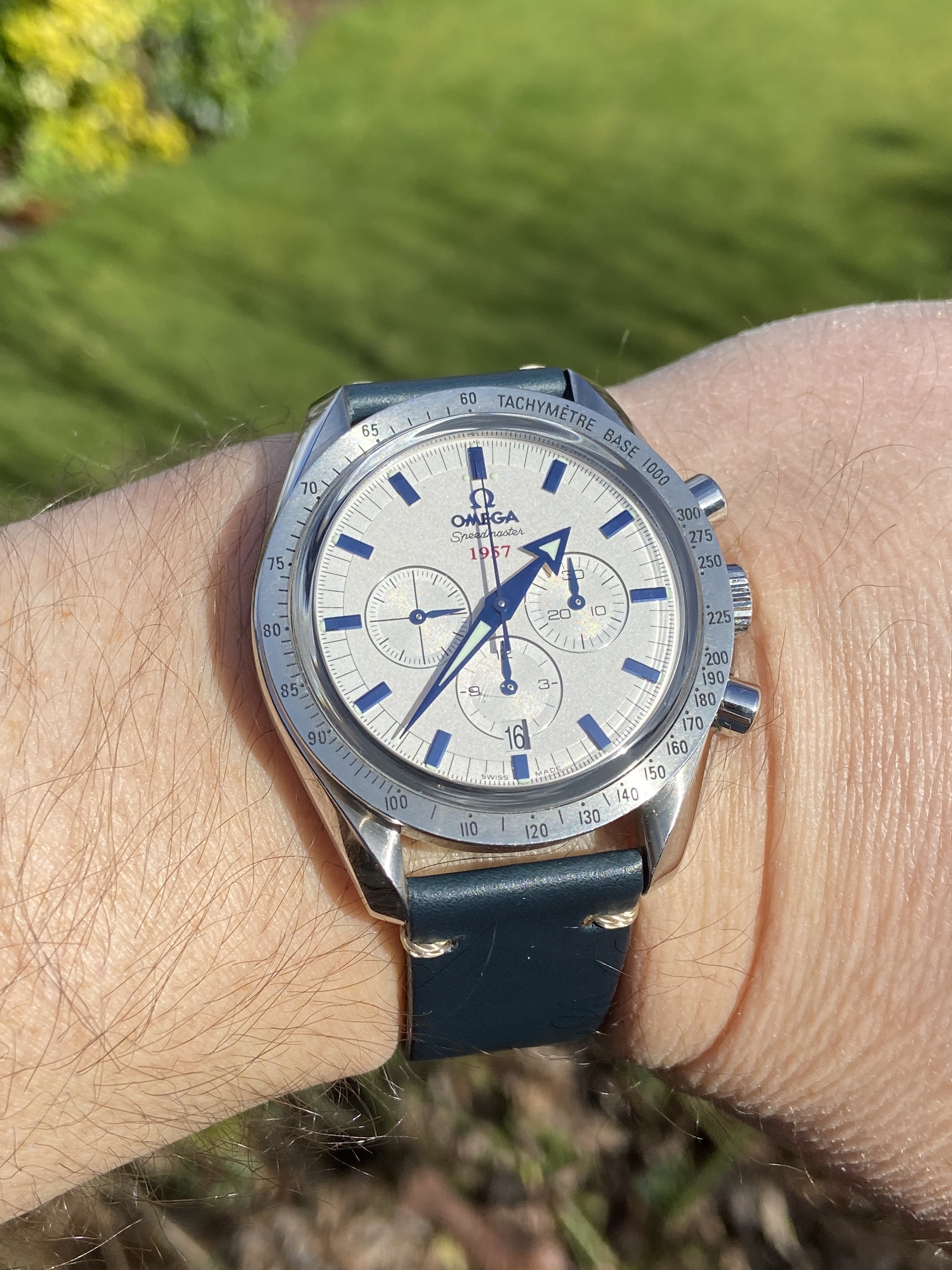

Mine is the slightly later 3313 co-axial version, shown below. I am wearing this today in fact. The earlier 3303 movement model you refer to has a white or cream dial, this one has varying silver finishes so changes in look as the light catches it.

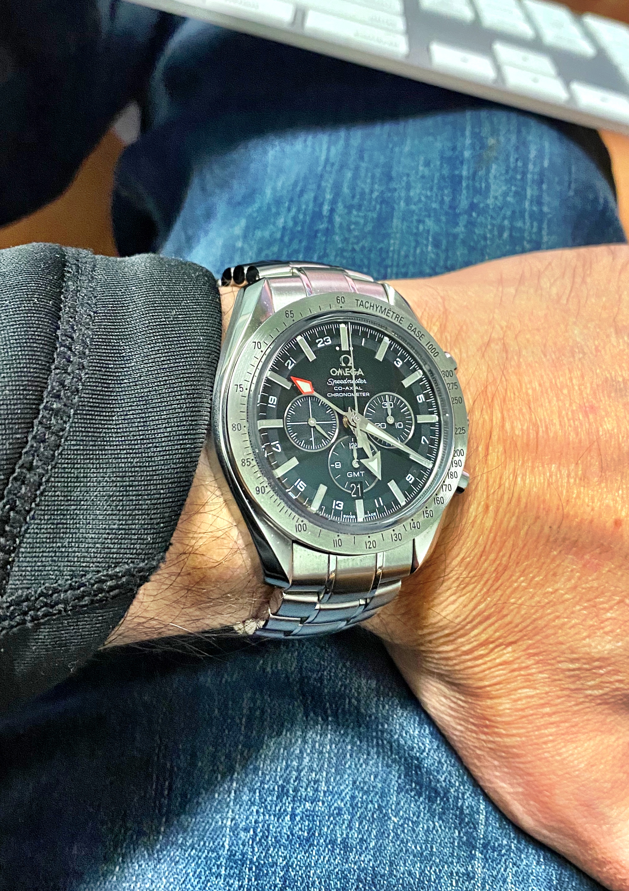

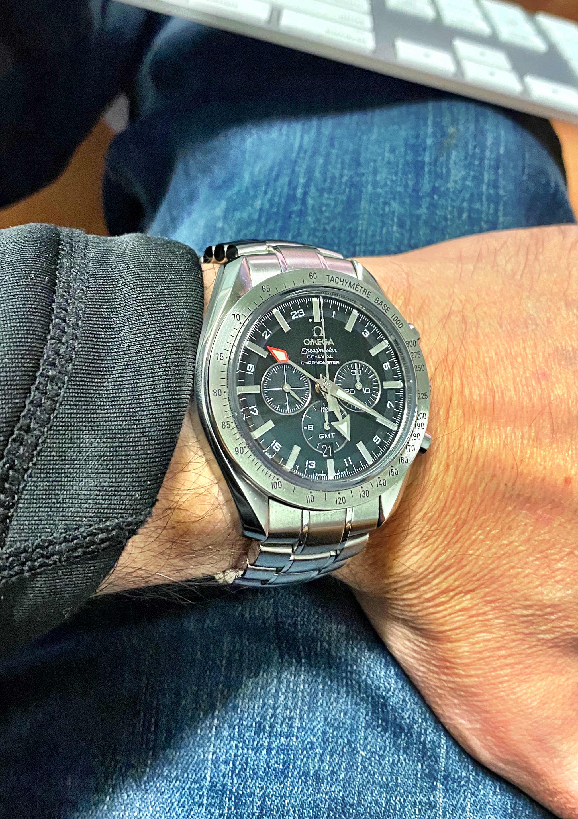

This is my Speedy BA GMT. Liked it soo much I bought it 2X. Won't let it go again... Model 3581.50.00

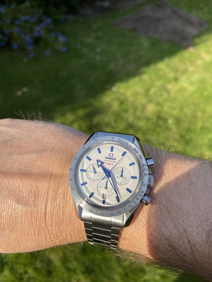

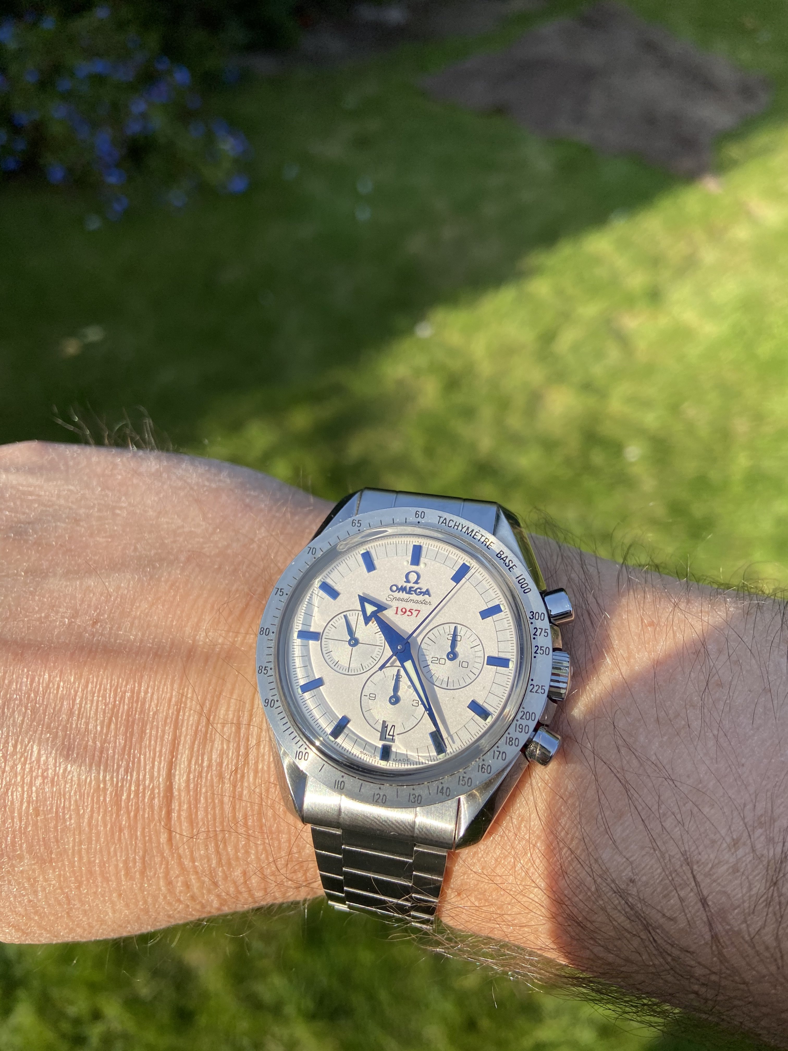

Love my 3313. Butter smooth and a joy to set and wind.
