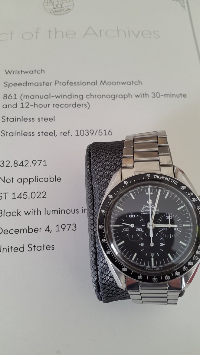

So are we in the general consensus that this EOA is indeed incorrect? I guess this would also rule out the 1039/516 coming standard on a ‘74 145.022 delivers to the US?
Thanks for all the knowledgeable replies guys!
5,861
16,791
Not at all. It should be presumed correct.
Your terminology is a bit of the isssue. When most of us refer to a ‘74, it is the reference year. So a 74 is a
145.022-74 which was produced starting in 1975. The extract shown above is for a 145.022-71 produced in 1974 with a 1039/516 bracelet which make perfect sense.

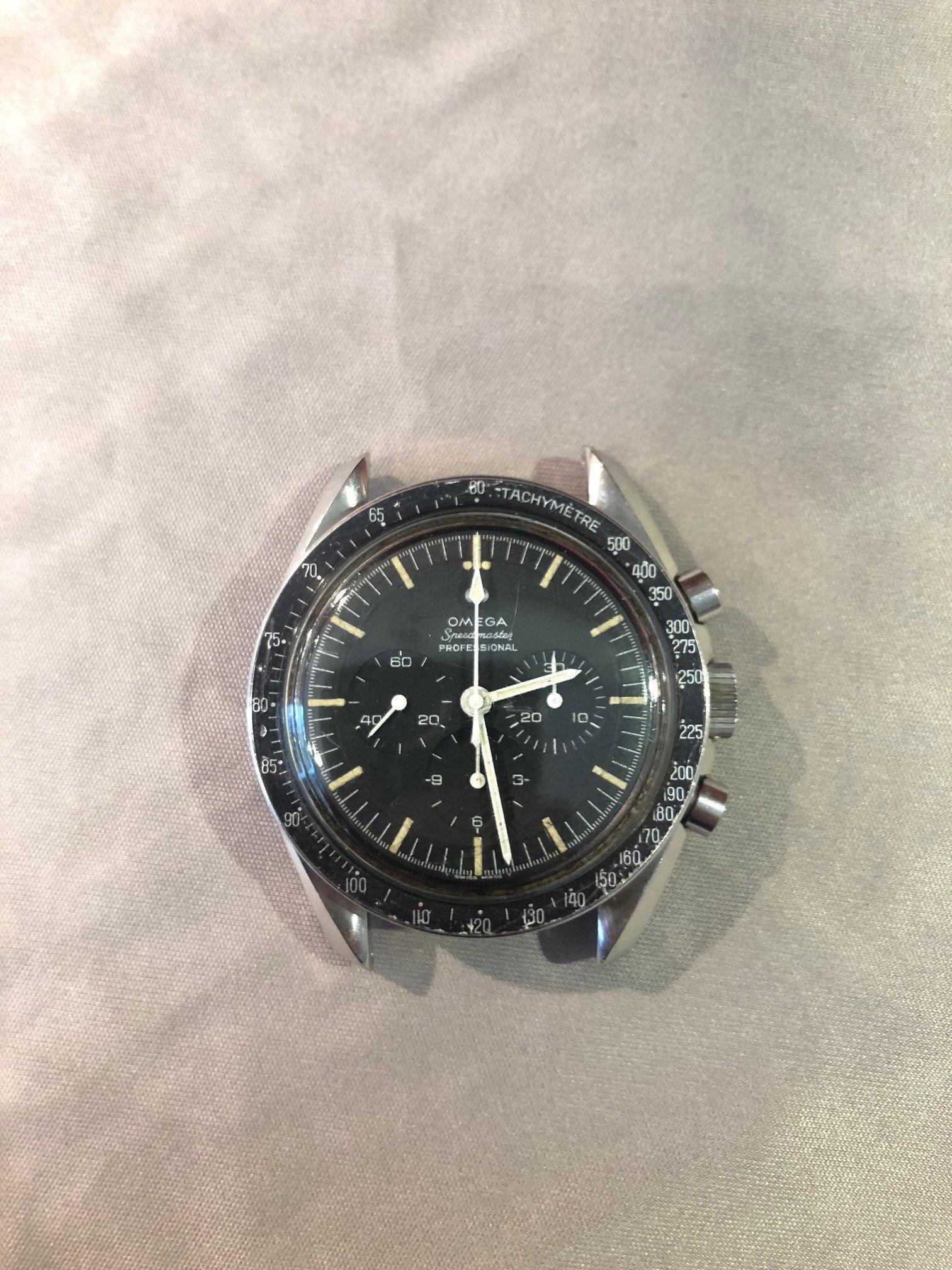

Hello
I'm looking for a bracelet for my watch s105.012-65 hf. Preferably 1506 or 1039 or 1035. Does anyone have it?

The more I search the more extracts I am seeing with the actual bracelet type specified.
I am still waiting on my EOA for my 145.022-71 (Prod yr 74) to arrive to see if it mentions a bracelet
The below pic shows a 1039/516 on a late 145.022-71 (Prod yr Dec, 1973) so adding feasability to a 145.022 produced in '74 with a 1039 bracelet.
(Picture Source - Banner Roar)
