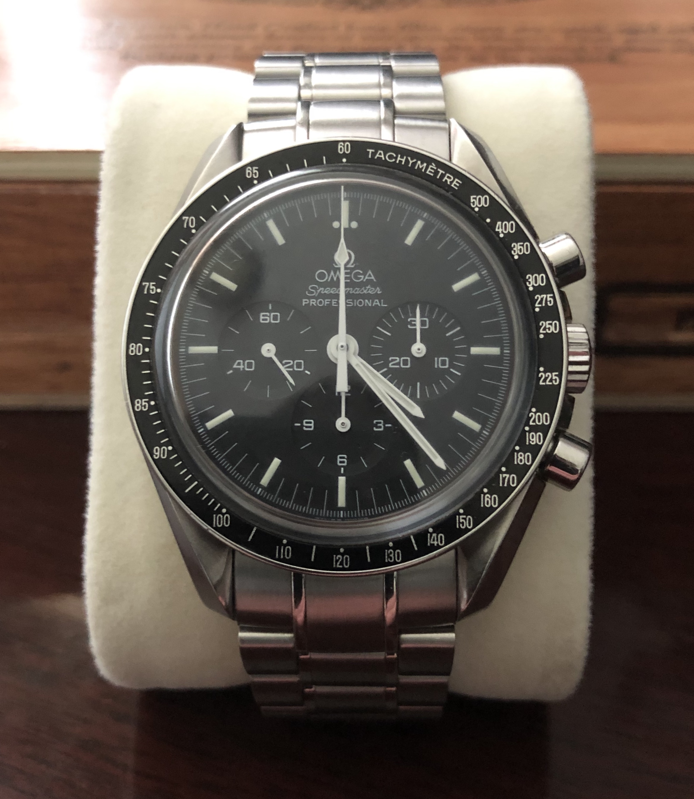

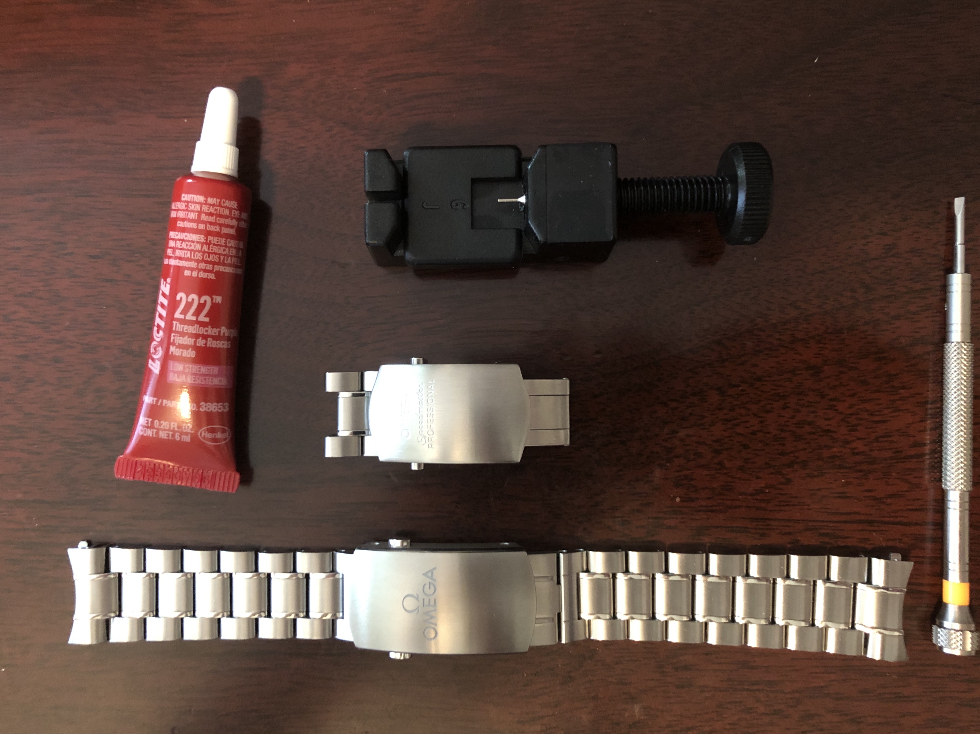

Just finished this modification. Took my time and managed a zero-scratch conversion. I love having an adjustable bracelet already, especially in this climate.
