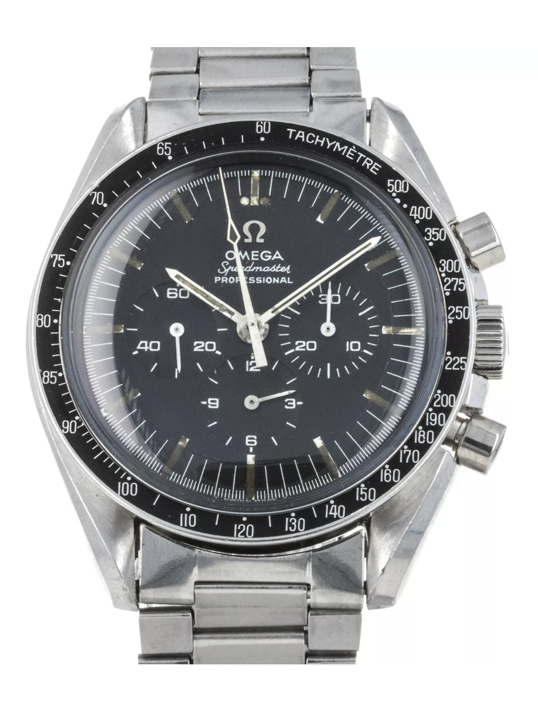

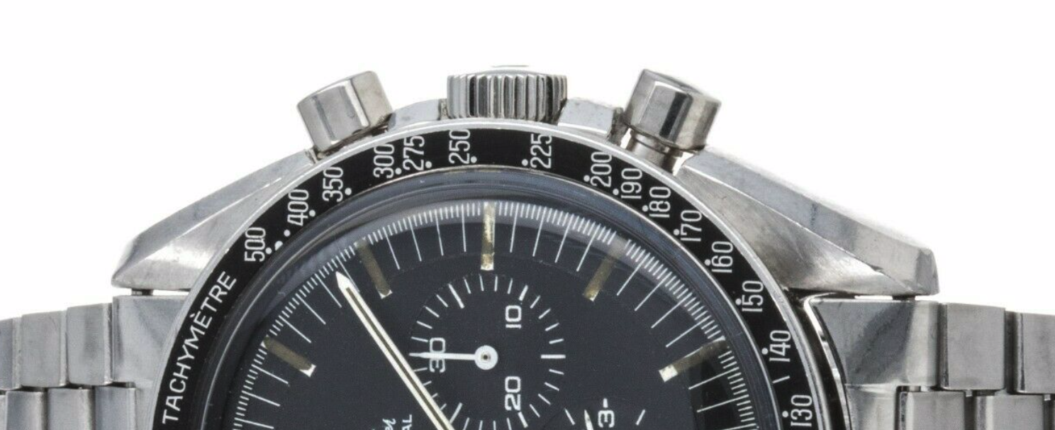

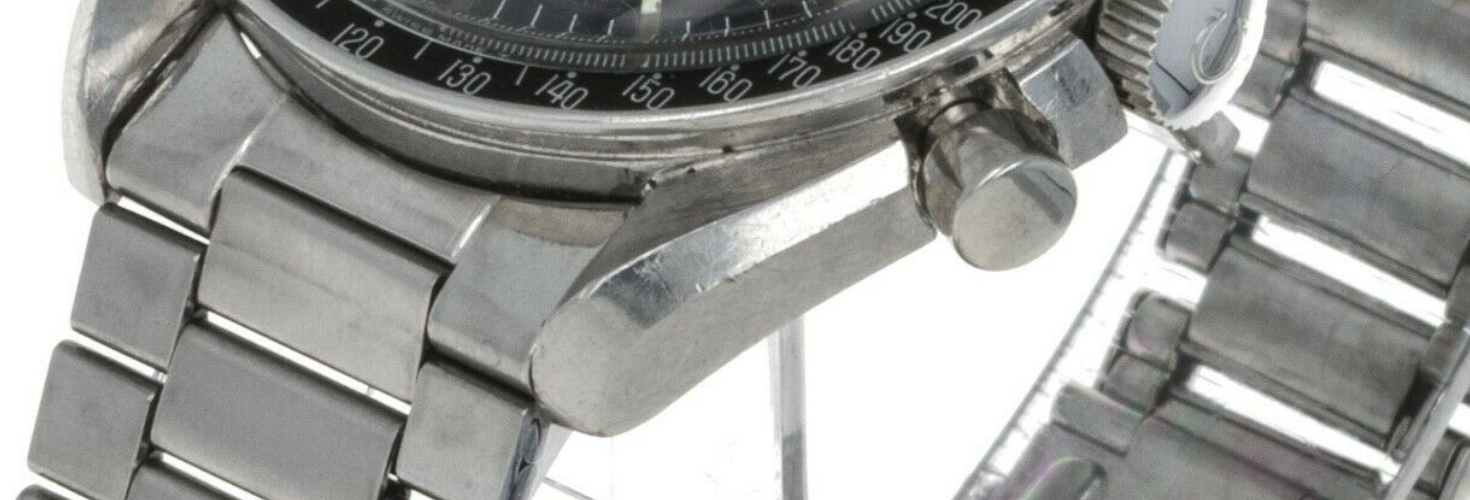

Was that a CB case??? Looks like the facets on the lugs were polished away.

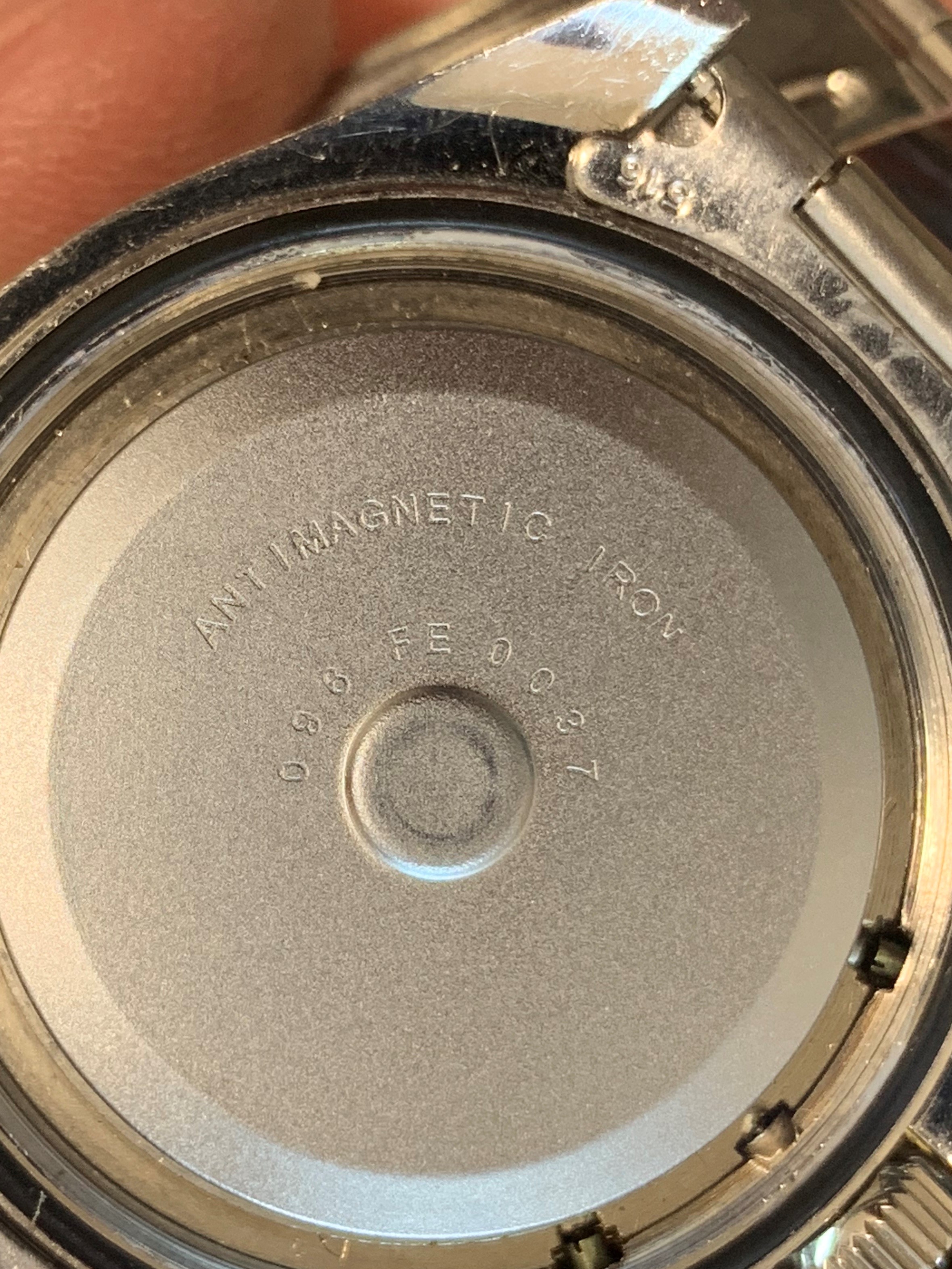

More photos needed -- case and movement.

Wrong sweep hand for a -66. Service crown and pushers. Are we absolutely sure it's correct? Can you show photos of the movement (with serial number) and the inside of the case-back?

needs to see more pictures. i doubt it's a cb66. looks generally ok though.

If it’s a 105.012-66, it’s got incorrect chrono sweep hand and pushers. If it’s a 145.012-67 or -68, then it could be correct but it all comes down to asking price - it’ll need to be relumed at the very least in order to appear attractive

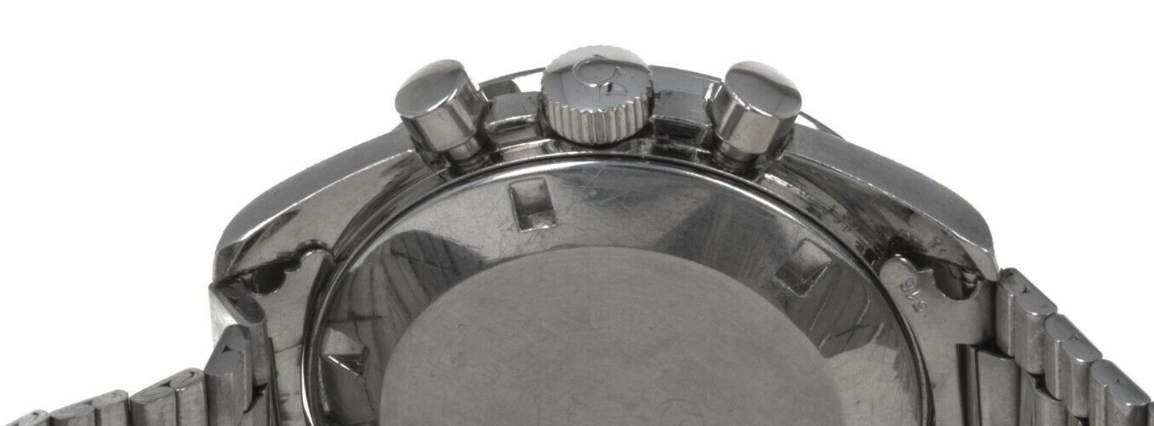

I think that may be a replaced caseback. The lugs, hands and pushers look -67/68 to me. The dial could be either since wide space Ts are seen on both. The serial seems right for both too!

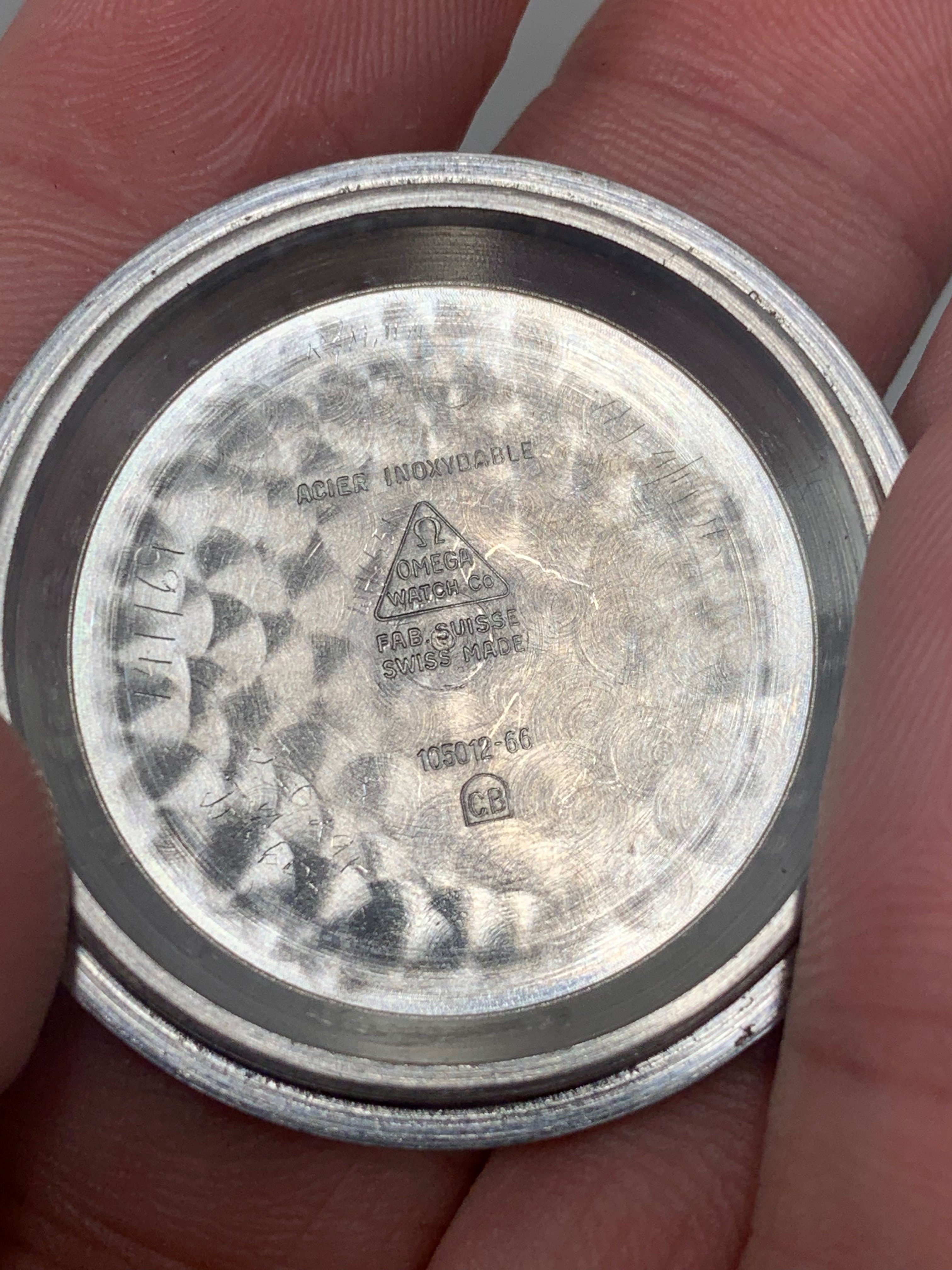

If this is your watch, you should order an Extract from the Archives to figure out the reference the movement belongs to. If it's not your watch, don't buy it. It’s a franken, and not attractive.

Regarding the lume, I agree, past my taste as well but will you be satisfied with relume? Isn’t it better to search for one with nice aged original lume?

There is an Extract. Dates to November of 67
Sorry if I missed that in your previous posts. The reference is 105-012 on the Extract? This would be useful information to include, so people aren’t forced to speculate.

Sorry I didn't think about adding that.
ST 105.012

here is one of the cover. I believe there were some variants of these as well.

As has been mentioned, the sweep hand and pushers are incorrect for a -66. The pushers (EDIT: I meant to write crown) and dust cover are later replacements. Importantly, the distinctive CB facets on the lugs are completely gone, if they were ever there. Obviously the lume is not appealing, to say the least. The fact that the lume on the hands is so well matched to each other, and to the dial, will make some of us wonder if this is not a franken, but there's no way to know for sure. It's definitely not a collector's watch and personally I don't see the appeal. But I guess you like the November 1967 Extract?

As has been mentioned, the sweep hand and pushers are incorrect for a -66. The pushers and dust cover are later replacements. Importantly, the distinctive CB facets on the lugs are completely gone, if they were ever there. Obviously the lume is not appealing, to say the least. The fact that the lume on the hands is so well matched to each other, and to the dial, will make some of us wonder if this is not a franken, but there's no way to know for sure. It's definitely not a collector's watch and personally I don't see the appeal. But I guess you like the November 1967 Extract?
I do like the extract but that is not the real value overall. That is why I posted here. My desire for a birth watch easily blinds me to reality. But you guys could care less in that aspect and have a critical eye to the reality of the time piece. I greatly appreciate that and that has helped me decide to pass. There may not be another one show up this close to my birthday, but I won't be too disappointed down the road knowing I spent a bunch of money just to scratch an itch that will go away.
