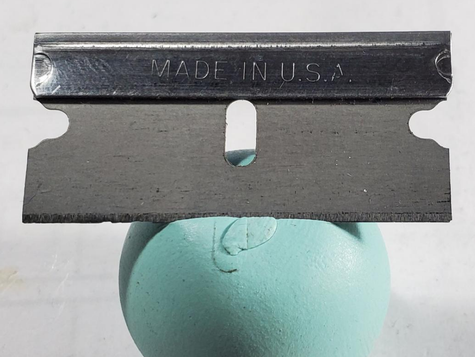

This is thinner. Sounds like you have no shoulders on your spring bars. I use this combined with pressure. Work it out a little bit combined with the friction from pressure to keep the bar from springing back into position. Good luck.
Be sure to tape the lugs to prevent damage when the bars spring back after they are free of the lug.
