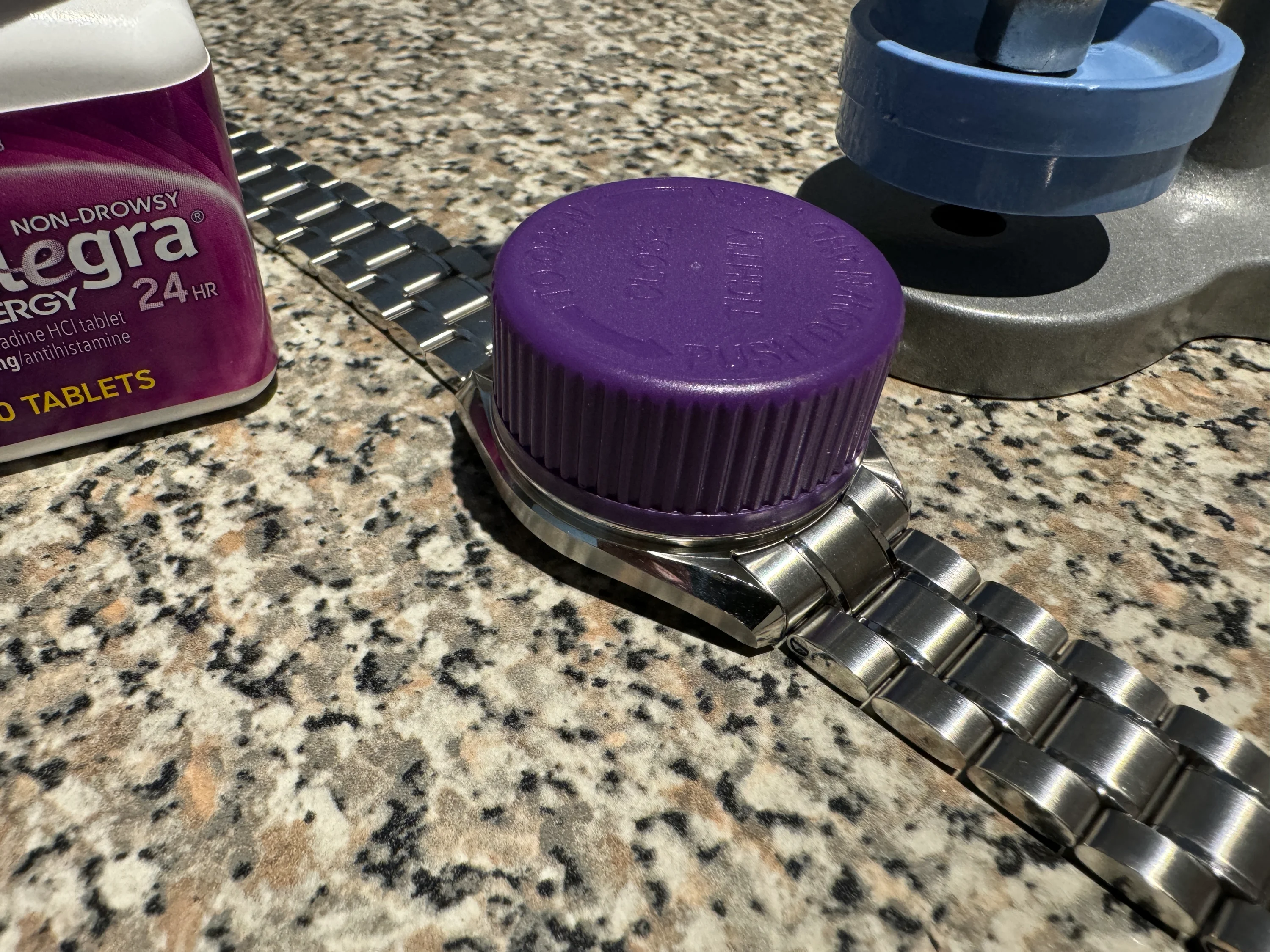

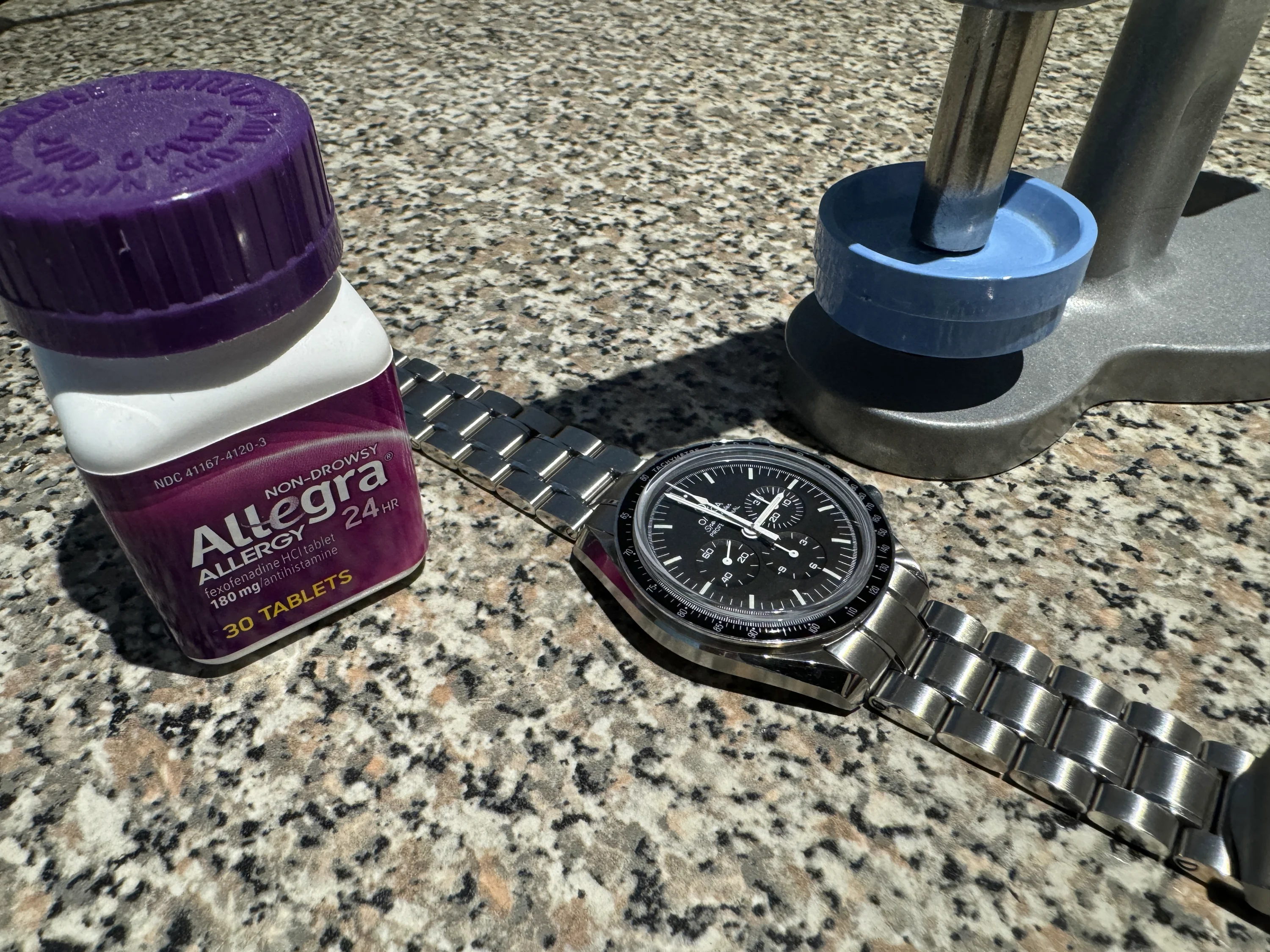

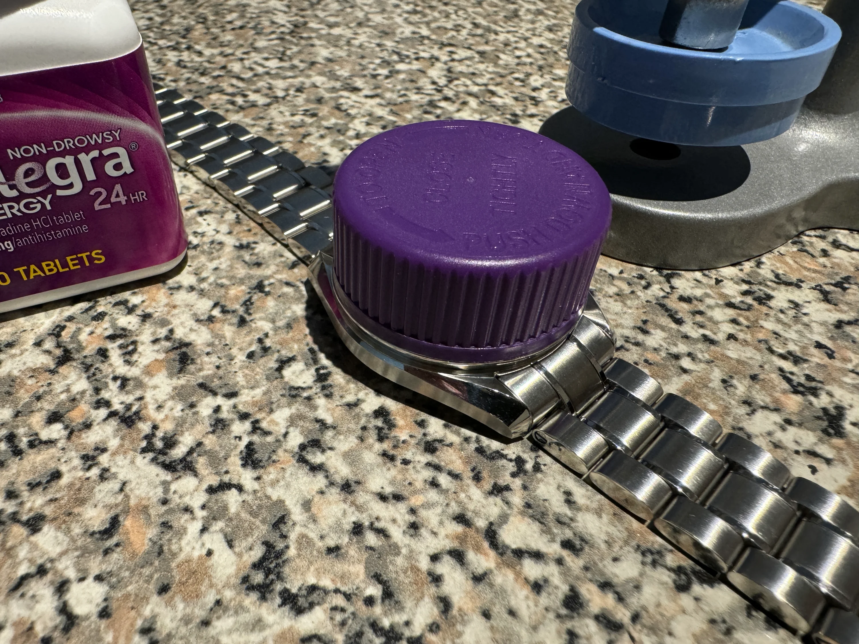

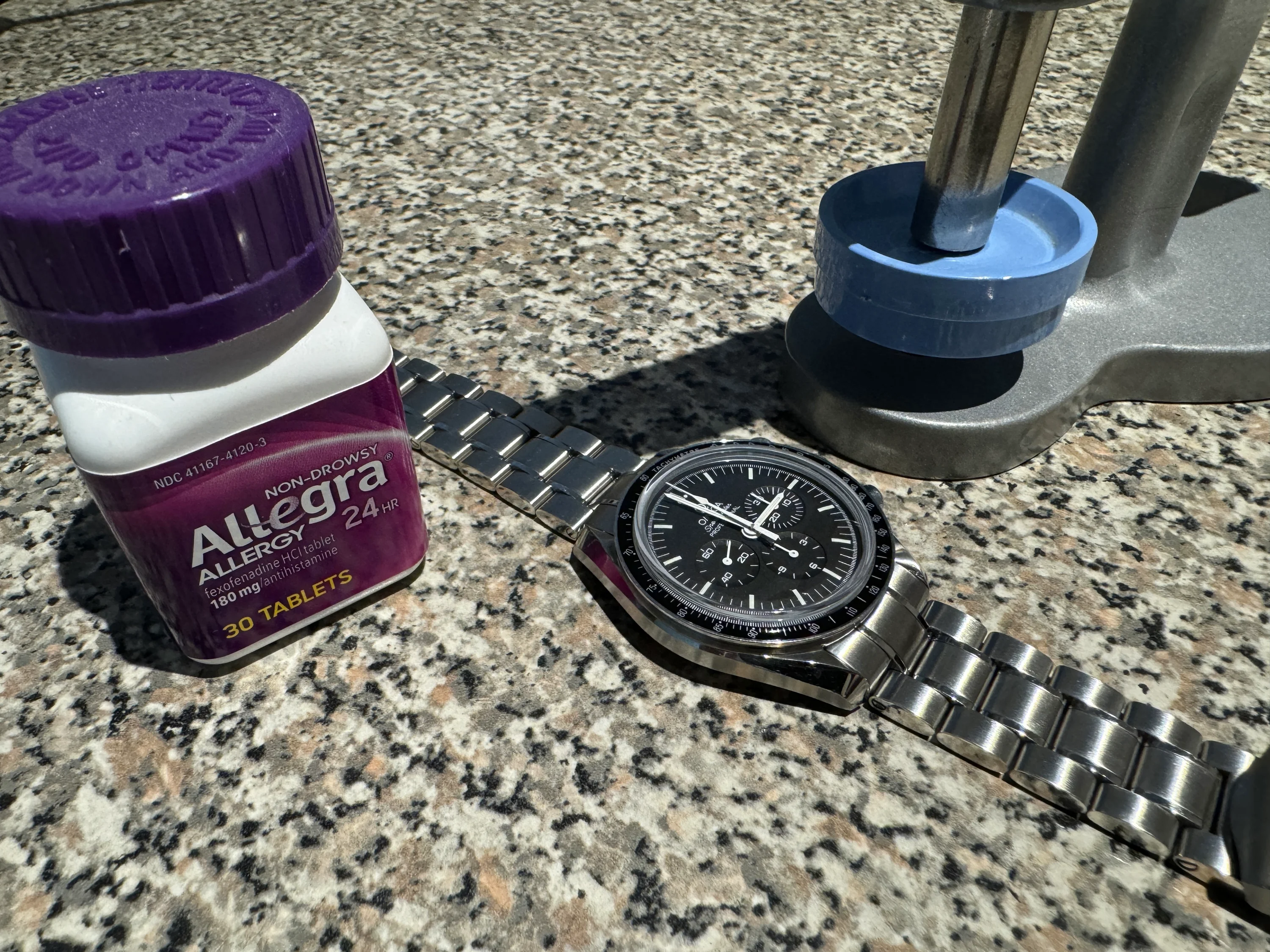

You have the right idea and it's very easy to do once you get the hang of it. A cheap crystal press works just fine, except the little circular dies aren't deep enough, so the hesalite or sapphire crystal usually ends up blocking you from pressing the bezel all the way in.
I happened to find a bottle of Allegra allergy medicine in the house and it turned out the cap is the perfect size for the bezel (30-ct-- I'm not sure if other qty have different size caps). You may need to unscrew the bottom piece on the crystal press so that everything fits before you press it in. Should be a light single snapping sound/feeling and doesn't take much effort.
Pro-tip: Use masking tape to hold the alignment of the bezel in place before preparing to press it on, as the bezel tends to shift during the process.
Good luck.
Meme-Dweller, I cannot thank you enough!
Speedmaster bezel back in place - there is no mistaking that sound, and just a gentle press was enough. I am delighted; what a relief!
