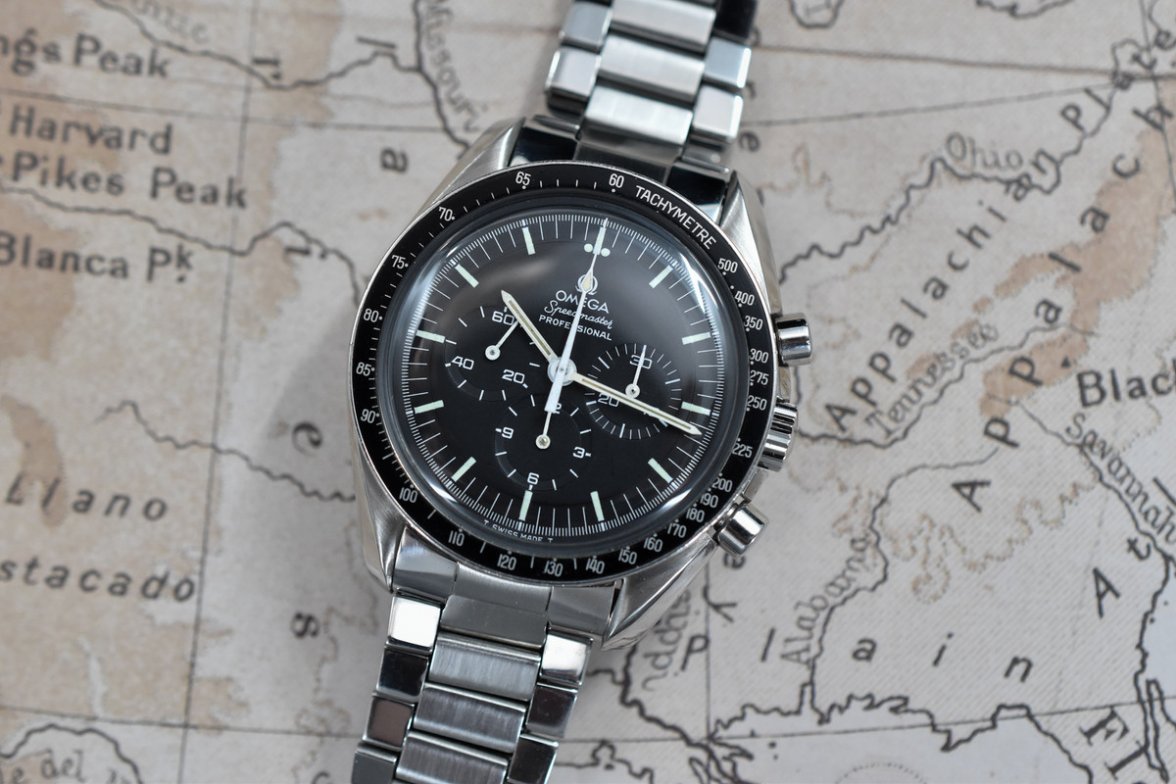

After I started with Seamasters and then Constellations, I am considering to buy a Speedmaster. I prefer a 145.022 or 145.012 and have read several articles and also bought the book Moonwatch Only. Still I am not sure how to recognize if some parts have been replaced during later services and if the case is polished or not.
What do you think about this one?

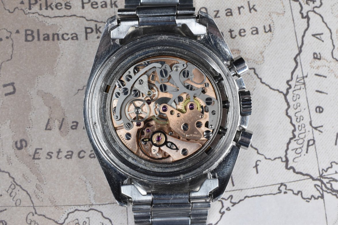

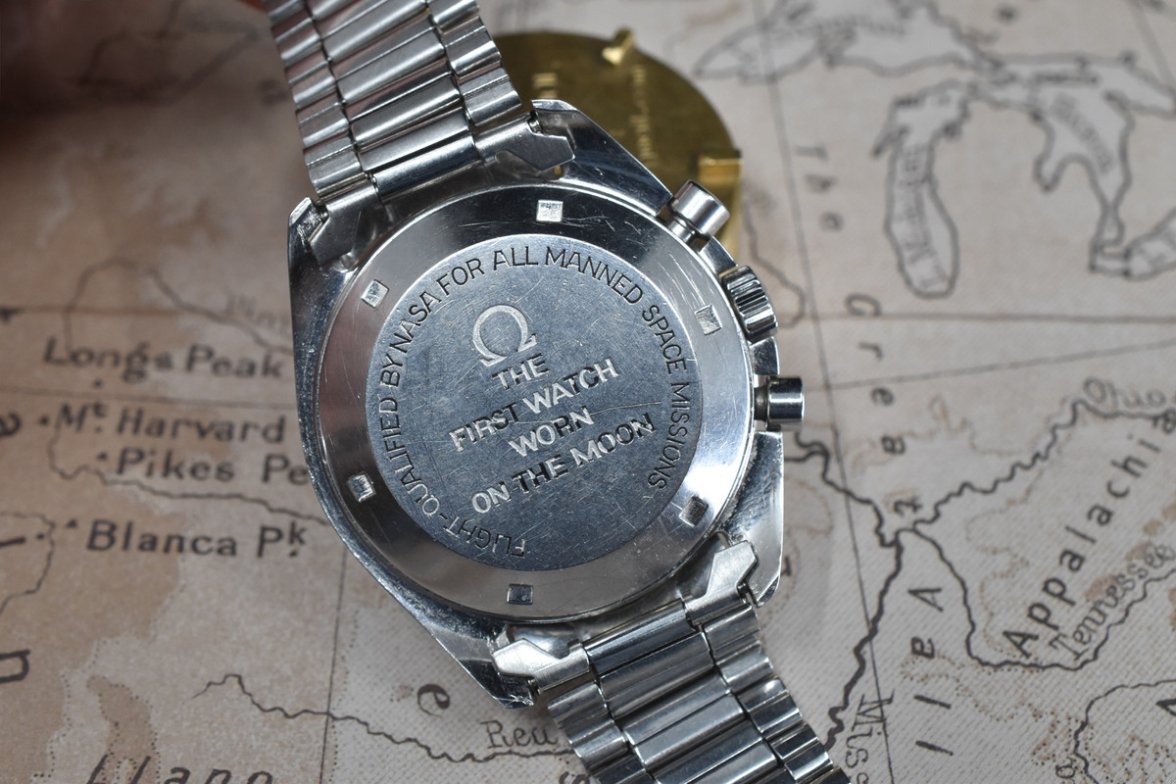

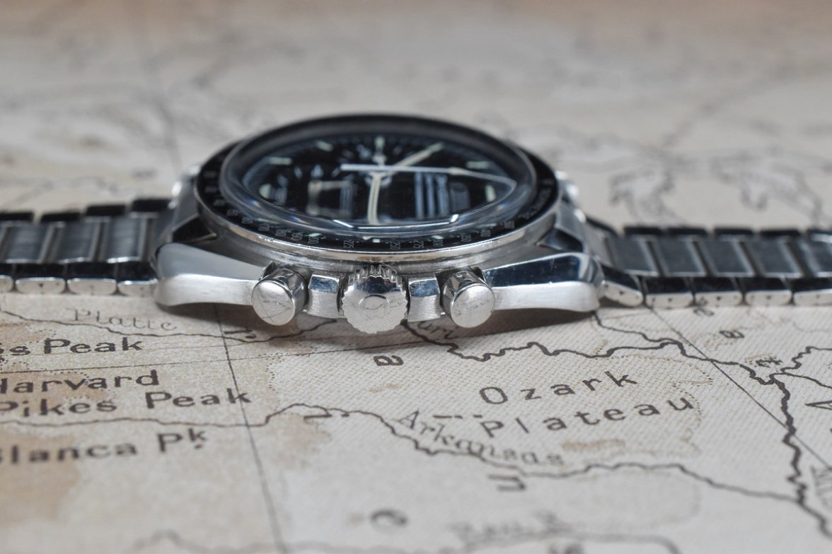

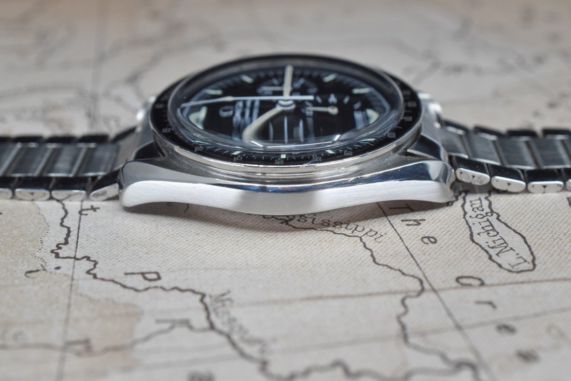

Yes, the case has been polished, and the brushing probably refinished on the sides. The crown is likely a service part. It's a bit hard to see, but I think I can see a step on the dial, so that's correct. What does MWO say about the correct serial number range for the straight writing case-back?
Not sure about the bracelet, maybe aftermarket or weirdly refinished. End-links definitely not Omega.

145.022-69 ST Straight Writing, this is next on my list 馃グ
A newbie myself still but are the bracelet end links origional? I only ask as I cannot see the numbers.

What @Dan S said. MWO says these go to 32.857.xxx.

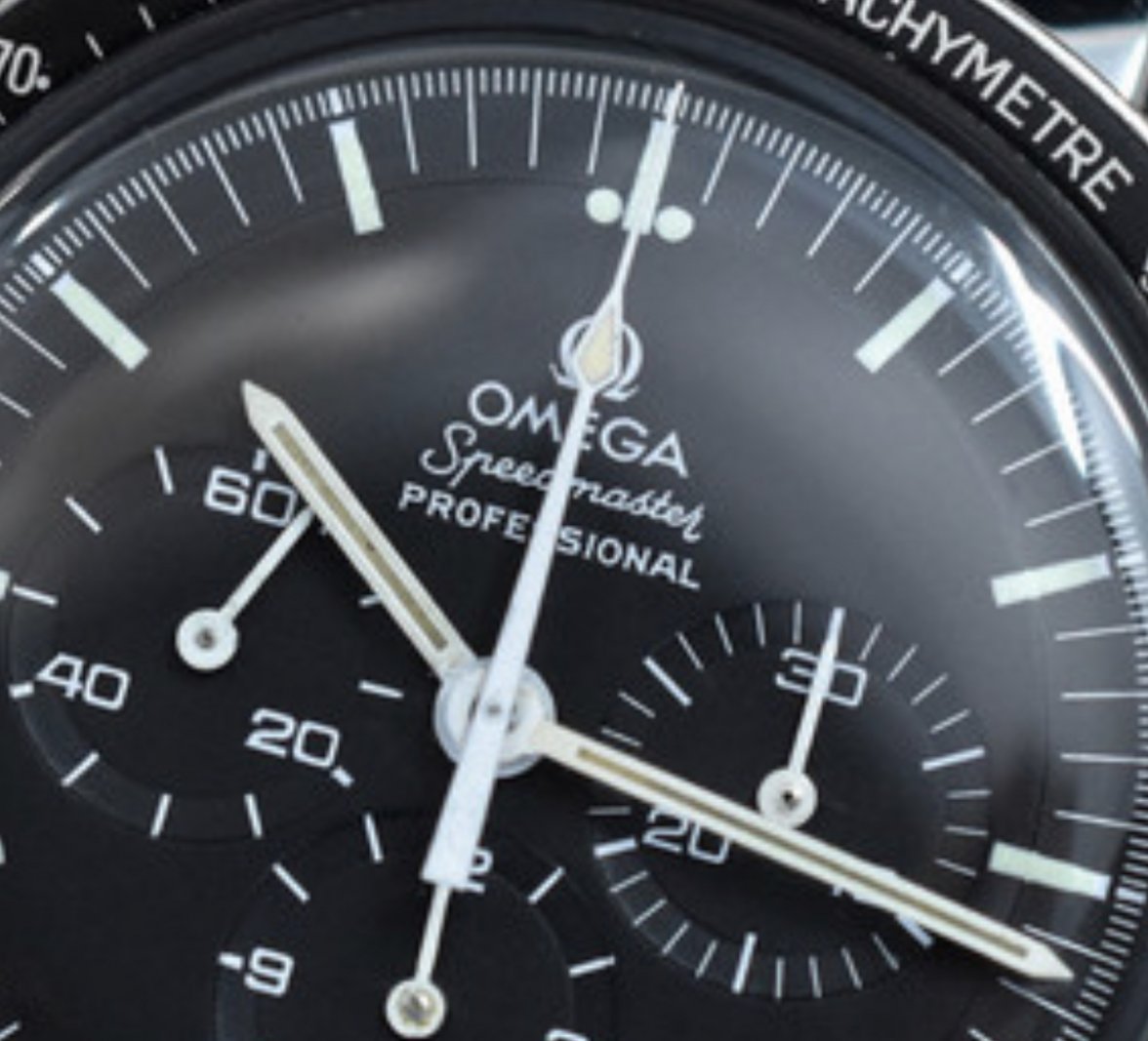

Plus, the lume colors are all different, which is disconcerting. The hands don鈥檛 come close to the dial (which almost looks like the lume has been scraped off) and even the sweep second hand seems a different color than the hour and minute hands.
Other than these things, it looks pretty nice.
