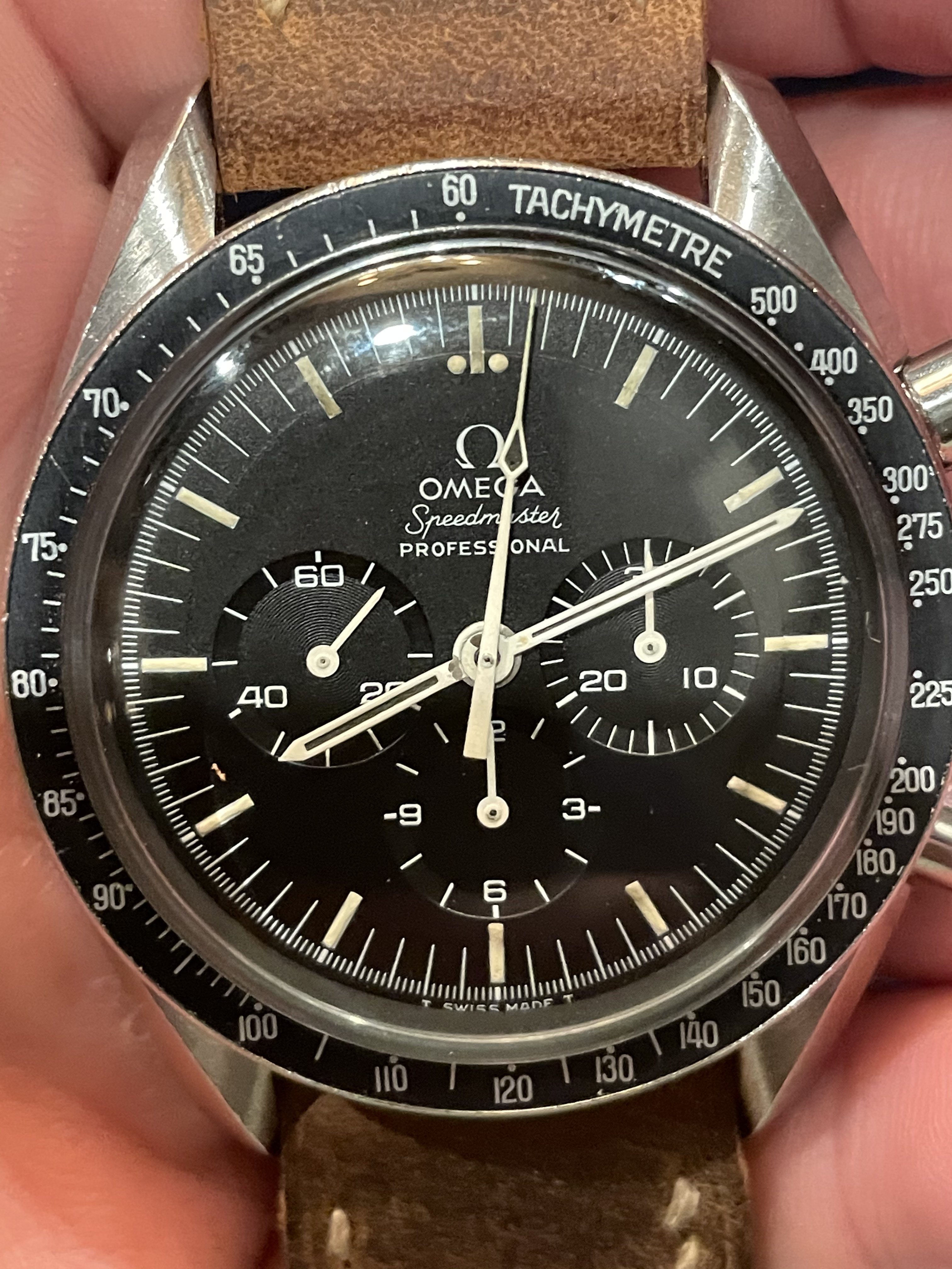

Just received my 1972ish speedy back from service and noticed 2 issues within days of getting it back.
The timing second hand is resetting more clockwise with each running of the chronograph. It maybe moves a second every 15 times I reset the chronograph... see picture. This is current reset position.
Also it’s now 18 seconds slow per day. It was 10 seconds a day before service. Was hoping it would be more accurate after...
Done at a local watch repair that advertised omega.
I’ve let them know about these issues and going to see what they say. Would you go elsewhere? Hate spending more money at a new place but come on.

The reason the hand is re-setting to the wrong position could be a couple of things. First, it could be that Te pipe that the hand sits on is cracked. It could be that the pipe itself is too loose on the pivot of the chrono wheel, or it could be the rivet that connects the pipe of the hand to the body. All instances are repairable.
it should definitely be more accurate after service but that is why warranties exist. Things can happen to cause a watch to lose time.
