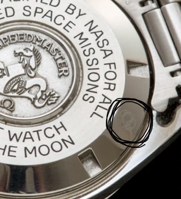

Just curious, but would opening the caseback matter at this point? It is modern caseback- lacking the serifs and has the globe engraving.
edit to add: if it was serviced by Omega, would they engrave the correct reference into it?
Ah I didn’t notice that. So the actual sub reference will be hard/impossible to determine.

I suppose the mid case could still be original (with a service caseback) but at this point does it matter?
1,586
6,837
It's an additional mark which Omega has added relatively recently. In this case, a clear indication that the case back is of a later date, making the identification of the exact reference quite a bit harder.
More details on this Globe logo can be found through a simple search here on the Forum. It has been discussed extensively, for instance here; https://omegaforums.net/threads/omega-aqua-terra-quartz-weird-omega-logo.29364/

- caseback : is not original (proof = ingraved logo )

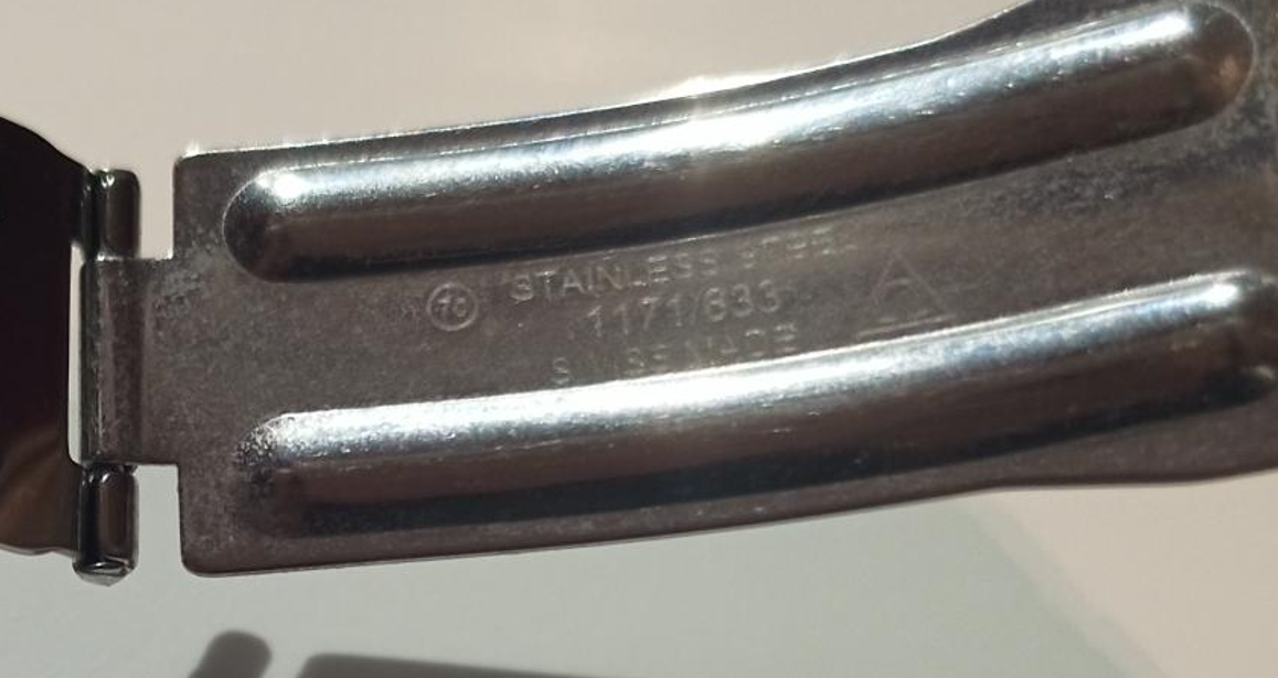

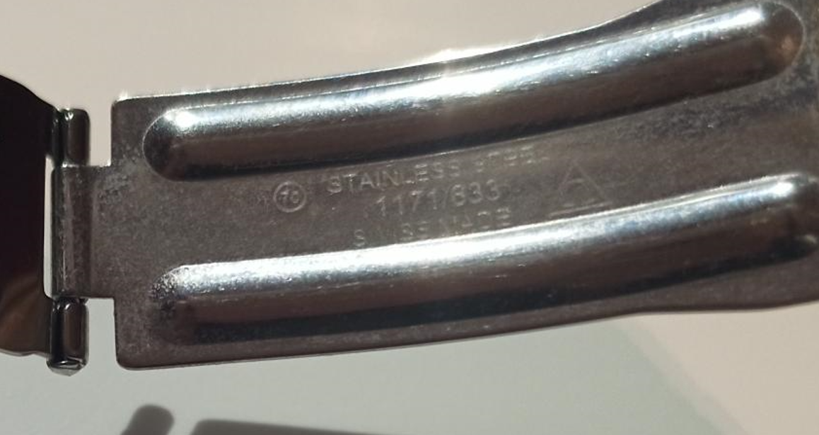

I think that this particular bracelet is newer than the watch, but quite similar to the original bracelet.
16
Logo on the bracelet is also different

Yes. That is the current 1171
