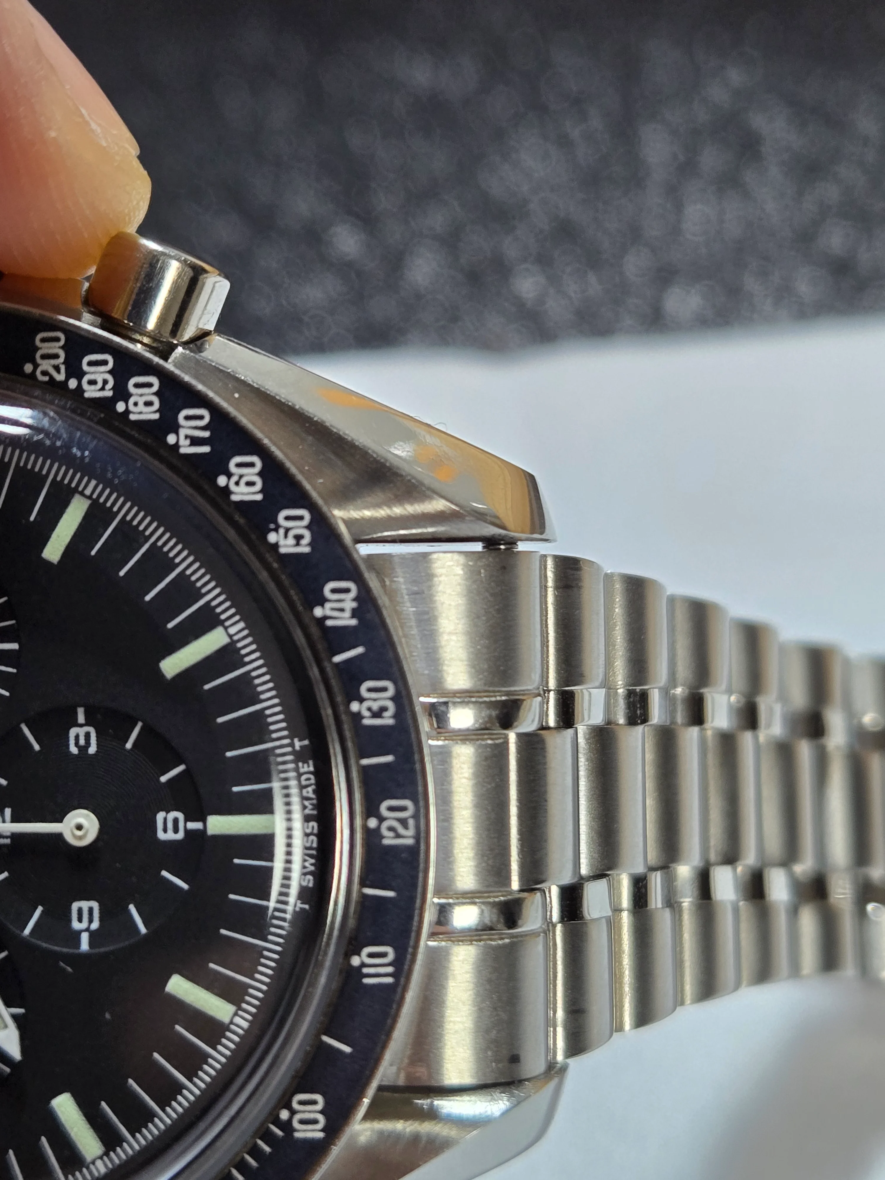

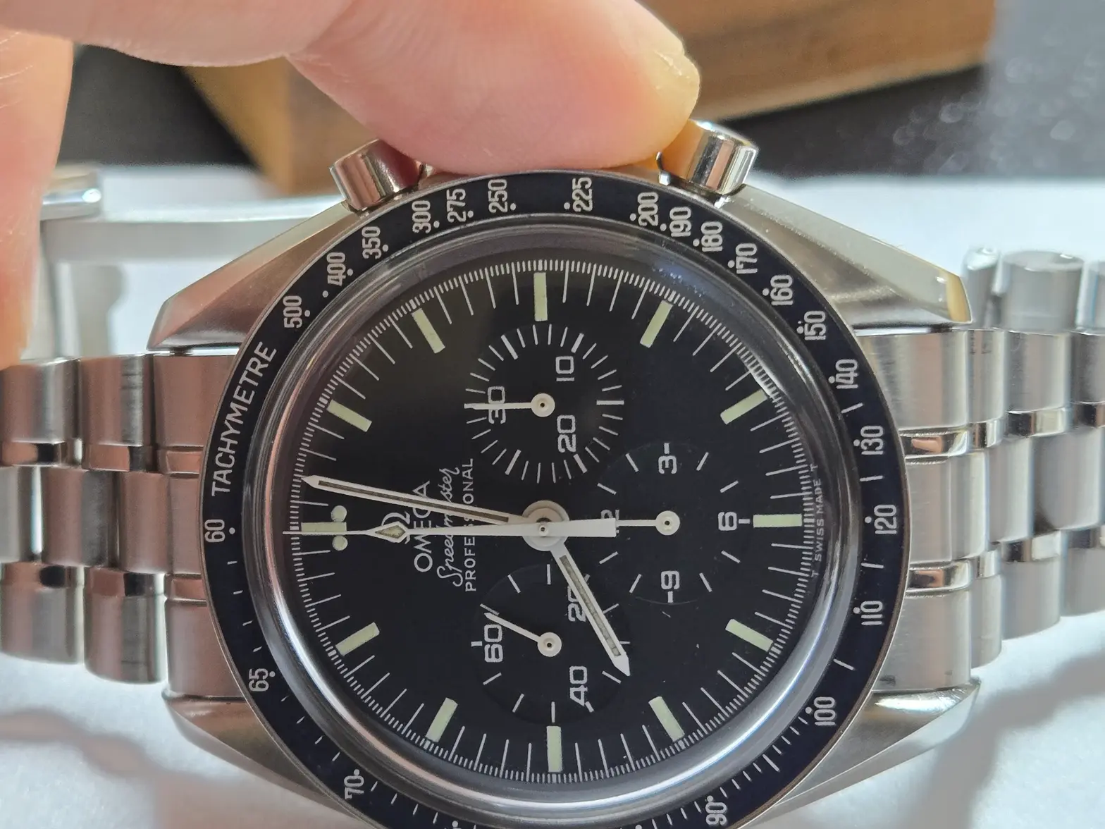

I recently purchased a circa 1979 145.022 Moonwatch.
However, the lug width seems unusually large. The seller said it has never been polished.
I agree with that when I look at the case condition, I don't think I polished it.

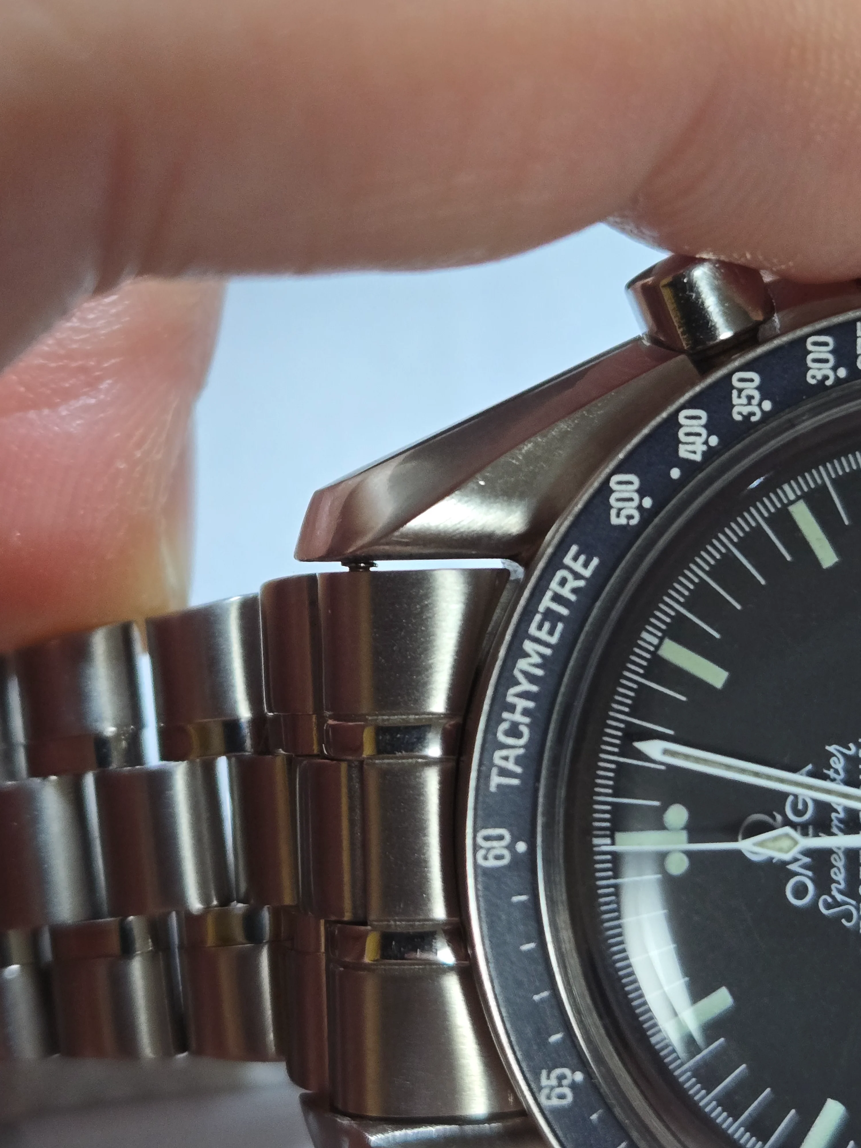

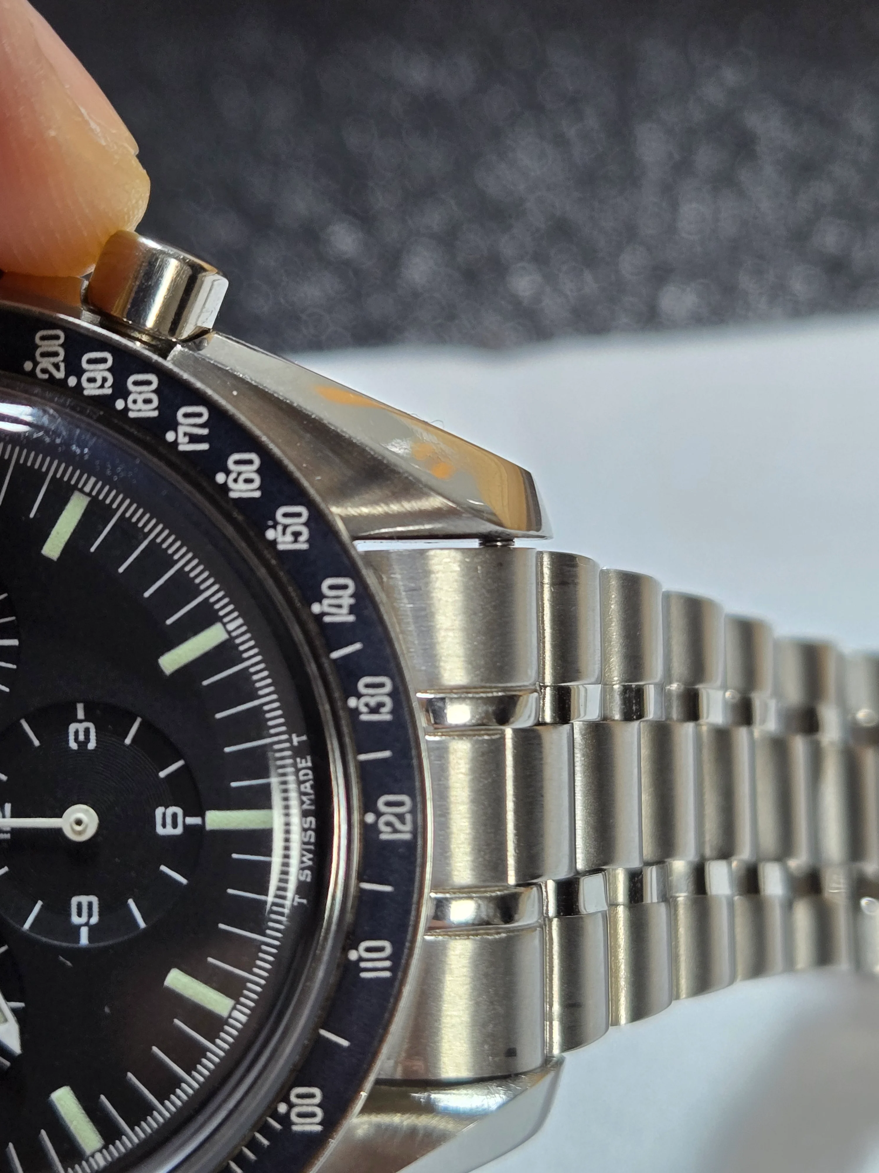

The photo below shows it with a 20mm Fostner Bullet bracelet. I measured it with a vernier calibers and it measures 20.3mm.
(this bracelet was used before on the 1861 model. At that time, there was almost no gap)
the seller said it is normal because of the case size tolerance of the older models.
Is that true? Please help me.
Thanks

There are some small variations in tolerances, I wouldn’t consider that to be any more than that, the Forstner is being made with tolerance too to ensure it fits as many watches as possible through the generations

Thank you so much for your reply, I know there has to be tolerance but 0.3mm seems too big. I think Omega is taking too big a tolerance. It breaks my heart.

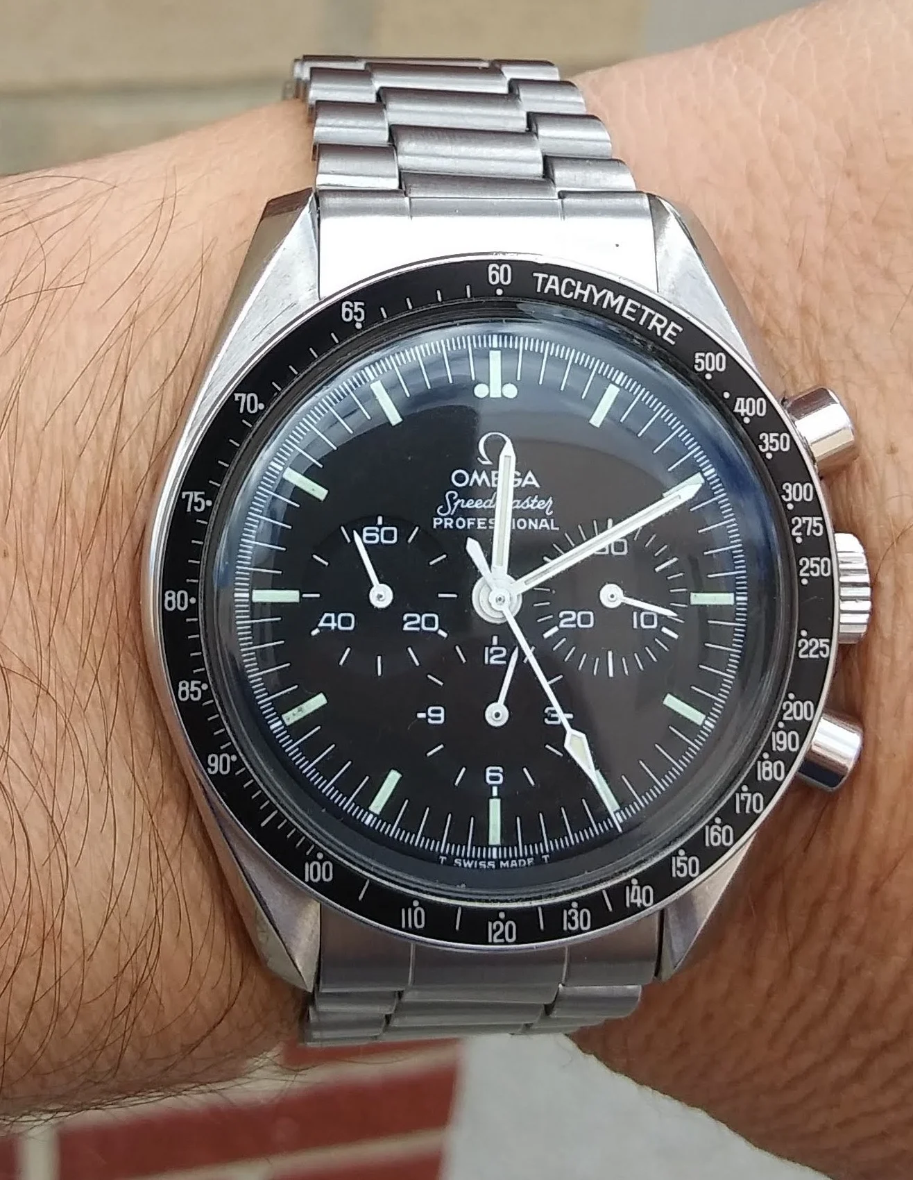

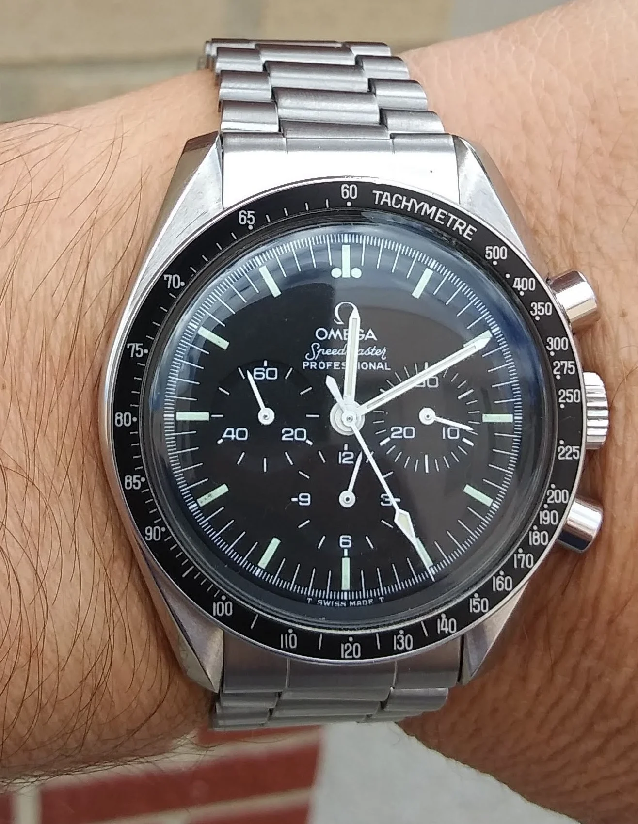

My 77ish CRS says heh. Your watch looks great. I love the greenish tritium.

i think your Moonwatch's lug size looks normal (20mm) and great condition. my eye sparkle with jealousy. Have a good weekend.

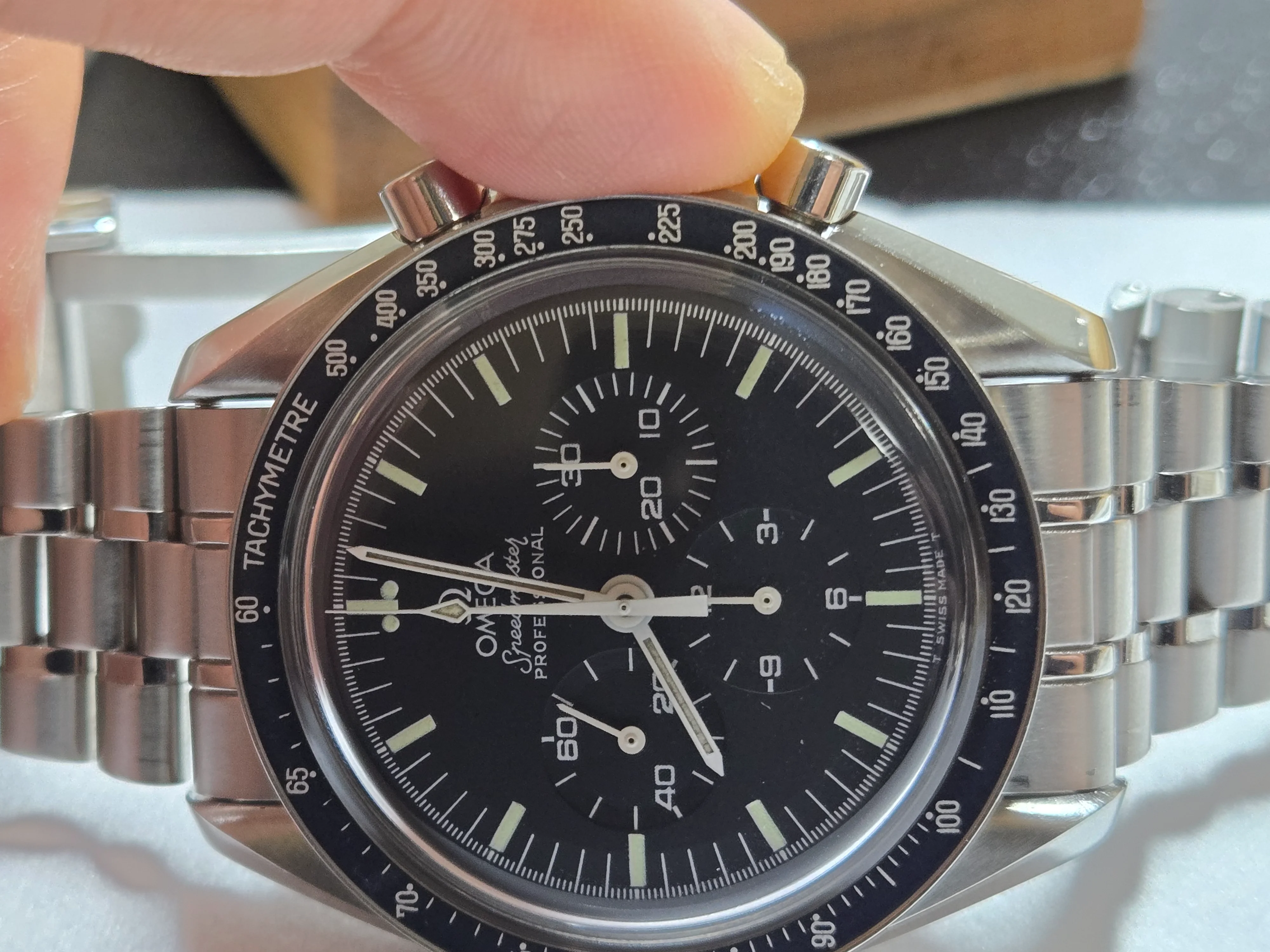

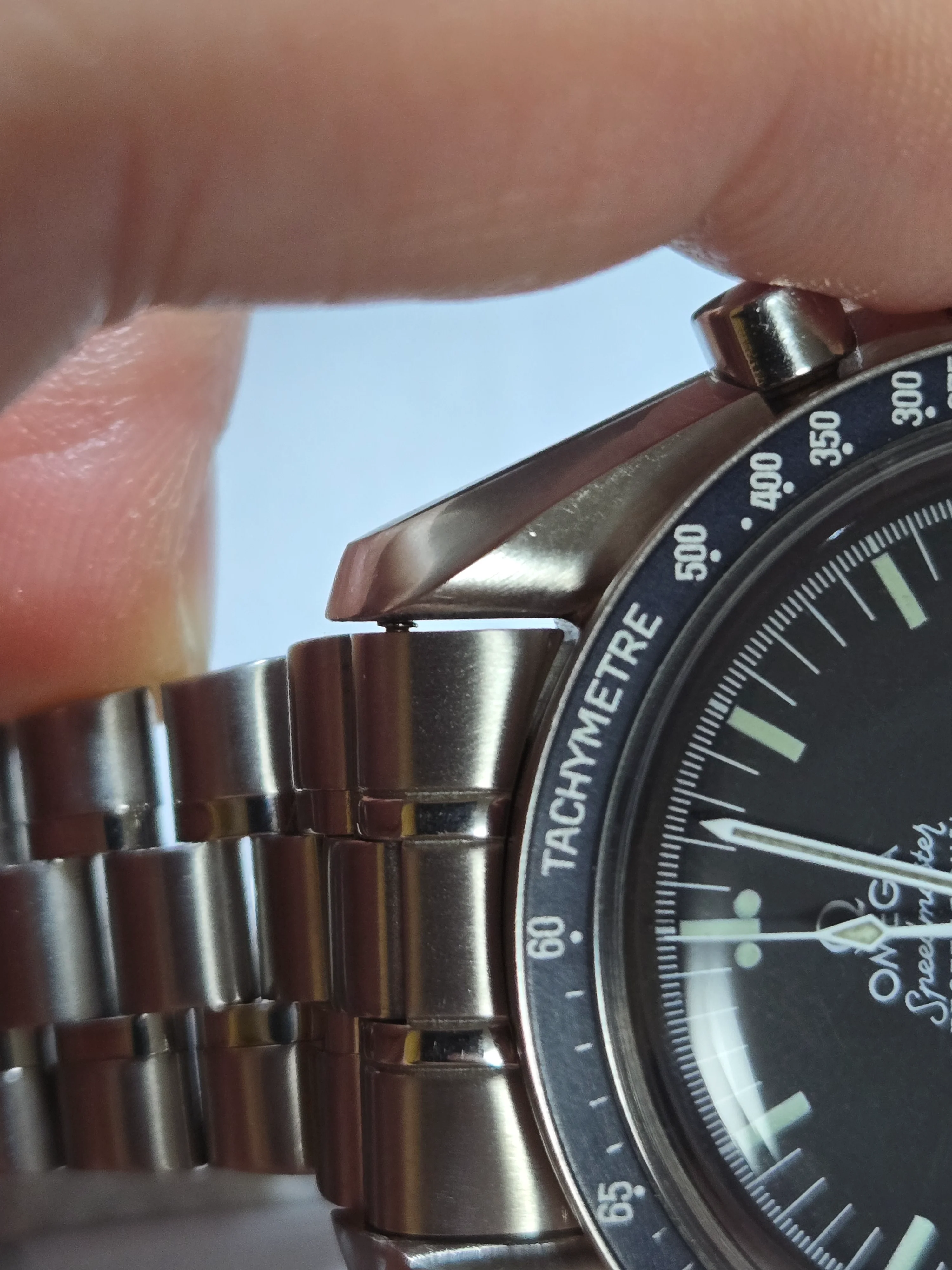

No gap.
Gap
Dump the aftermarket bracelet. I seem to remember OEM 1171s needing to filed to fit for just this reason.
8
No gap.
Gap
This is just an optical illusion. There is a gap even with the original bracelet. I measured the Moonwatch case lugs precisely with a vernier calipers and the case lug size is 20.3mm. Aftermarket bracelet end links has no problem.
