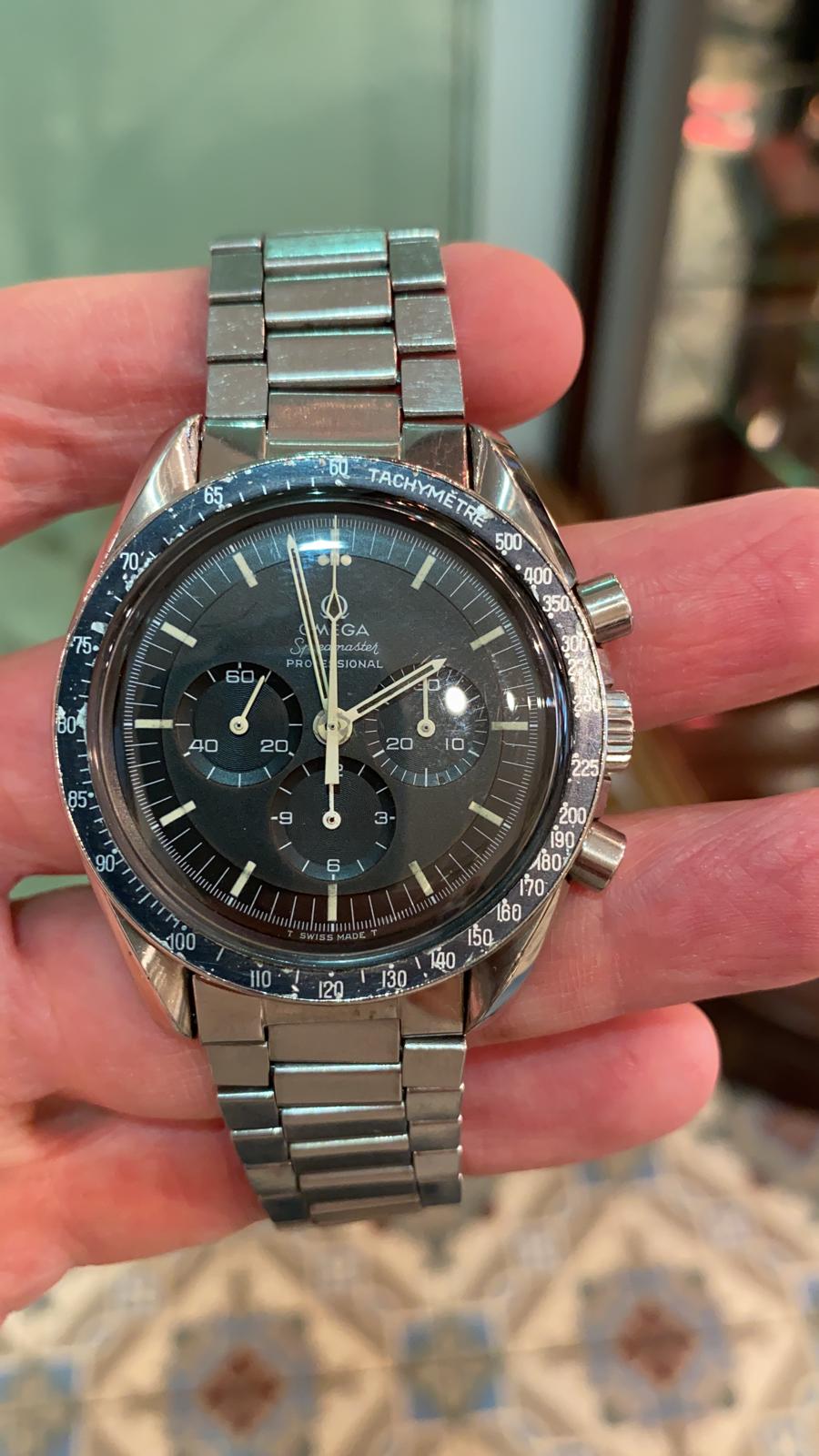

Fellow collectors and friends,
I have a question concerning my speedy.
I own a 145.022 69 reference with stepped dial and DON 90 bezel (see foto)
Also the watch features a single bevel case back and a 1039 bracelet.
Recently I opened up the case back and saw the movement number is 322XXXXX.
When I checked the Speedmaster database it shows that the movement is produced in 1974.
Is this watch a frankenstein or is it common to have a later movement in this perticular watch?
Thanks for any help!

Perhaps check on Speedmaster101 (or when I’m I will check moonwatch only), but that serial seems too high for a DON bezel. I believe they transitioned to the 220 bezel around 30,7xxxxx.

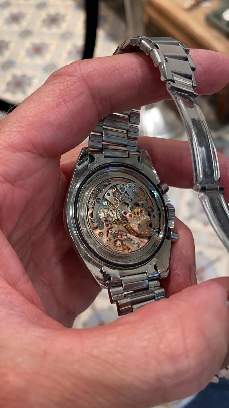

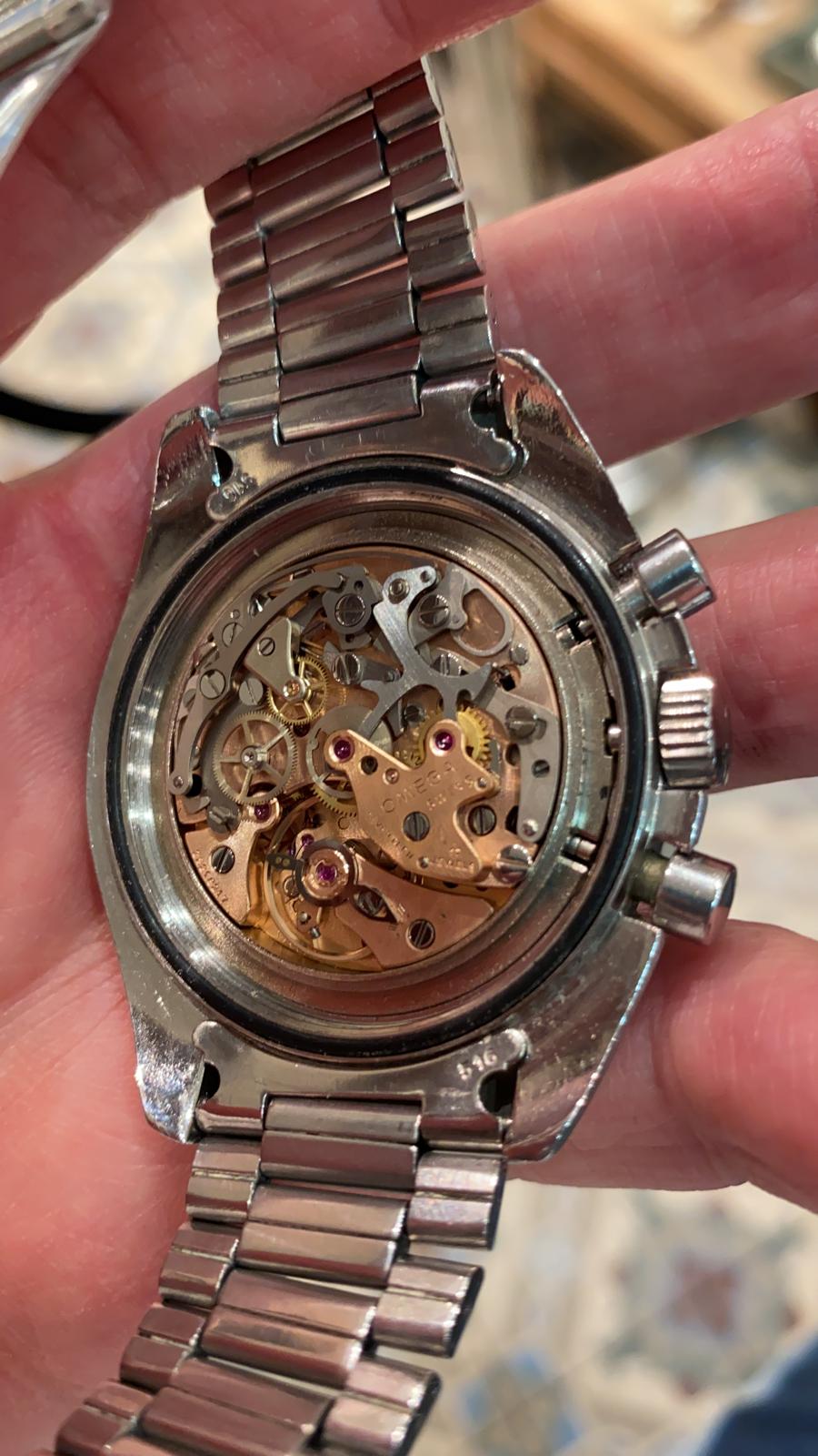

Please find a picture enclosed

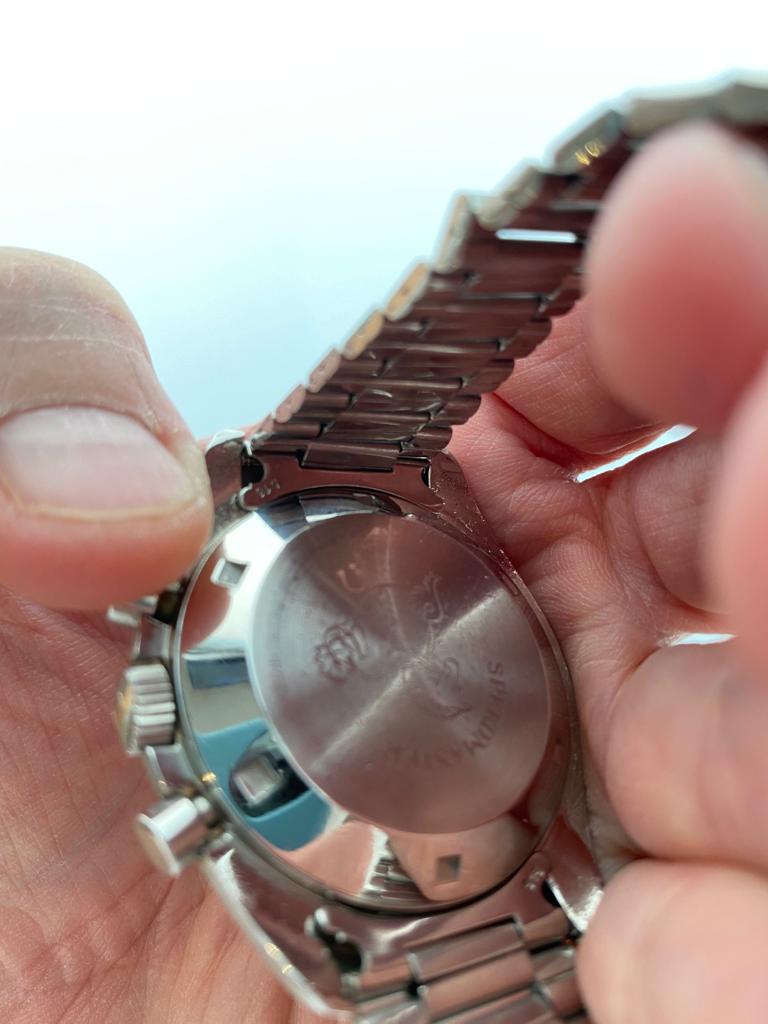

Is it a straight writing case-back? In general, it's good to start right out showing comprehensive photos instead of adding them in a trickle. That way we can help you more easily.

Serial is 32218217 so the movement appears to be produced in July 1972. The case back is pre-moon with only the seahorse and the Omega logo

But notice the movement minus the serial is correct for a 69. It’s not correct for a 72. At least by looking at the parts that changed in that period.

Yes, but according to the OP, he has a -69 that is not a SW. At least that is my interpretation of his posts, which is the best we can do without photos of the case-back.
