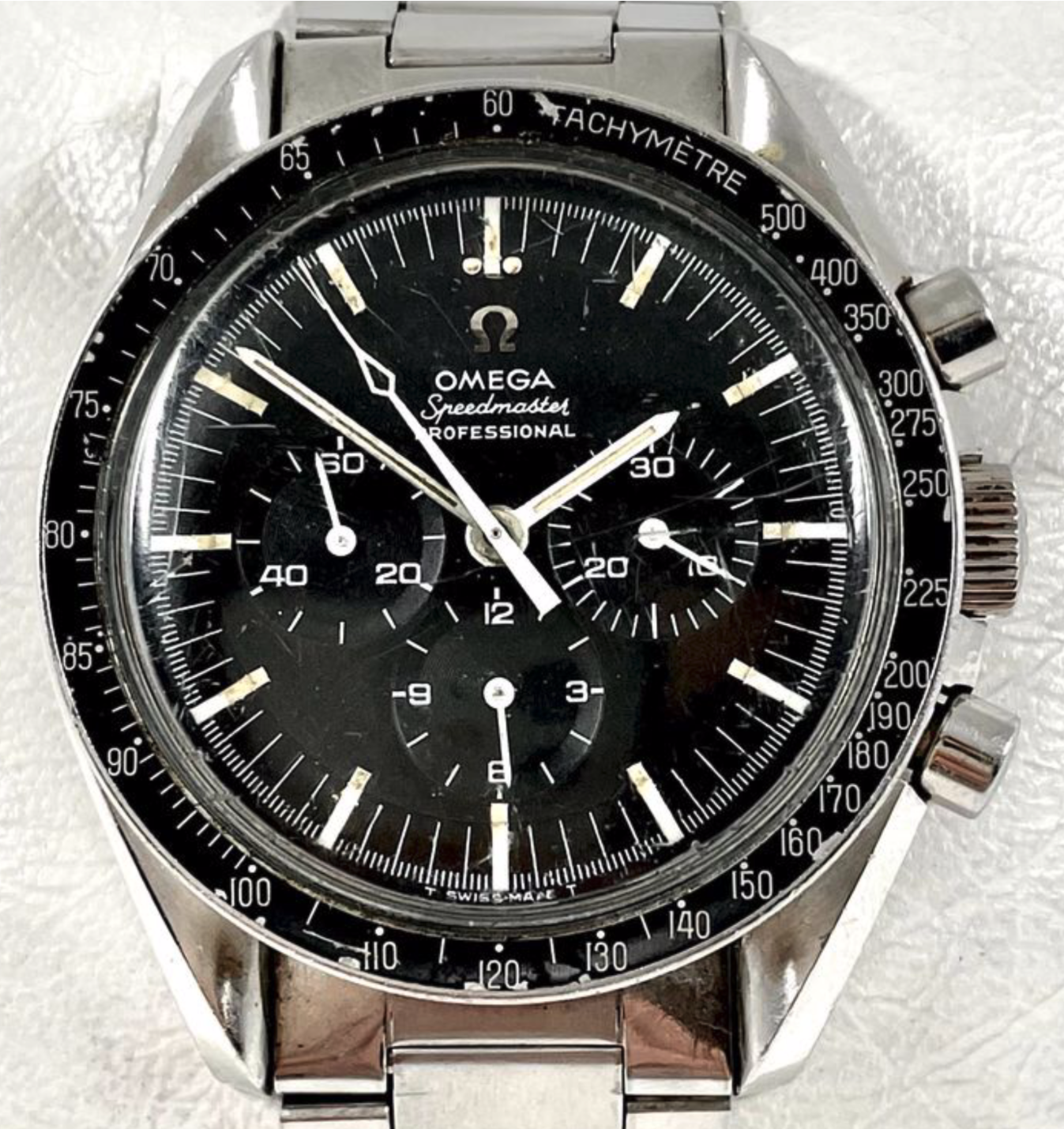

I stumbled over this one here, it is a 145.012-67.
Not a beautiful one at first sight, but then I took a closer look.
And asked for more pictures.

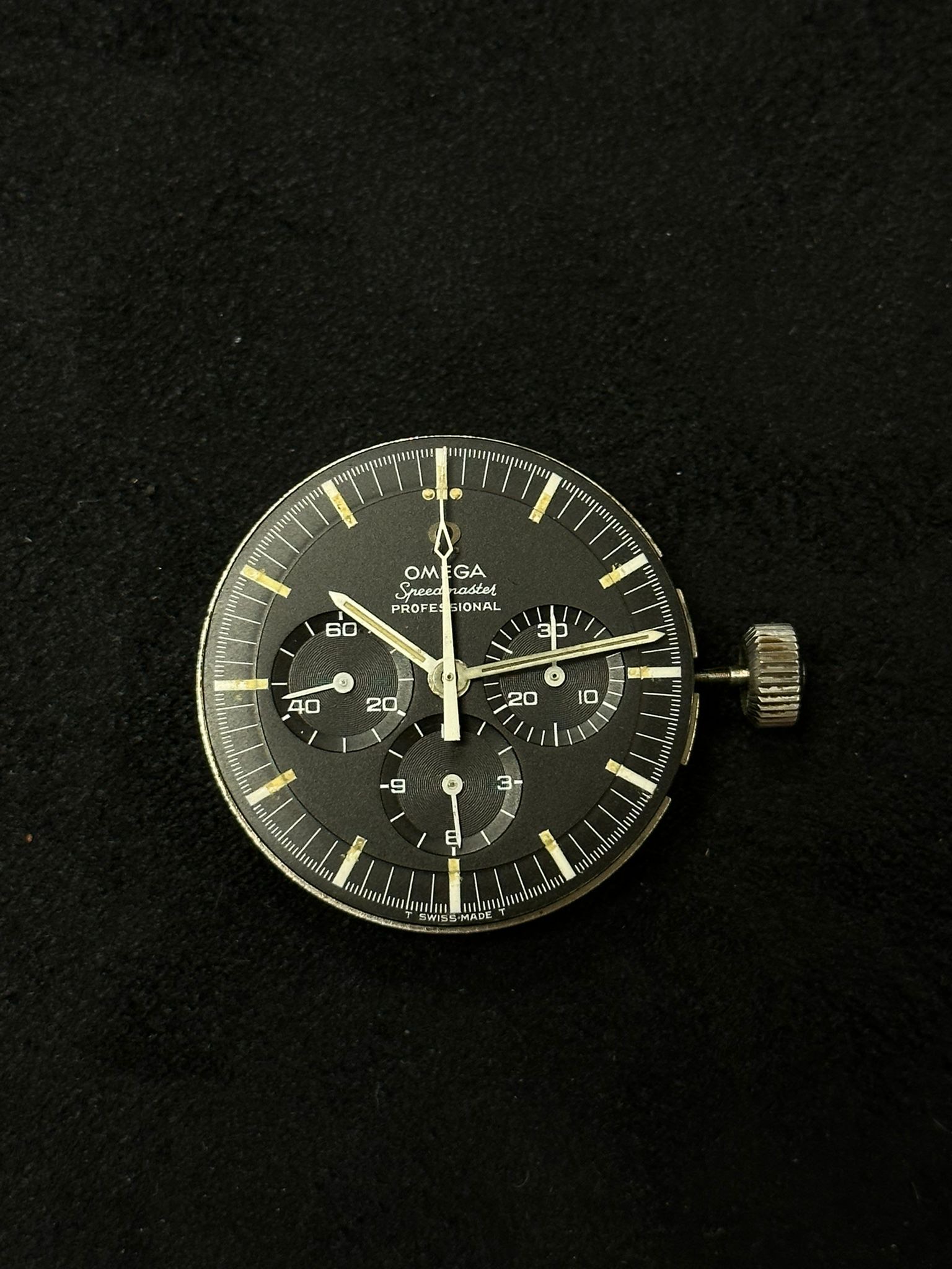

The auction house had de-cased the watch, and the picture showed more details regarding the dial.

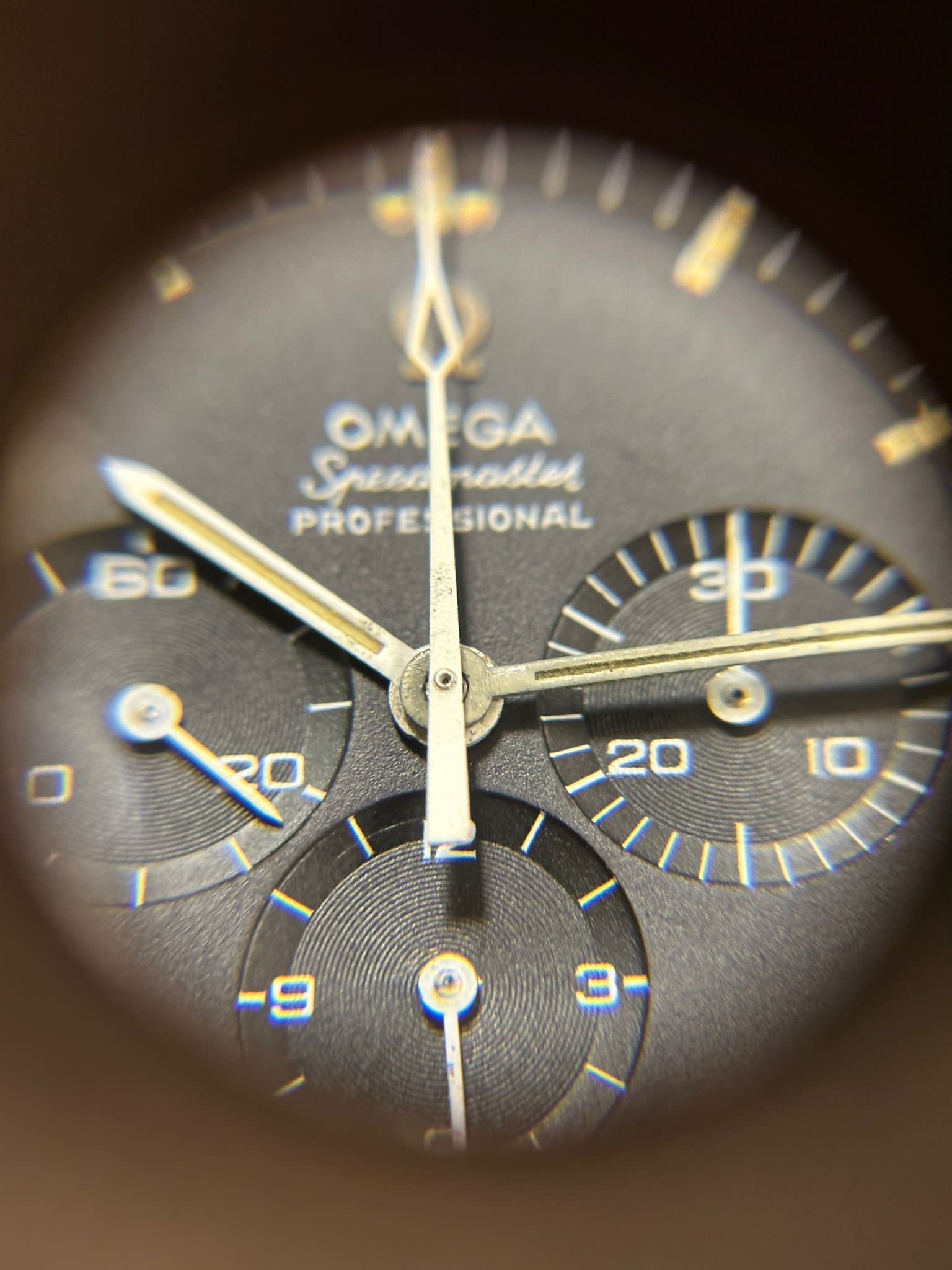

And the dial itself was pleasant to look at, maybe maybe with a little brown tone?
But the lume plots were tired and very ugly.

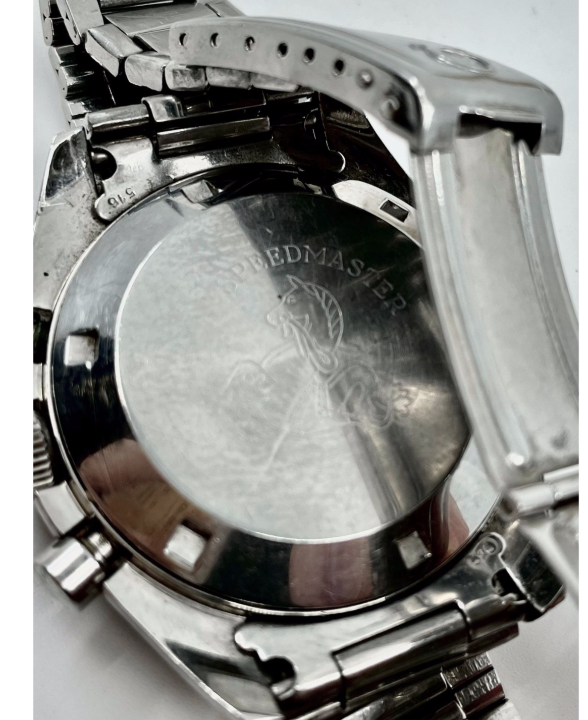

The case and caseback looked ok, it must have had some polishing, and with the obvious marks and scratches.

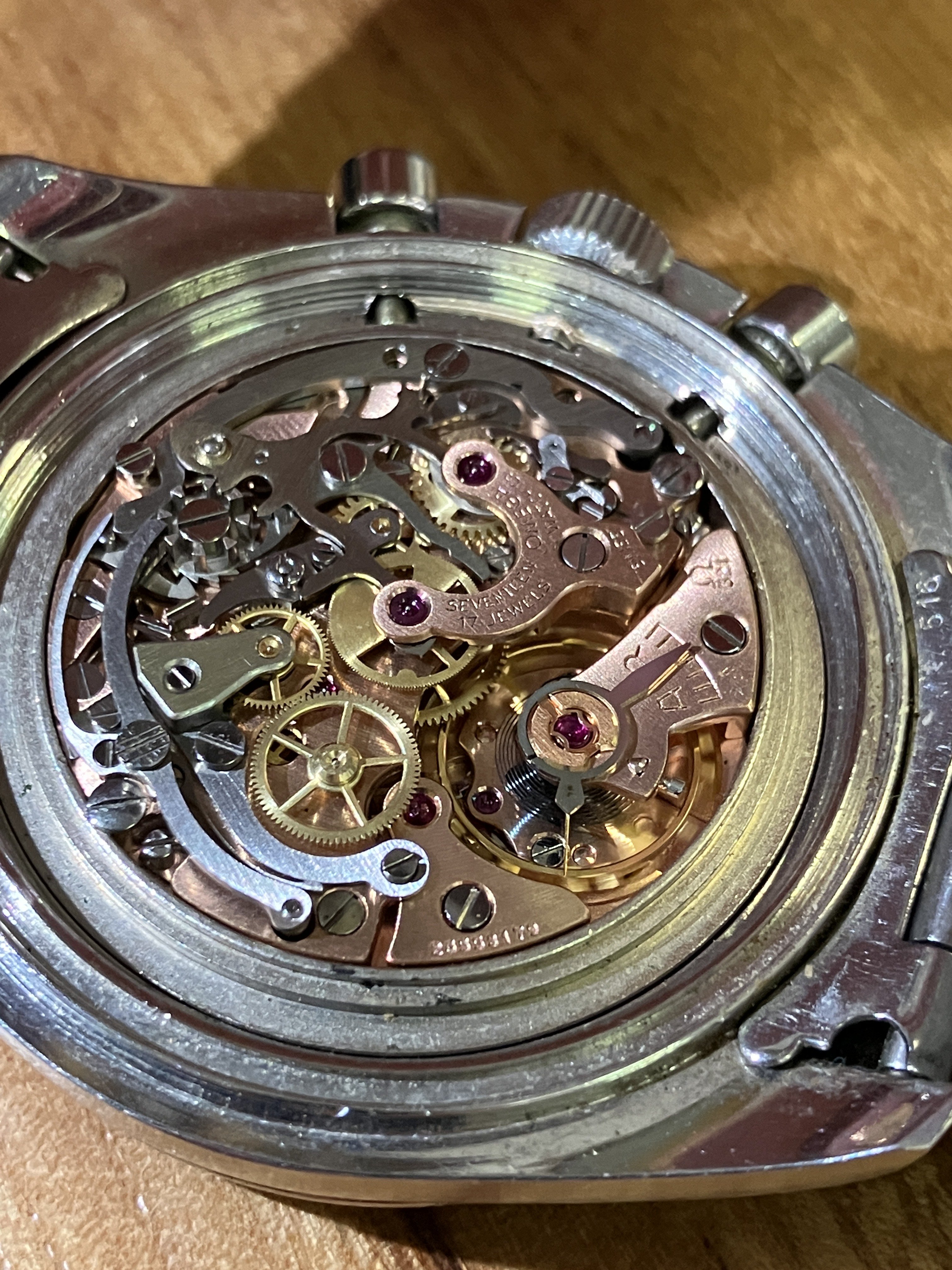

And the movement was also nice.
Serial nr was in the correct range.
Bezel ok, scratches and marks, but no big ones.
The hands where an issue, the tip of the chronohand was bent (how could that have happened 😲..??)
And the colors of the hands didn't match, and different style, so these must have been replaced/redone?
The crown was not the correct one, but for this one, it could be sorted out in the future.
The bracelet was a 1039/516, so this was a plus!
My thoughts here would be a full service, taking care of the hands in some way (new chrono/relume??),
and actually a relume of the dial, I have seen lots of watches with this, and they do look lovely if done correctly!

The body of the dial does not look bad.
There is not much lume left on the dial - so a perfect candidate for a re-lume.

For this, the buyer has got a viable Speedmaster with a Dial that I would have to say in its current condition is ‘fair”.
Plots are terrible and not attractive at all. It’s an ideal candidate for a relume as the base colour of the dial appears to be intact apart from a couple of spots that I would want to check. It’s going to be a dilemma. If you re lume the dial, it’s going to look way better than the bezel and hands, so next thing you know you have Lincoln’s Axe.
The crystal disguises the quality of the dial underneath, and it’s good to see the photograph of the dial bare.
The bezel is an original omega DO90. It has the slim font that I prefer.
The value of this bezel alone is probably around $1000, but it is what I would call fair. It might look better in real life or when cleaned. It also fits with the state of the dial and hands, and would remain on the watch if it were me.
The hands are mismatched, but possibly original, they just don’t look very attractive. It would be possible to restore them and distress them to an attractive vintage look, but perhaps it would be a hiding to nothing with the state of the dial might as well leave them all alone and enjoy it for what it is.
I can’t see anything wrong with the case from these photographs, but quite possibly there are problems in addition to the missing gasket.
The movement clearly needs a service, judging by the position of the hour indicator, but I would expect that in any auction piece
It is what it is. I don’t really see any advantage in restoring this with a relume, and rebuilt hands. The dial and hands would look attractive, but the bezel wouldn’t fit the aesthetic.
I think I would service clean and put it all back together as it is, and with a new crystal. If the bracelet is solid, then it’s probably not a bad watch for the money.
