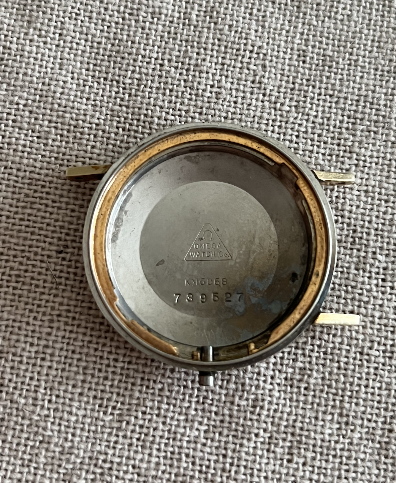

Yes, it's a SMDV. Hopefully gold/gold filled, but the original case was a two-tone so it was actually a SS.

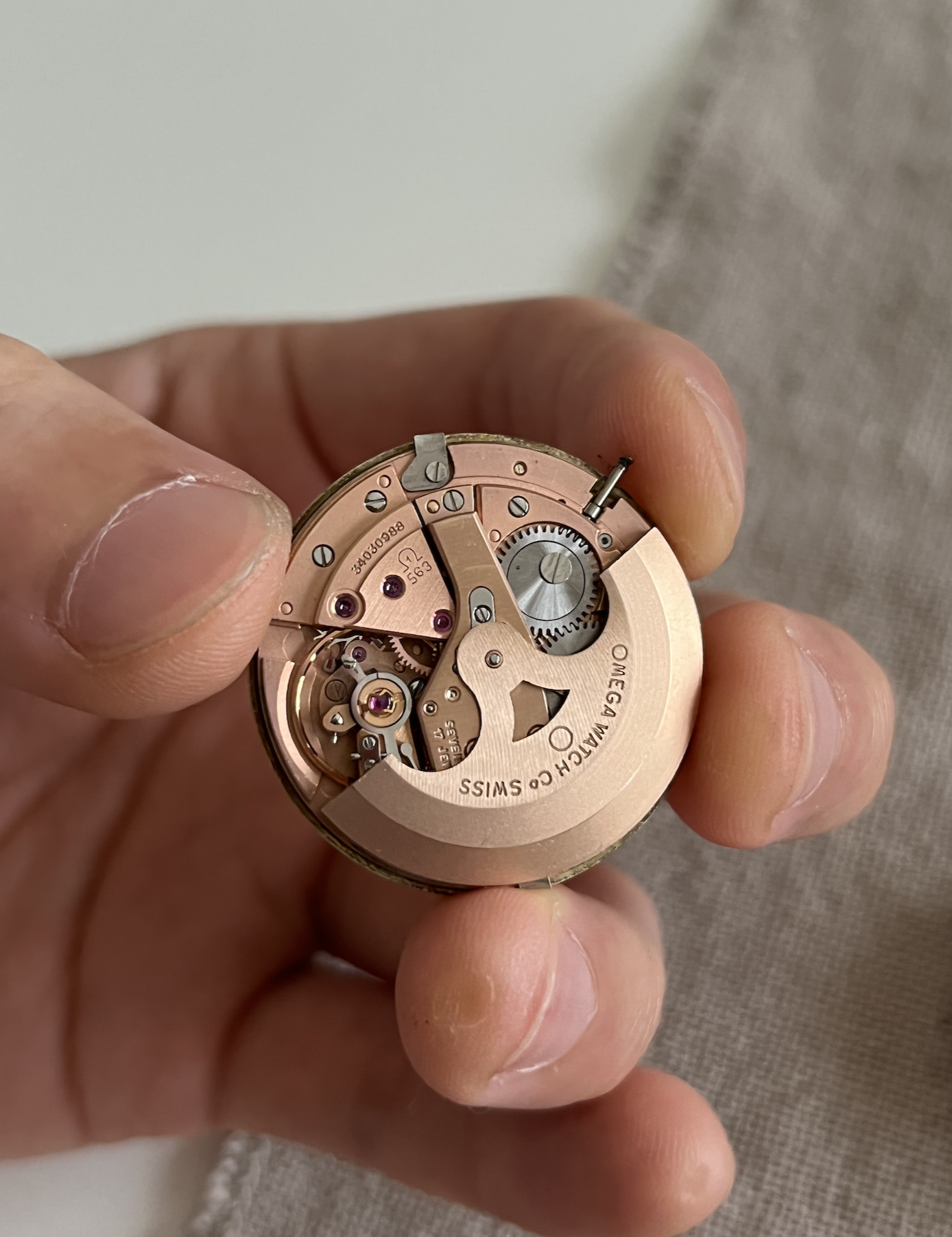

Here are some photos of the case and movement. It's a cal 563.

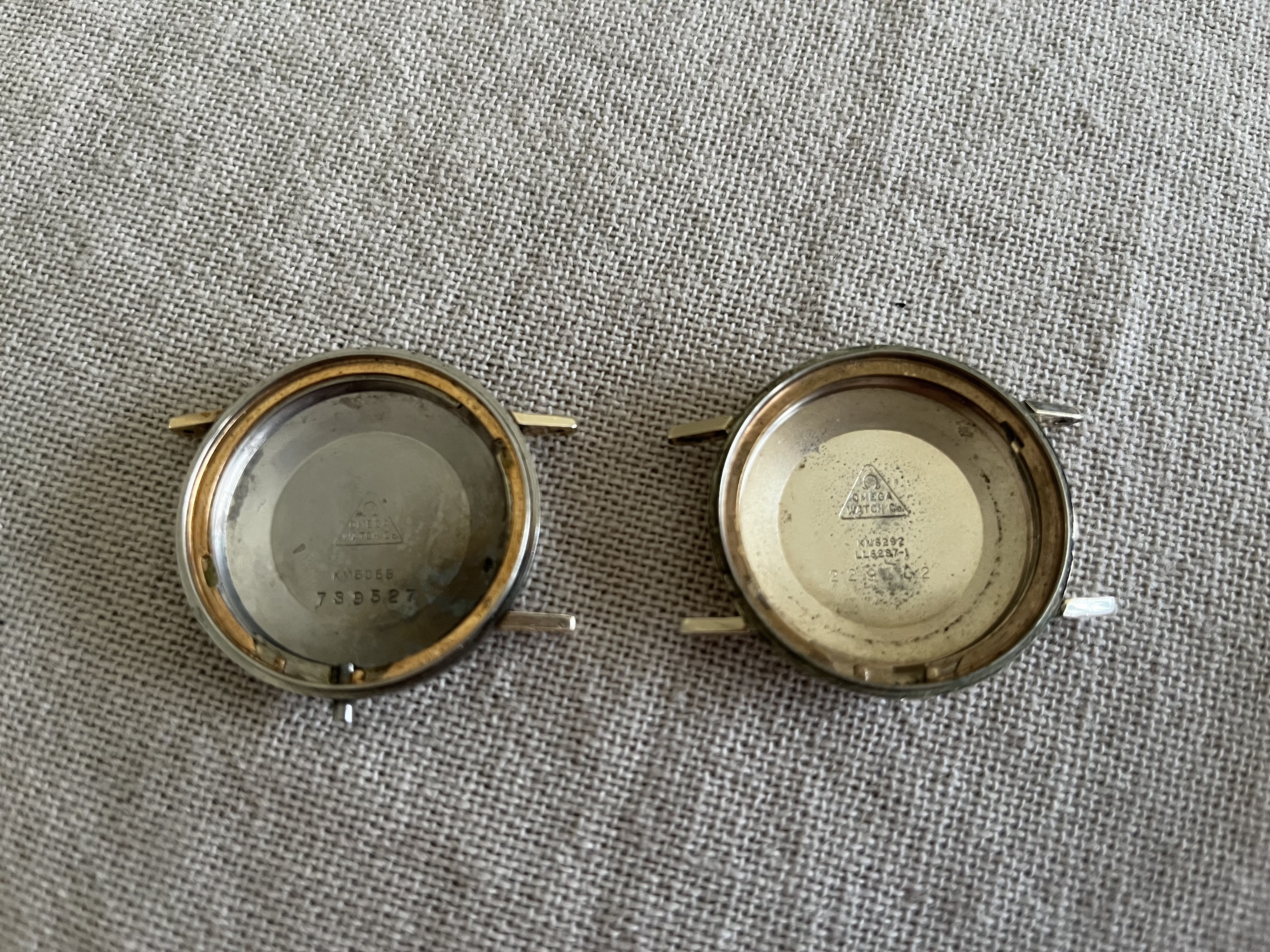

Hello. I picked up a KM6292 case but it doesn't have a case tube like the previous one.
Anyone know the case tube reference number for the specific case?
It approximately measures:
-1.5mm/case
-2.00mm/crown
-2.00/crown shoulder length
-5.00/total length

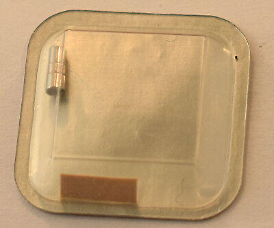

Usually, the Jules Borel parts database is very helpful. Go to http://www.julesborel.com/products/watch-parts and launch the Watch Parts Database from the link in the upper right corner. Search in the format OME CS#KM6292 . No useful results for case tubes.
Next try Cousins UK. Go to https://www.cousinsuk.com/category/filter/omega-case-parts and search 6292, select this model, select Case Tube, then Search All under color. Click Search for Items. Cousins gives part number 090ST0099 but won't sell to you, Restricted Item. They do give a part number though, which you can use to search eBay and whatnot.
There's one of these on eBay now. Again, I'm not a watchmaker, I've made mistakes with part numbers in the past, take this with a grain of salt. Ultimately, you'll want to consult a watchmaker.

According to Cousins, the original casing I had for it has the part number 090ST1270 for the pendant tube, and the new case requires the part number 090ST0099. The movement does fit in the case (not as perfect as the original case, but does fit) but without the pendant tube, the crown wobbles around. Would purchasing the part number 090ST1270 solve this issue?

Case tube for the 6292 case is 090ST1217.
