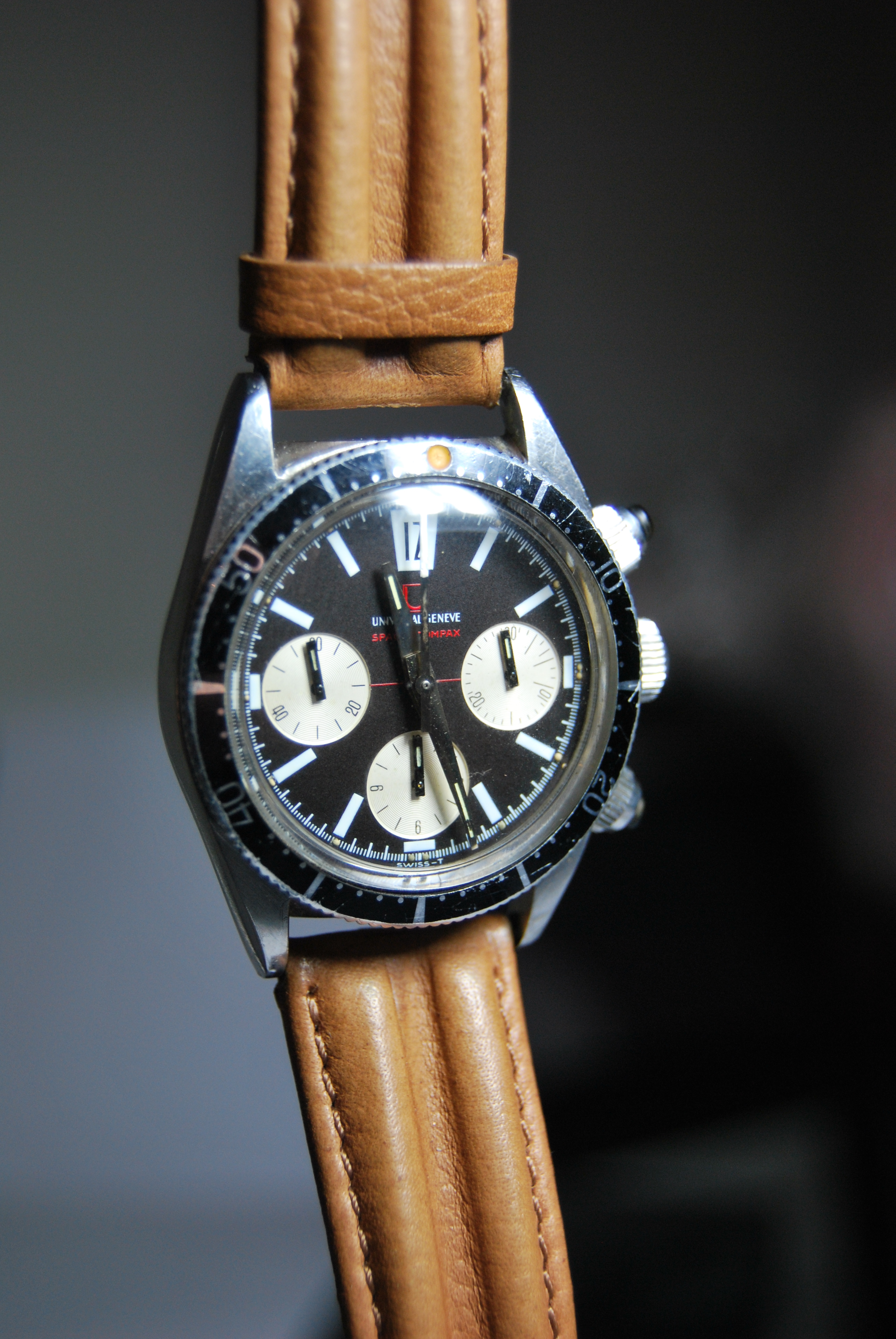

it was easy to confirm based on this photo
my actual SC but photo from the seller to make things clear
@ Stefan
VERY nice SC, congratulations !

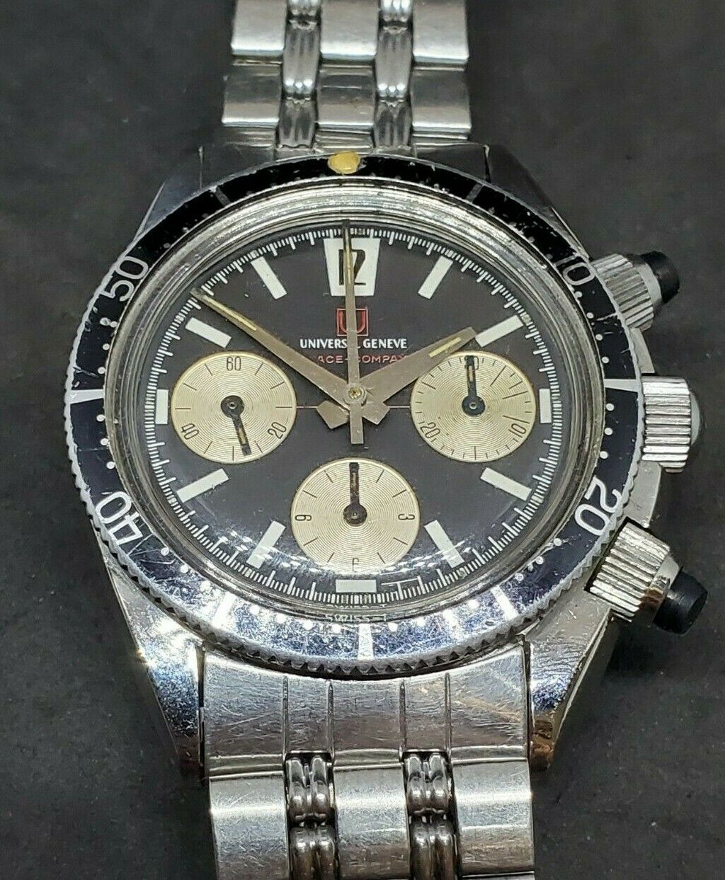

Hello to all, if the image is correct in this brochure my space compax have the correct sub second hands? Because i was thinking they were not the correct ones and i didnt had information to confirm that....can somebody help me with this?
THIS IS MY SPACEY 馃榾
Thank you and have a nice weekend.
Francisco
2,399
4,474
Francisco
The hands look correct to me.

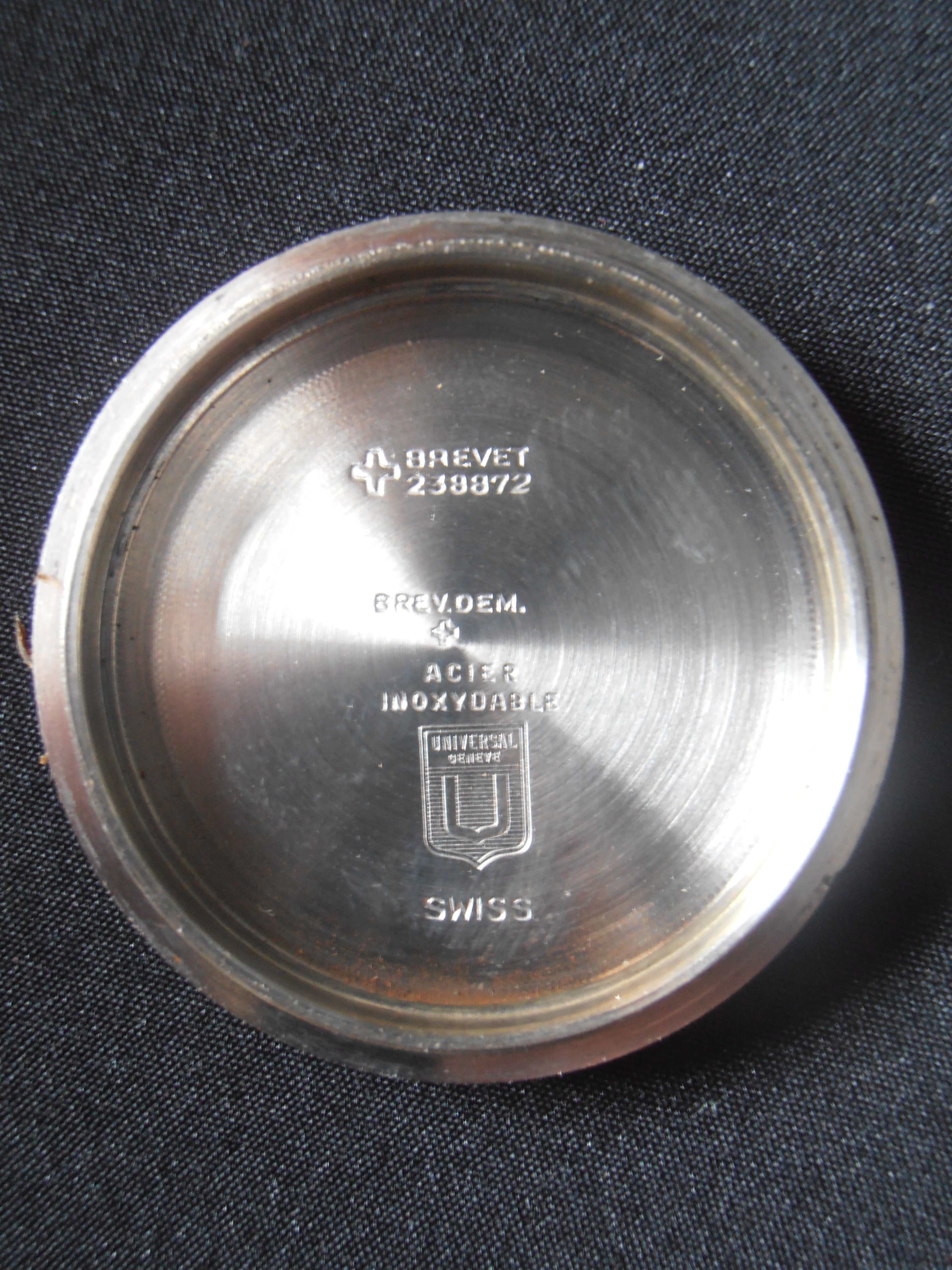

If some bodyhelp me i apritiate! 馃榾
I just have the marks inside my case back because last owner polish and the serial number in the case back desapear...is that a very bad thing?
6,710
18,593
No. It is nicer to have the numbers, but Universal engraved them very lightly on the later watches like the Space Compax, so it only takes a little polish to make them disappear. There are many examples with missing numbers - I would not count that as a major sin.

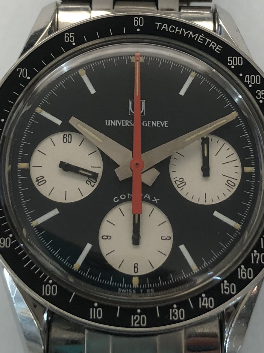

I am bumping this to ask about the chrono seconds hand. This has not been discussed yet. Here is what I know:
1. Space Compax is known to have the large chrono seconds hand that extends over the Hours subregister as shown in this thread
2. Other Compax models typically came with the smaller chrono seconds hand
3. A few other Compax models did come with the larger Space Compax-style chrono seconds hand. I have an Evil Nina configured just this way. It is all-original and in mint condition otherwise including proper serial # and UG-signed crystal, so I have no reason to suspect it was changed. See photo.
So my question is this: Do we think it possible some Space Compax examples came from the factory with smaller chrono seconds hands? I had thought not but have come across at least two examples just this way in my latest research. See photo.
What do you think?
