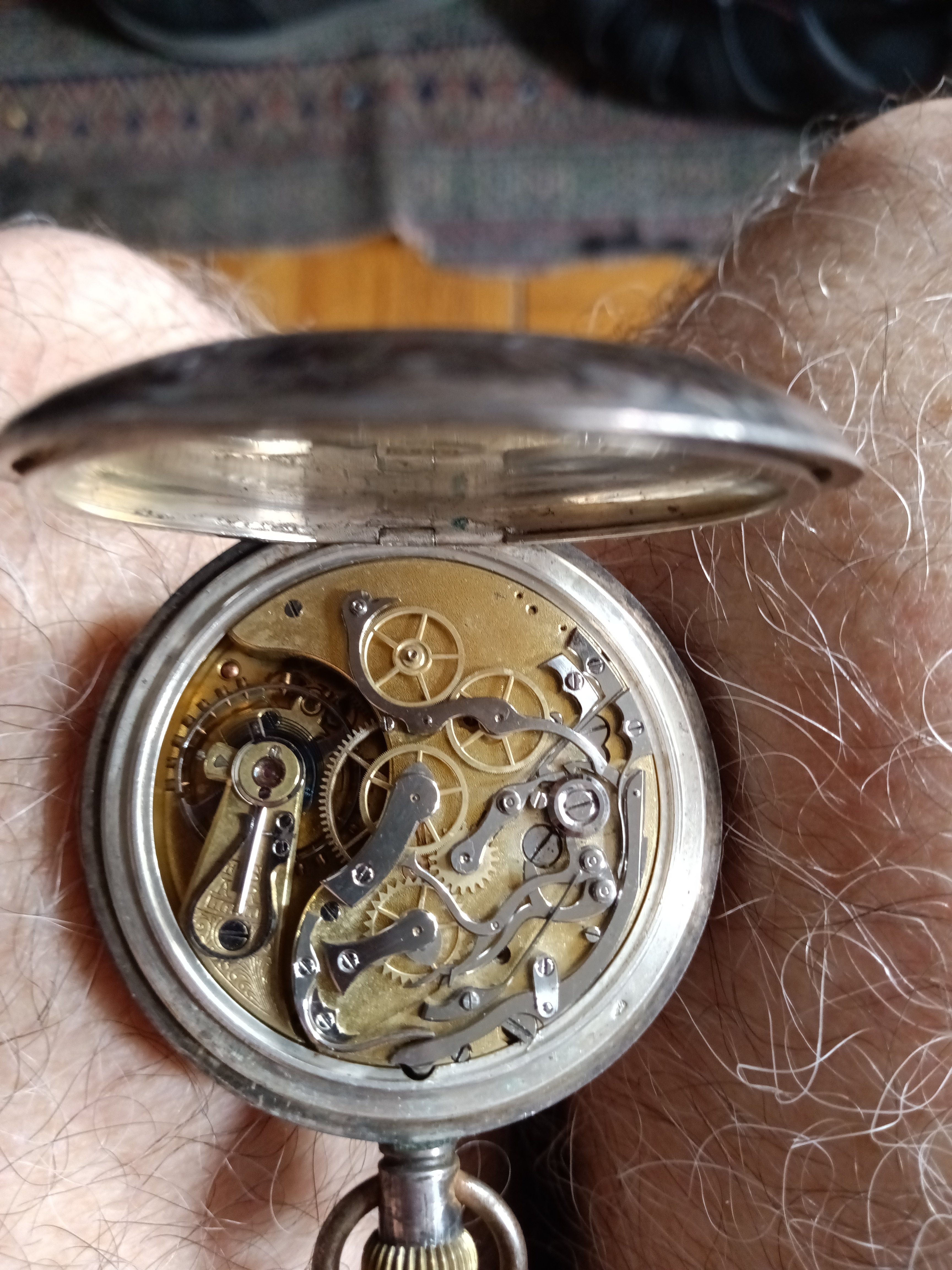

Can anyone suggest a source for old pocket watch parts please? My watch repairer just said this part would be for him impossible to get. He says that this movement ìs of such extraordinary high quality that he said no one would have it. He described it as being Patek Philippe like!
It is a large silver pocket watch. I couldn't argue with him as I have never tried to get a 1910s Omega chrono watch part before.

This look likes the same movement and missing part

This looks like a 19 lignes chronograph movement.
See these links.
https://www.timeline.watch/watch/1900-omega-first-pocket-chronograph-ref-ch-533-19/
http://www.pocketwatch.ch/komega.htm
search the internet for "Omega 19 chro" for a parts movement. or omega pocket watch chronograph (but omega has made other pocket watch chronograph calibres).
Urdelar has one that is not so cheap: https://urdelar.se/products/omega-19chro-lb
This one is cheap https://www.ebay.co.uk/itm/22576859...YeVaTOayoLPm2O2IpzUlzj1w==|tkp:Bk9SR-7Dlf_UYg
Please measure the diameter to see if it really is 19 lignes.
Maybe send us more pictures of the movement.
You have to decide if it is worth it. What about the condition of the dial and case? History of the watch (family heirdom).
Good luck hunting!

It suggests what I suspected but didn't know: That this isnt an Omega calibre it is a calibre! Now if I can identify it, I can measure the size and start looking for this part.
I also wondered but didn't know that I could realistically look for such a part on ebay. But you suggest that these obscure chrono parts do crop up occasionally. Now all i need to do is identify whose calibre it is, (and maybe what that part is called)!
Then I can start looking.
Were it not for my repairer rhapsodising about the magnificent Patek quality, I'd just assume it is a 19 ligne CHRO.

You need a coupling clutch spring...
Thanks for that! Is it specific to Omega or do you think they bought in an existing calibre as is suggested above?

BTW there is a cannibalized one on eBay Bulgaria. I have asked him ìf he would care to cannibalise it further.
There seems to have been a 7 jewel version of this movement .î would bet it isn't even particularly rare?

I am not sure if you are being sarcastic.
In my opinion this IS an omega 19 ligne chronograph calibre.
You can have the part if you buy this https://www.ebay.ch/itm/22576859120...-53480-19255-0&campid=5338788128&toolid=10001
for 300 pounds.

Well I did manage to get my repairer to fit the part and now it works fine.
So I am trying to figure öut exactly why he went so far out of his way to rhapsodise In such glowing terms about the quality of this particular piece. For a 1908 movement it is nice quality but I can't see what the externally apparent differences were between the five grades of 19" CHRO movement? Is it something to do with chatons on the balance staff? I can't see the jewels on the movement and the chrono part doesnt seem to be jewelled?
