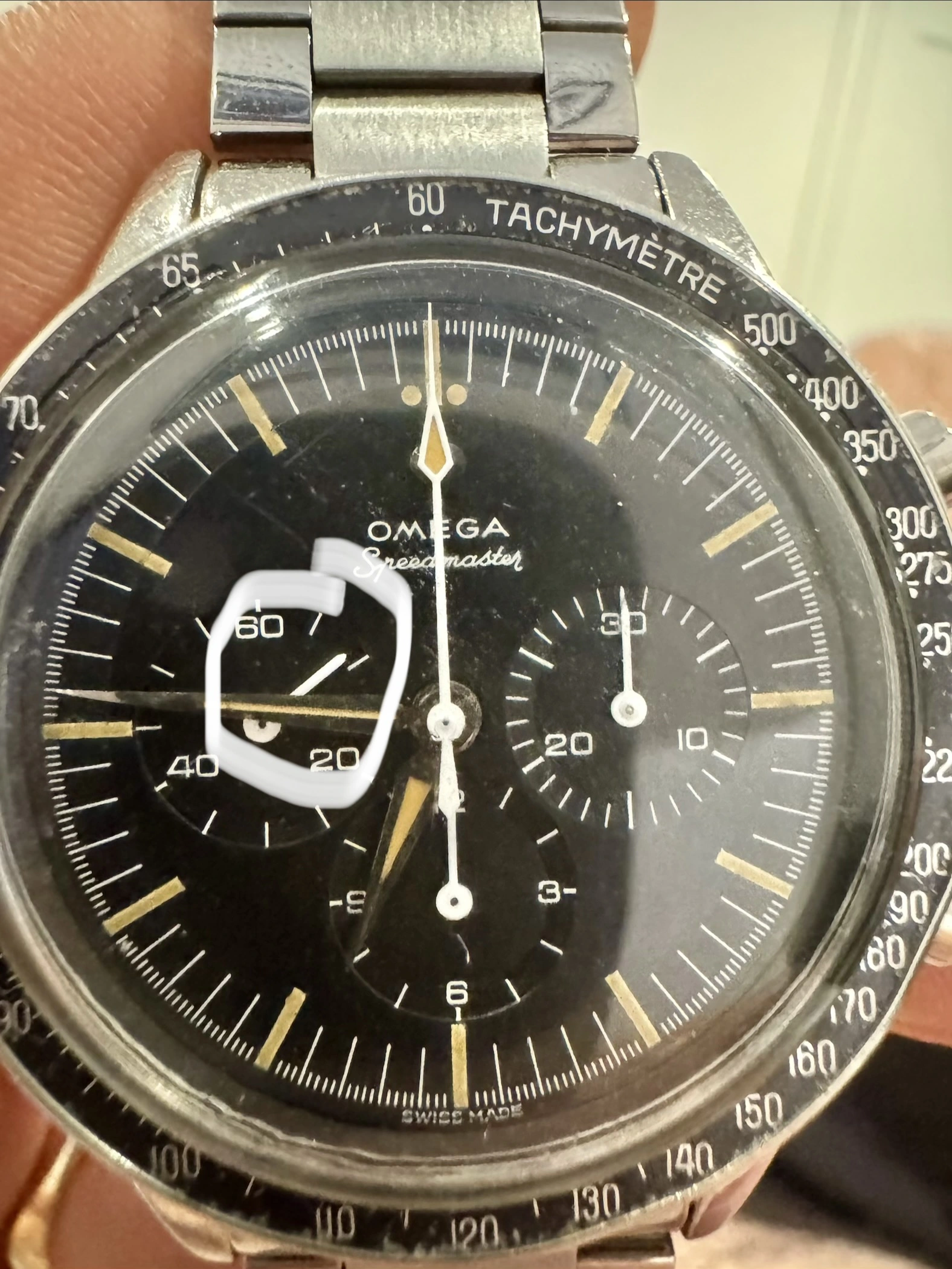

Soo the running seconds hand is wrong on this 2998-62. Ya?

Thanks for the response. What I was asking if the hand itself was an incorrect hand for this watch.

Actually, you misinterpreted his question and gave an answer to a question he didn't ask. He was quite clear asking if the running seconds hand was incorrect, he even circled it, it had nothing to do with any chronograph hand or operation of the chrono mechanism. OP's expression was fine, nothing needs to be learned. 🙄

It depends whit 2998 is. If I regenerate well, up to the -4. Is one type, from the -4 up is another.
These should be ok in a -6

The resolution of this picture isn't great, so perhaps it's just the image, but the point of the subdial hand under discussion here seems a little blunt and a little short. @T*M*M is that your concern?
Either way, I'd be more focused on the hour counter hand with these as these 2998s and 105.002s are the only ones with a hour counter hand without the obvious 'nipple' around its post. Neigh impossible to find if it isn't there. The other two subdial hands are far less specific and can be sourced more easily. And on a positive note, the watch in question seems to come with the correct hand. Nice.

Thank you. Yes, this was my main concern. It appears to be shorter and blunt. Certainly different from the shape and length of the other subdial hands. I wondered if perhaps there was some variants out there and it might still be correct. I understand 321 and 861 hands to be interchangeable so it might be the case that some watchmaker replaced it at some point.
