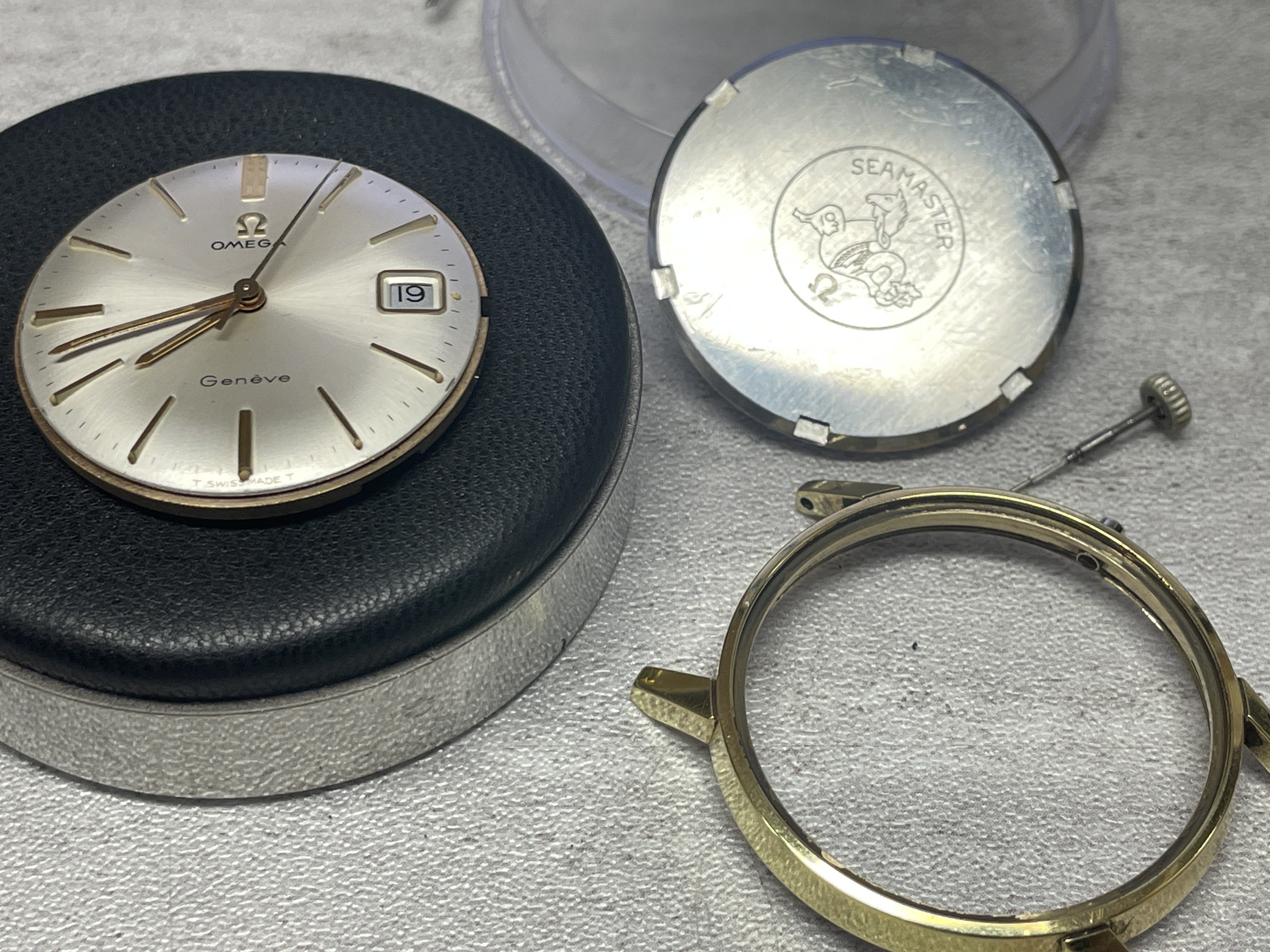

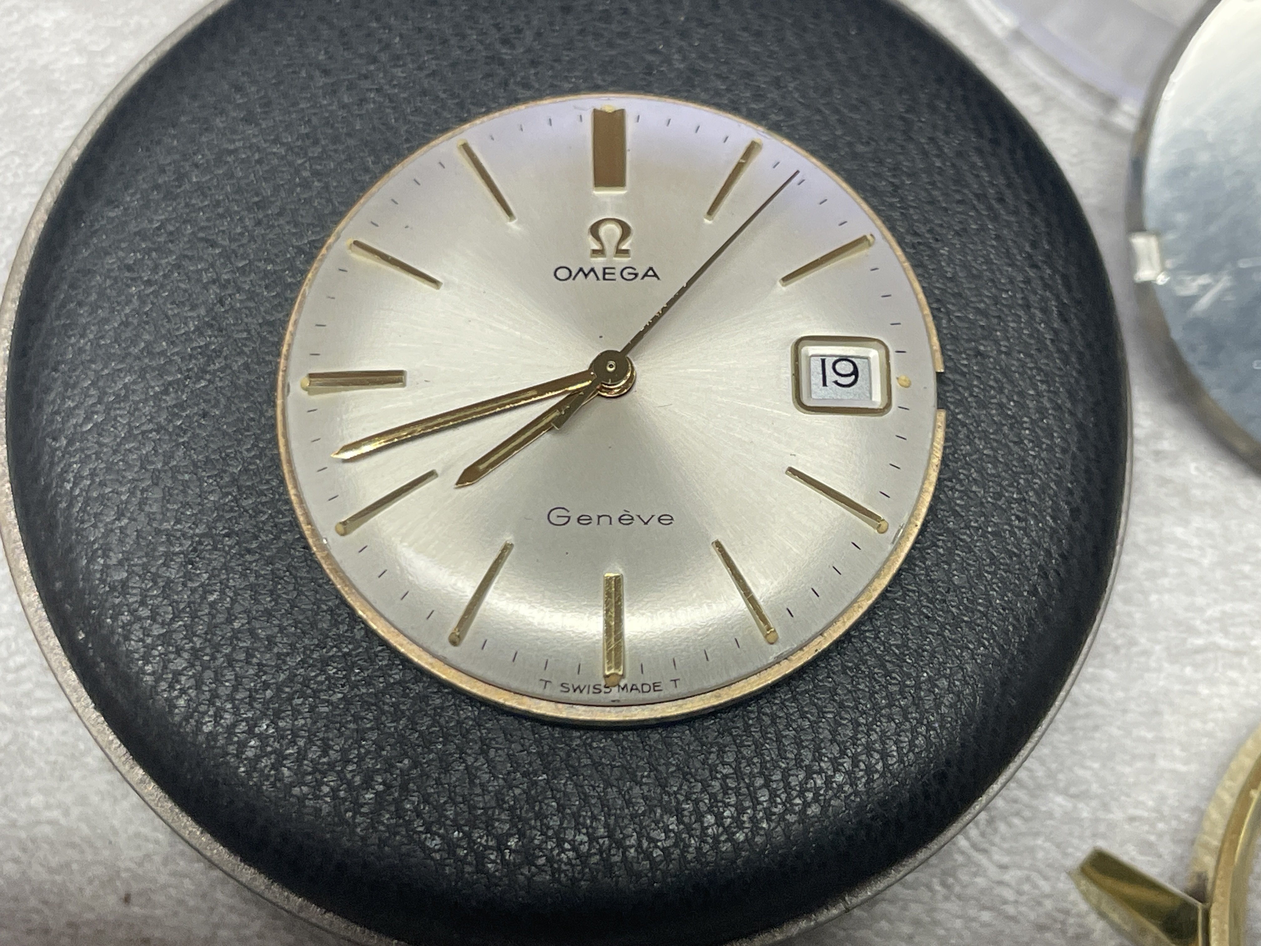

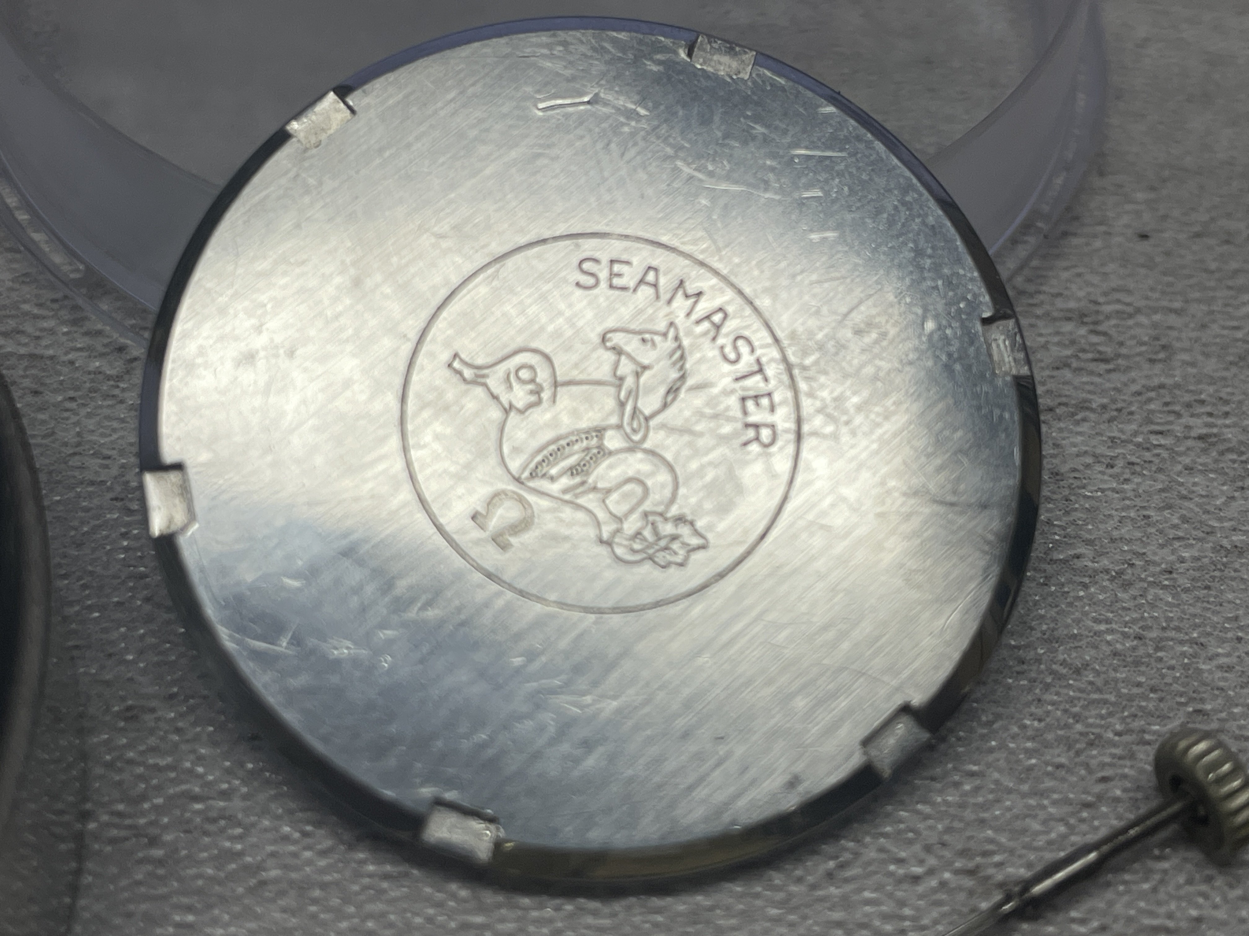

Something seems odd with this 1968 Geneve + Seamaster cal. 613
4

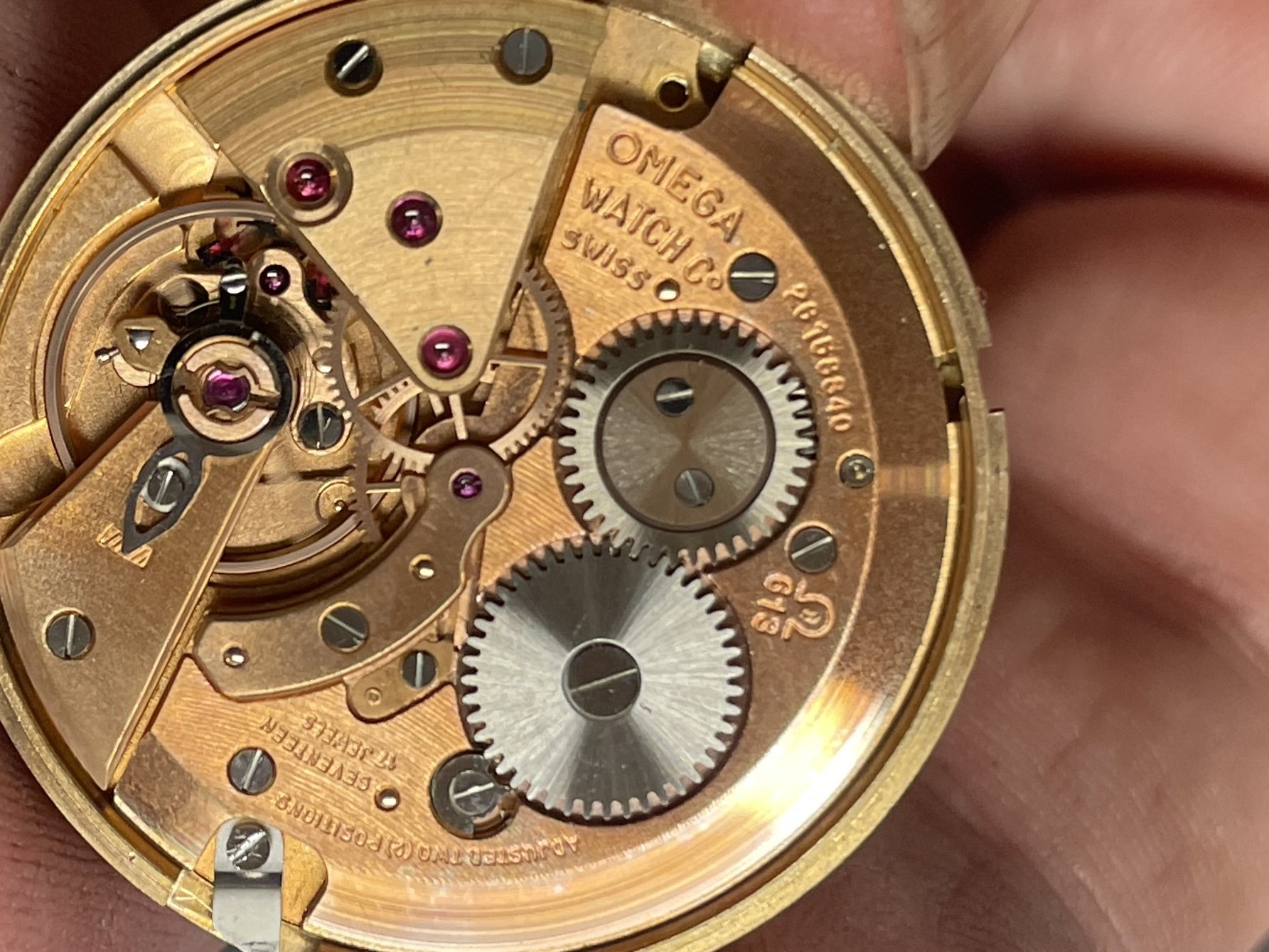

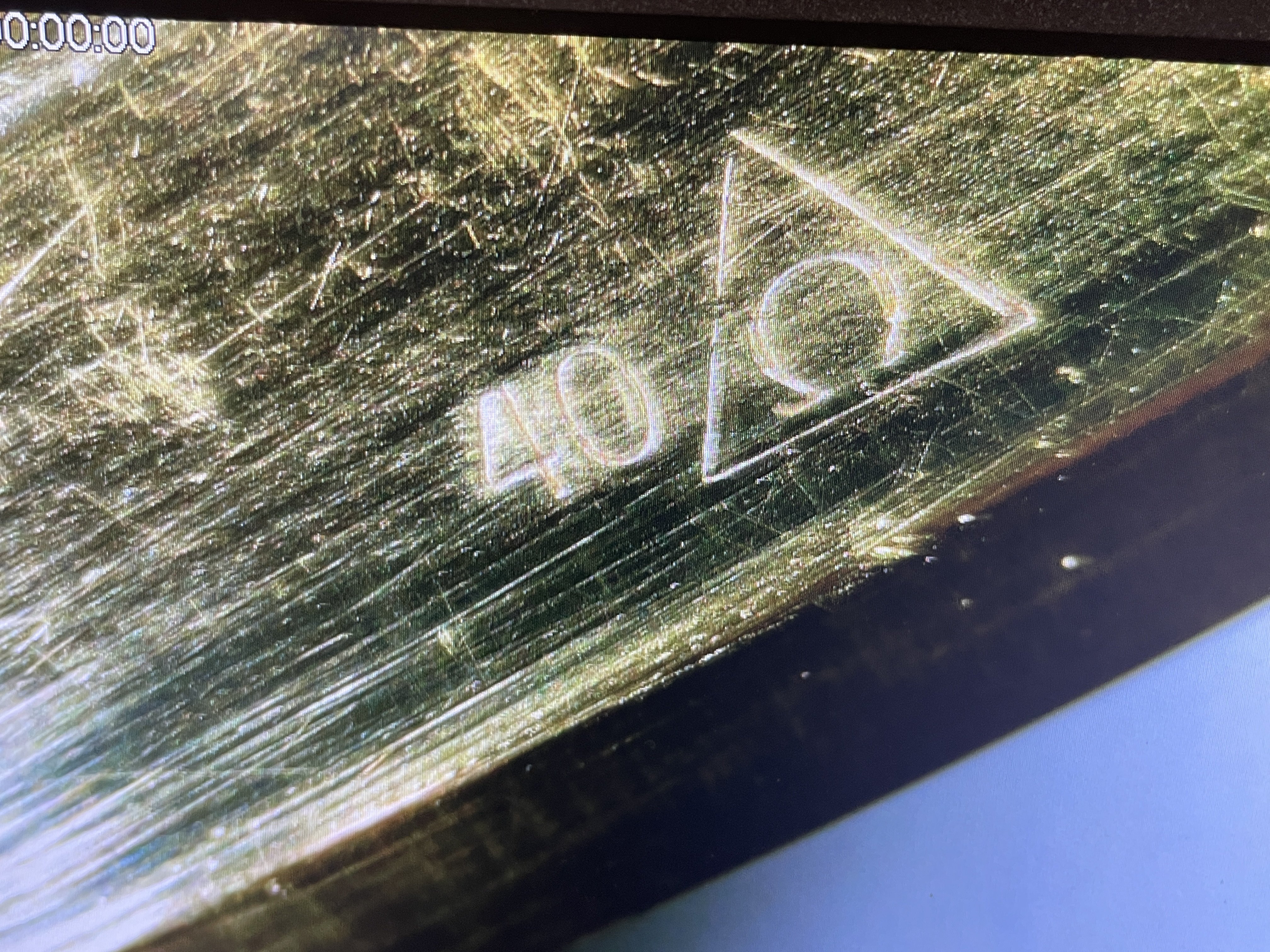

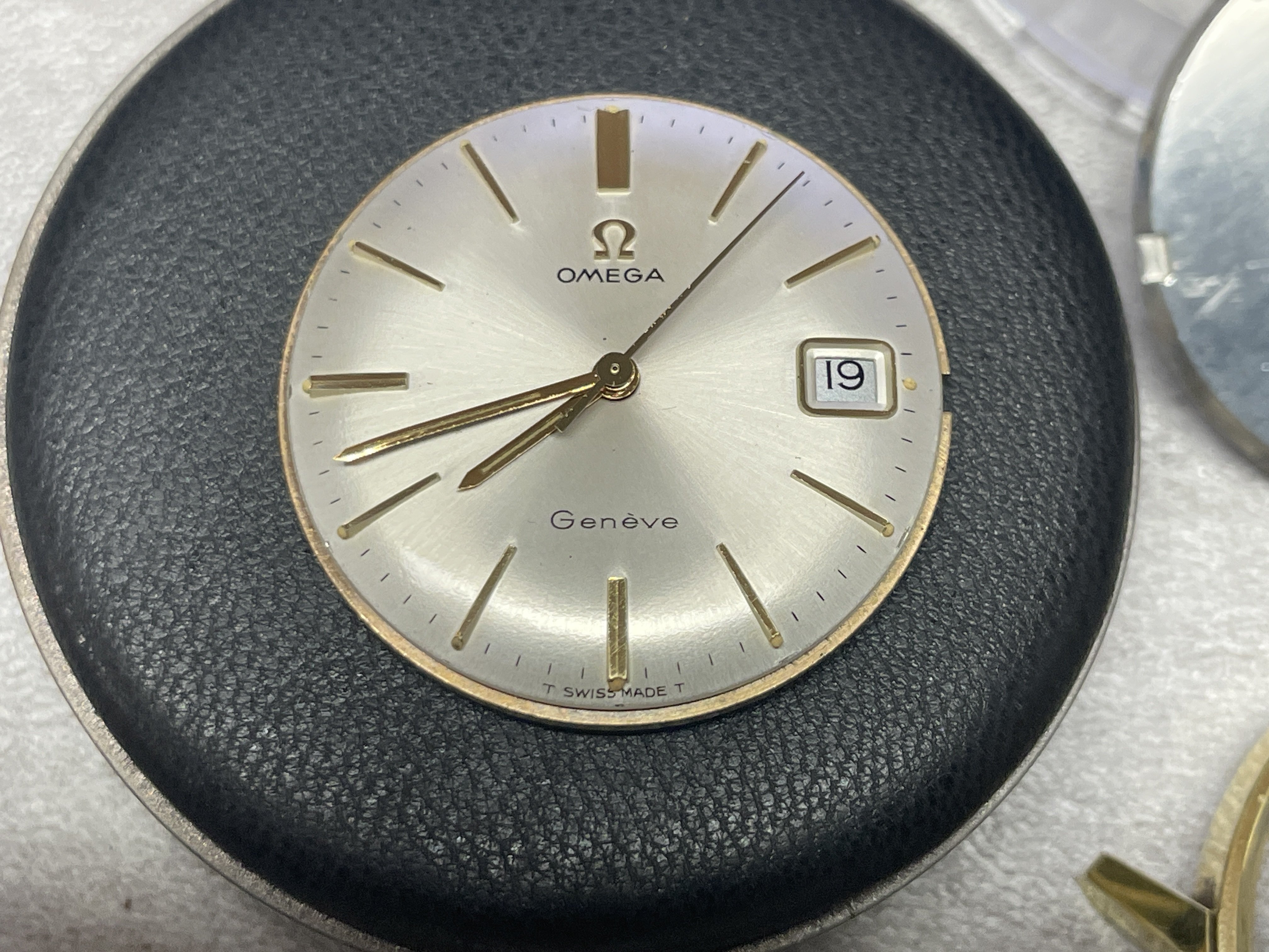

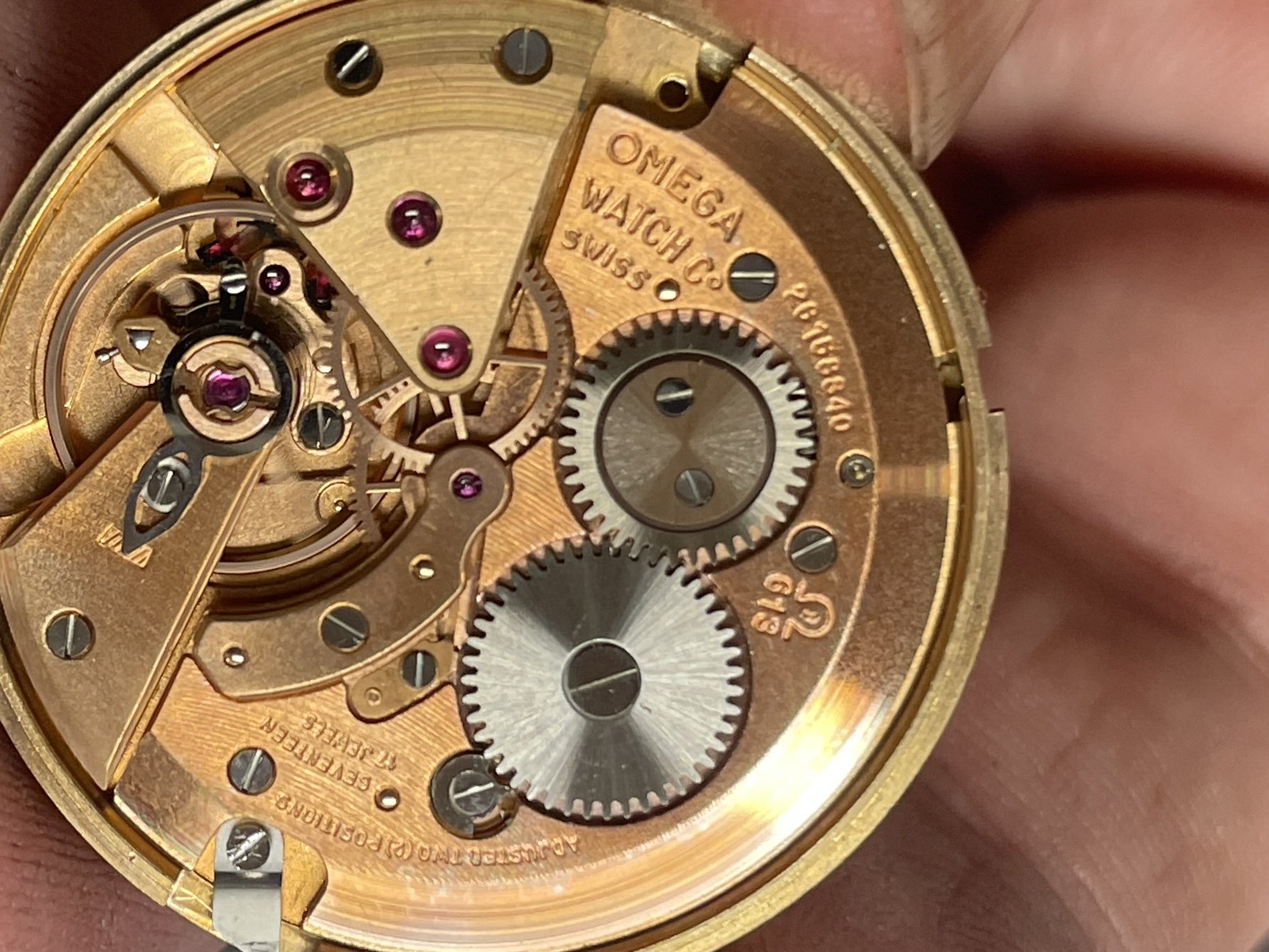

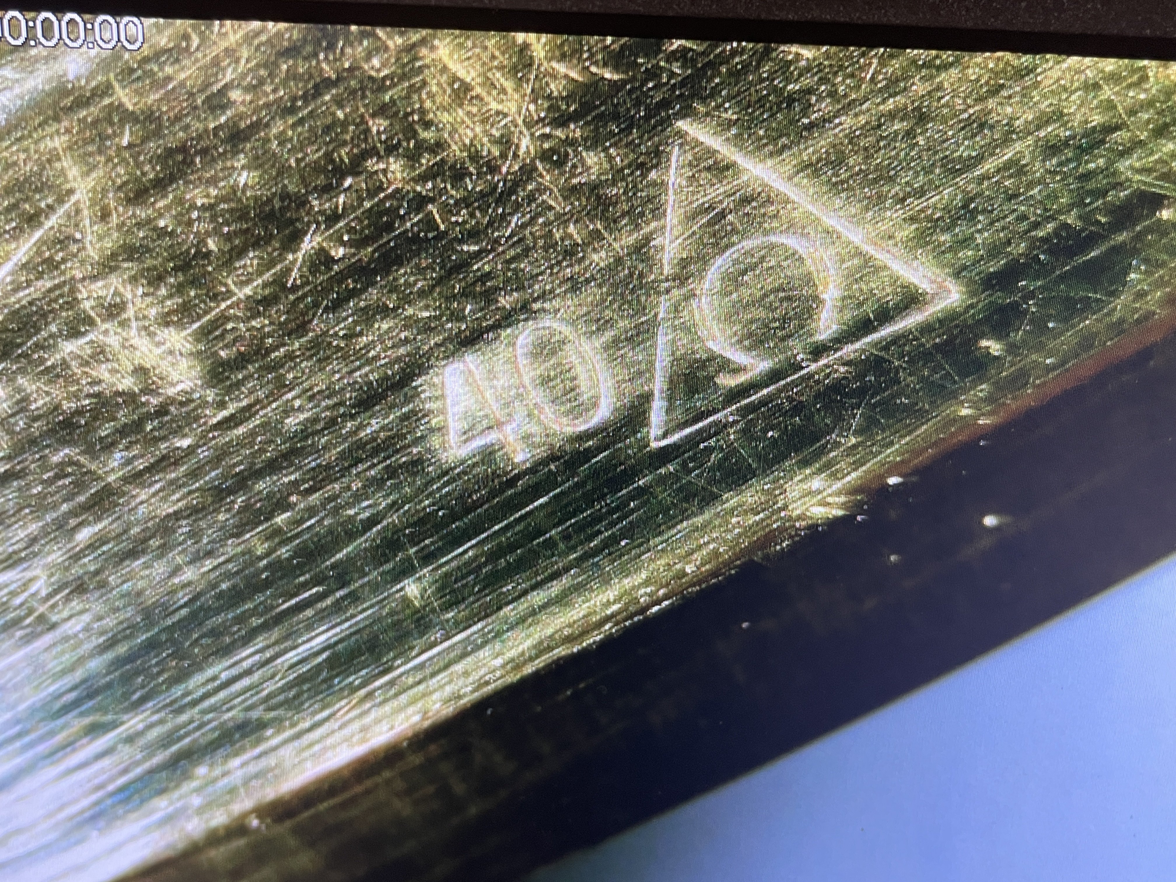

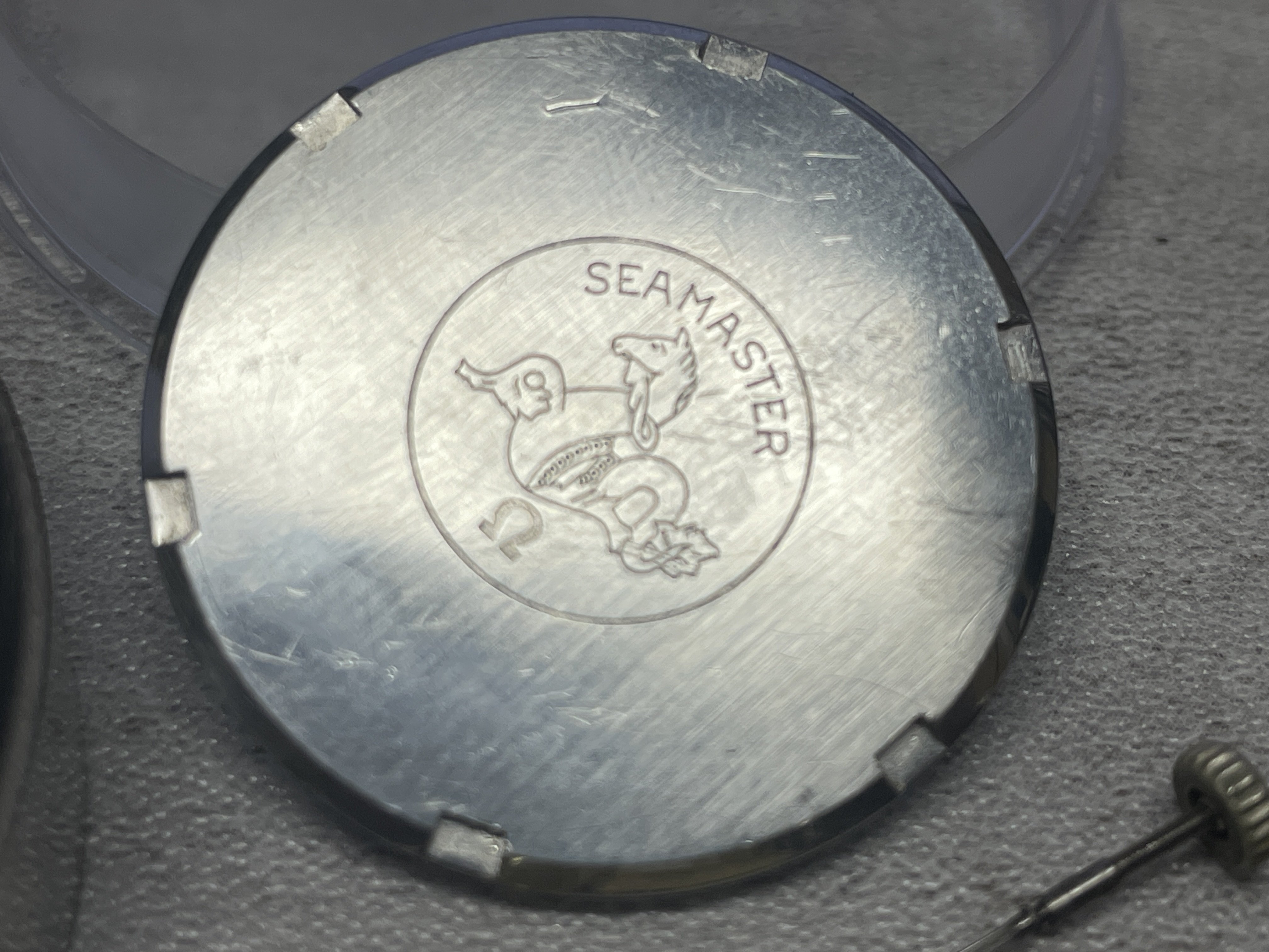

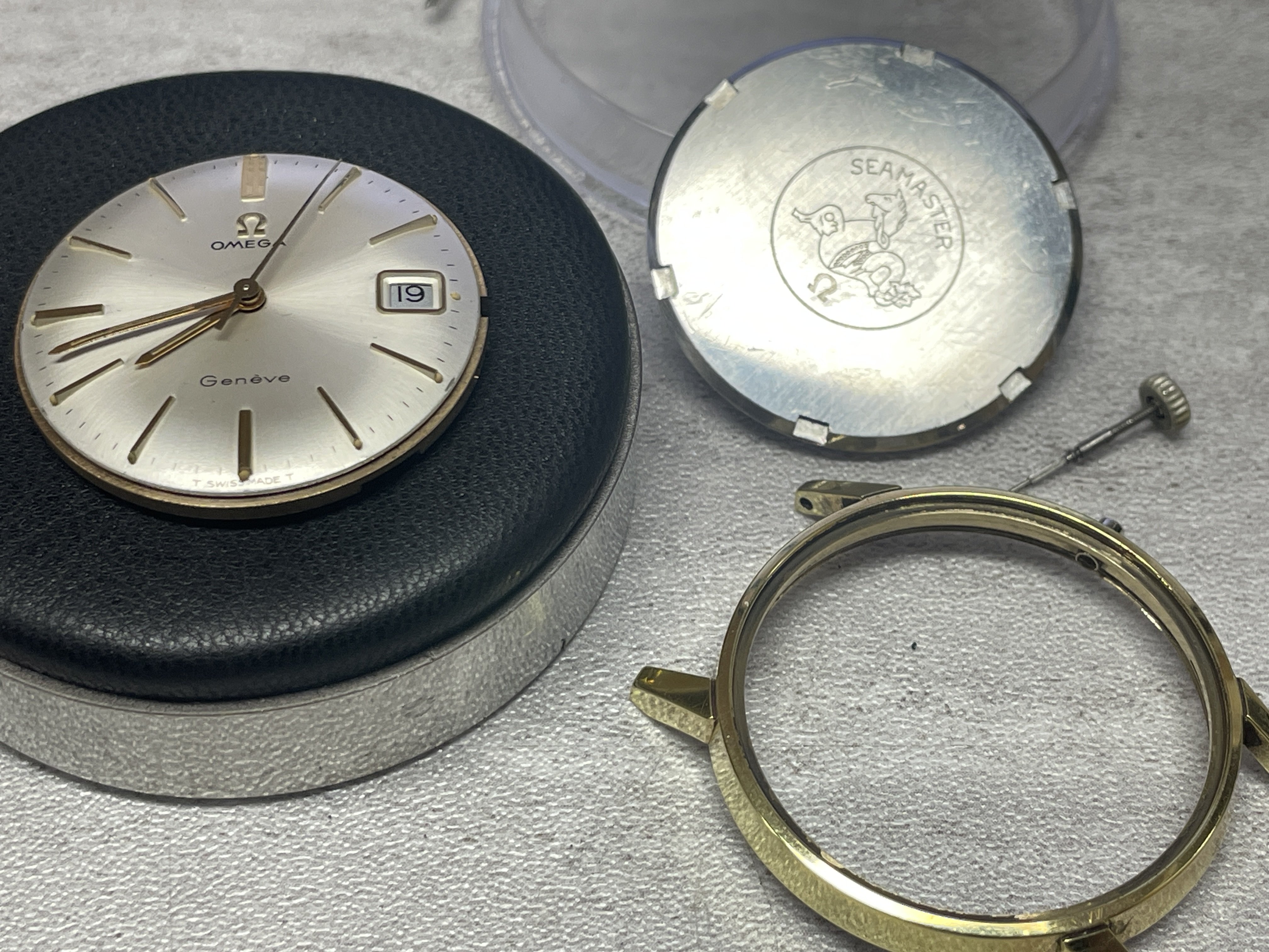

Is there an actual '68 Geneve Seamaster? Caseback has seamaster on it and front Geneve. The case has "40 with omega logo on it. It measures approx. 34mm. Movement marked 613. Any help appreciated.

136.011 Inside case back

Yes this is a known combination, Geneve dial with this reference number.
The 40 marking indicates 40 microns gold plate.

thank you
