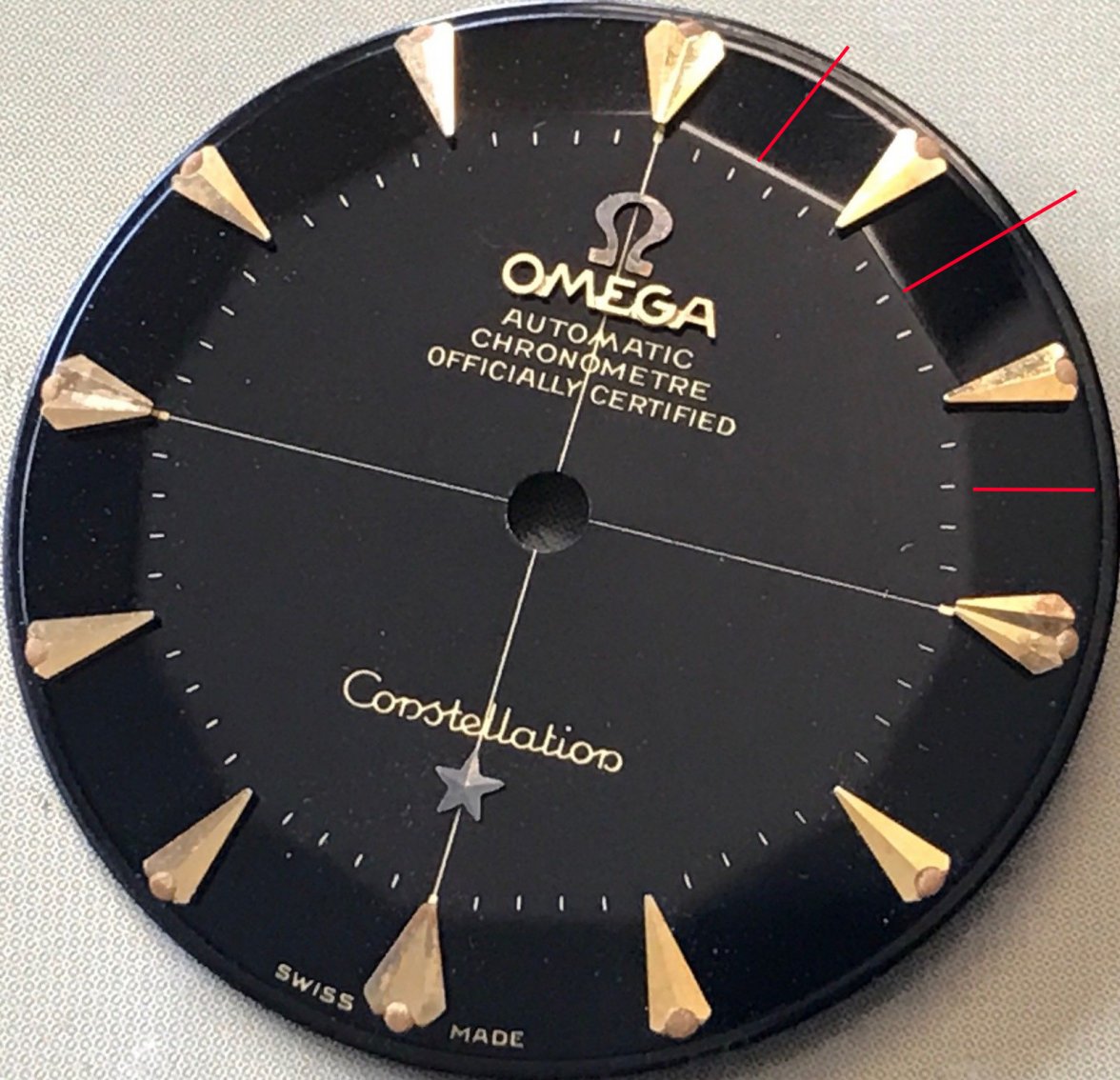

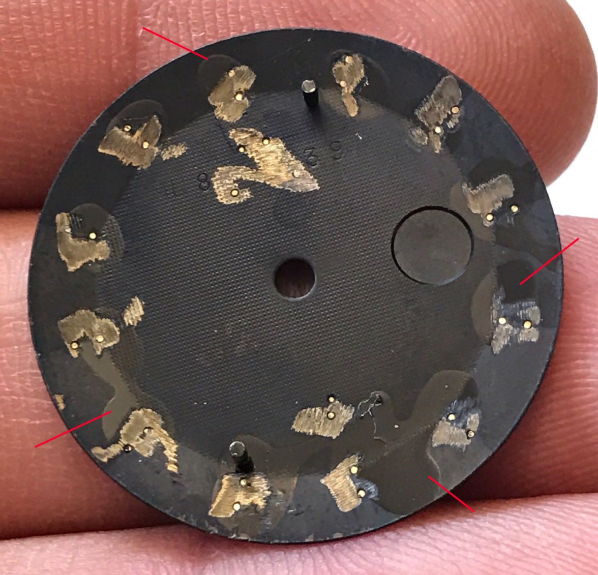

For sure cleaned and tampered with not original. Edge where pie-pan breaks is fuzzy and outer section is shiny unlike the center, evidence of cleaning. Back side clearly shows large traces of glue indicating the markers have been reattached.
Second one has way too much grinding on the back an indication that the figures have been reattached (tried to grind off the glue this time).
