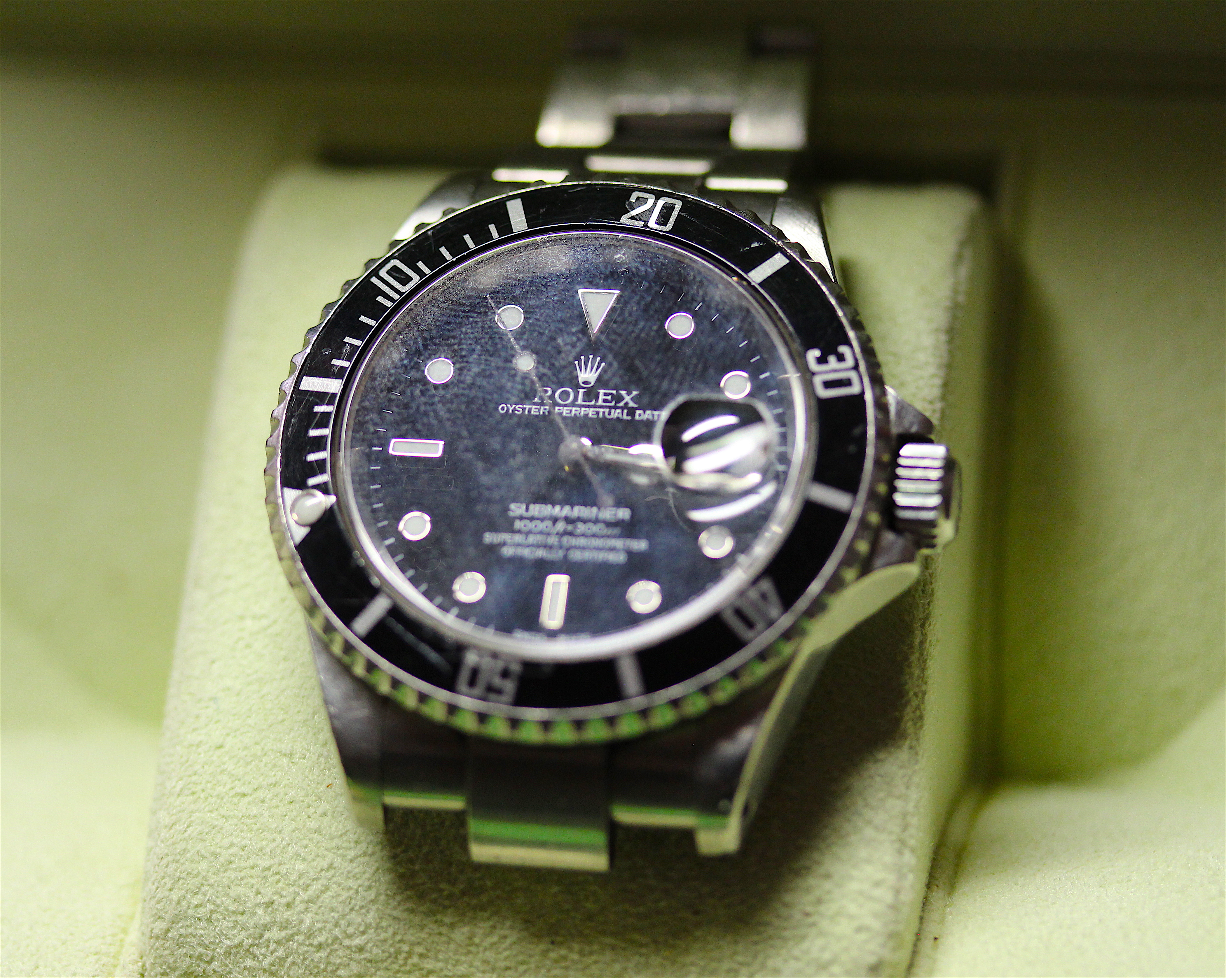

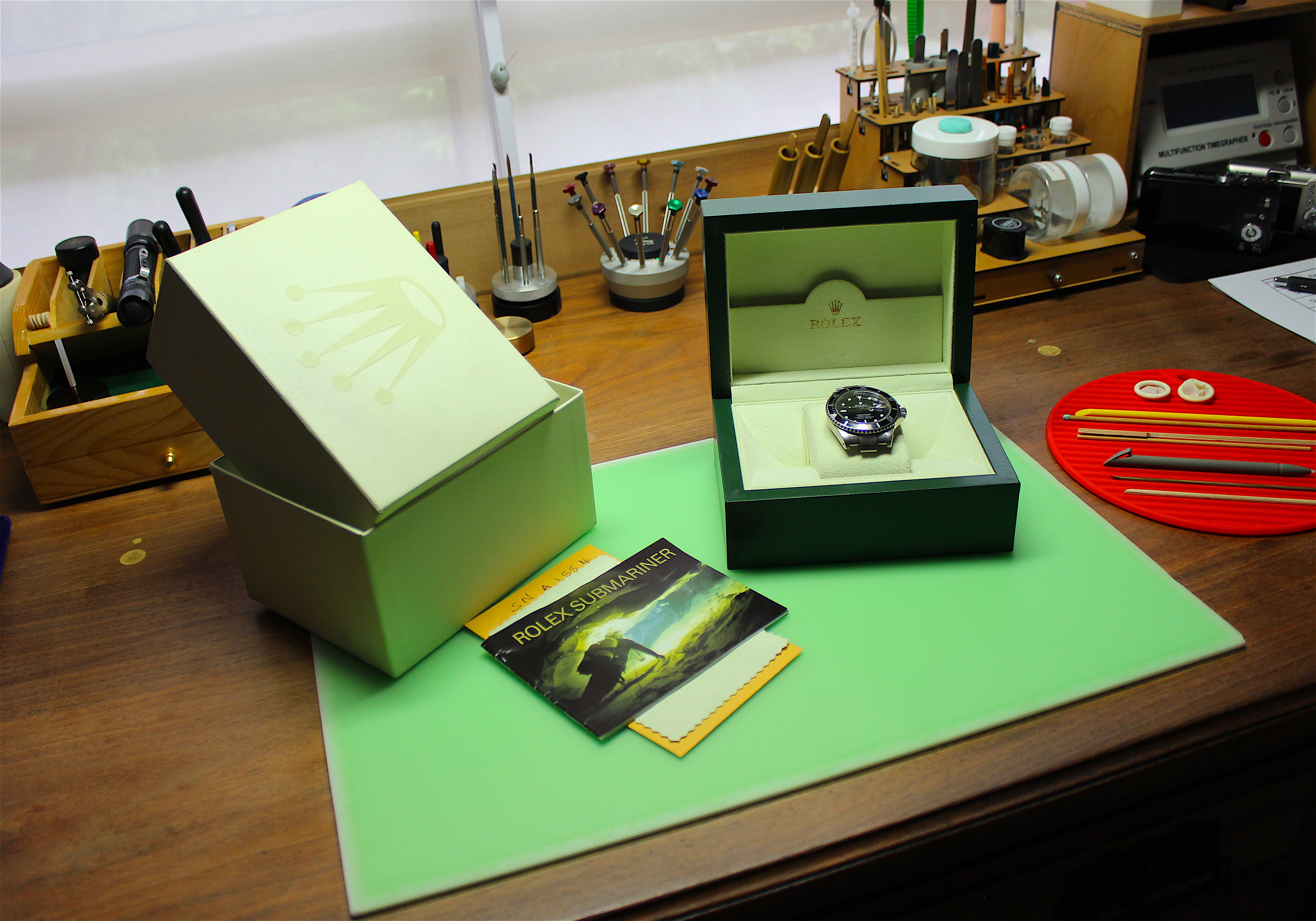

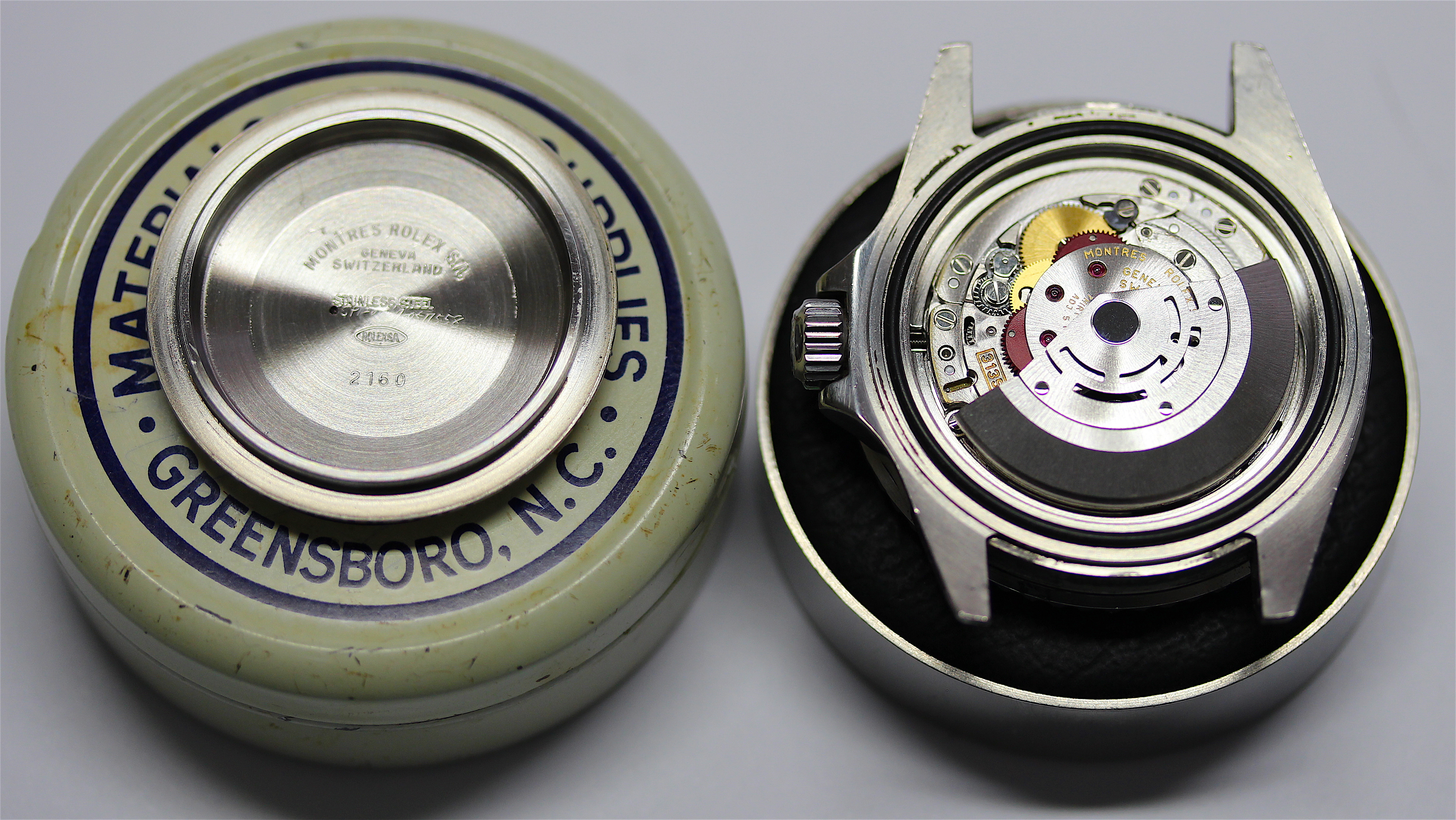

    So here's what he brought along,
    a rather beaten up 16610.
    The bracelet was broken, the case was marked with battle scars and the movement was stopped dead.

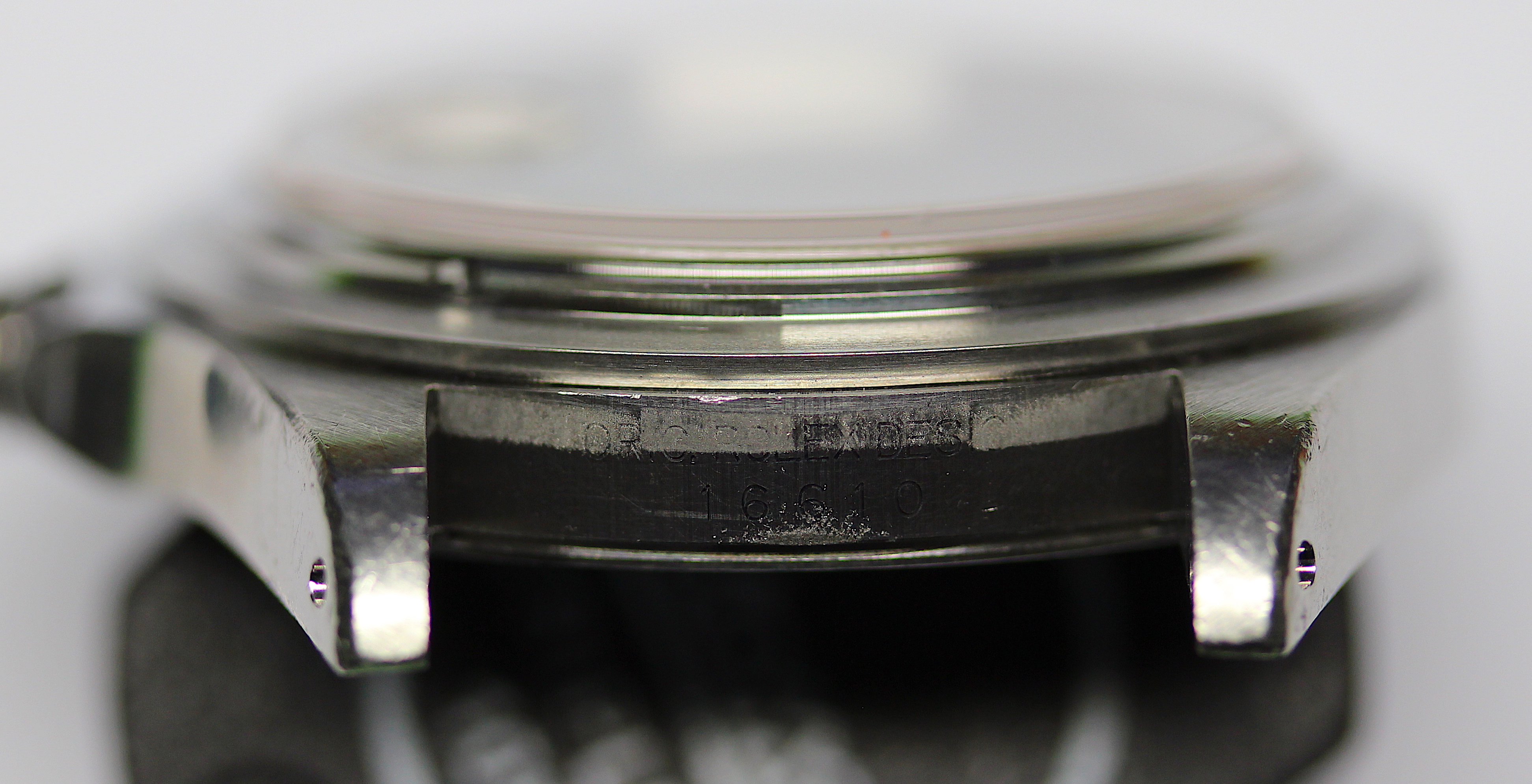

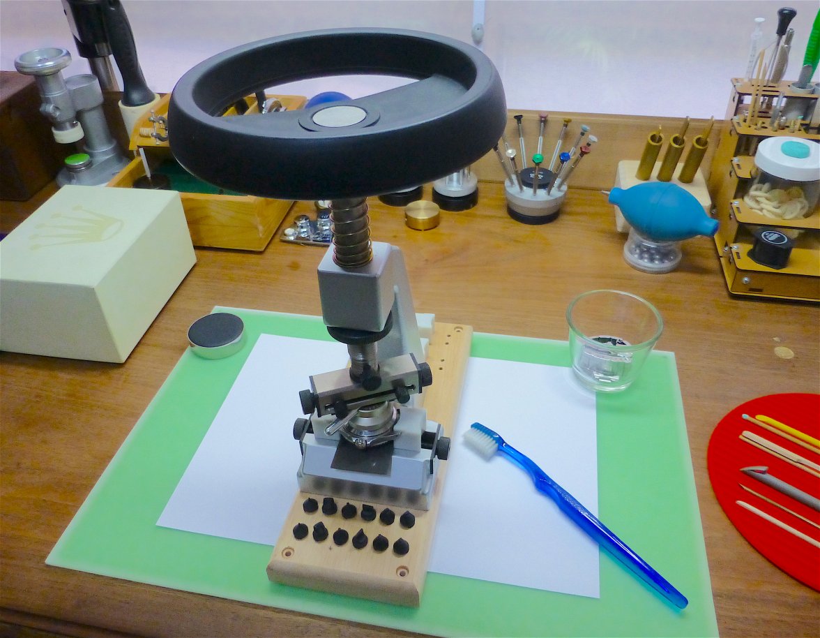

    First step was to remove the bracelet, thank heavens for drilled lugs!

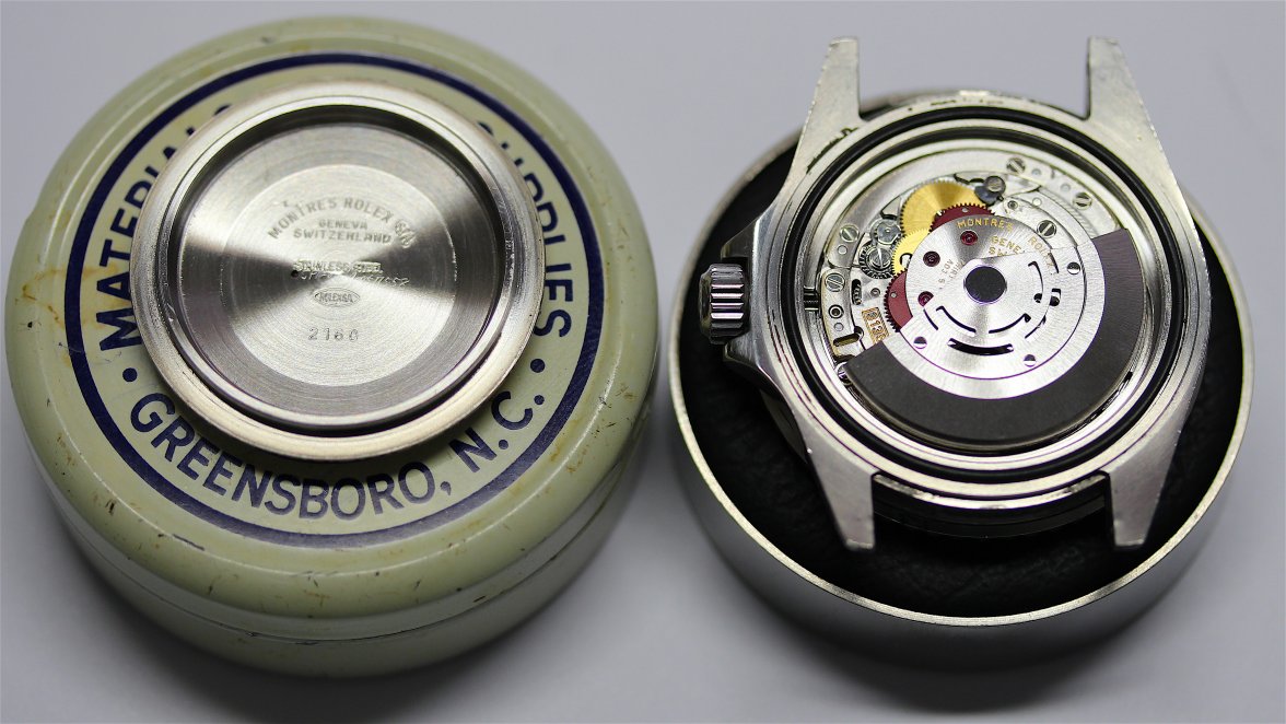

    After cleaning the caseback with a clean brush it was into the case opener to get the back loosened.
    The inside look OK, no water damage or other signs of corrosion and NO CRACKED ROTOR! The caseback has a prior service marking but unless it was done by Rolex the place and date are unknown.

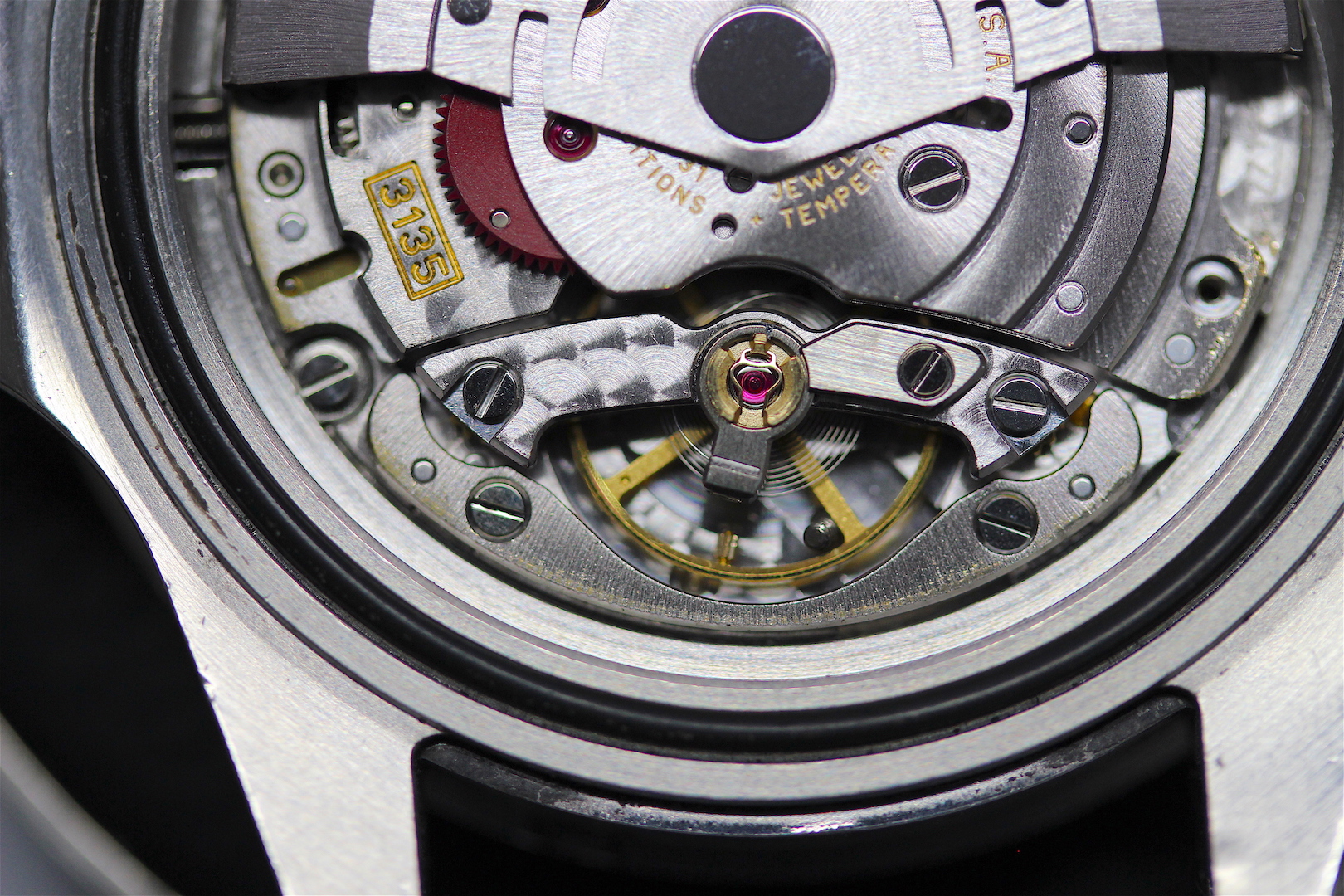

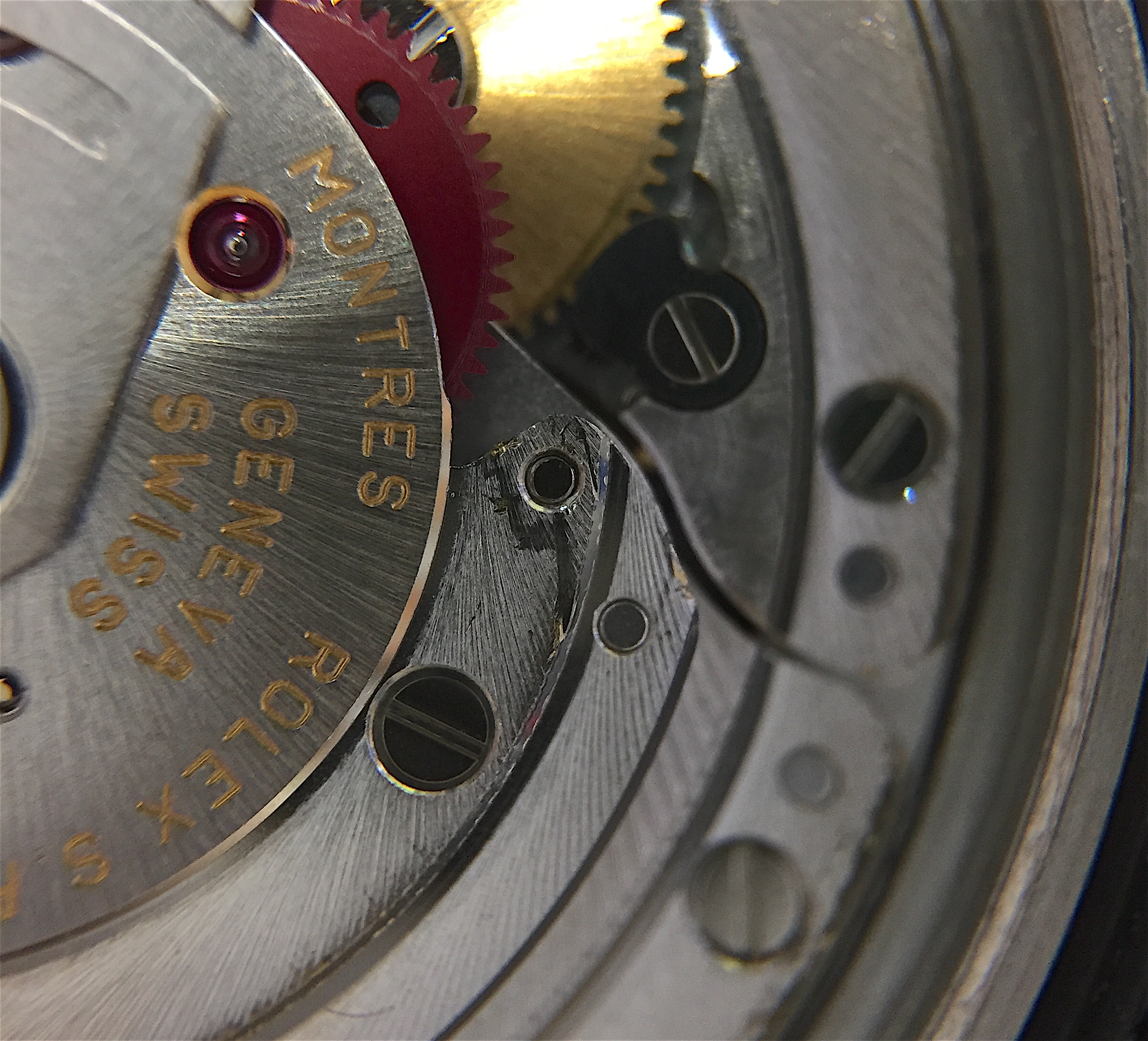

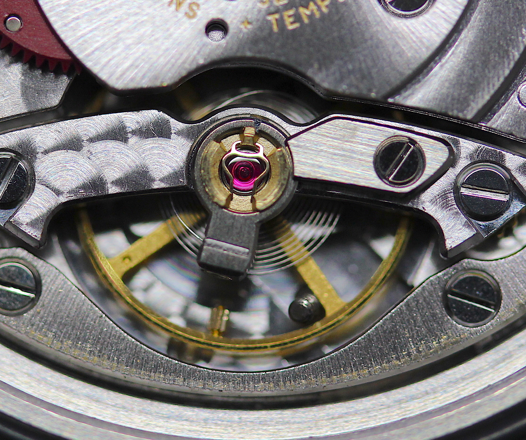

    Moving the rotor around exposes the balance assembly.

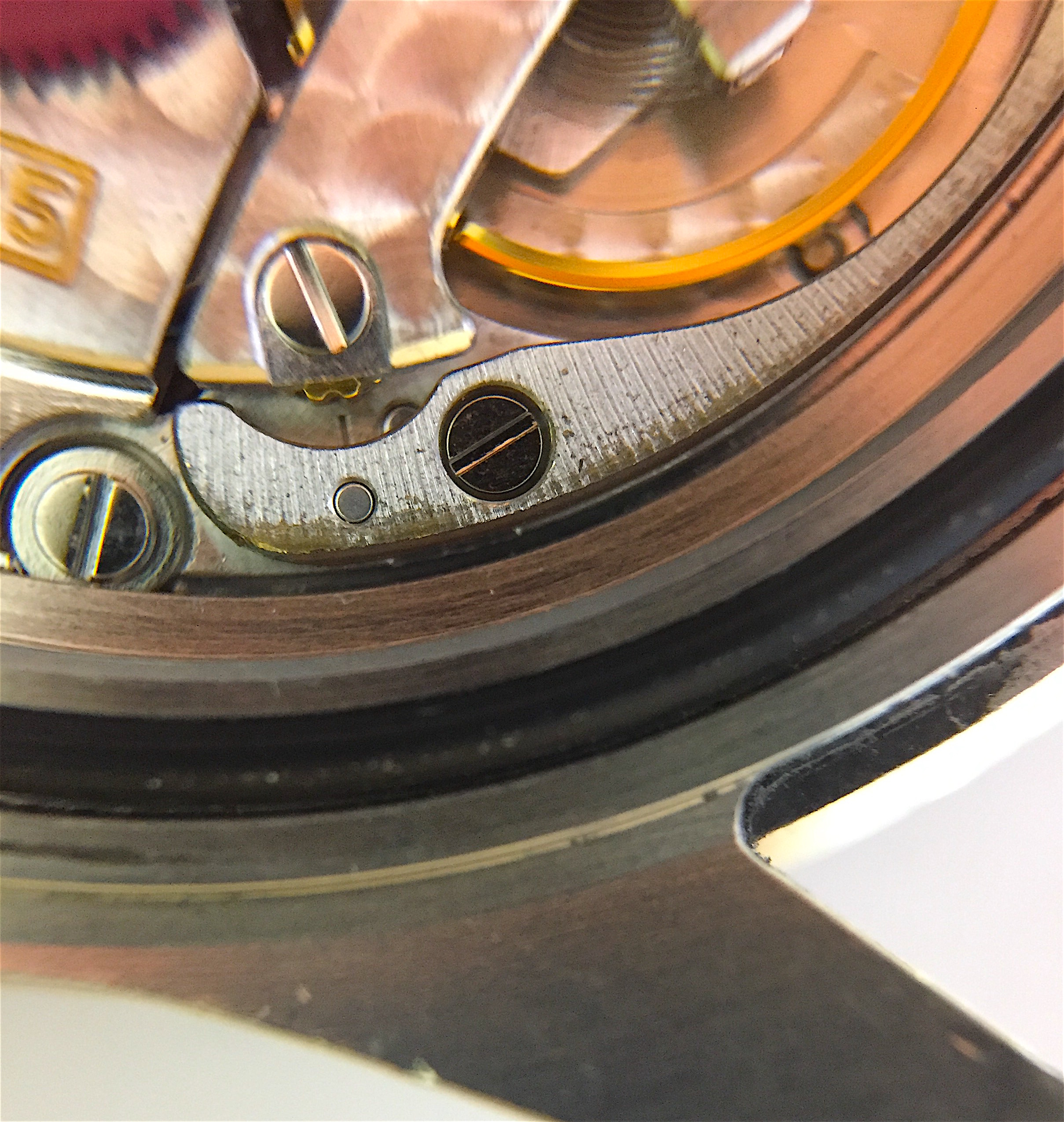

    And you don't have to be blind Freddie to see the problem. One of the bridge screw has come adrift and lodged under the balance wheel.
    With that carefully removed with my finest brass Dumont 4 tweezers the balance started again.
    Looking around before the lid was closed I noticed some scuffing from the rotor which I suspect may be the reason for the first service.
    And also evidence of "prior work".

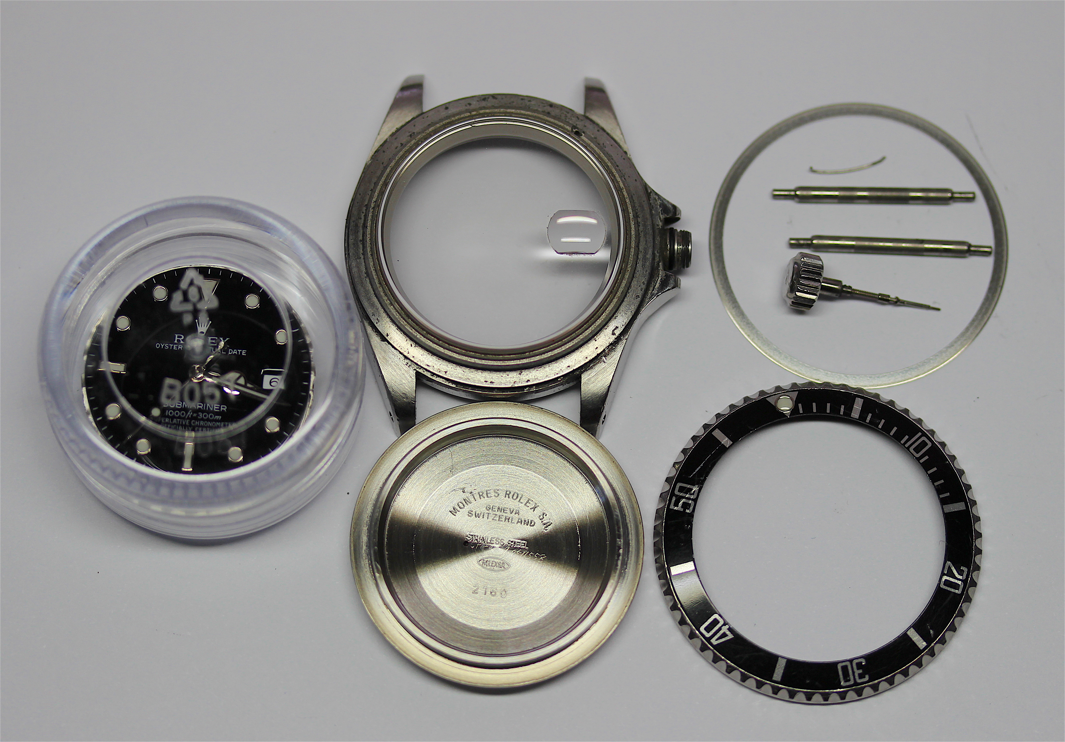

    Now all taken apart ready for cleaning.
    Some great gunk here, but not the worst I've seen.
    The case, caseback and bezel will all be given a thorough ultrasonic clean and then re-assembled.

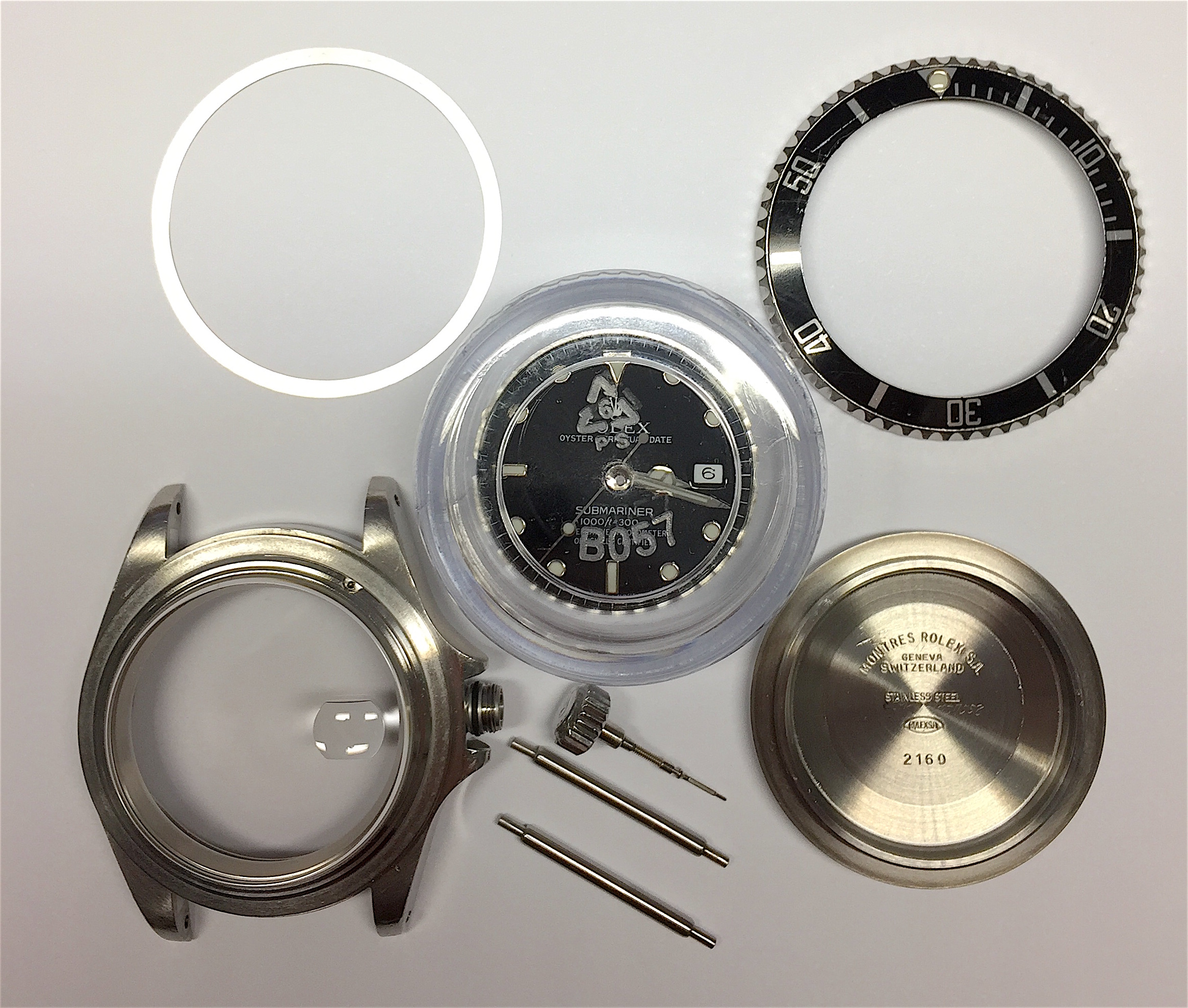

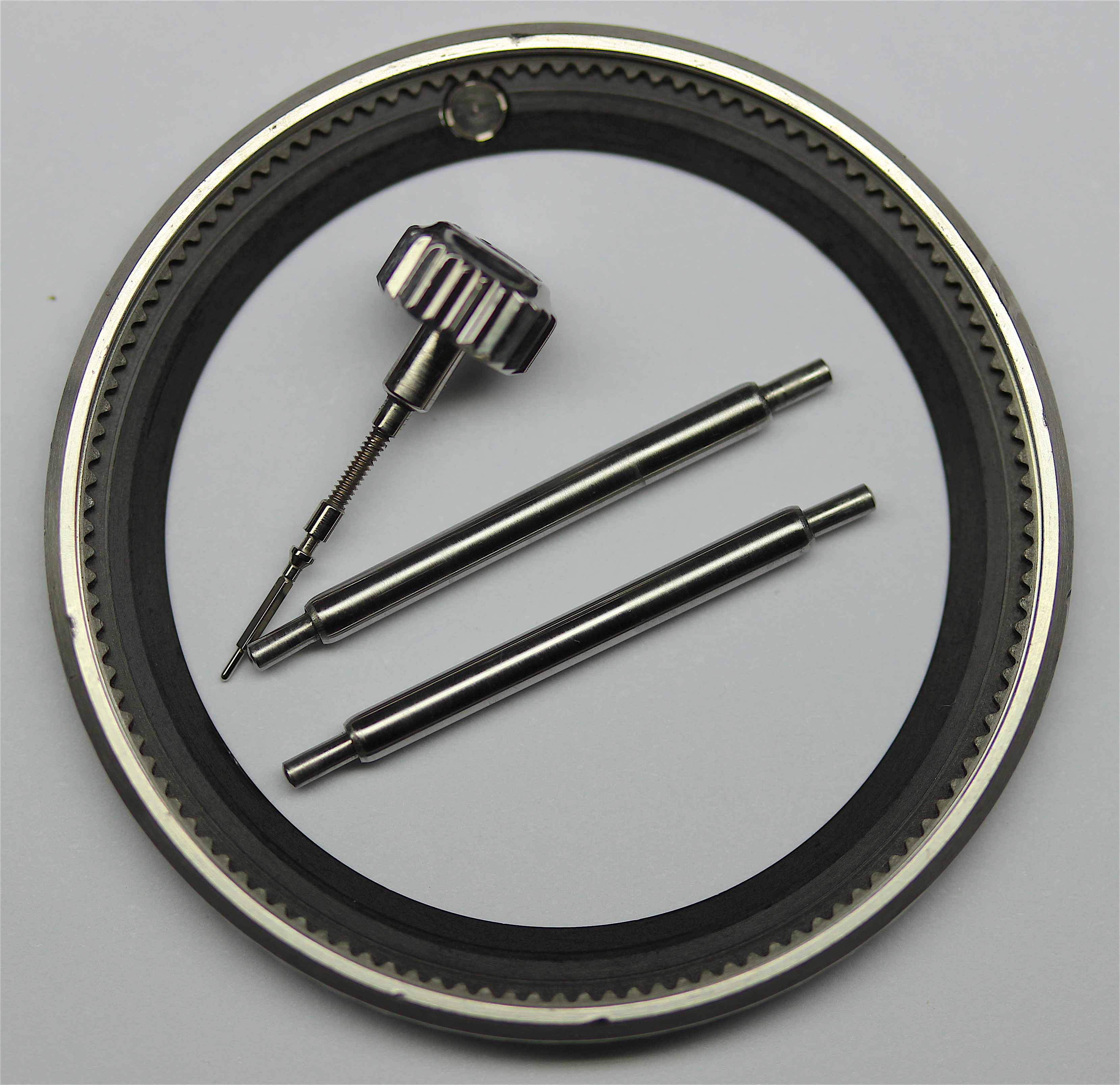

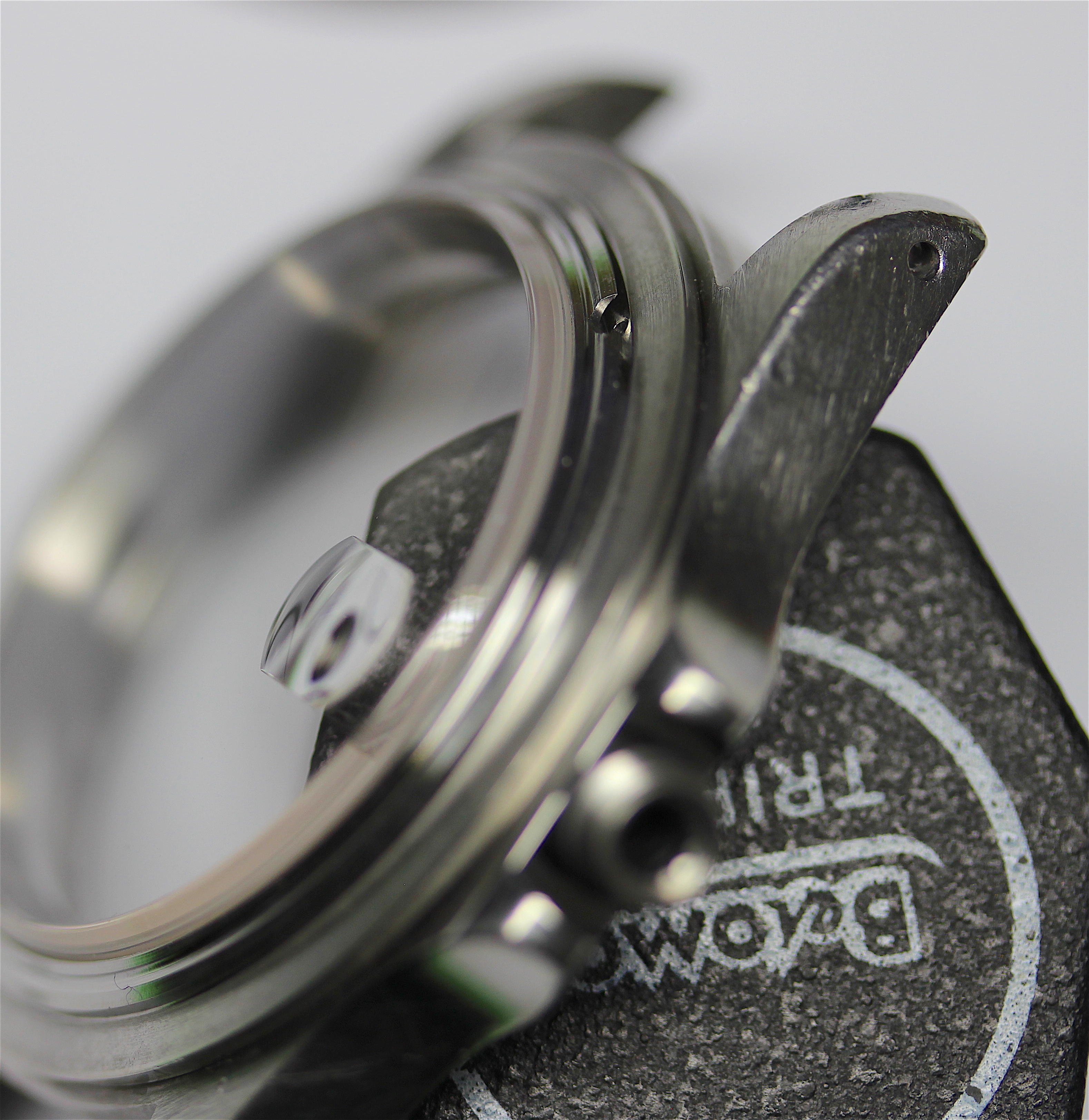

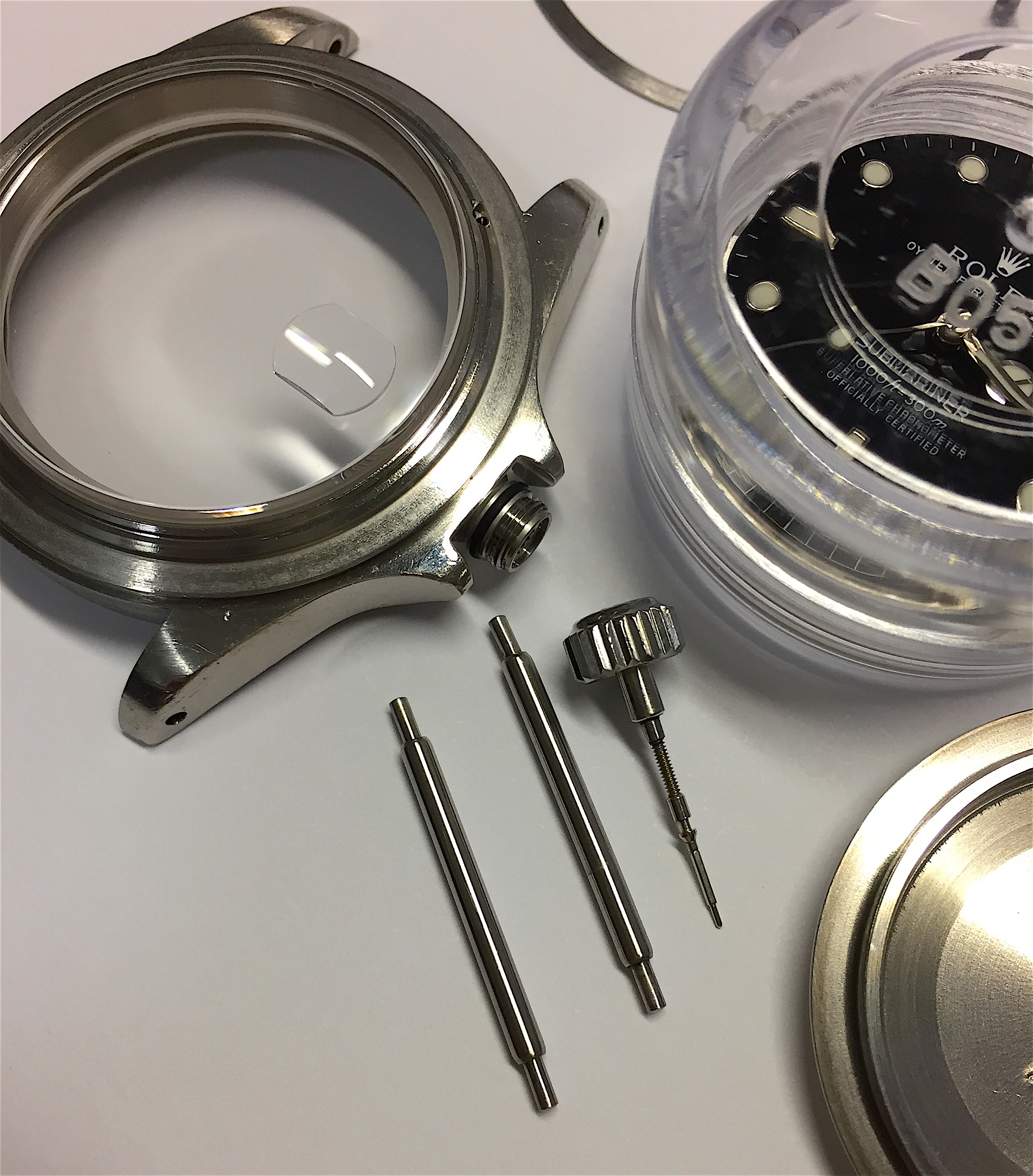

    So where did I get to, ah yes, ready for cleaning.
    All parts got scrubbed with an ultrasonic toothbrush and dish liquid, then some went into the ultrasonic bath (NOT THE BEZEL!)

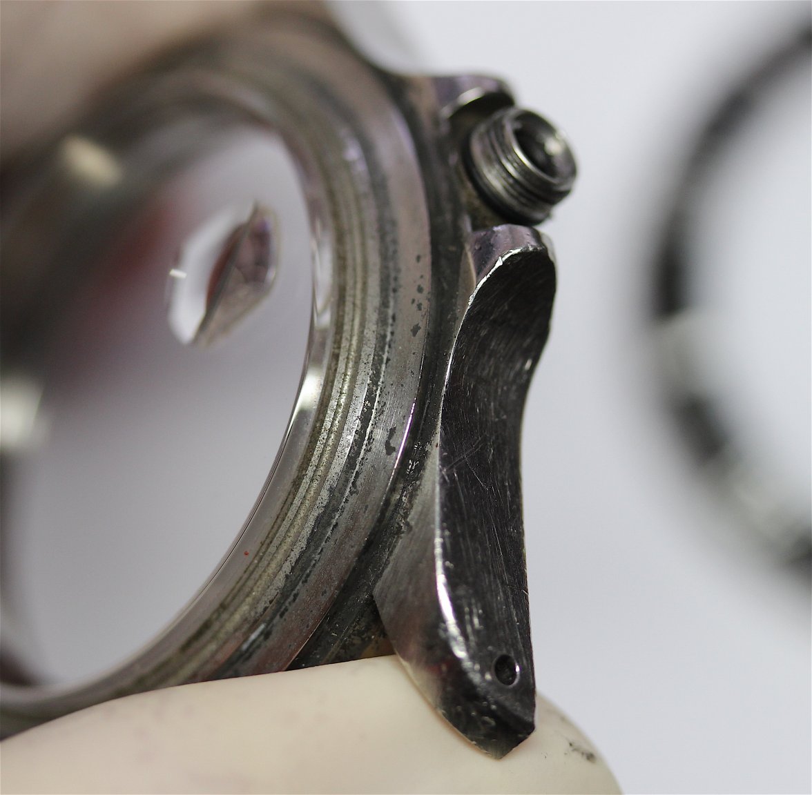

    The case shows signs of hard use and I'm not sure if I should do a mild re-brush or just leave it as is.
    Nice to see all of the gunk gone. Compare it to the earlier shot of the same area.
    The bezel was cleaned with sharp pegwood and an ultrasonic brush.
    All parts nice and clean, almost like new.
    Now all parts ready to go back together. Points to the person who can tell me what's missing in the pic below.

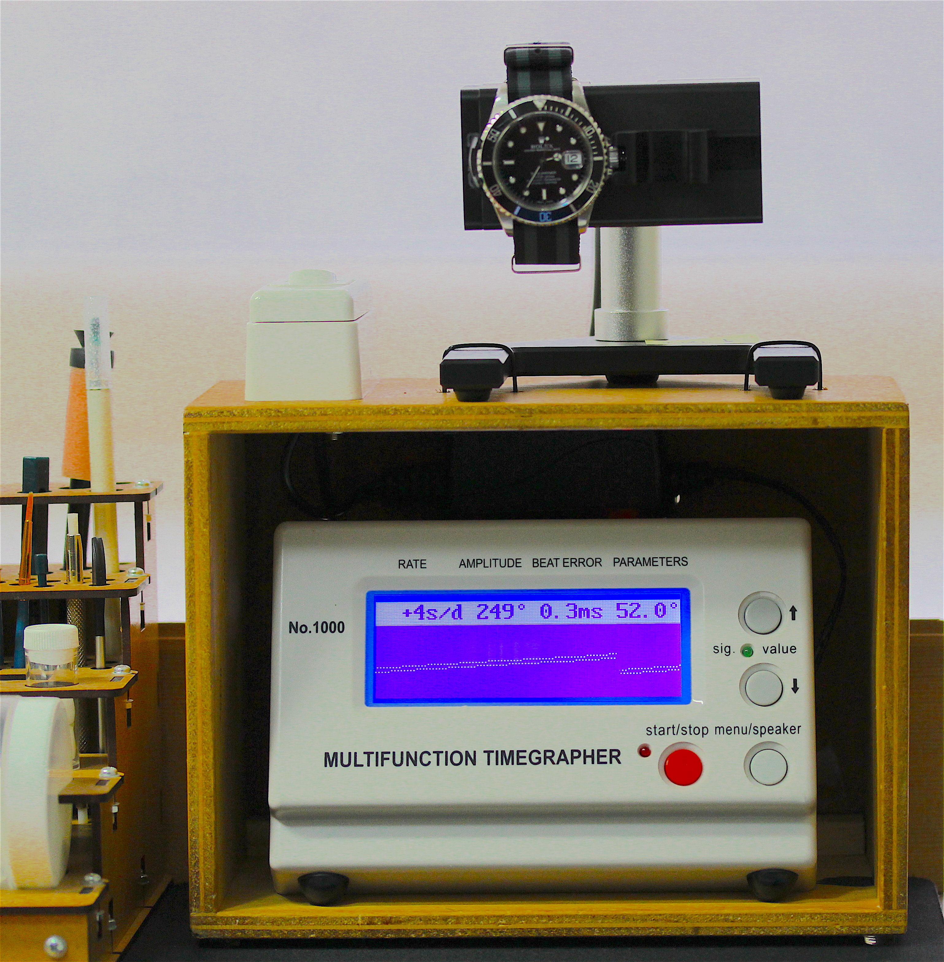

    So now we are ticking away nicely on the timegrapher. Proper checking to be done later.

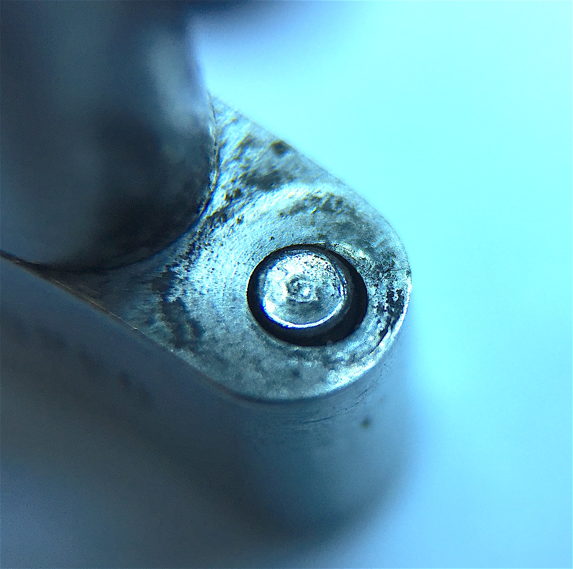

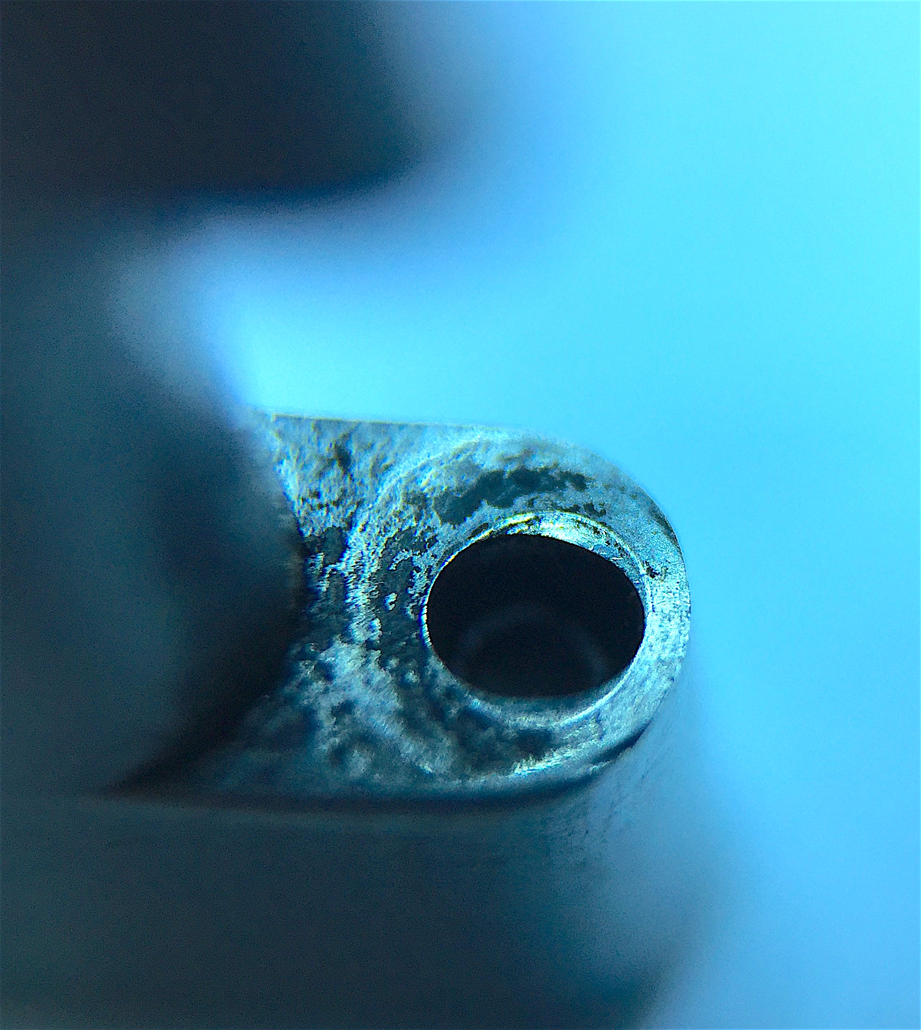

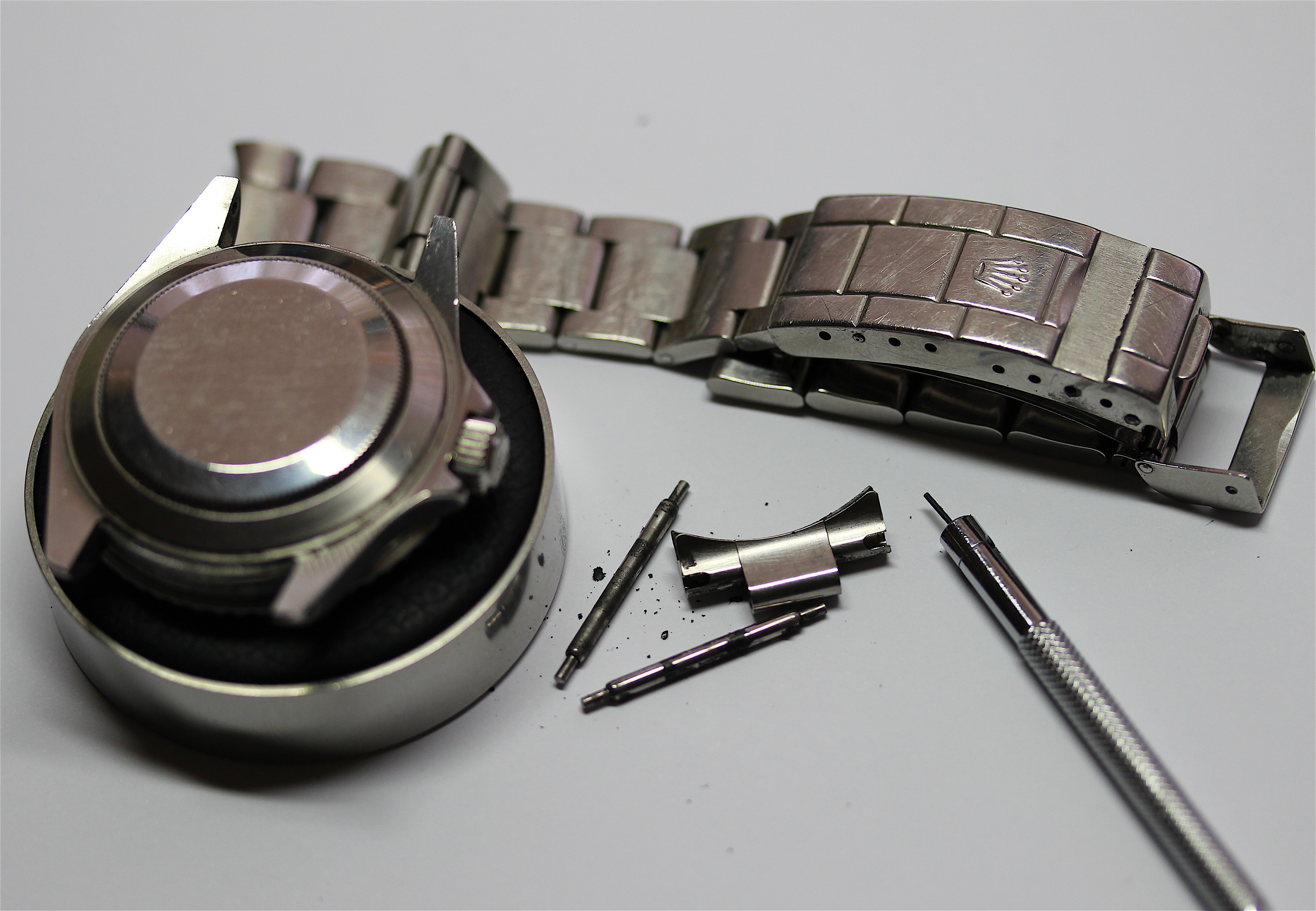

    Next phase is the bracelet which was problematic due to the link pin being sheared off in the side links.
    This is one side with the missing pin.
    This is the other side link with the broken part still embedded.
    Fixing this will be fun.
  17. PaulC77 Jun 12, 2017
    326
    1,568
    I'll play what's missing from the pic, is it the bezel spring?
    watch3s likes this.
  18. JimInOz Melbourne Australia Jun 12, 2017
    15,492
    32,385
    :thumbsup:
    watch3s likes this.
  19. watch3s Jun 12, 2017
    1,363
    821
    has someone removed that bezel a lot? theres a few marks on the underside
  20. JimInOz Melbourne Australia Jun 12, 2017
    15,492
    32,385
    Not surprising considering the marks on the movement. The owner didn't buy it new so who knows the history.
