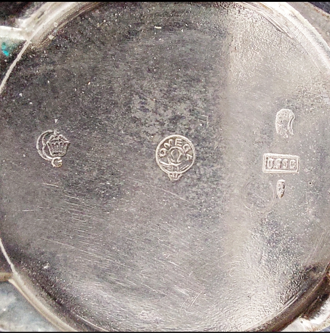

I find the guts to be somewhat unexpected but exciting! The hallmarks on the right appear to be the Swiss Bear for fine silver but I can't find the one on the left that looks like a crown.
I'd love to see them under a loupe.

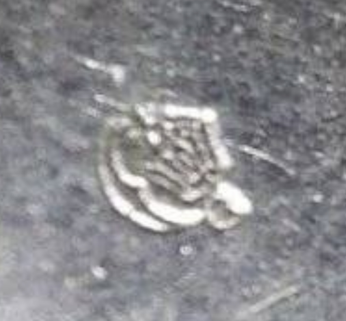

iPhone loupe to the rescue:
There’s your crown.
Crescent moon/crown was for items exported to Germany from Switzerland.
All other marks look fine to me.

@UncleBuck I managed a cleaner shot of the hallmark, it's a crescent moon with crown and "G" beneath as suggested above.
I did some digging, could the G refer to "Gallone" - "a silver case finished in gold leaf"? Perhaps it refers to the movement as it clearly has been gold plated at one point.
Also the seller had labeled the watch as a "damenuhr" so could that have anything to do with the different movement/dial variation on this model? It's a 30x40mm case which at the time could very well have been a men's watch though.. 😕🍿

This is definitely a men´s watch
And don´t worry about the case - it is all right with it. Hallmarks are legitimate

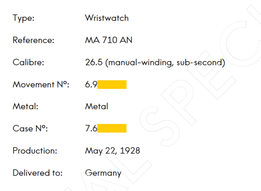

I'll send a request to Omega as you suggested
93
214
@mac_omega @UncleBuck looks like we have some interesting news back from our friends at Omega 📖
and we'll be celebrating a birthday soon ::psy::
Thanks all for your help and Erich for suggesting the EoA, this is exciting.. now to find an example of an original dial!
