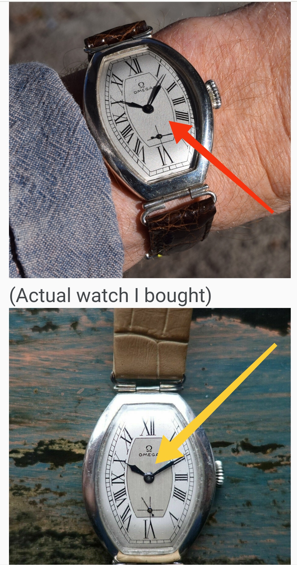

(Possibly the same watch, this one was on sale in ~2014)
(Actual watch I bought)

The watch case seems to be authentic (except the crown) but the dials on both watches are bad re-prints.
Photos could show the same watch... 馃槙

The watch case seems to be authentic but the dials on both watches are bad re-prints
Well, I don't know I'd call it "bad" besides the logo now that you point it out.. but I guess I had overlooked that. Could you estimate an approximate valuation?

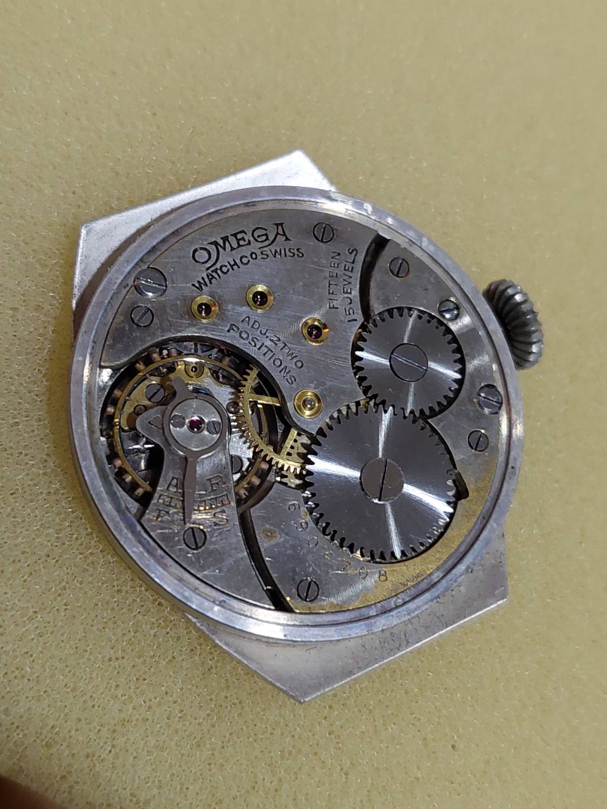

The movement should not be a cal. 26.5 but a gold plated cal. 13麓麓麓
Looks like this:

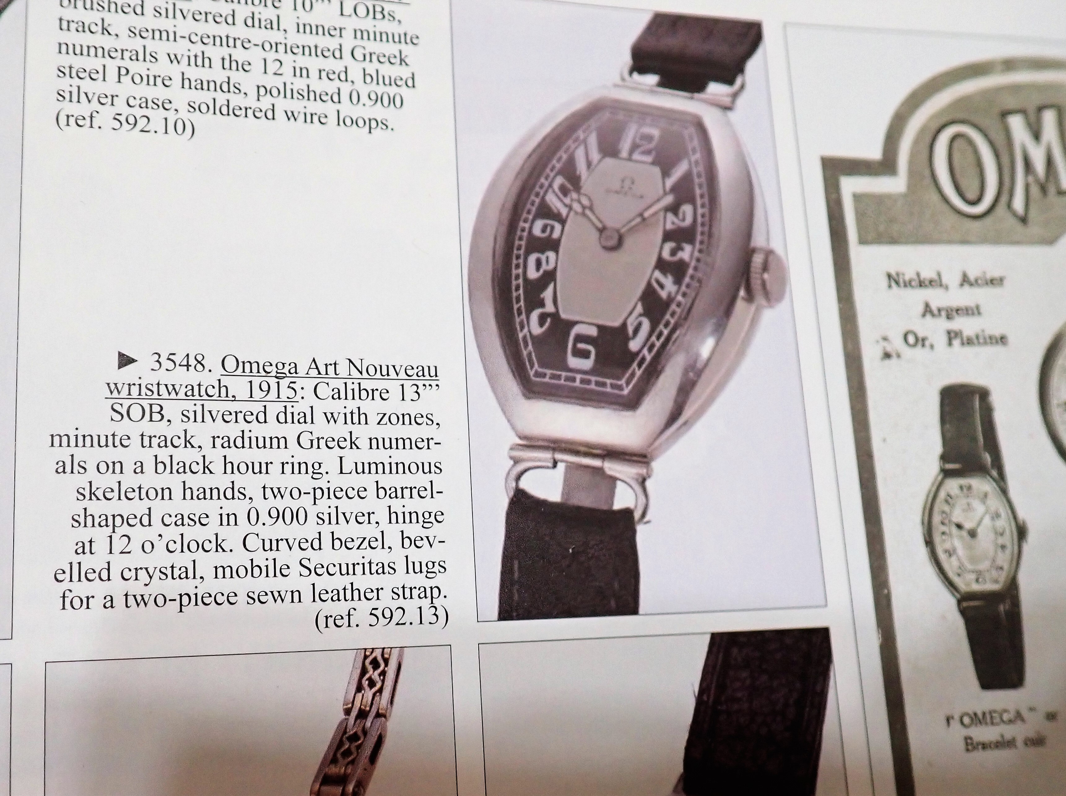

Case model# (ref.#) is 592.13
the watch is much older than you expect. - It is around 1915

Tonneau case with hinged "securitas" lug is an easy search, here is what AJTT shows.

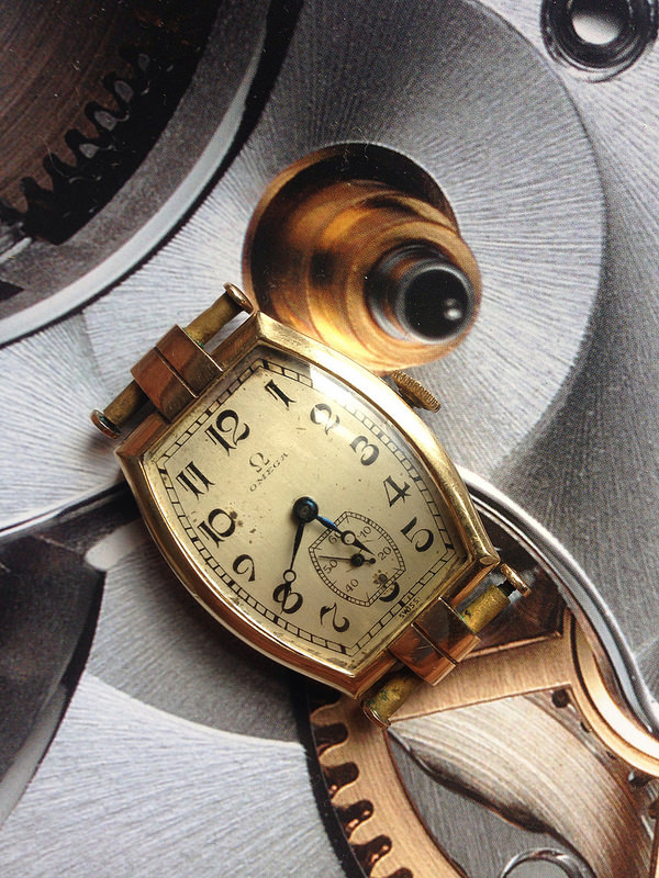

I appreciate the supportive words. I generally stay away from redials but I agree, I couldn't resist getting my hands on a tonneau and I think it looks quite alright, all things considered. I actually dug up another example of this model on antiquorum, but not sure if that one's original either - if logo should look more like yours and sub-second crosshair doesn't look quite centered with the 12/6 markers.. plus too clean? The crown looks similar to mine but it's hard to tell from just one photo, maybe both newer replacements. Also claims it to be house a cal. 12 - we'll see when mine arrives.
So you're the owner of that golden beauty .. saw this pop up in my searches recently, it's a fantastic piece! 馃憤

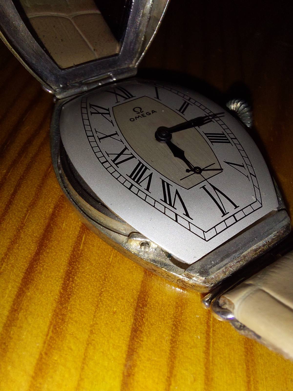

Please don麓t rely on what you see on randomly found photos. Both sources (Antiquorum and the large photo in the Omega book AJTT) show reprinted dials (I am sure it more likely looked as on the watch visible in the ad). Auction houses often don麓t have the expertise to describe watches accurately or they deliberately ommit crucial aspects like refinished dials in their lot description for obvious reasons 馃槖
Although Omega麓s book often is a great source of knowledge it is still full of misleading photos of restored watches.
My advice to you: better to rely on experienced fellow collectors on OF
@UncleBuck showed a well preserved (although a bit younger and different reference) - the logo and font should look similar
This is the logo as it should look like
It is a bit faded and on a "wave area" but it gives you an idea.
And another one from a socalled "Banana" of about the same era
These early watches often had "guilloched" (structured = engine-turned) surfaces on their dials

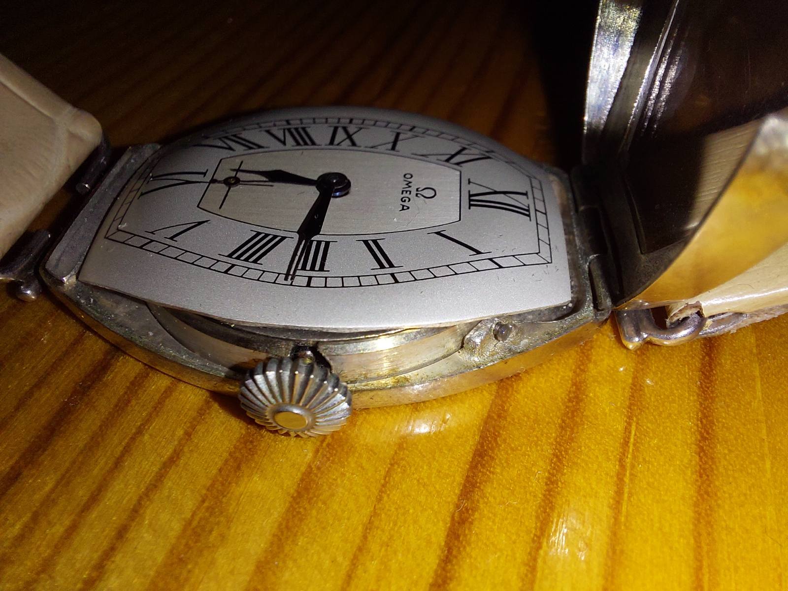

@mac_omega @UncleBuck so the watch just arrived today but I don't know how to get to the movement. I see there is a small flathead screw under the bottom left and top right corners of the dial, are these what is holding the movement in place? Is there a specific way to remove it afterwards to keep everything safe? Should I wait until the movement is stopped/unwound?
Also does this crown look like a replacement?
Cheers
Alex

From a candid eye 馃榾... Would like to point out that the one pictured in 2014' sale ad and photo by OP could not be the same watch ... since the OP seems to own a 2 tone dial. Perhaps in the meantime that dial has been "enhanced"?
Pls see photo below

I confirm that these 2 screws have to be removed, then you can take out the movement/dial unit without risk.
And yes, the crown is a replacement
Pls see photo below
I think it's just the angle and how the dial is catching the light that changes the appearance, I'm pretty sure they're the same watch.. I can recreate the same single color effect in the sun. The case itself otherwise feels like a dream in the hand and on the wrist 馃榾

Great, thanks for confirming. Sadly none of my micro-flathead screwdrivers are thin enough to catch the screw so I'll likely visit a local watchmaker tomorrow if I don't find any other tools in the meantime.

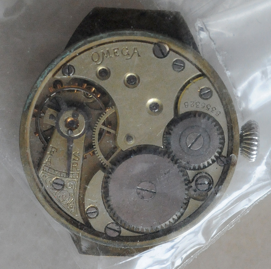

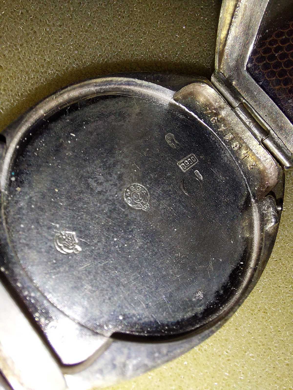

@mac_omega @UncleBuck I managed to get it open but the movement doesn't seem to match, perhaps a later caliber? Do the case hallmarks even look authentic? 馃槙 Apologies for the unclear case photo
3,653
7,770
Case markings look OK
the movement looks like a cal. 26.5 which is a bit younger than the usually found cal 13麓麓麓
IMO this watch deserves an EoA - but give them the case serial# only as these early watches are searched by case# in the archive.
