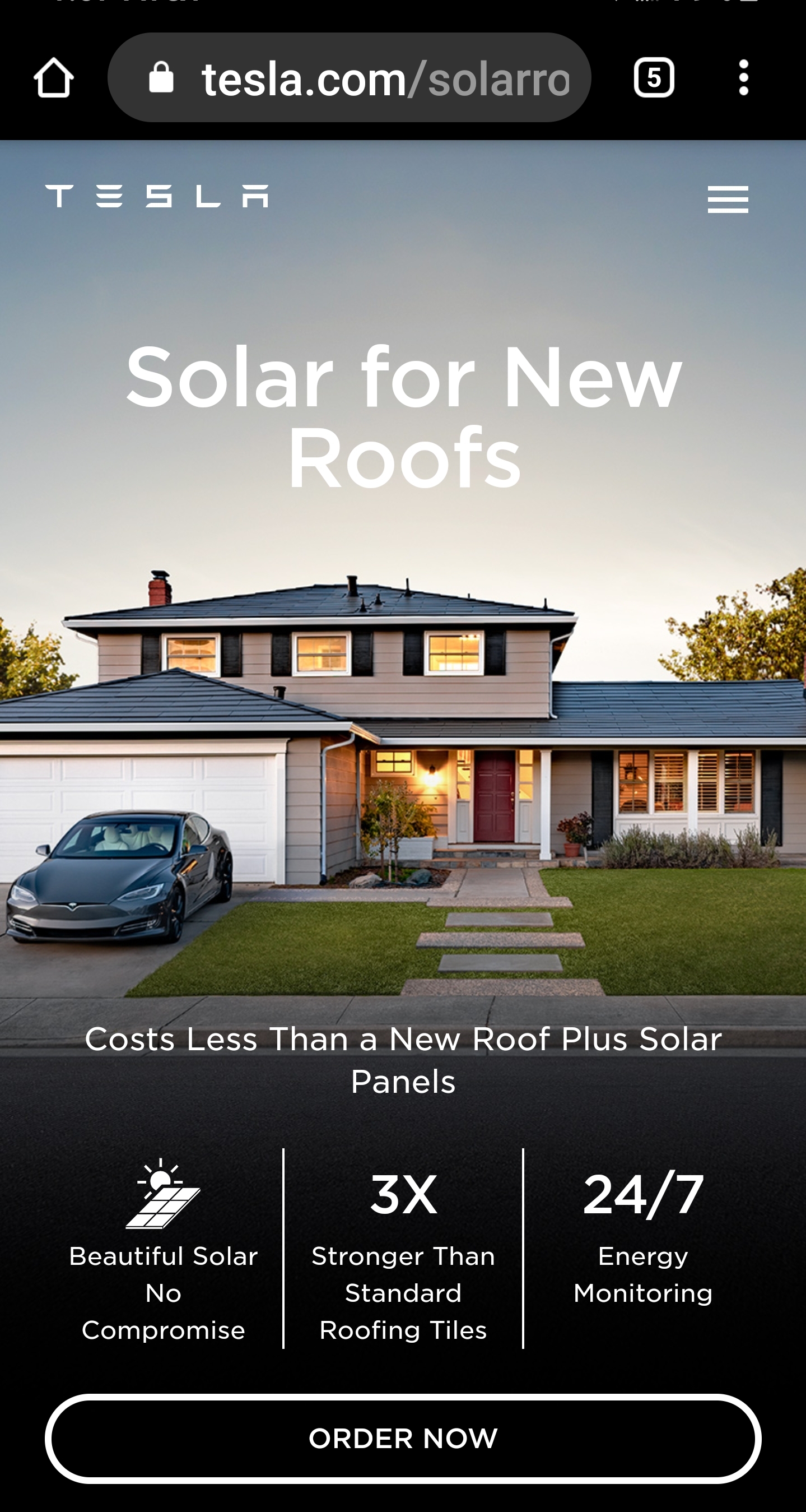

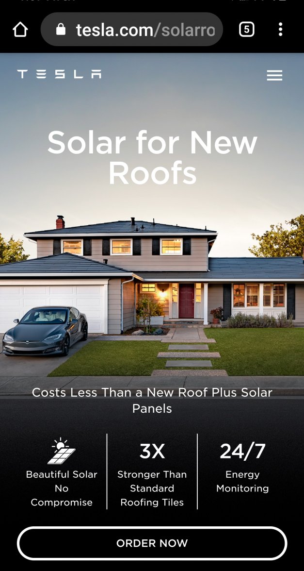

Maybe the future.... Just get a solar roof instead of panels...
I was talking to my neighbor about these as he was looking into them. I think this goes back a year and at that time his research told him these are not manufactured that great as of yet but Tesla (formerly solar city) are working on it, like I said it was a minimum of a year ago, with technology a year is a long time. What I like about musks solar products such as that solar generator I looked into is he explained the faults in them. Not discouraging purchase he was just explaining where things are at now versus where he wants them to be. I find that refreshing. I’m not saying he does that with all his products the fact it’s done at all I like. Anyway I can see solar shingles/roofs being the future. Seems to make more sense. I’m sure 100 downsides can be mentioned but the progress is pretty cool in general. And as you mentioned I did install several energy efficient utilities including an efficient heat pump that heats, cools and dehumidifies at about 40% of what the straight electric does. So I agree these are all smart moves
