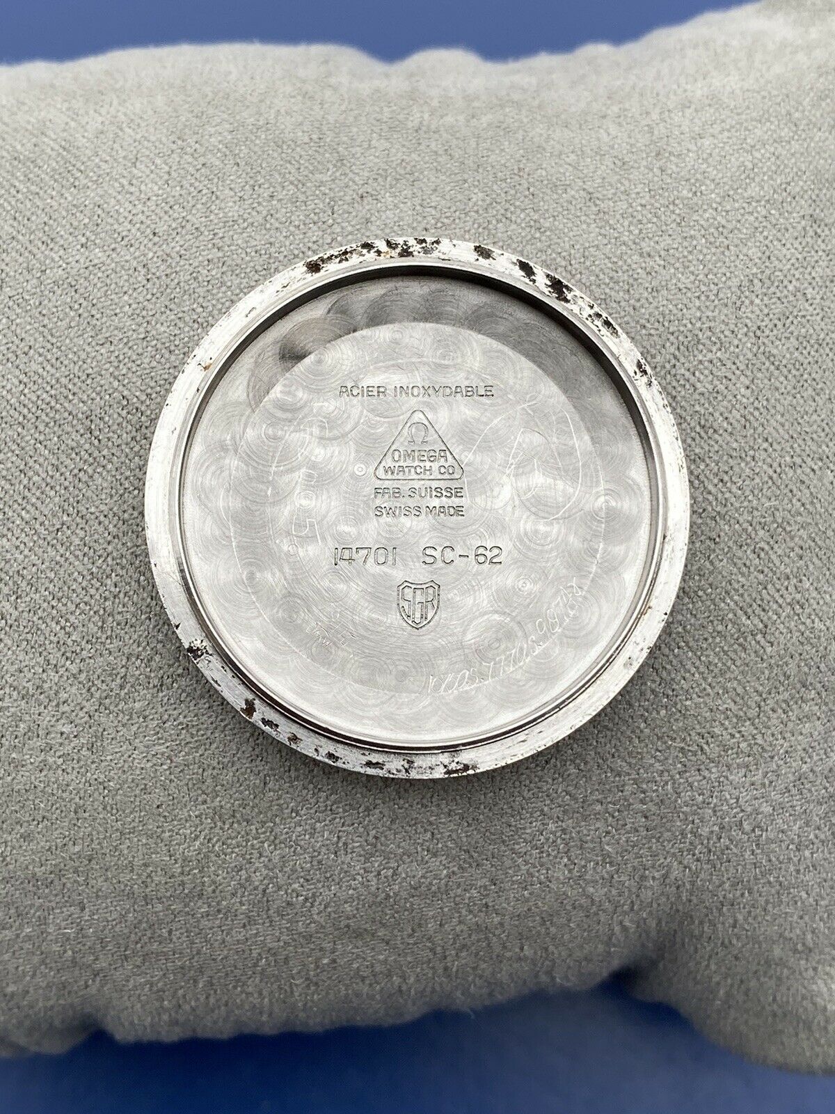

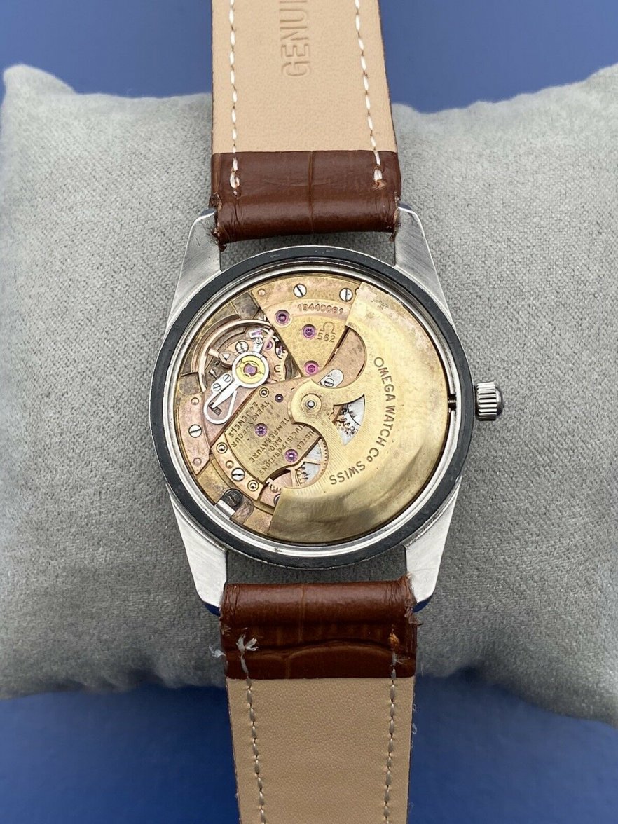

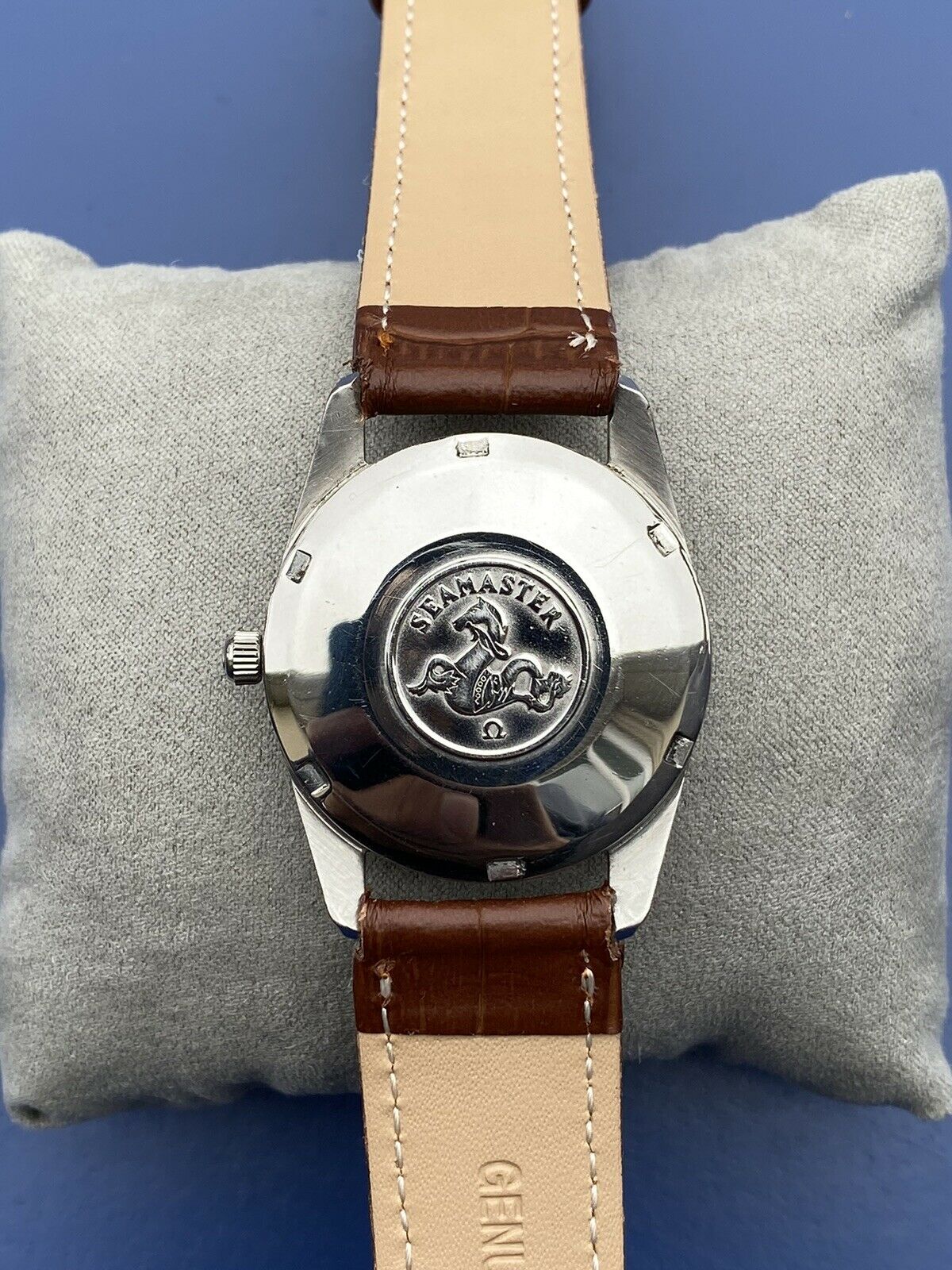

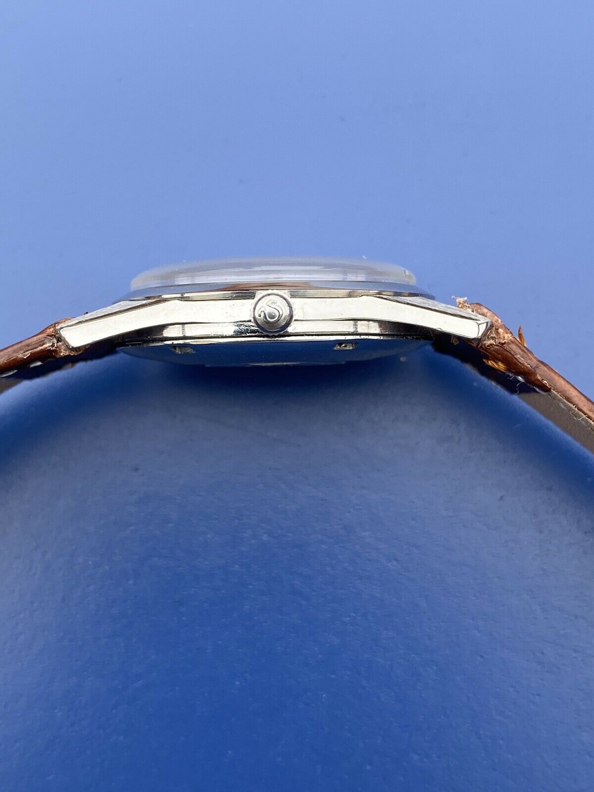

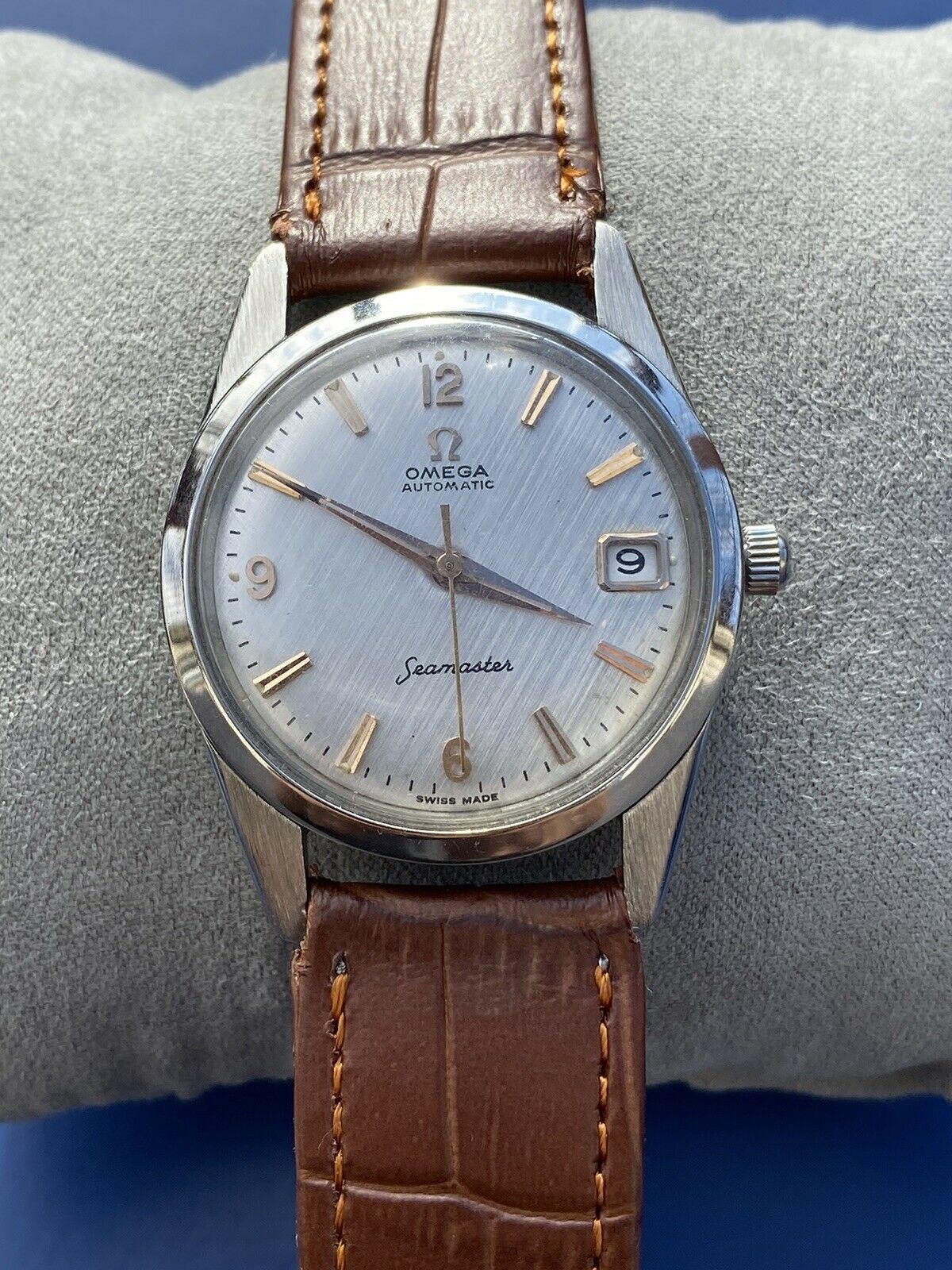

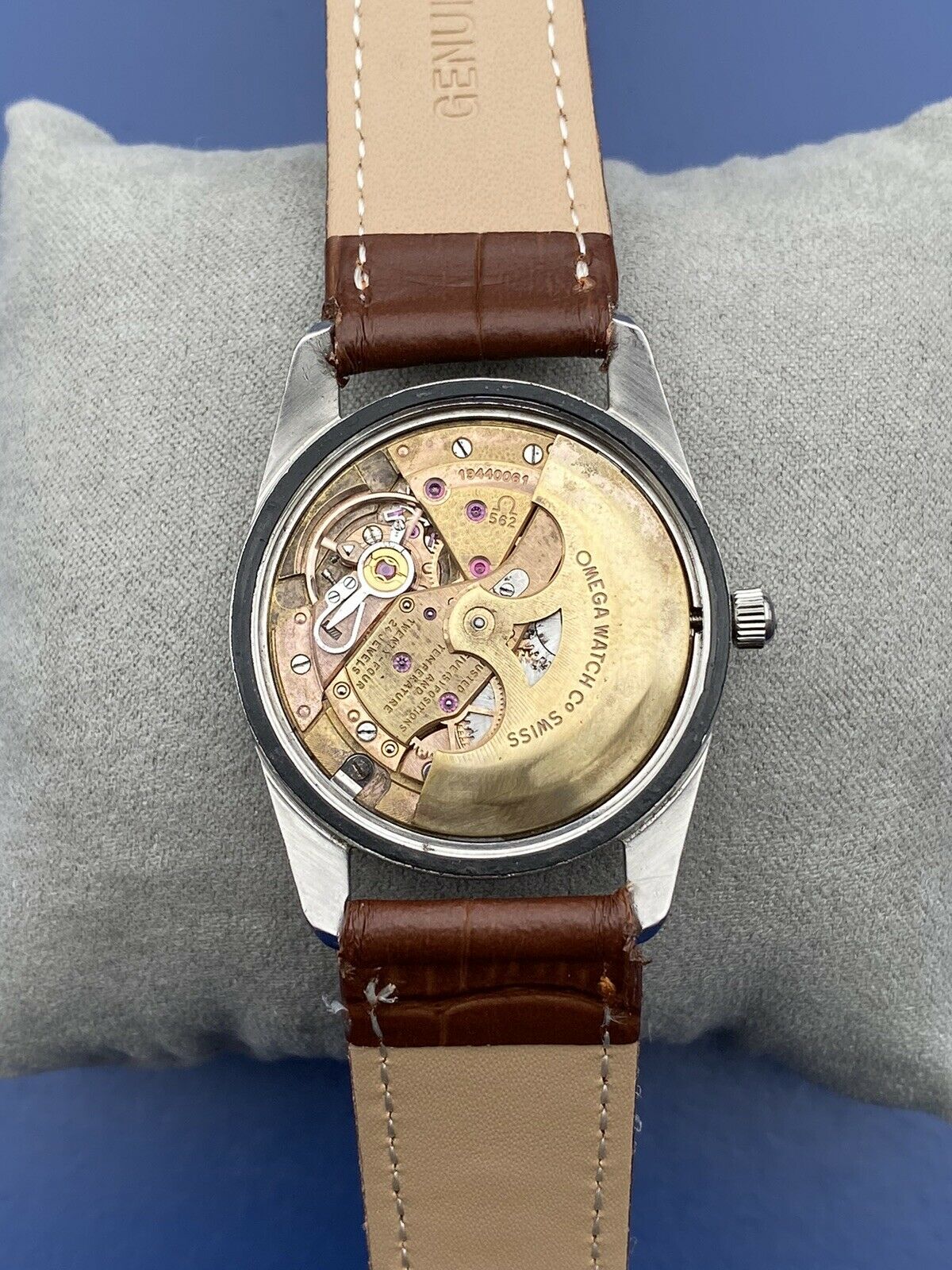

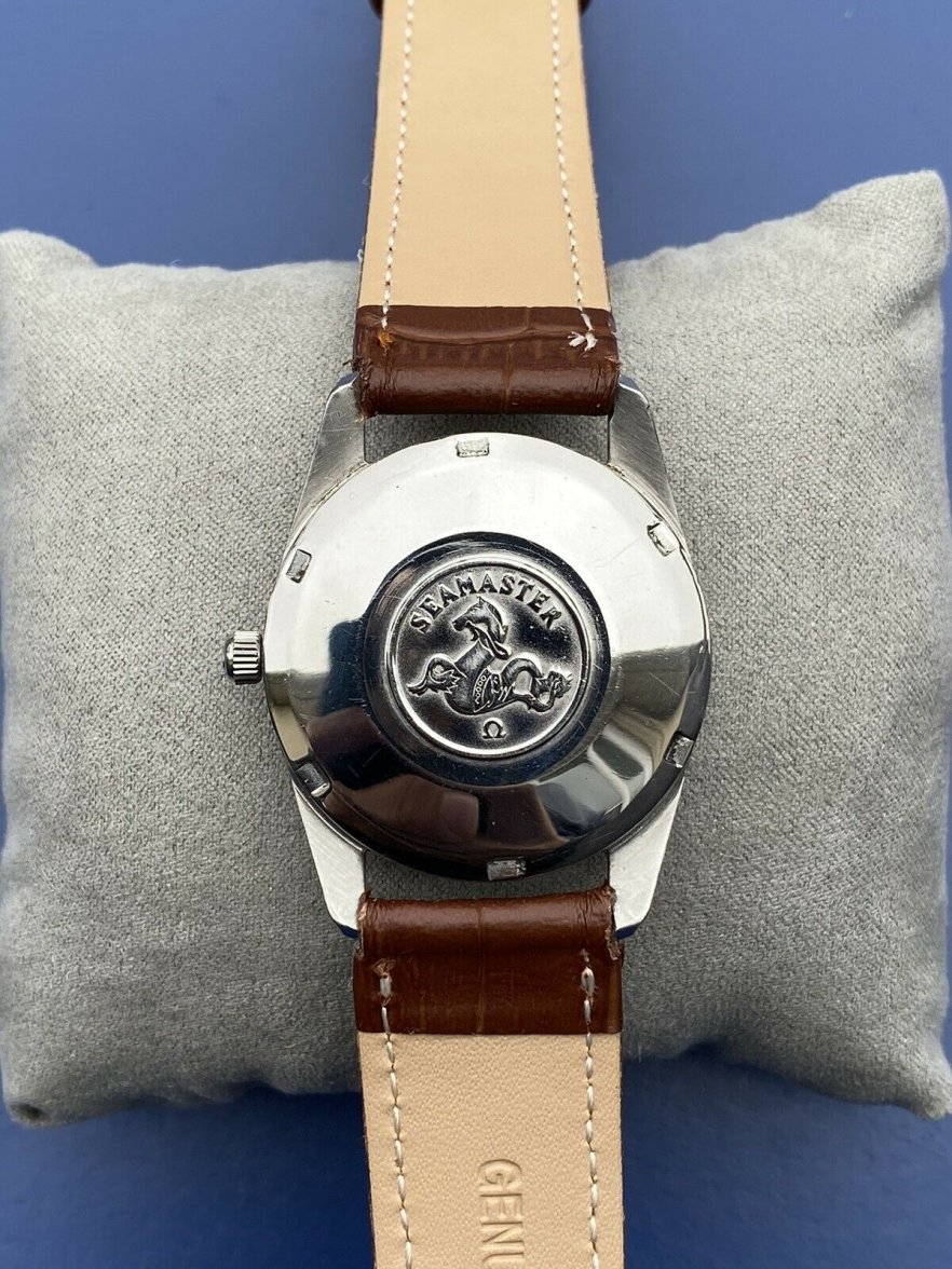

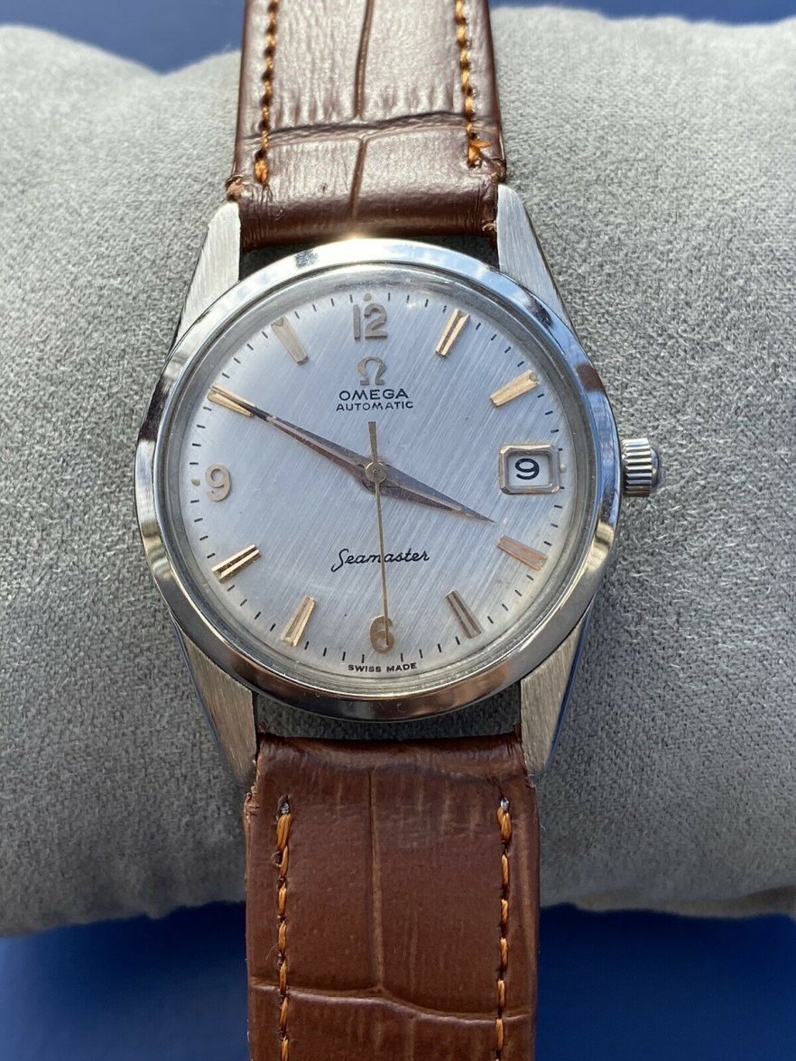

Since purchasing the watch, I've struggled finding any Seamaster's that looks exactly like mine which is leading me to believe that it is probably a frankenwatch, could really use your guys help. The dial has been restored, but I'm wondering if all the hands, indices, crown, movement, etc is all original. What I do know is its a caliber 562, and I believe the serial dates it to 1962. Pictures below, thanks in advance!

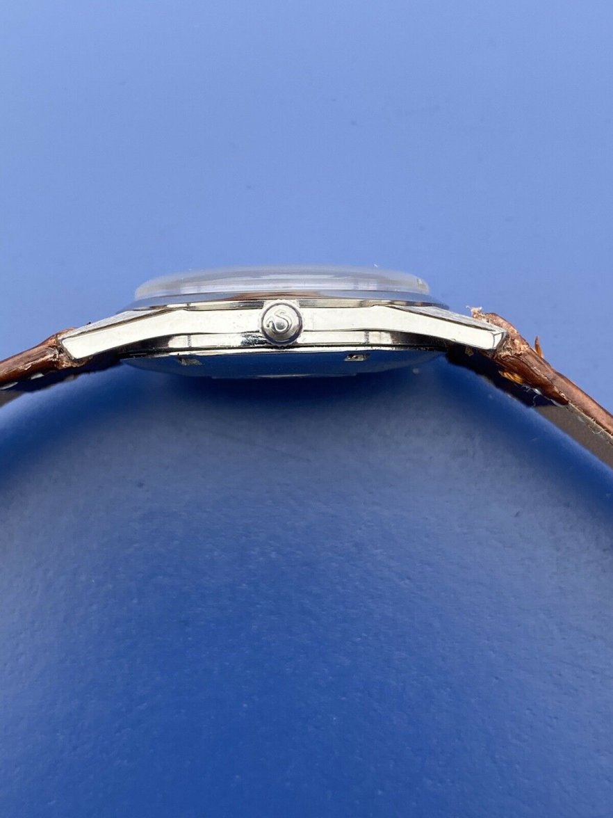

Case has been refinished to have a brushed look. Crown is a replacement. Movement is probably from another reference, as the base seems to state that it's a chronometer - its adjusted to 5 positions. Movement is also filthy.

It’s a nice looking watch. I think so, you think so and 99.9% of people who see it on wrist will also think so. Some of us, even on OF, liken it to having a vintage car restoration. Get it serviced, wear it, and enjoy it.

I agree with what has been said above, this is not a watch to put money into, it can't be restored. It will never be a collectible example, so there's no point in replacing the crown or servicing it. Wear it as is and enjoy it.
If your interest in vintage Omega continues to grow, you can hunt for a truly collectible watch and then sell this one.

I’d look to return based on the add stating the movement was “overhauled recently.” That movement is filthy and hasn’t been touched in a looooong time!
88
74
The crud you can see on the gears under the rotor makes me cringe.

The 562 movement would be correct for this reference. But you should probably mention that 562 movements are NOT chronometer graded. The chronometer calibre would be 561. So either one of two bridges (either the train bridge with the movement no. or the automatic works bridge with the "adjusted" inscription) have been swapped with an incorrect one in this case.
1,155
592
The movement is a franken/marriage. It has parts from multiple movements. (not that that is a bad thing especially if all the parts used are from the same caliber, I'm just pointing it out)
Crown is incorrect as has been mentioned. I think the case has been polished as well (it has a weird incorrect finish in some areas).

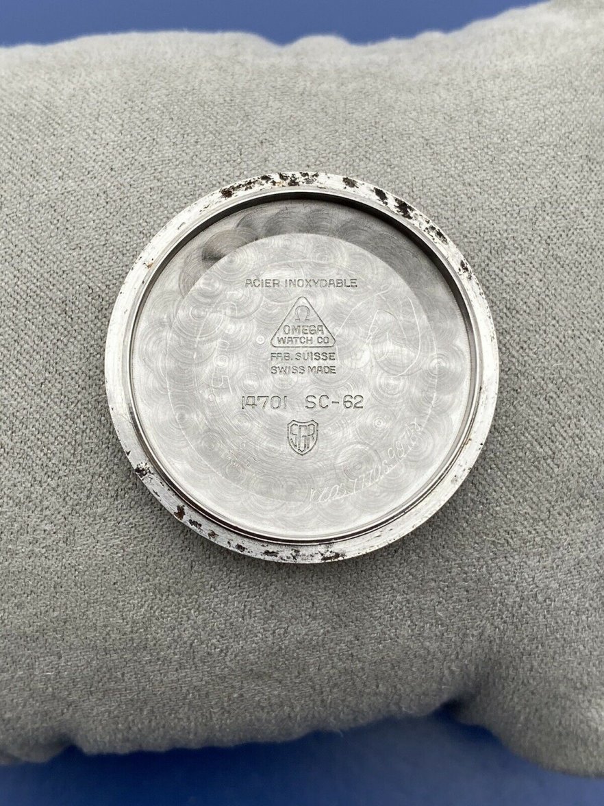

The marks on the case back should have been cleaned during servicing. Wouldn't be surprised if the movement is NOT serviced and I doubt that it has been serviced correctly.
