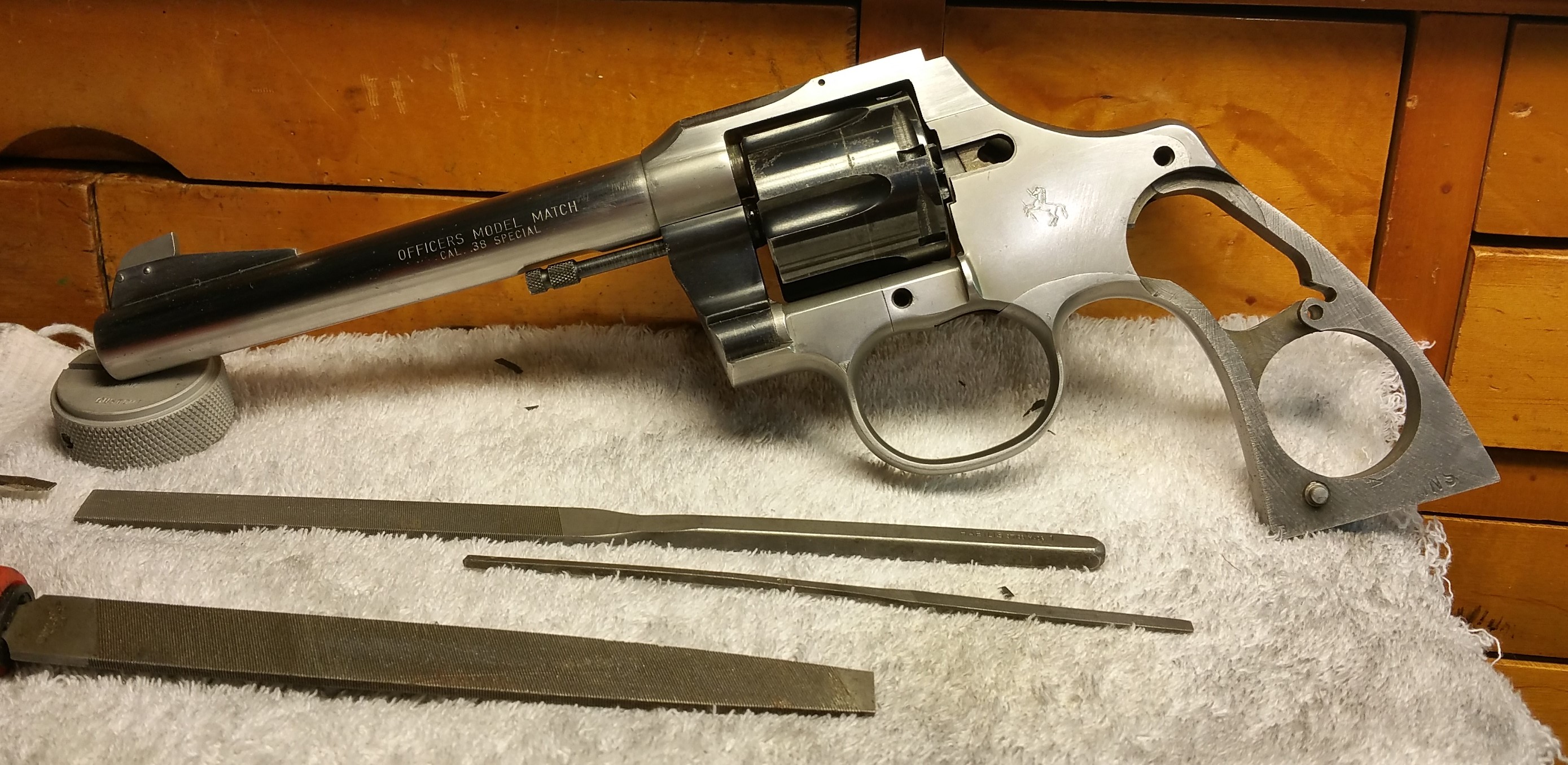

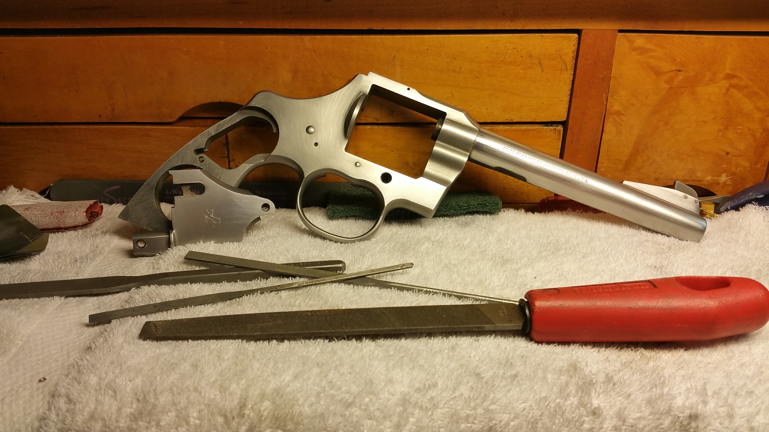

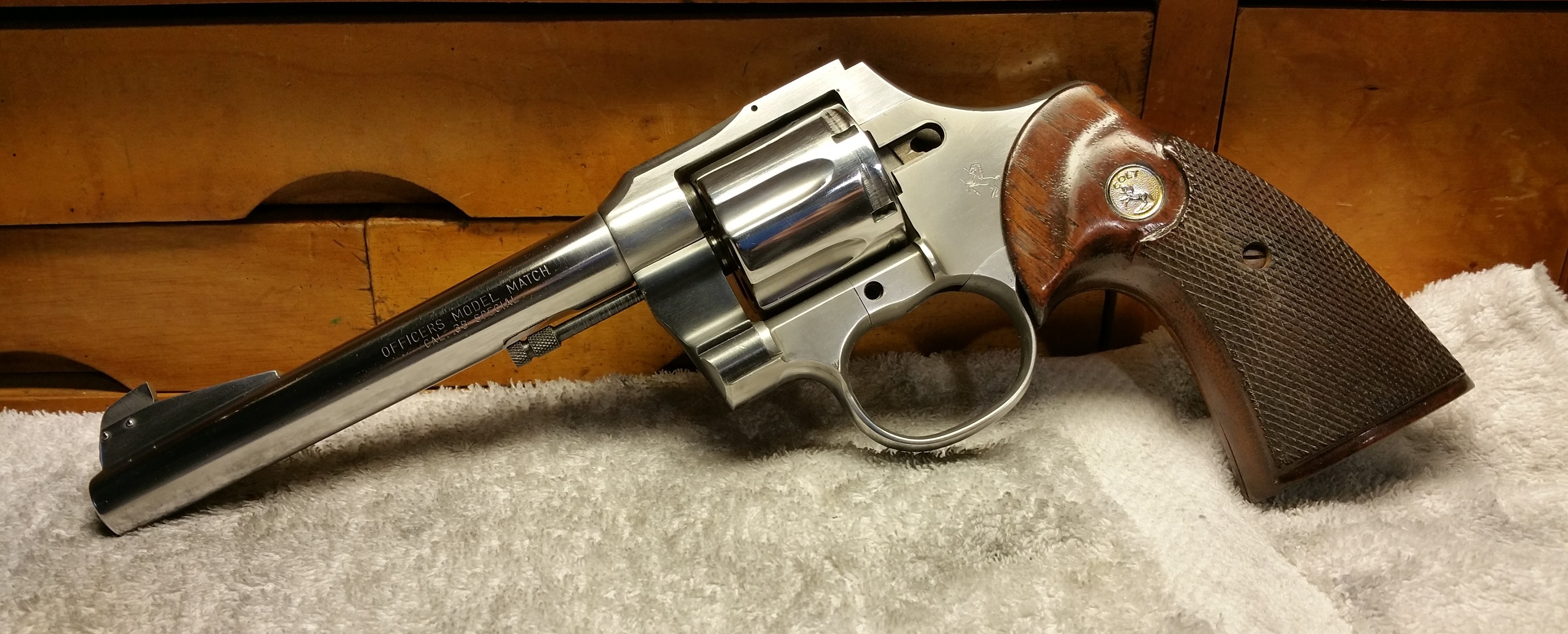

I'm still plugging away on this Colt getting closer I should be done the middle of next week. Damn doing the file work on the pits is a real pain in the A... I need to remove the ejector rod and do the crane. I'm taking my time I work on this one a couple hours at a time. This way I come back to the revolver with fresh eyes. If I was to just keep on plugging away I would skip over some of the pitting and just think F it I'll leave it alone I have the front sight removed since the picture was taken little by little I'll get her done.
7,096
57,080
Go voere! Thanks for posting a sequence of photographs showing your patient efforts.
This is a better firearms thread than is found on some firearms forums.
1,317
9,081
Thanks

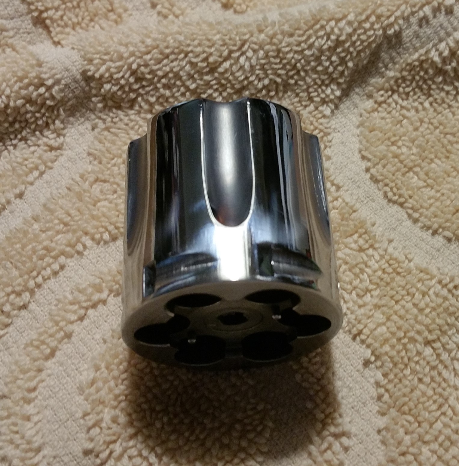

I'm working on the colt little by little. One of the hardest things to remove is the gouge on the cylinder. That was caused from a loose side plate screw. When I recovered the revolver from the flood. I removed one side plate screw to let some water drain out of the internals. Like a dumb A.. I rotated the cyl. and bingo more damage. That is now removed and looks as it never happened. One pictures shows some of the files I used on this colt plus various grits of sand paper. Plus a 1/2 hp buffer with heavy felt polishing pads.
The last pic shows the cyl. after a trip across a polishing wheel
4,358
12,879
Voere, the cylinder looks fantastic now. I'm enjoying following your progress.

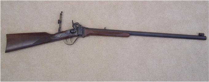

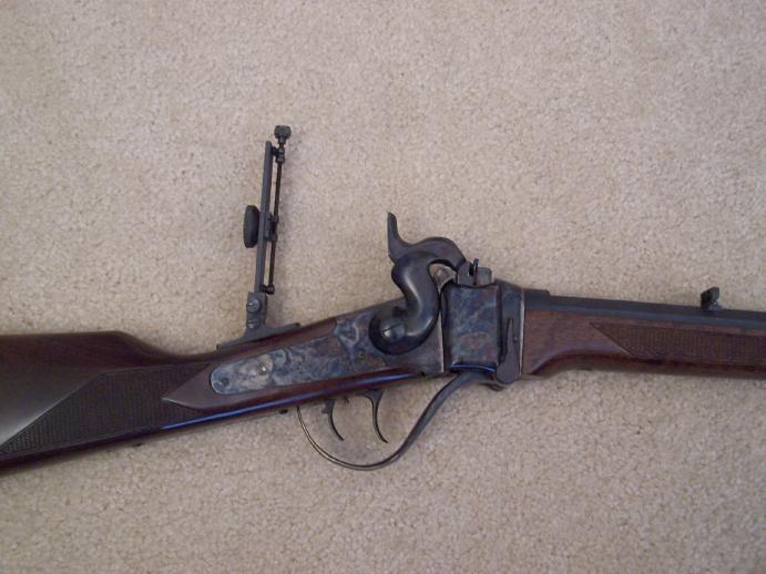

Was looking for something else this morning in the safe but rediscovered this old piece...Sharps 1874 in 45-70. Close as I could get to a Quigley gun (doesn't everyone love that movie?). Shot metal silhouette back in Texas with it. I think I paid 900 for it, then money got tight and sold it for 800. At a gun show a couple months later I saw the same rifle on a table and said hey that looks just like the one I sold a few weeks ago...how much? He said $600 for a quick sale, as he just got it. I looked closer, and it WAS my rifle. I described to the fellow the guy that bought it from me and he said yup that's the guy. He just left. Still looked perfect so I bought it, shot it, and it was just fine. Strange story for sure. Guess it wasn't his cup of tea....
7,096
57,080
Good film and great rifle! Great caliber too.
4,358
12,879
Great rifle Wryfox, I think all of us who have seen the movie want a Sharps.

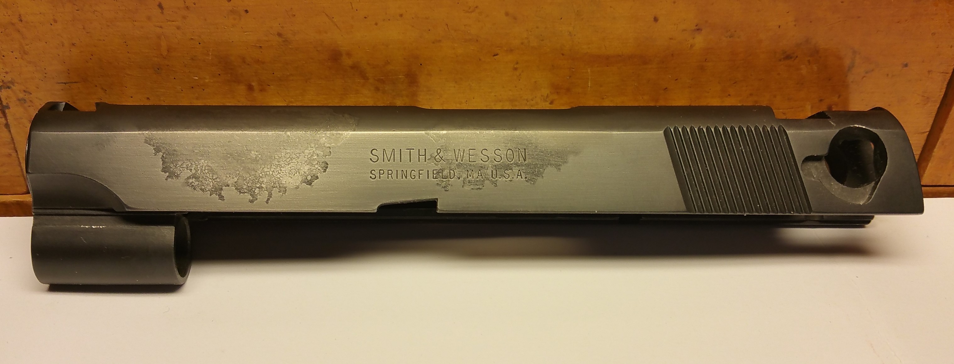

This slide is from another handgun that was diving under water for a few days
I'm still plugging away on the Colt I posted. My next project is in the works a S&W 5906 that has a melonite finish on the slide. Later in the week I will stop in at a friends plating shop. And find out if blasting the finish off will work. Since the melonite is a heat treated finish. Not sure if blasting will remove the finish.
You can see the hard compound layer is flaking
The finish appears to be 3 to 5 mils thick not sure if blasting will work. If not he may know of a way to remove the finish. I would hate to remove the lettering on the slide. It may be easier to just replace the slide and have the replacement slide melonited.
Maybe a muriatic acid bath would strip it.
4,358
Not sure if that will work. At this stage of the project I'll let my friend take a look at the slide. He owns a industrial plating shop. He may be know of a way to remove the finish. If not I will try the muriatic acid bath
Sounds like the way to go. Hopefully it won't be too difficult for him to remove.
