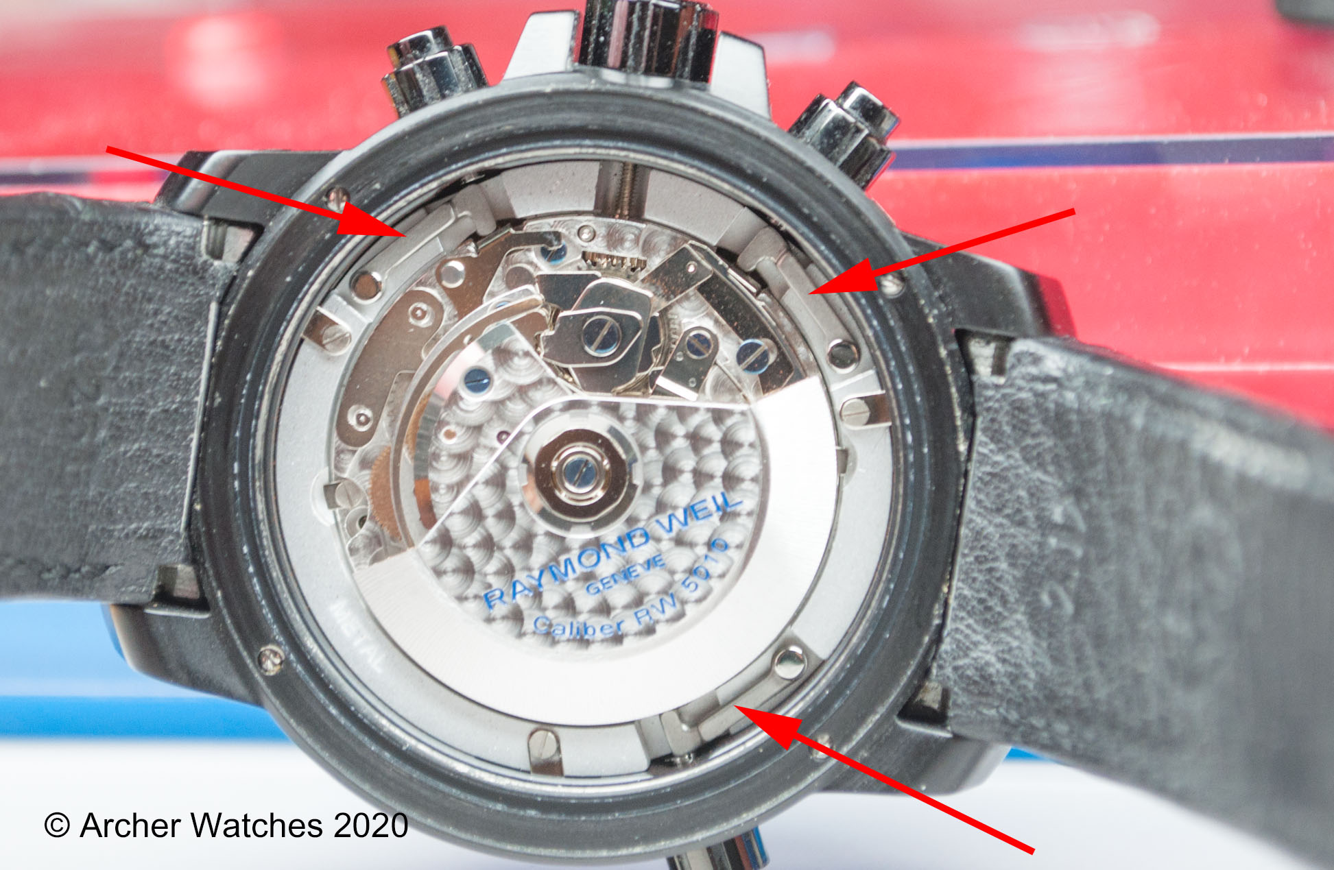

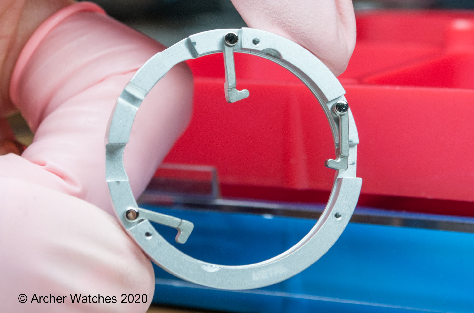

As I was scrolling through the thread initially, I thought the same before I saw what they had actually done. I think the reason this came to mind for me is that I'm working on a Raymond Weil chronograph right now, and although it's a 7753, they are also doing some funky stuff with the movement spacer:
Small levers are used to transfer the motion of the pushers through the spacer, to the movement:
In most cases where this motion is transferred through a large spacer like this, they just use a straight hole and a small round piece of steel, which is simple. This is a little more complex - not nearly as complex as what Breitling has done, which to me is another failure point for the sake of looks or sales...and yet another parts that you won't be able to get when it fails, forcing you back to them for service.

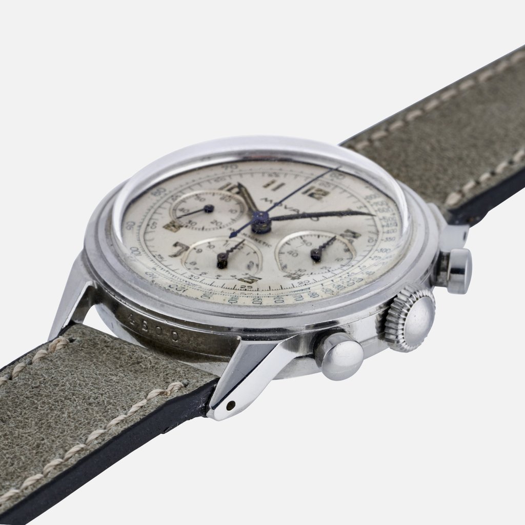

Out of curiosity, I pulled up some photos of vintage Movado M95s - as I understand it, the first modular chronograph movement. I noticed, somewhat to my surprise after reading this thread, that the crown and pushers seem to be lined up.
I wonder if @Archer has any experience with these, or if, indeed, it's something you'd be willing to service.
(photo credit: Hodinkee)

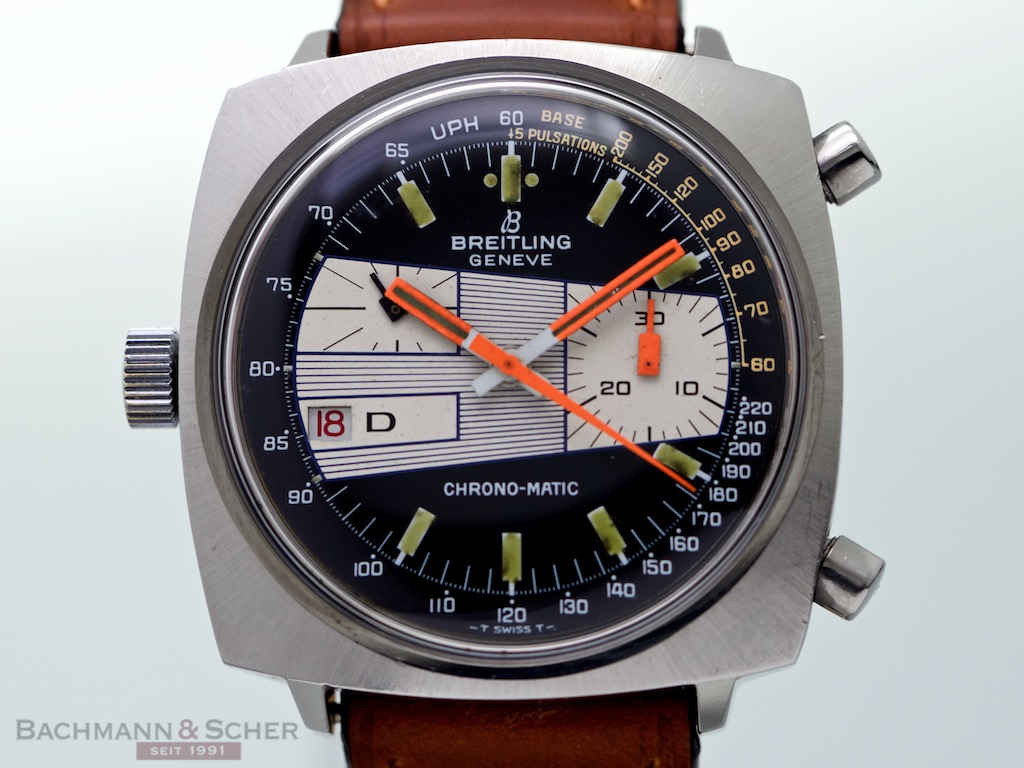

The next major modular chronograph movement I'm aware of, the Chrono-matic, went so far as to put the pushers and crown on opposite sides of the case; surely a pioneering act of chronograph skulduggery
(Breitling was one of the developers...)
I never paid attention that the 90/95M was modular. But it is obvious now that I look at it ::facepalm1::
The pushers are aligned because the posts of the chronograph levers go through the barrel bridge, as we can see with those pics
https://www.abellwatchmakers.com/movado-sub-sea-m95.html
(src: https://www.rescapement.com/blog/for-your-reference-the-movado-fb-95m)
Same on the Buren calibers: the levers extend to the plate, so the pushers are not off-centered.
From what I understand, those calibers require the base mouvement to be reworked as the module is not added on top of the plate, but on top of the bridges. Modern modular chronographs have the module added on top of the plate, so no modification is required on the base caliber.

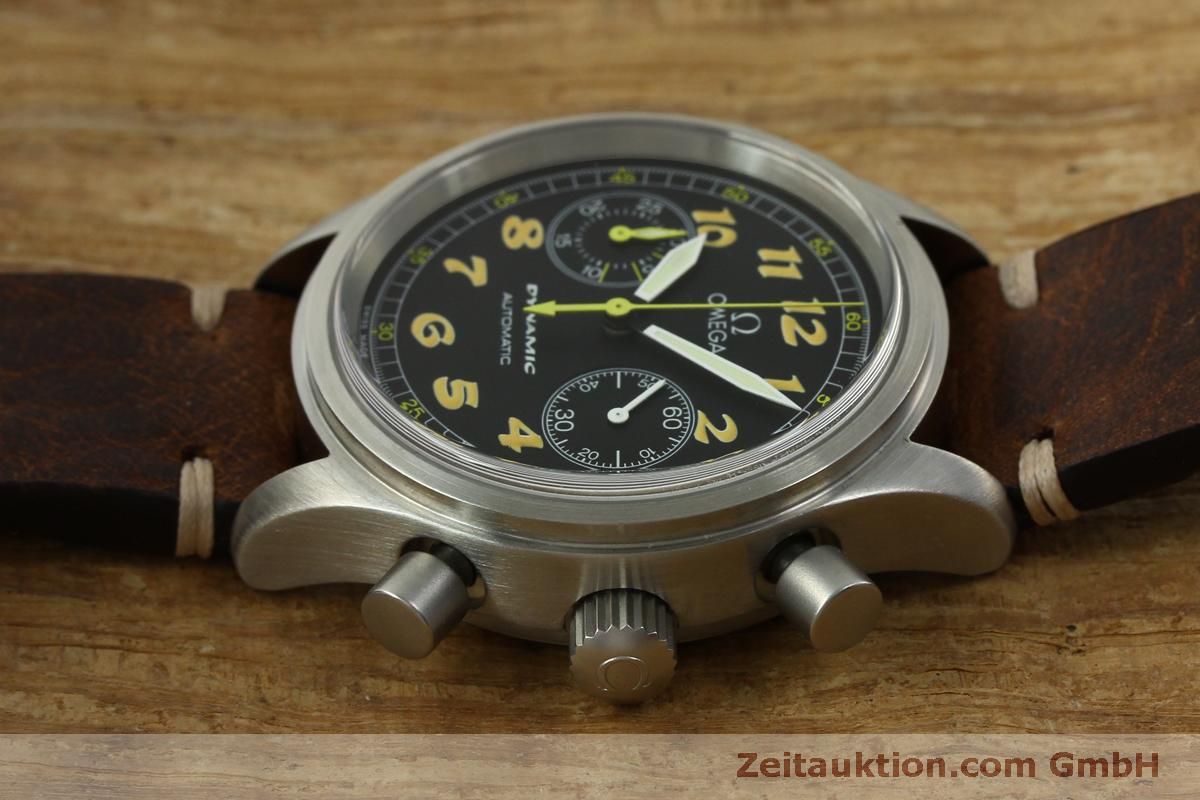

The Speedsonics were also modular so Omega have nearly as long a history of this kind of shortcut as Heuer, Breitling and Movado.
There are just as many of us who don't mind modular chronographs one bit because other than maintenance time, there isn't a practical difference in daily use. I will clarify that I don't love most reduced models because of the snap back, so my modular chrono of choice is the Dynamic chrono. (Photo found online.)
Actually there are practical differences. Tried to hack it to set the time accurately and wondered why it’s out by a smidge unless you lead or lag the minute hand (I forget which)? Note the jump when you engage the chrono? They are not identical to integrated units. The pusher feel isn’t as nice and the amplitude can drop a lot when the chrono module is running, more so than with many integrated designs.
My experience with modular chronos has not been great. I’ve had a Dynamic and several others too. Lesson learned.
Great insight, thanks. I have noticed that the pushers can feel "spongy" on these units more often when compared to standard chrono setups, do you think they wear quicker as well?
Cheers, Al
I thought Breitling put the crown on the opposite side of the pushers initially to indicate it was a self-winding movement. It was a marketing decision when the first self-winding chronos came out.
