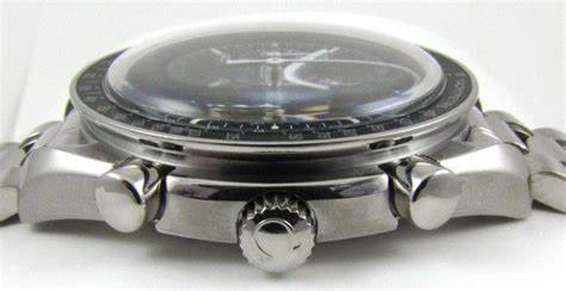

So as most know the modular chronographs that use a module placed on top of a normal base movement (often and ETA 2892) will have a particular feature in that the pushers and crown are not aligned. Here is a photo of a side view of a Speedmaster reduced, and you can see that the pushers centerline is well above the crown centerline:
This is sort of a tell tale sign that the watch uses a modular chronograph, and although some brands have tried to disguise this by using oversized pushers, you can usually still tell.

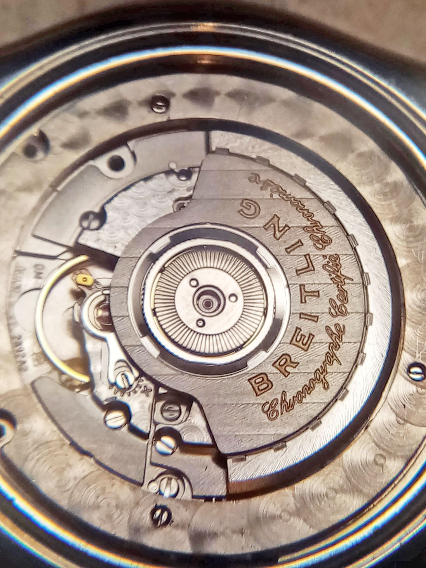

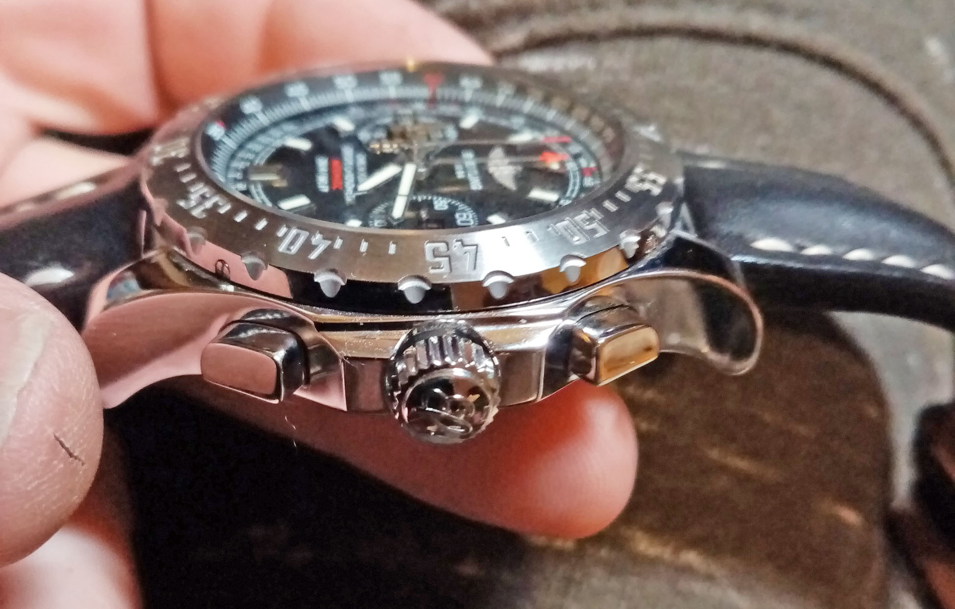

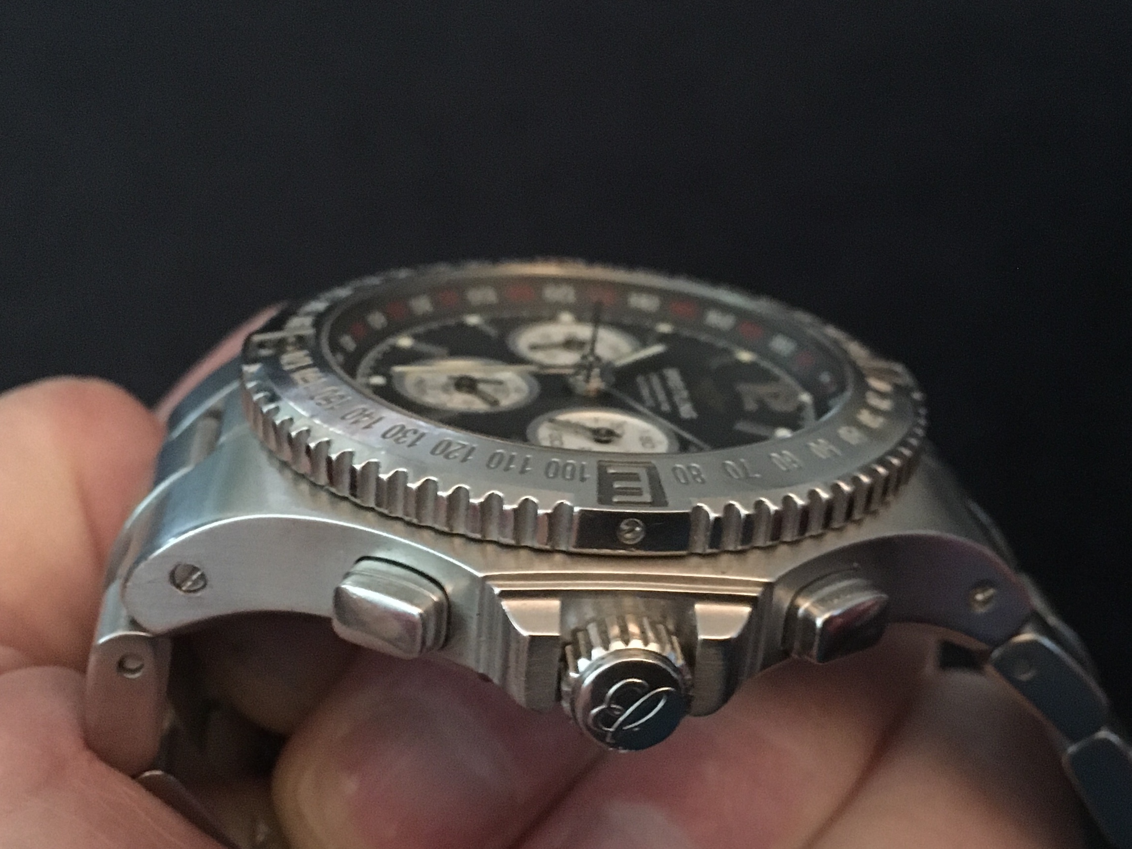

Joe Horner, a UK based watchmaker posted some photos of a Breitling he received on another site - I've edited them to make the images clearer but these are his photos. Side view appears to have the crown and pushers line up as a normal integrated chronograph:
But inside, there is a 2892....curious...

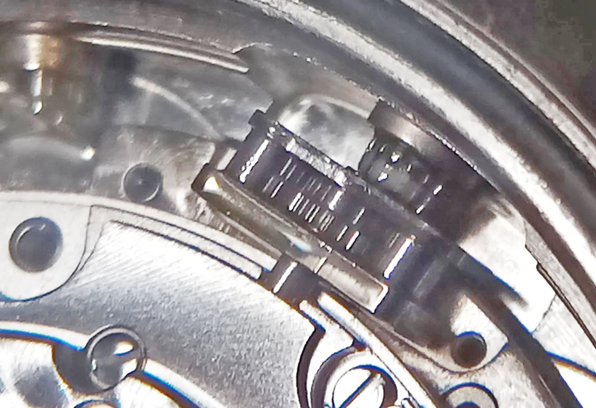

When he removed the spacer, it was all clear...
Breitling has installed a set of gears to shift the position of the crown so that it matches the height of the pushers, all in an effort to disguise the fact that this is a modular chronograph. I suspect that since many chronograph fans do shy away from modular chronographs, they have done this to help with sales.
The alignment of these parts is sort of a key indicator in knowing if the watch contains and integrated chronograph or a modular chronograph movement...now that indicator isn't one you can trust to tell you the whole story.

An interesting feature. It would interest me as to how the hand setting would function, given that the “transfer case’ would have to shift outwards to connect the setting function. And there has to be some kind of a detent screw to permit removal of the crown. Also, this is a model with a date. If there is a quick change date setting function, that would factor into it. Hmmm! Many questions.
29,815
77,157
Described this way...
"When you drop the movement in (with the crown already in place) a U shaped cut-out in the outer plate of the "gearbox" engages with a groove in the shaft's crown so the crown can move the stem "proper" in and out."
Also there's an idler gear there so the crown/hand directions are maintained as you would expect.

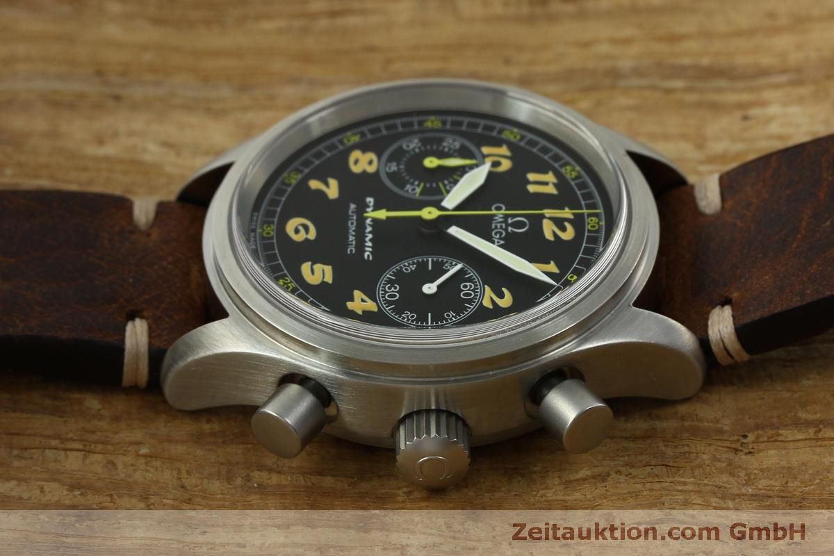

There are just as many of us who don't mind modular chronographs one bit because other than maintenance time, there isn't a practical difference in daily use. I will clarify that I don't love most reduced models because of the snap back, so my modular chrono of choice is the Dynamic chrono. (Photo found online.)
