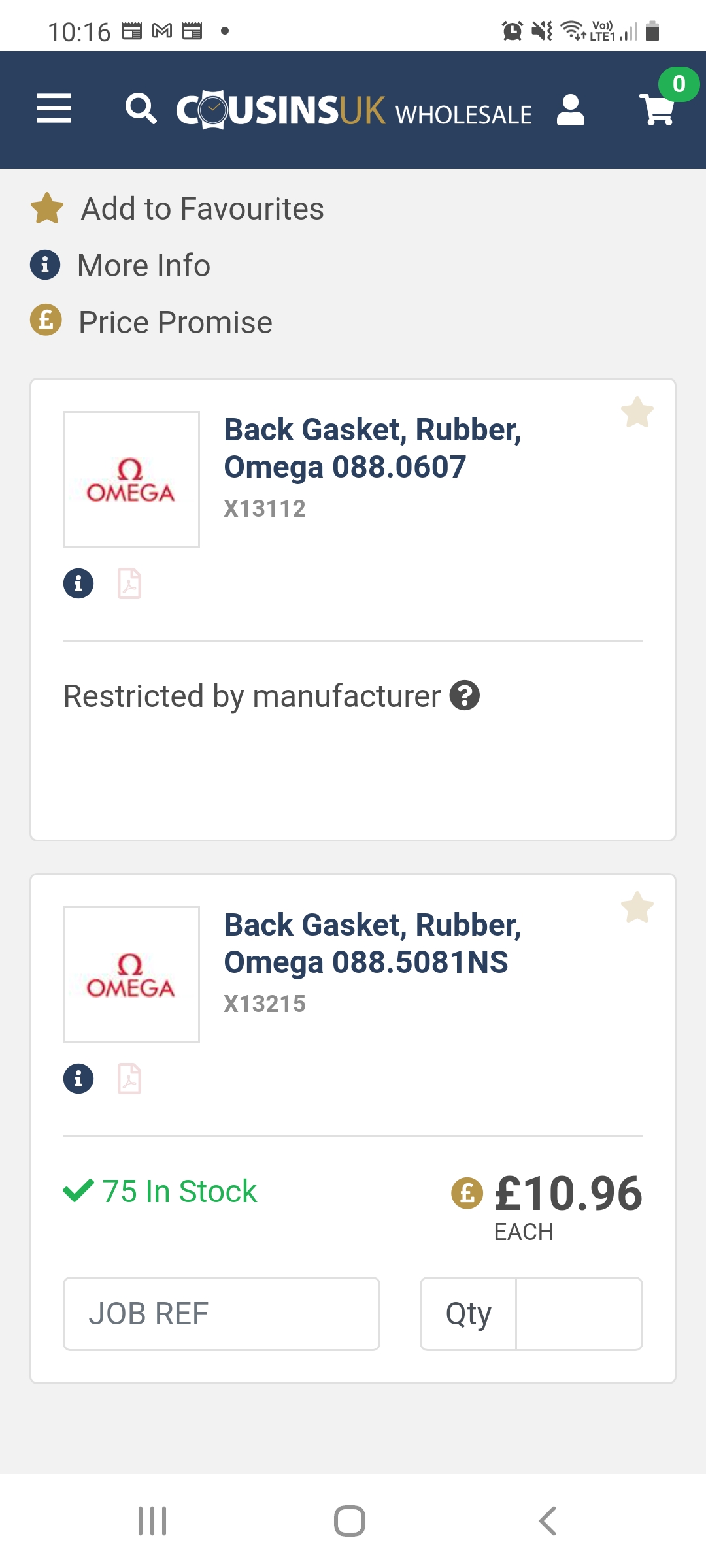

Hi there. Slowly assembling parts for my 2846 seamaster before I send it to the watchmaker. Any ideas what gaskets the 1950s snap back seamasters had. Normal generic rubber of something else. Cheers in advance.

Hi Archer. The watchmaker I use is 91. He is great but doesn't have an Omega washer. I want to track down the right one to make it easier for him.

Also, with caseback gaskets at this price , it made me wonder if there was something special or unique about them. If indeed this is the right part.

Nothing special - that's just price gouging. 100% mark-up by the reseller there.
BTW the top one is the one you need - 088NS0607 | SEAL O-RING D29.75 D31.75 Ø1
It's just a regular nitrile O-ring - nothing special.

Thank you Archer. It looks obsolete by Cousins will have to hunt elsewhere

It's not obsolete - it's just that Cousins can't order parts from Omega anymore. The dimensions of the O-ring are there in the description - I included those so that you can just find a generic O-ring of that size. Again there's nothing special about these.
