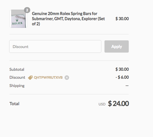

    Like so much else, you probably get what you pay for. These little pins are quite literally the only standing between a watch on your wrist, and a watch on the floor with a smashed crystal ...or worse, your watch plain gone.
    So I'll take mine OEM + made in Switzerland, and pay the small premium. As opposed to $25 for a box of 200 and made in...?

    Begs the question, is there a good resource for normals (people without a parts account) to obtain OEM OMEGA springbars for a Speedmaster?

    walk into an OB and ask for them preferably while wearing the watch. Not only free but you get a nice Omega bag to hold the small ziplock bag holding 4 of them.
