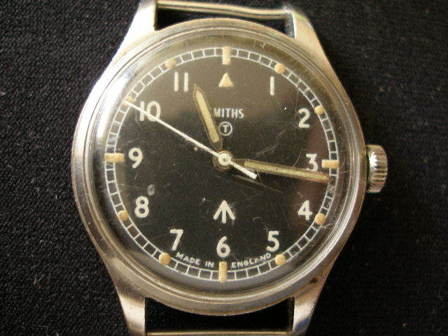

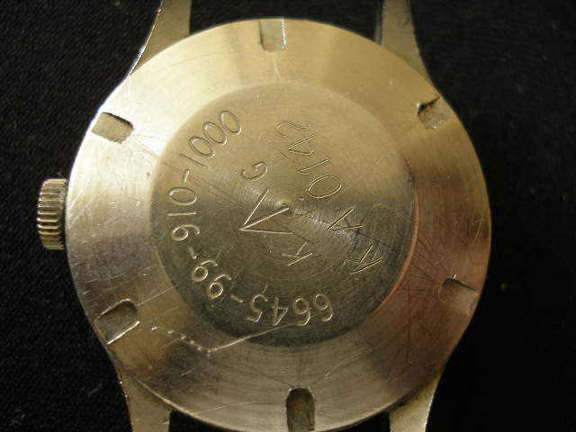

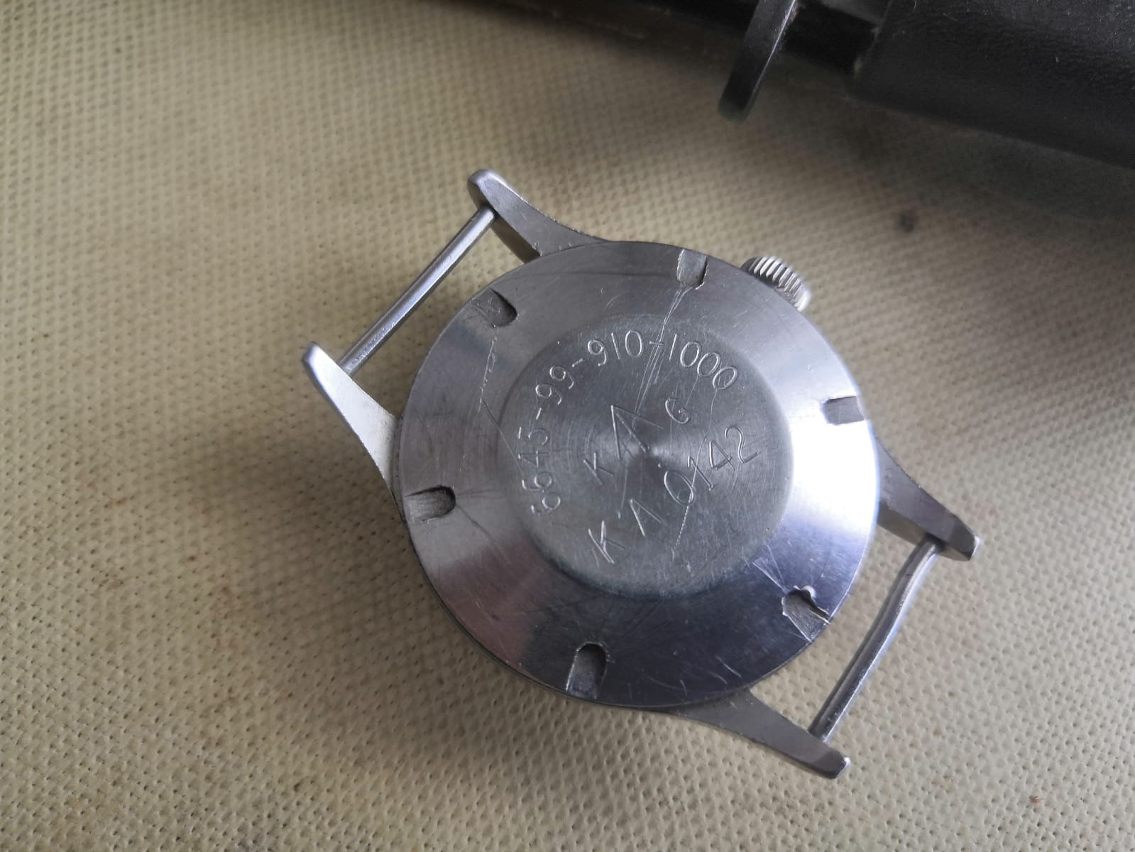

I'm eyeing this piece from a local watch guy that is liquidating his "old" watches. Somewhat of a rare piece and somewhat of an iffy piece in my eyes?

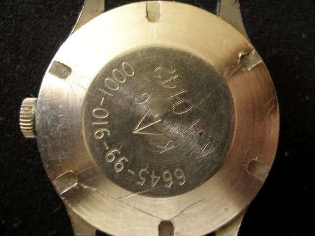

If I'm not mistaken the caseback is off? Other watches from his collection are all good from the GSTP pieces to the Bunds and the Tricolori stuff. But this watch while it presents to be a honest piece is a mystery in regard to the caseback?!
His story is that it was a Kenyan Military subcontract if I caught his info correctly... Any and all insights would be most welcomed!

What part are you uncertain about, just if they made these for the Kenyan military?

I know they did by the sheer logic of the British involvement there and the timespan these watches were made in. It's just that I've never handled a Smiths or Record that was marked outside the regular British markings and don't know what to think of it.
I kind of suspect that the guy is there and don't want to insult him by checking his facts over there. But thanks for the suggestion!

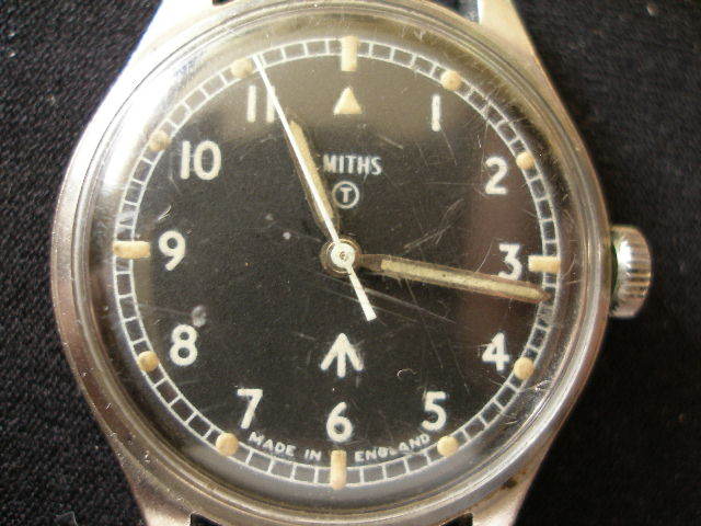

Caseback aside, the dial and lume look good under the crystal and the scratches can either be buffed out or the crystal replaced easily (they are just generic and inexpensive). I think this looks good as a watch and there’s huge pleasure to be had from these Smiths military pieces.
Shame there are no movement pics.
381
380
Thanks, there will be a lot more photos tomorrow. I can't manage to get to him today. The dial is pristine and the lume looks really good IRL.

Can you just say to him that you would like to get some thoughts on the caseback from others because you are not familiar with it, and that it's not that you distrust him in any way. Being transparent and up front always seems to me to be the best strategy in such situations. If he's sniffy about that he's probably not the sort of person I'd want to deal with anyway.
381
380
It's been verified by a person close to Mr. Knirim so I'm fine from there on out. The mentality of old people who found the "interwebz" in the last few years here is a mentality of paranoia and people out to get them and scam them. I'm fine with him being sniffy and bit secretive, all the watches have been inspected in person and the guy has more confirmed B-Uhrs than I have Omegas. He is throwing stuff out not of WW2 vintage.

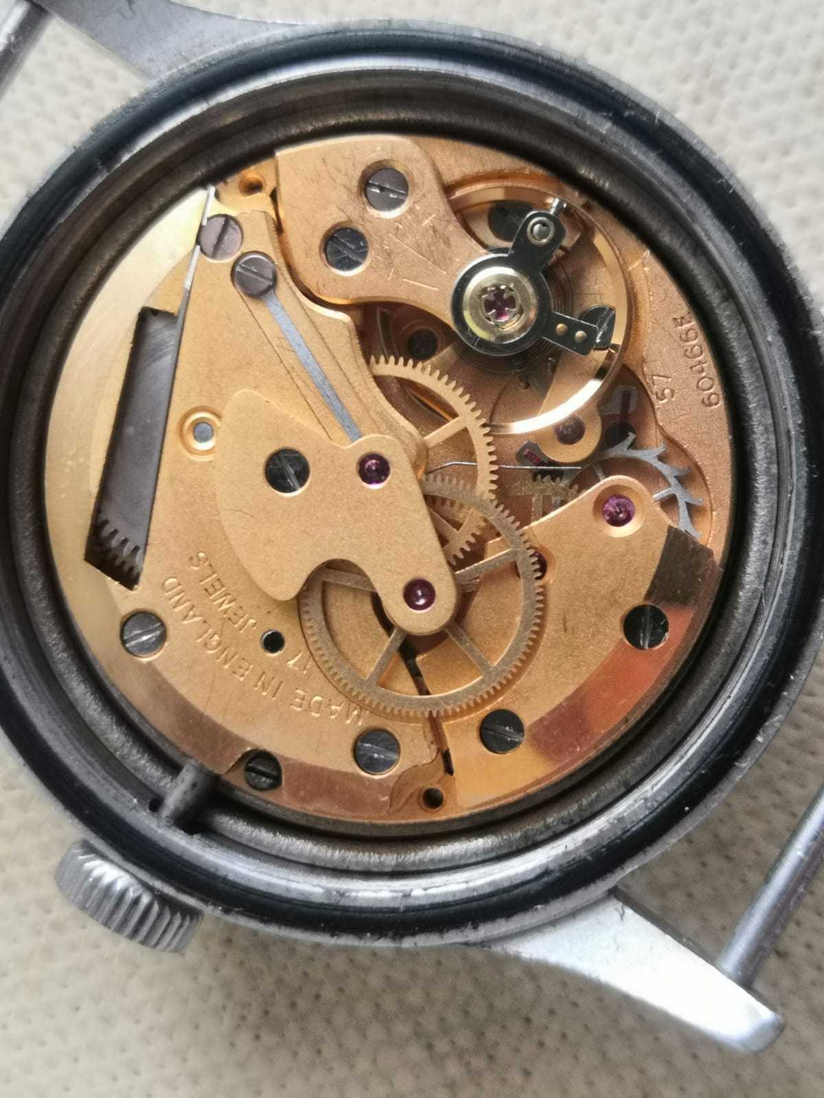

Great, look forward to the pics. I will be interested to see if the movenent is a military 60466E with hack spring and blued hairspring or an M marked 27CS. A potentially good buy I think, if the money was right.

Looking forward to more images Aquariusmatic, The fact it unusual even more so. Like Size11s, I'm also interested if its a mil movement.
It's the 60466E just confirmed by my watchmaker. Photos when I get home.

+1. Once you’re ready, you’ll find that people there have huge knowledge about these pieces - there is a dedicated Smiths forum and the people on there are lovely. It’s where you’ll find out more about the caseback markings.

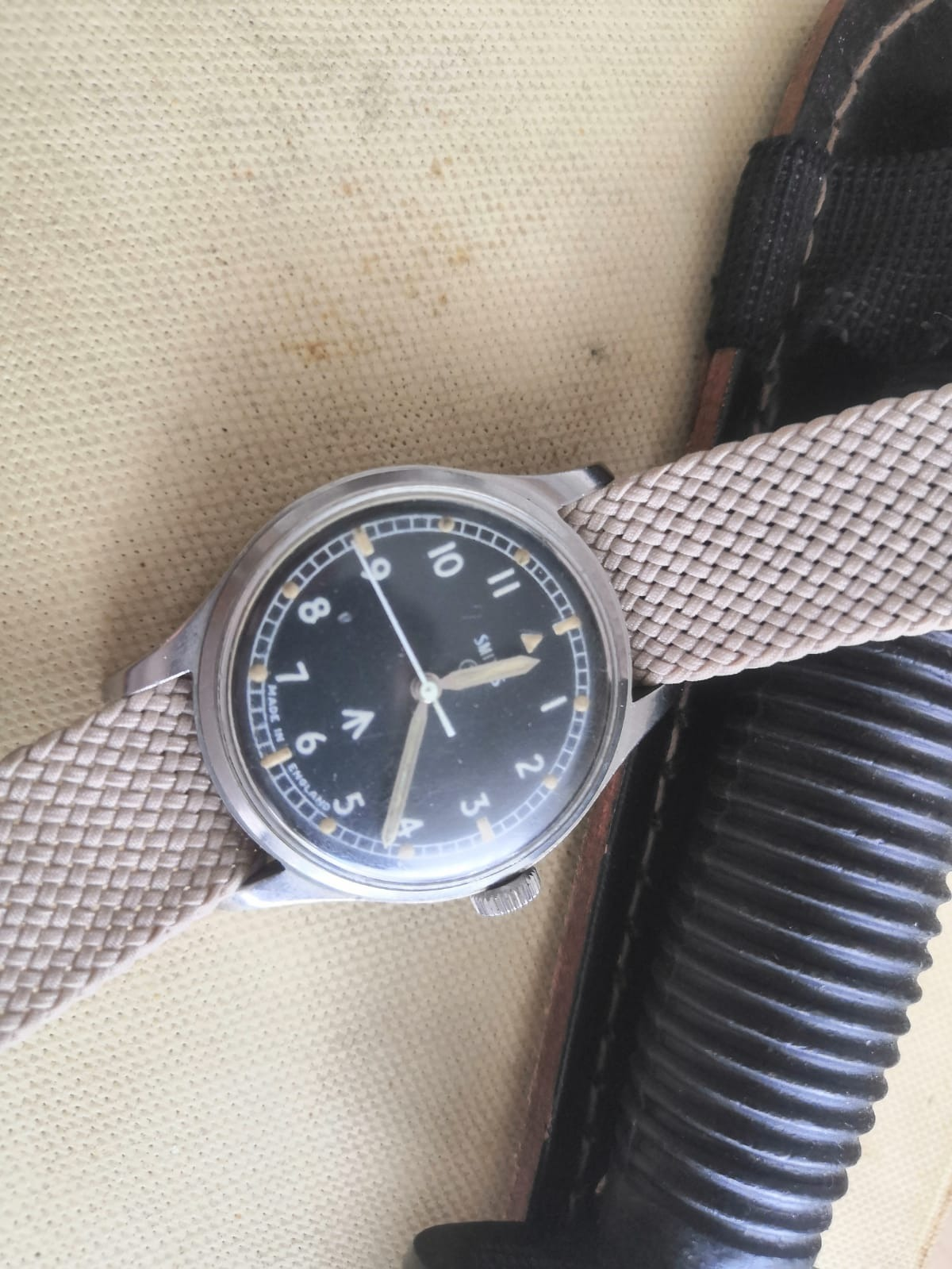

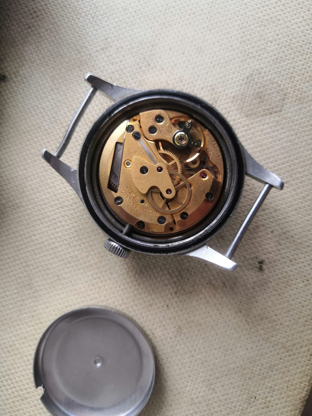

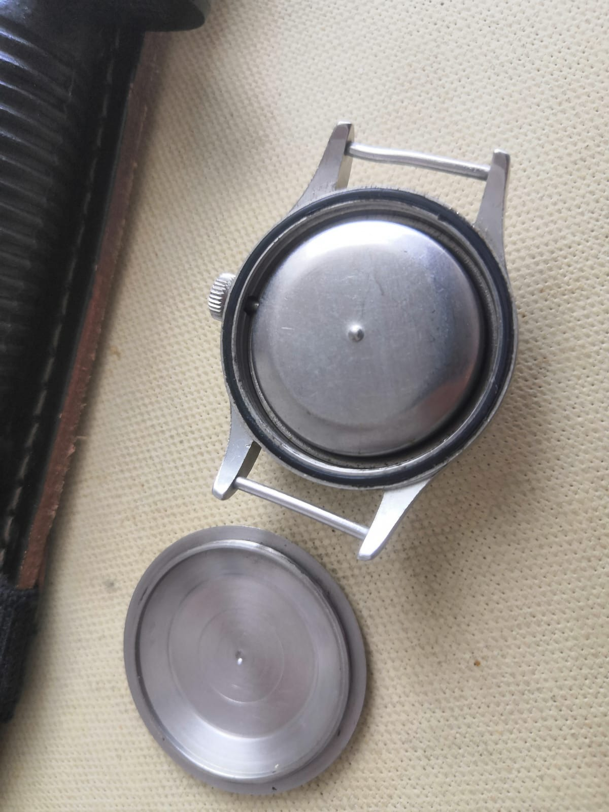

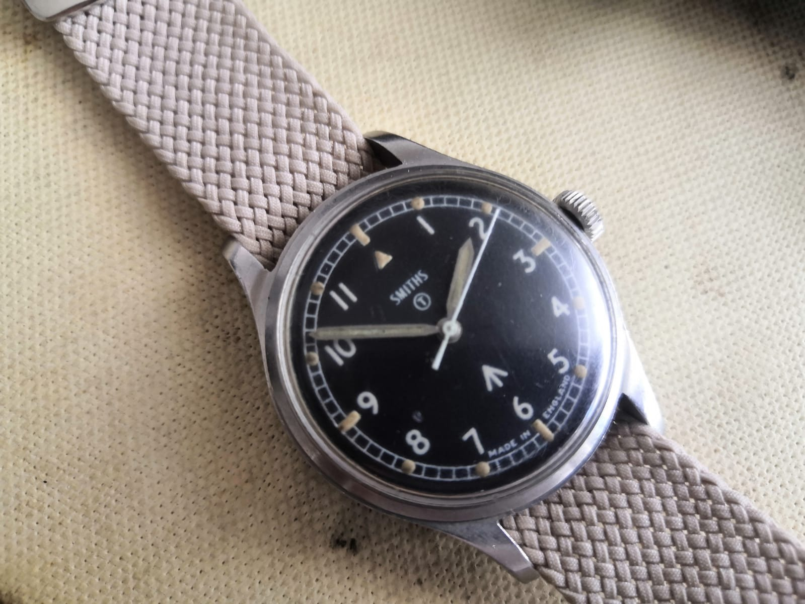

As promised here are the first pics for today, next up a quality crystal and I'm set! Dial is perfect but the crystal is hazy as heck dunno why.
A service has been scheduled...
781
1,340
57 on the movement indicates May 1967, which puts it in the first year of production, similar to the others seen I think. I am just a little jealous...lol. The crystal should just polish up easily as it's acrylic. Congrats again. You will need one of the upcoming 6b/2167 reproduction straps on it once they are in production.
