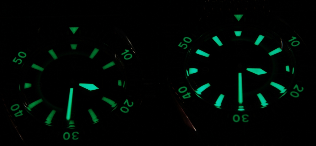

Question: Al it it true that the non date dial lume is SL C3? I have seen this said on various other forums and in some pics the modern service no date looks like it could be and in others it just looks white like my own date dial.
Here's one that looks greenish/ yellow that seems to match the bezel and hands. Copied from WatchCo images I hope I have not transgressed by posting it here.

I have only seen the green C3 on the no-date dials. The date dials I have seen with either C1 or C3. The date dials have the same part number no matter what the lume colour is, so it's a crap shoot when I order them in what version I will get - usually C1.

Just coming back to this and a couple of points of possible interest.
The first is that Cousins don't allow returns on this sort of part - it seems to be all watch parts so, be careful if using them. This was a bit of a surprise to me.
The second is that there is nothing wrong with the dial, just that it is a C1 dial and I didn't let it charge sufficiently. I had not realised these came in C1 but Al's post has clarified that for me. The one on the left is the C1. Unfortunately, with C3 hands it is very mismatched. Anyway, I am going to keep it (no choice!) and possibly put it on my SM as the lume matches these bezels rather well. I will need to relume some hands to match.... Really don't fancy trying that broad hour hand though so some practice is in order first.

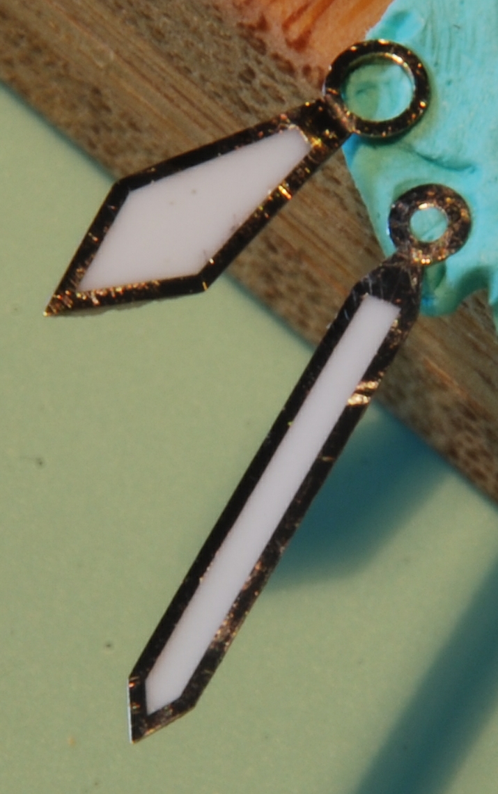

Hmm, that may be true! First attempt at re-luming with a Bergeon kit on an old set of hands. This is a pair from my SM300 build and I marked them so they are now my trial hands for everything. They are now very marked...
The lume is drying but the minute hand looks very nice. That big wide hour hand not so as it is very hard to fill so, I even have some along the edge and it seems to have a few porous areas. It has to go on thin so the hand is not too bulky. Will see how it dries.
Ah well, first try so, leave to dry, scrape off and try again.
Cheers, Chris

If you get the technique down, maybe I'll be sending hands to you! 😀
Ha, ha. I can see why you don't like doing it though, Al. Pretty tricky to sweep across in one go with the wide hand. I thought the narrow hand was not too bad but, it hasn't dried yet...

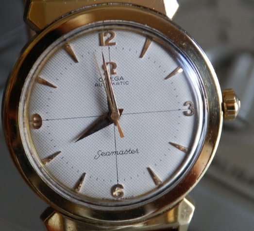

If I get it sorted so I'm comfortable, the first ones to do are on this 354 as it has been flaking off. Am not sure what colour this should be as it is currently black and crumbly! As it's a 1954/55 and it's not marked for Tritium, it may even be filled with Radium. Not nice if you breath it in.
Actually, looking at the dial there is no lume at all so, this may just have been a black filler in the hands? Let's see if @John R Smith has an opinion as he's my goto expert on the style of these old bumpers.

How did you scratch the hands so badly?
I mix my luminous with LOreal clear enamel nail polish. Thin enough to scoop up on a flat toothpick and run it along the bottom of the hands but only close enough to let the opening absorb the solution.
Any error. I always remove from the backside to avoid scratching the face of the hands
