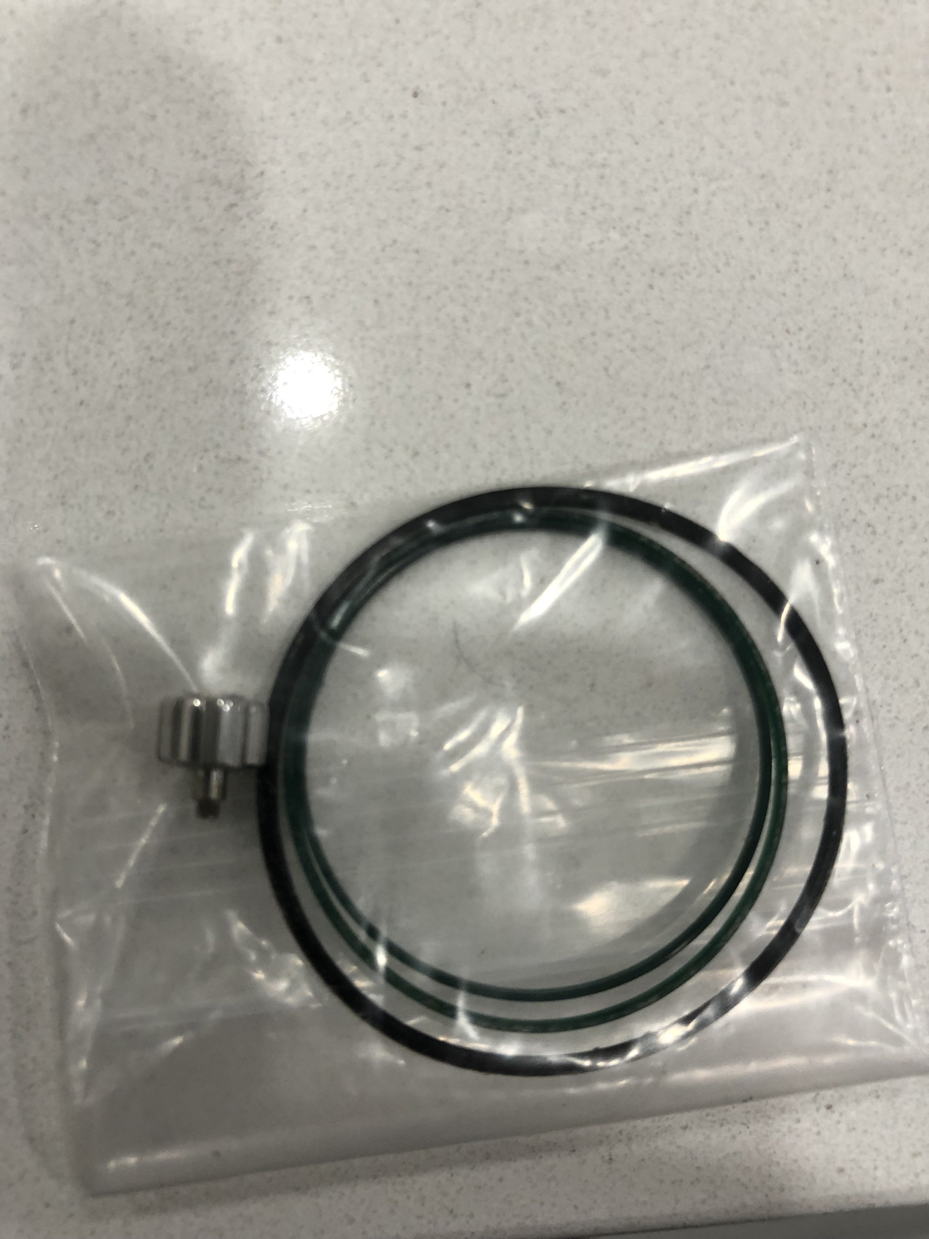

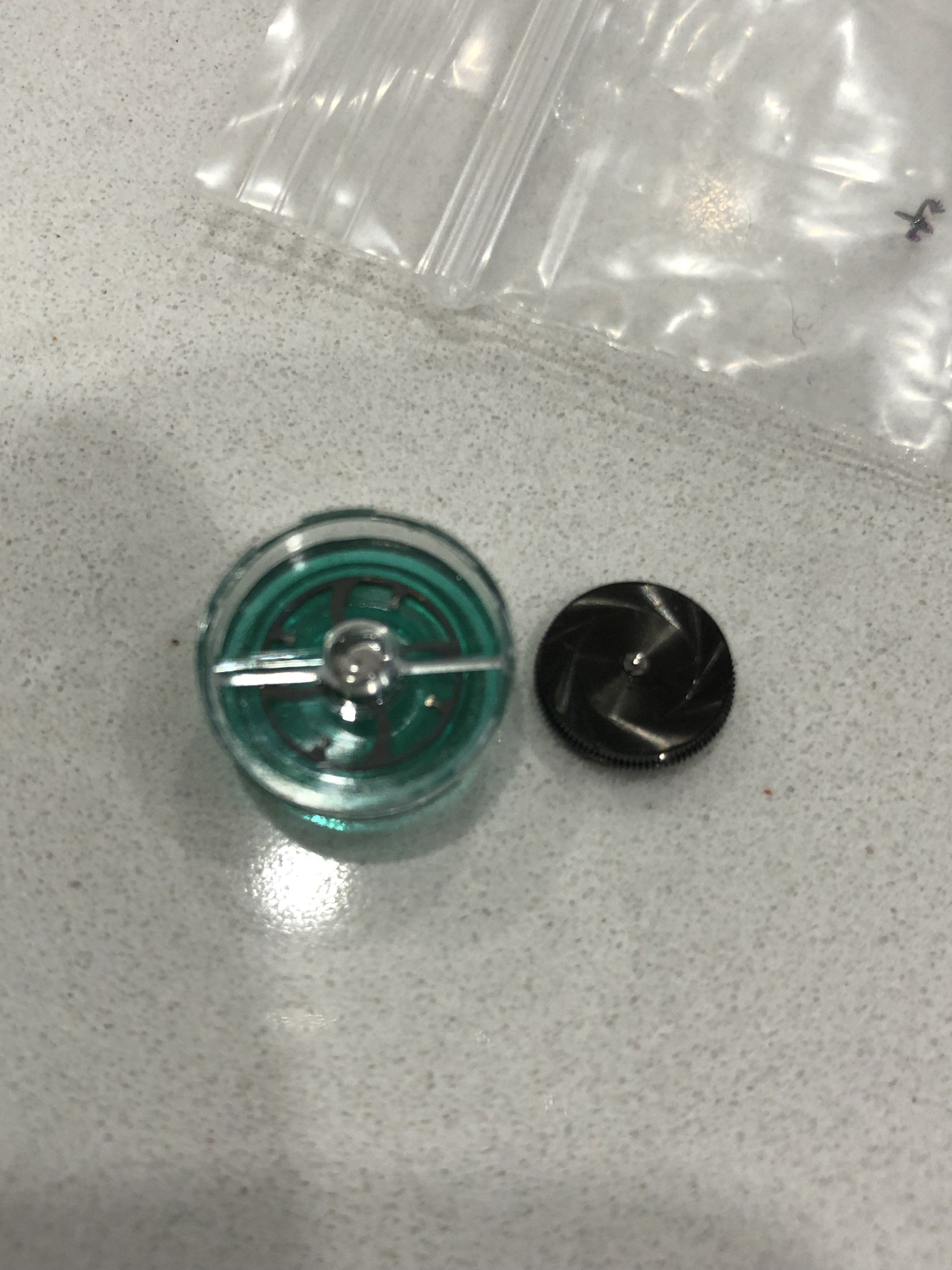

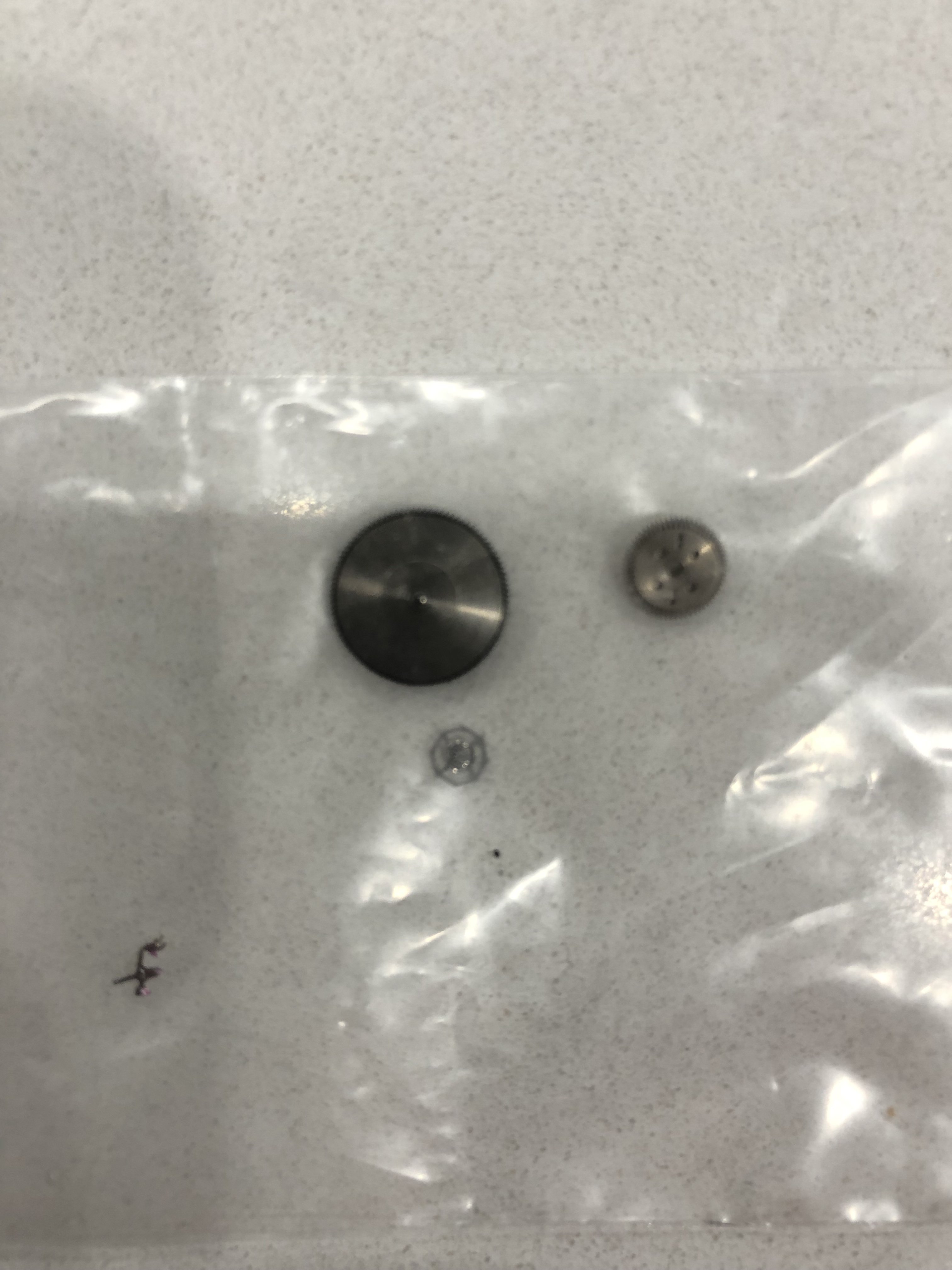

My PO (8500) is a bit over 5 years old and stopped working a few months ago. It has been with Swatch service for a couple of months waiting for parts to come in. I was really upset it stopped working and not happy to have to pay $700 for it to be fixed, but realized that it is a watch and the parts are small and precise, so I am actually ok with spending the money. I am not ok that it stopped working after 5 years.
I hope after the restore it lasts for more than another 5 years.

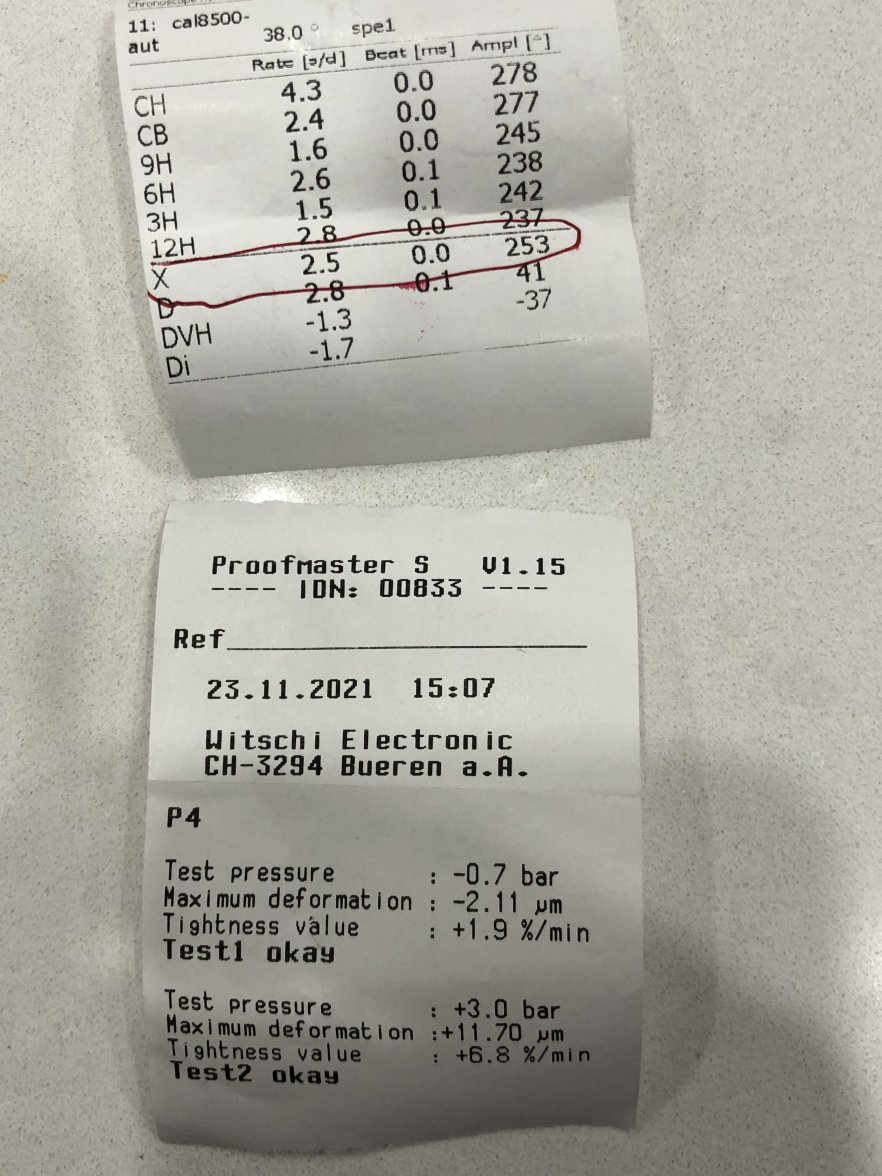

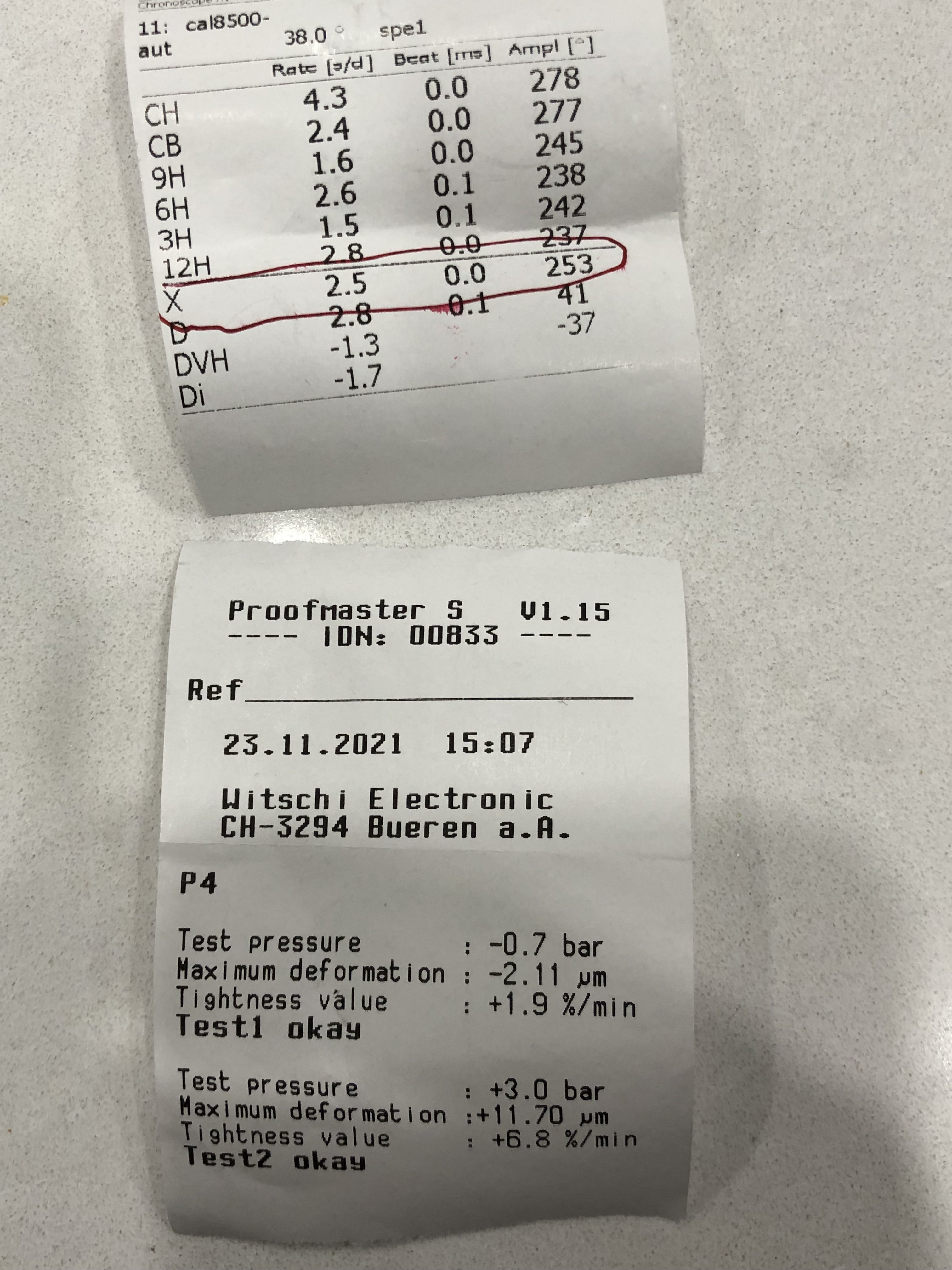

The watch is rated to 600m, and they tested it to just 30. The machine they used (same as mine) is capable of testing to 100m.

Thanks for the explanation. I have asked the service center why.
I would have expected more from them.

Hi @Archer, is that not good? I don鈥檛 understand the significance. 馃槙
Now you must limit your recreational diving to 30m/100ft 馃榾

Odd that the pressure test was done to only +3 bar...
Exactly my thought. I would not be happy with that. Maybe they are basically saying that they couldn't get the watch to pass a real pressure test.
I doubt that's the case, as all the sealing parts have been replaced. The other odd thing is that the service card doesn't indicate that a dive pressure test was done, and that would be mandatory fore this watch.
Deepest I鈥檝e gone with the watch is 60 feet, but still. Seems wrong to not put it back to factory specs. it is sad that I don鈥檛 know what that means from the paperwork they provide
