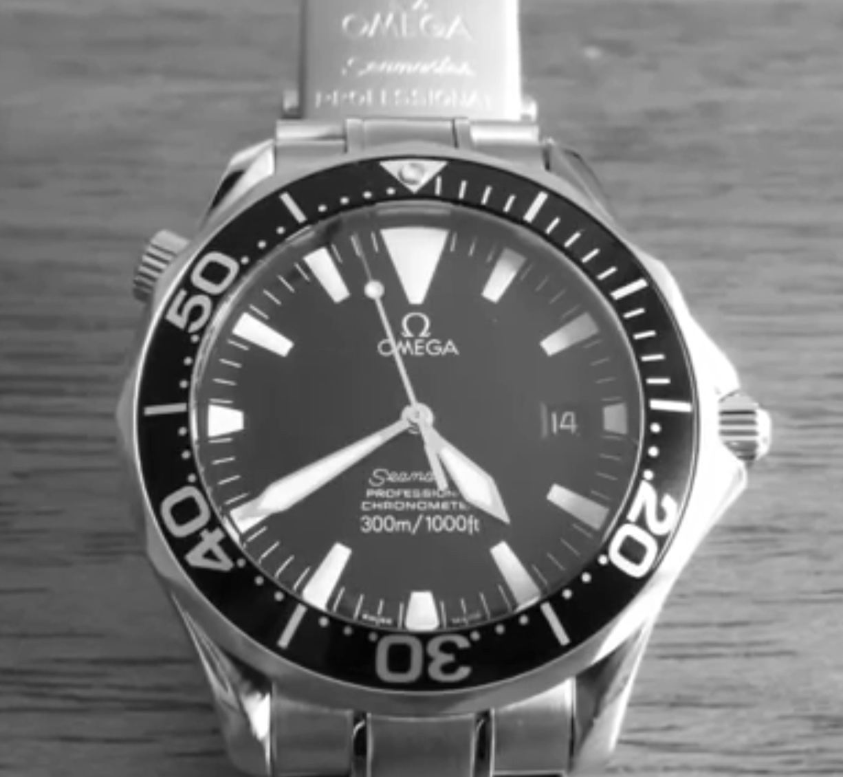

I have a Seamaster 300 that is coming up for its first service. I recall a post that recommended an independent watch store in the UK for service, but cant find the post. Also, many on here say get it serviced at Omega, but is this really necessary considering it probably needs a clean and lube only.
5,631
5,815
You don't know what it needs. Omega will replace parts that an independent might call "good enough", and if there is an engineering change, you will have the updated parts instealled.
Omega charges a flat rate for most of that, which includes refinishing the case and bracelet as appropriate.
For a new watch like yours, there really isn't a good reason for not going to Omega.

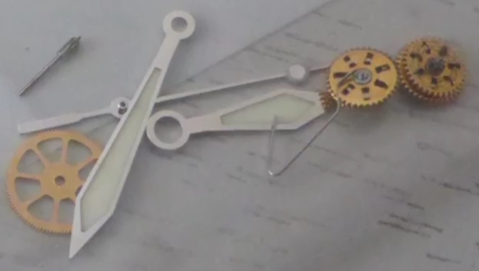

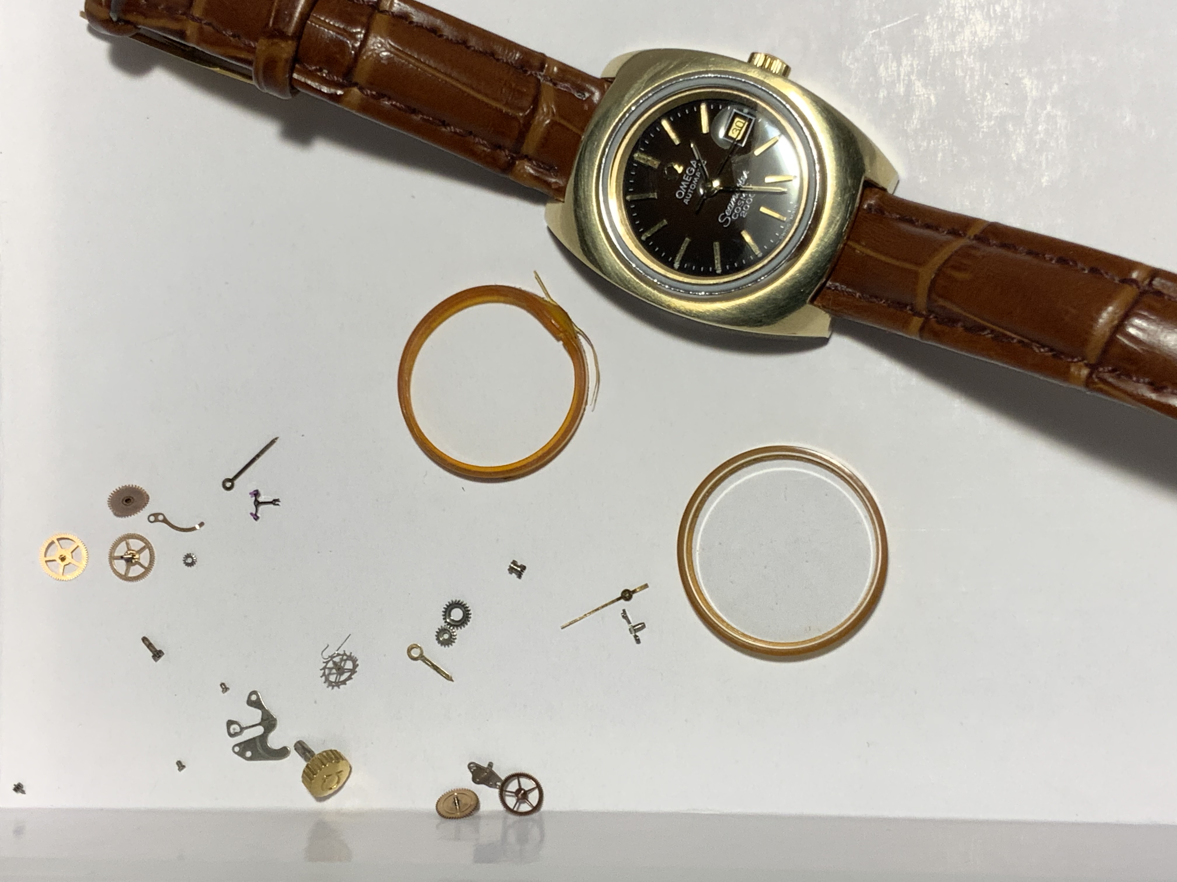

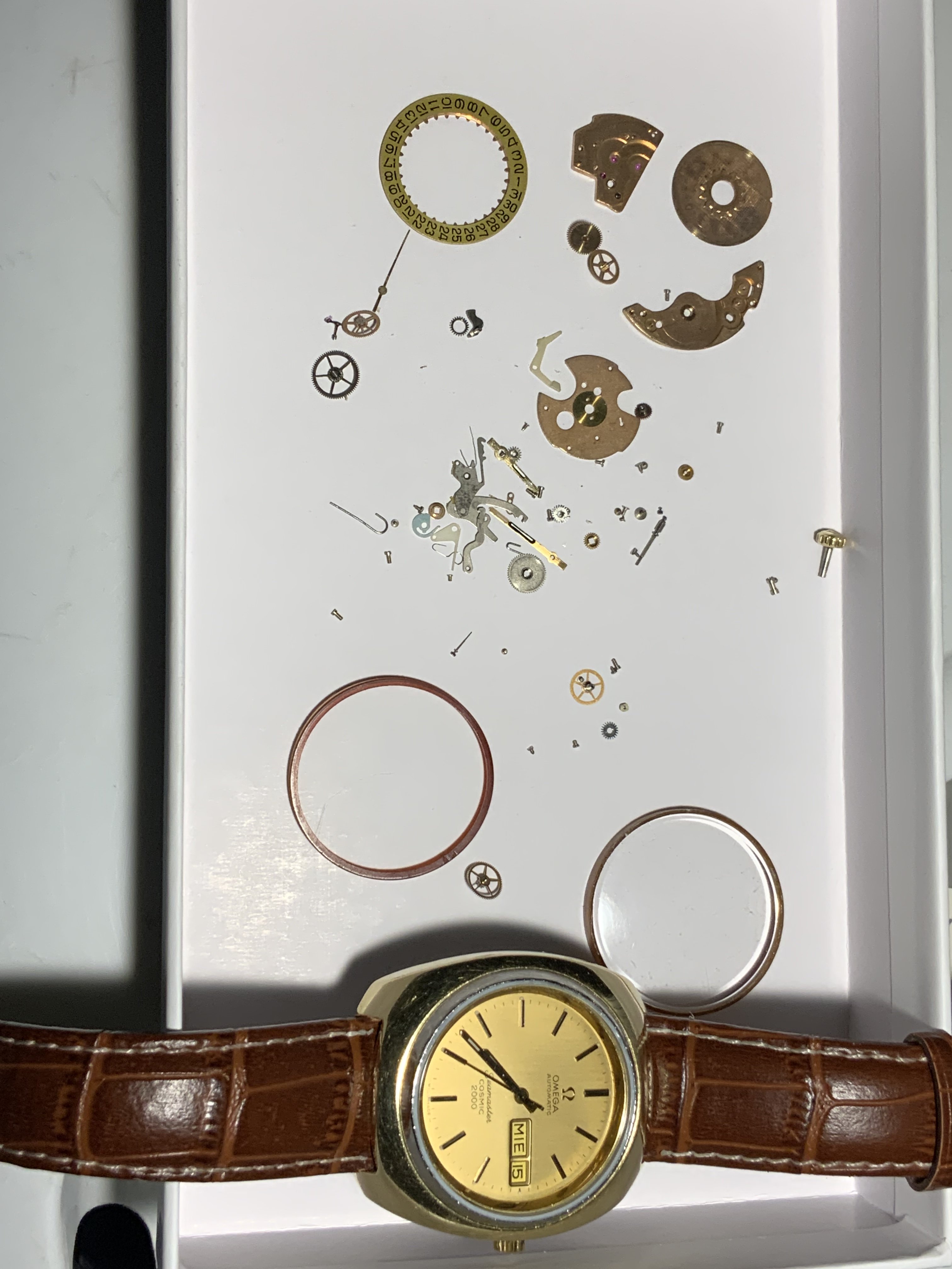

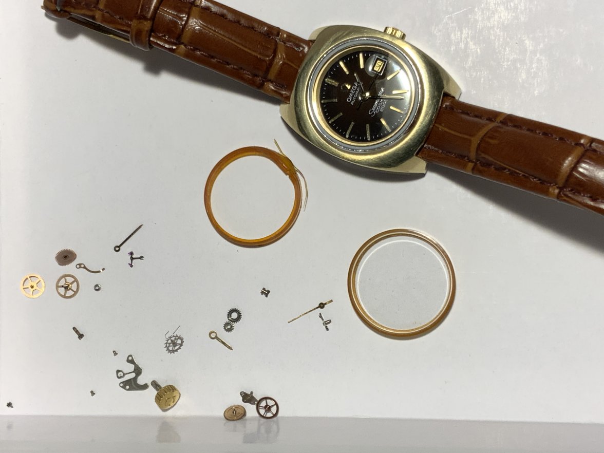

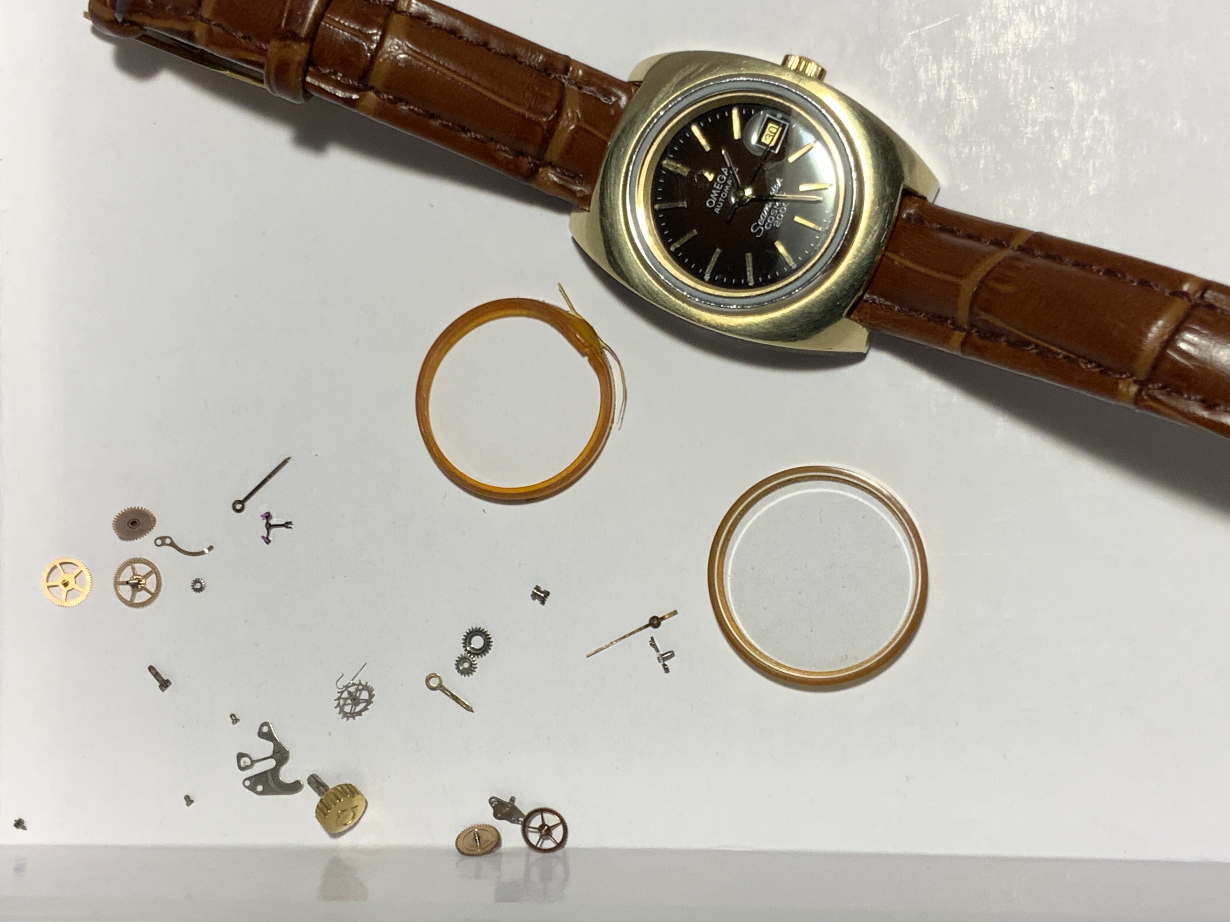

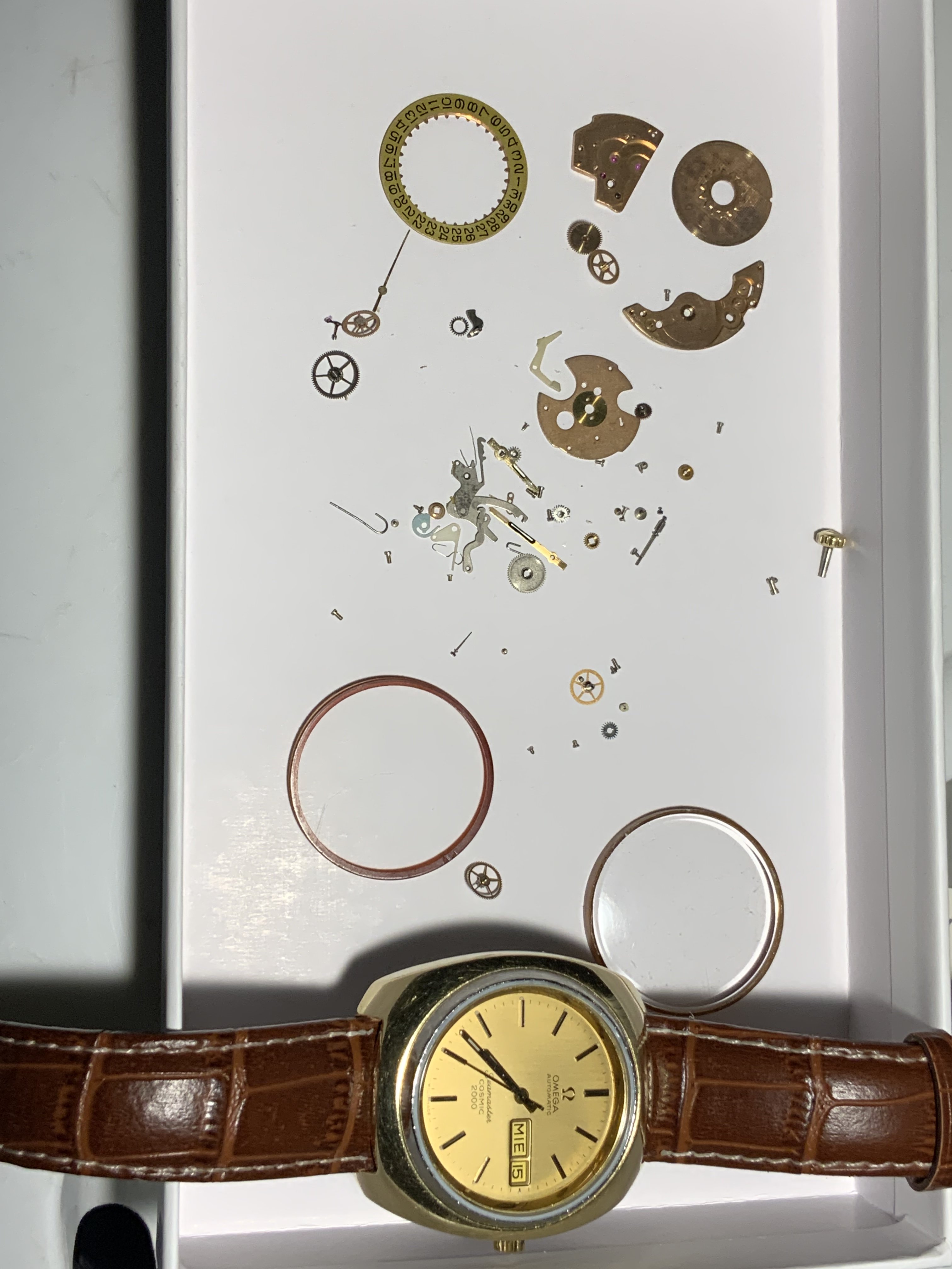

I would like to share my experience of two Seamaster Cosmic 2000 (weird, not so popular Banana casing) serviced (his and her sort of), sent to Switzerland via local OB. Here are the photos of components they replaced. I guess some of those parts are almost not available in US.
Costing service fee over a grand for each.
Those are kind of quasi-vintage pieces, not of the high price for sure.
So there is big question about value-for-the-money of Omega service.
But I would like those funky 70s watches back to life again to enjoy as practical, reliable, wearable ones for yeas to come, and happy to pay for that.
Having said that, my 145.022-71 is needing service and cannot decide yet where to send.
For that particular watch, Omega factory may or may not be a right place.

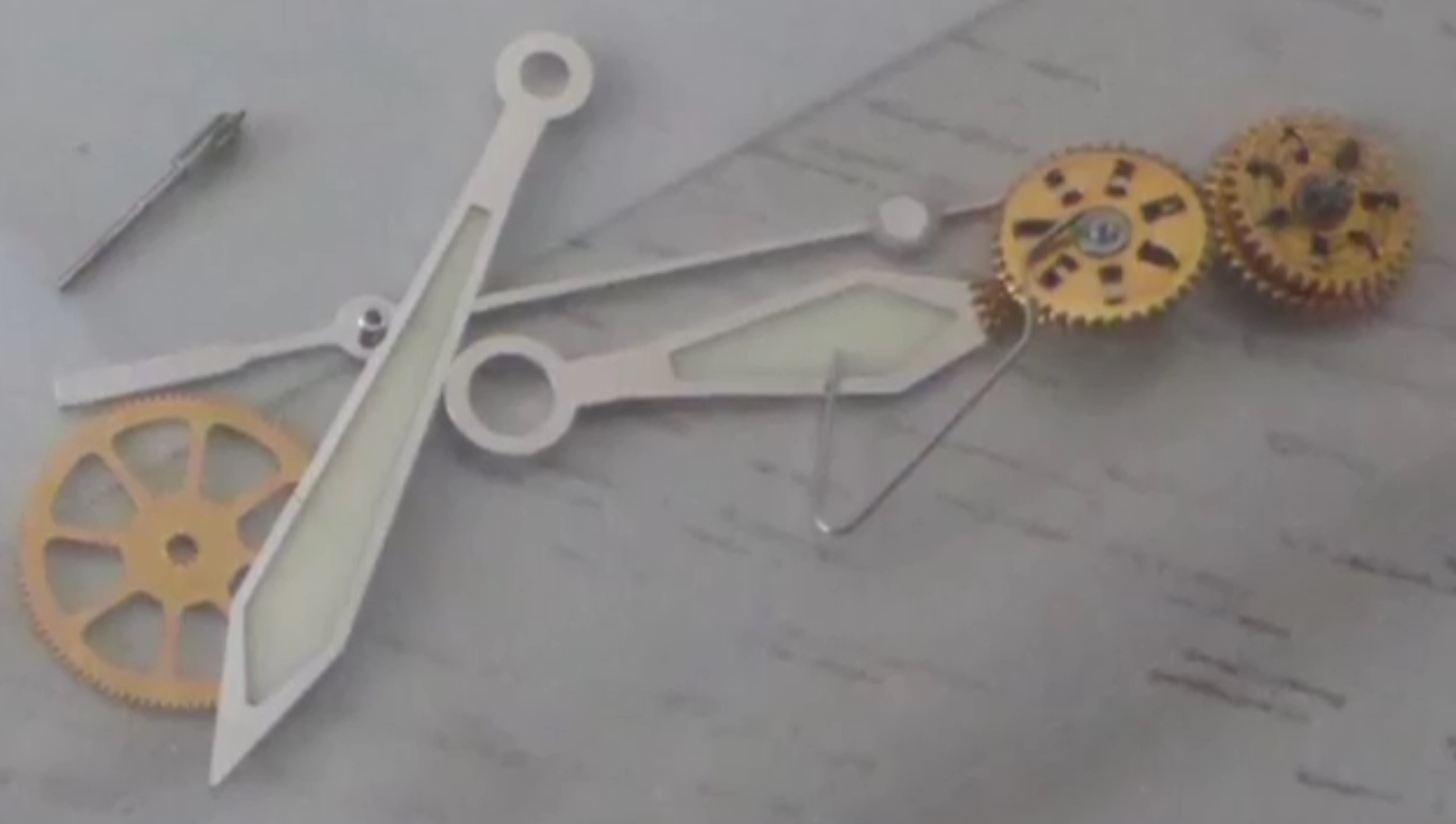

If your '71 Speedy still has a tritium dial and hands, and you want to keep the watch in its original condition, Omega is definitely not the place to have it serviced as the dial and hands will almost certainly be replaced with superluminova service parts.

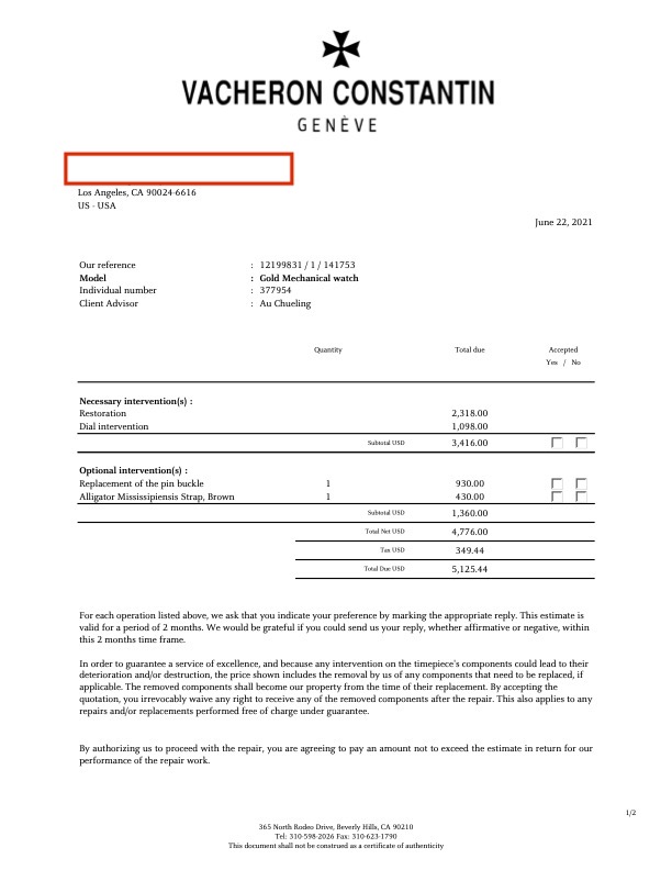

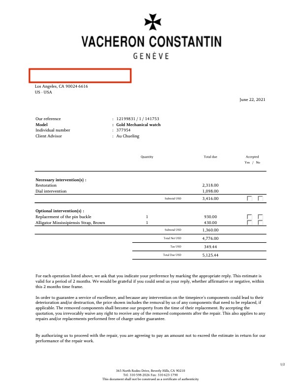

charges $950 CAD for a service.
vc charges me about 3.4k for a service for a time only vintage watch
i know it is a little different segment from omega but still somewhat close enough for comparison between those swiss entities range of servicing fees they are expecting

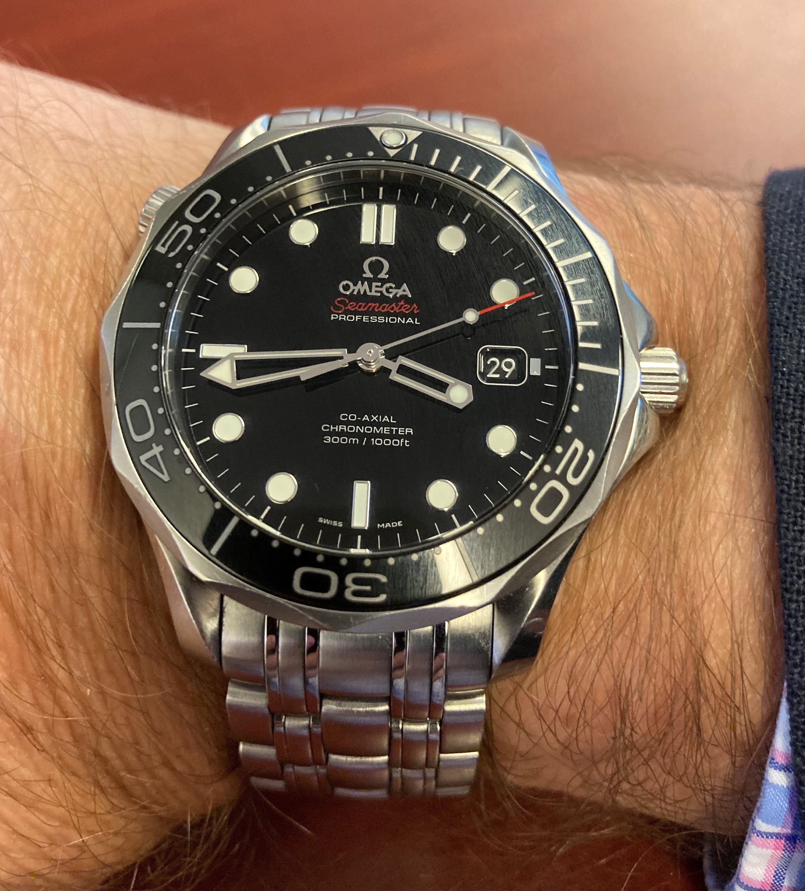

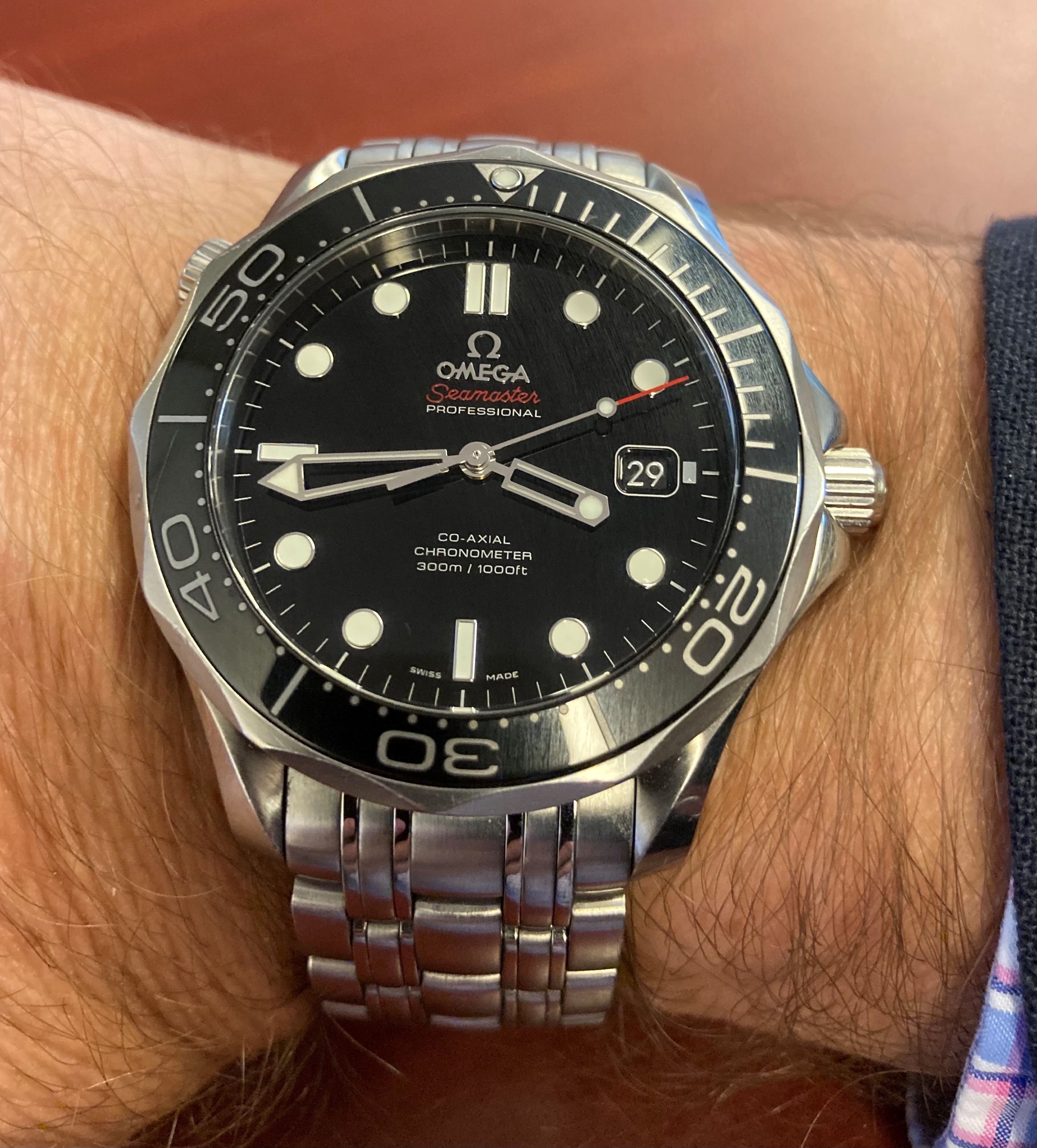

Great advice, but still smarts that my Omega store in Canada charges $950 CAD for a service. I can buy a nice watch for that
Not sure where you arrived at that price. Omega lists the price of a steel 3 hand watch at $680 Canadian on their web site. Even a steel chronograph is $930, so the watch you have shown won't cost anything close the $950 for a straight service.
All of the parts are still available to anyone anywhere in the world who has an Omega parts account...
$930 for a buckle. 😲
