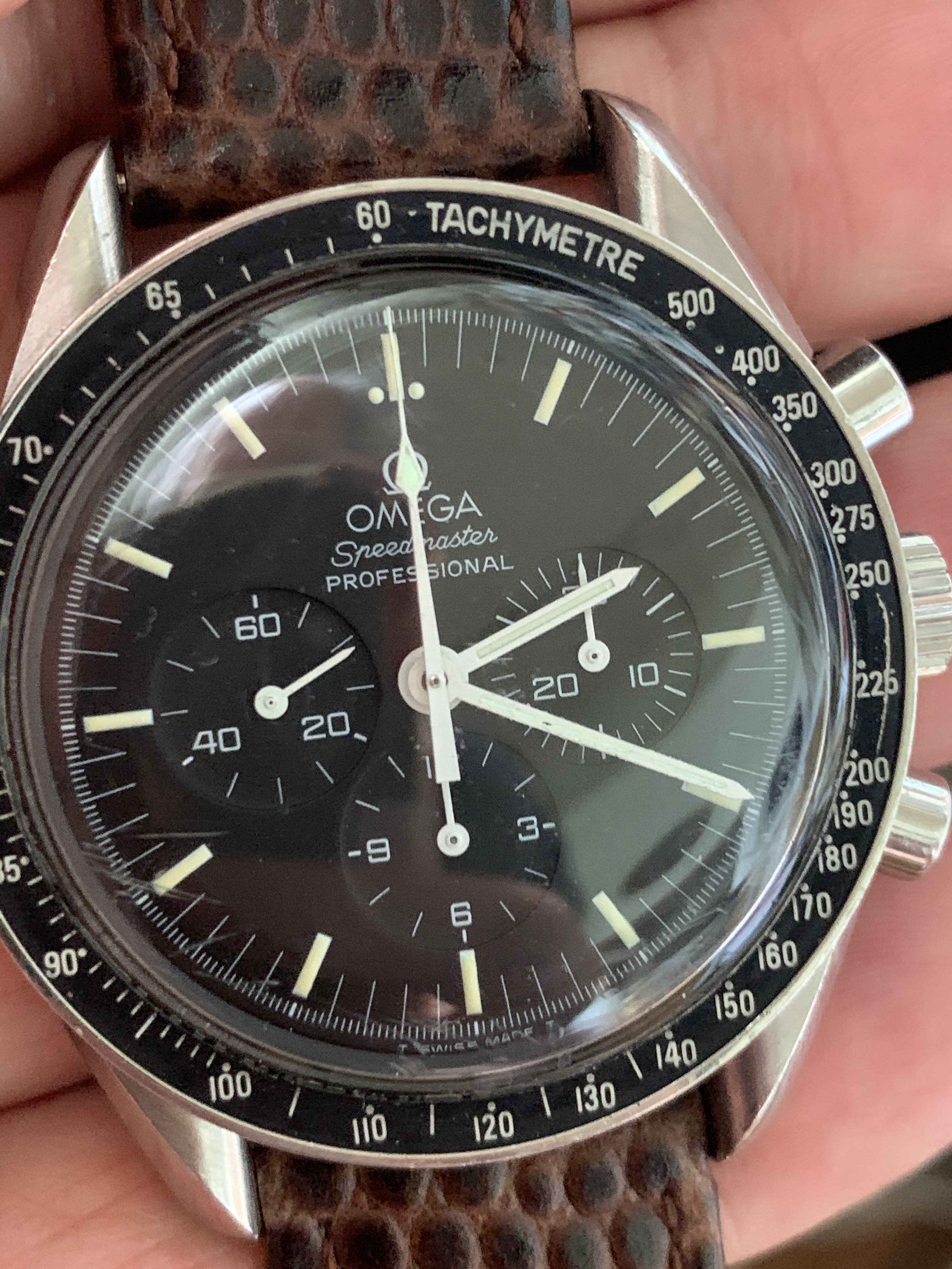

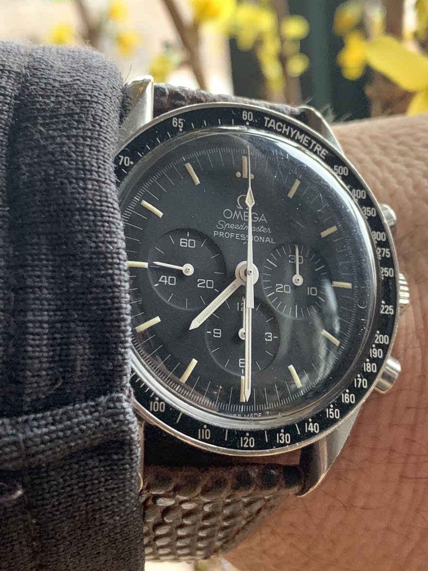

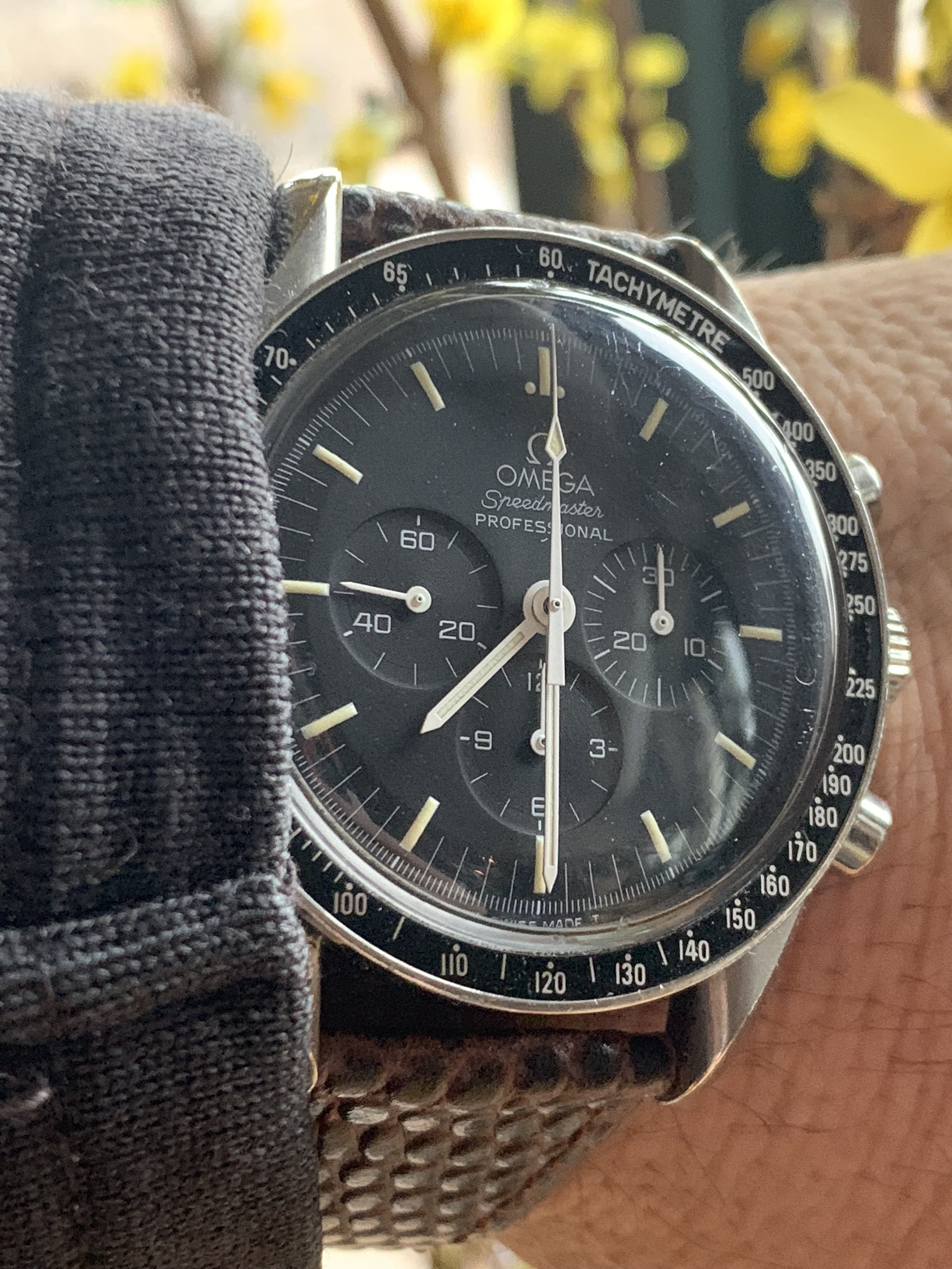

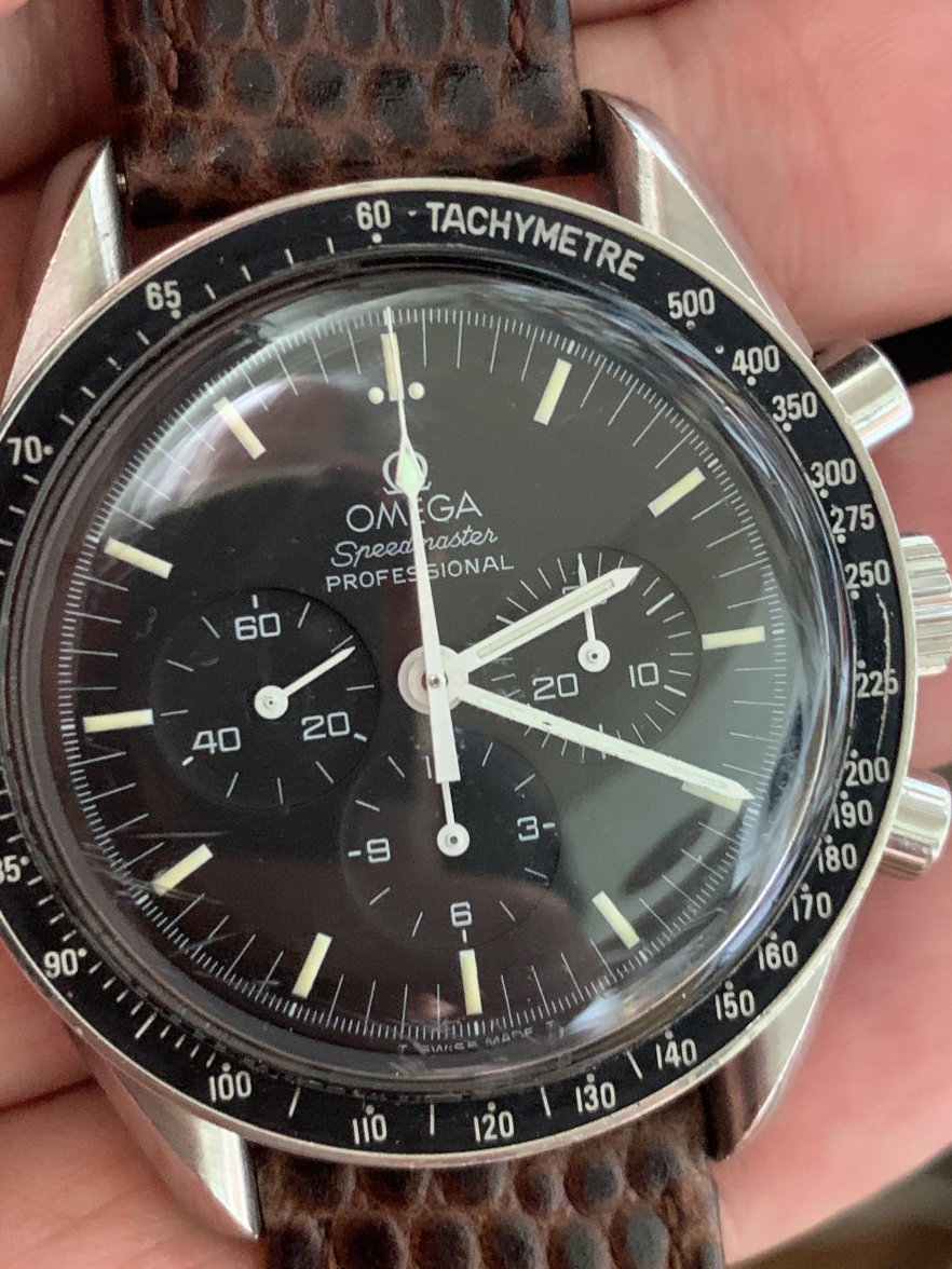

The watch came back to me with a different set of hands. It went in with a nice set of Tritium hands; came back with Superluminova that had been badly applied, especially to the minute hand. They had explicit instructions not to polish to attend to anything except the mechanicals.
Anyone else have this happen? What recourse might I have? They haven't responded to my email about it.
Here's the before pic:
Here's the after:

It's so badly applied too--smeared on the minute hand, and piled up high on the Chrono hand......

As you probably know, you have two options. Replace the hands with period-correct hands with intact tritium lume, or have these hands re-done with color-matched lume. The first would probably be preferable, but obviously more expensive.
