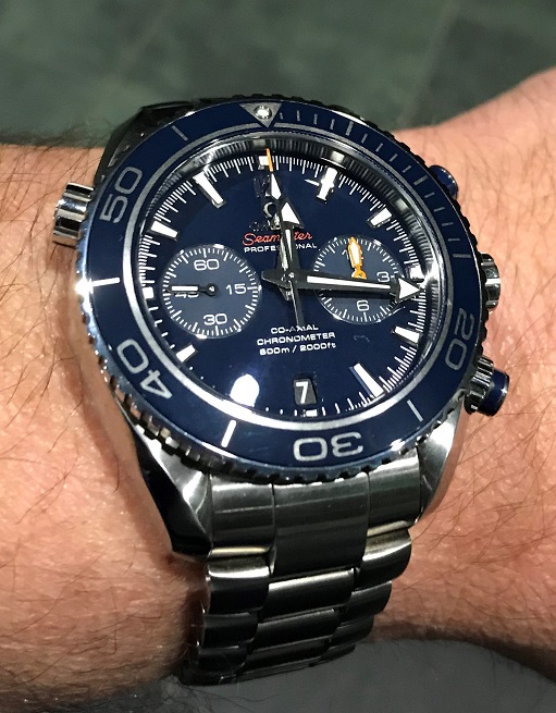

That's a Titanium SMPO, made from Grade 5 Titanium.
I just checked and Grade 5 has no nickel, only Aluminum, Vanadium, no more than a quarter percent iron and two tenths of a percent of oxygen.
