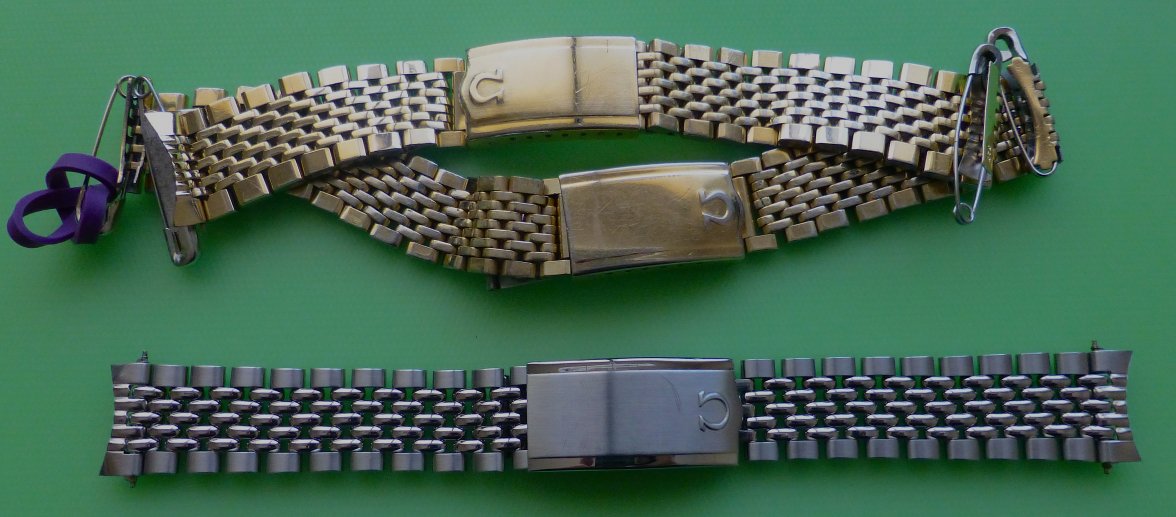

That band has the more oval end peices of the late 50's early 60's. For a dog leg Connie you want the more squared off bor bracelet of the late 60's.

I'm not talking about how many rows, just the outer row, you want the more squared ones not the oval ones.

okay i understand , the one i put in photo was too round to fit properly

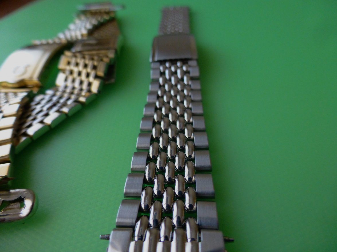

Beads of Rice (or BOR), more correctly, Grains of Rice (GOR) Ω bracelet.
So called because the elements that make up the inner part of a link look like grains of rice. More evident in the second picture.

See in this picture, the top two have the later more squared outer row and the bottom has the oval early style rows.
