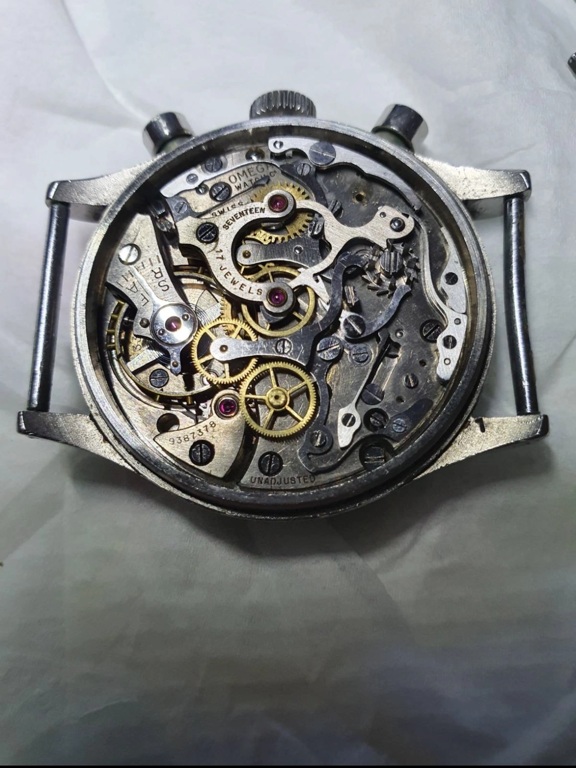

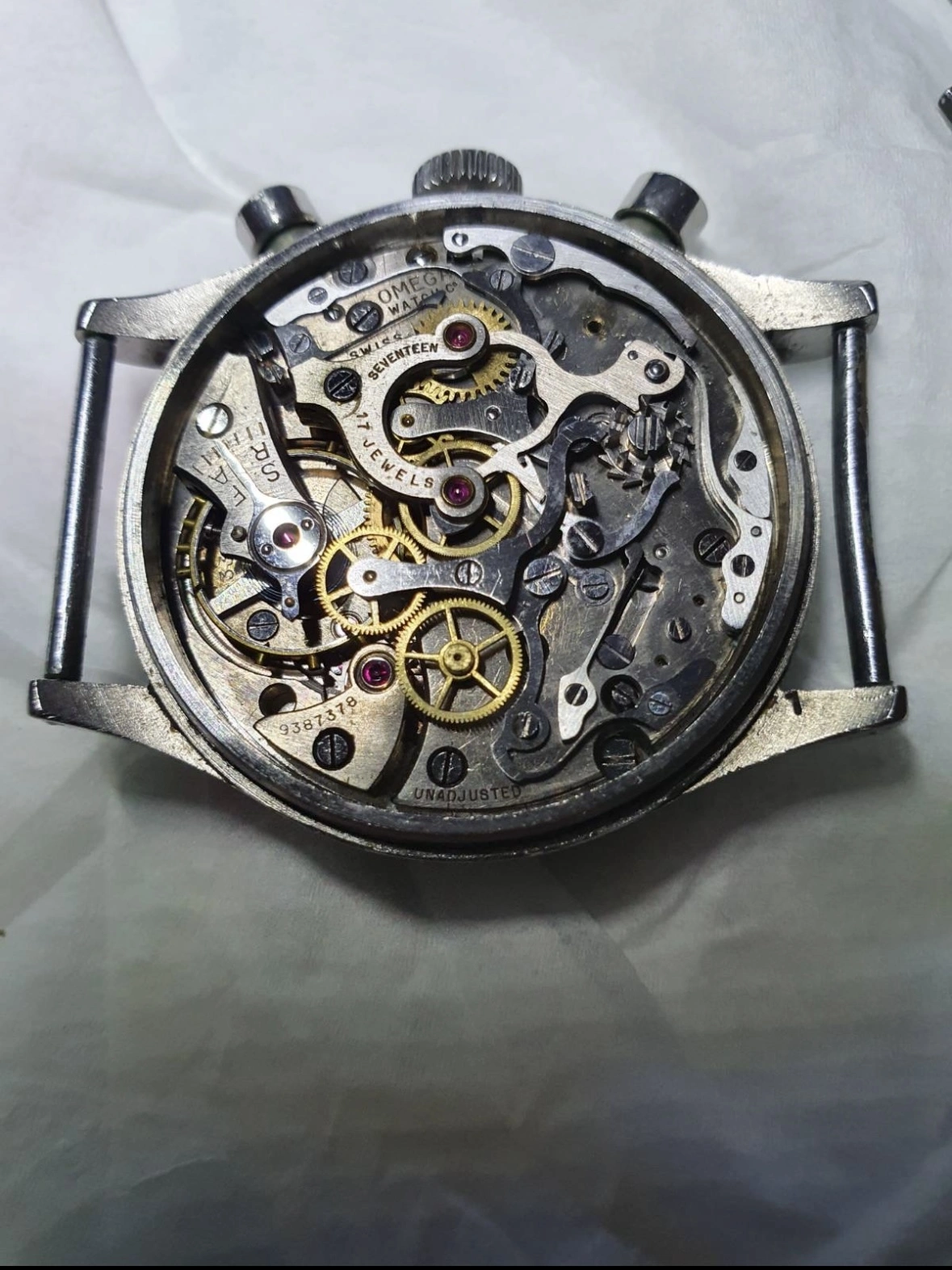

im curious what chronograph part/s was unable to be sourced?
160
435
That’s a question I have. A number of 33.3 collectors on here have had success sourcing so I am optimistic ( albeit their knowledge base is high). However once I know what exact part is required I can be resourceful and figure it out. I do know it is not the crown wheel and core. Both present on the watch and correct.
Based on this picture of the movement, AI has the following to say… let’s see how right it is!
🔍 Key Observations from Your Image:
  1. The chronograph heart cam is missing:
    • The central chronograph seconds wheel is present, but I can’t see the heart-shaped cam that allows the reset hammer to push the hand back to zero.
    • This would explain why the chronograph doesn’t reset properly - the reset hammer has nothing to act against.
  2. The minute recorder jumper/spring looks absent or displaced:
    • The minute recorder mechanism (which counts minutes when the chrono runs) may be missing its tensioning spring or jumper.
    • This would prevent the minute subdial from advancing correctly even if the seconds hand worked.
  3. The operating lever and/or intermediate clutch may be missing or misaligned:
    • The key levers that control start/stop/reset aren’t all clearly visible. It’s possible one or more are missing or installed incorrectly.
    • Specifically, the horizontal clutch or intermediate wheel connecting the chronograph to the train might not be in place - preventing transmission of movement to the chrono hand.
  4. The column wheel is present:
    • That’s good - it’s the tall, gear-like component just to the upper right of the center. This part governs the coordination of chrono functions via levers.
    • It appears intact, but we’d want to ensure it rotates when the pusher is pressed.
🛠️ What to Do Next:
  1. Get a parts diagram for the Omega Cal. 33.3 / Lemania 15CH
    These diagrams help identify each individual part, and compare to your movement.
  2. Get the movement to a chronograph specialist
    A true vintage chronograph restorer can:
    • Confirm exactly what’s missing
    • Possibly fabricate or source rare parts from donor movements
    • Properly align and test the entire column wheel and hammer system
  3. Source a donor movement (Lemania 15CH or 15TL)
    These are mechanically similar and were used in other brands too - they can sometimes be found more affordably than Omega-marked version.
3,653
7,770
🛠️ What to Do Next:

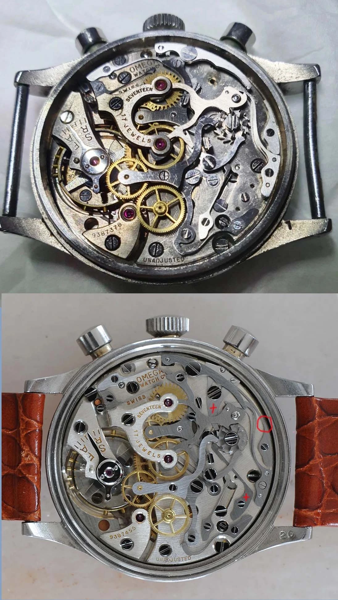

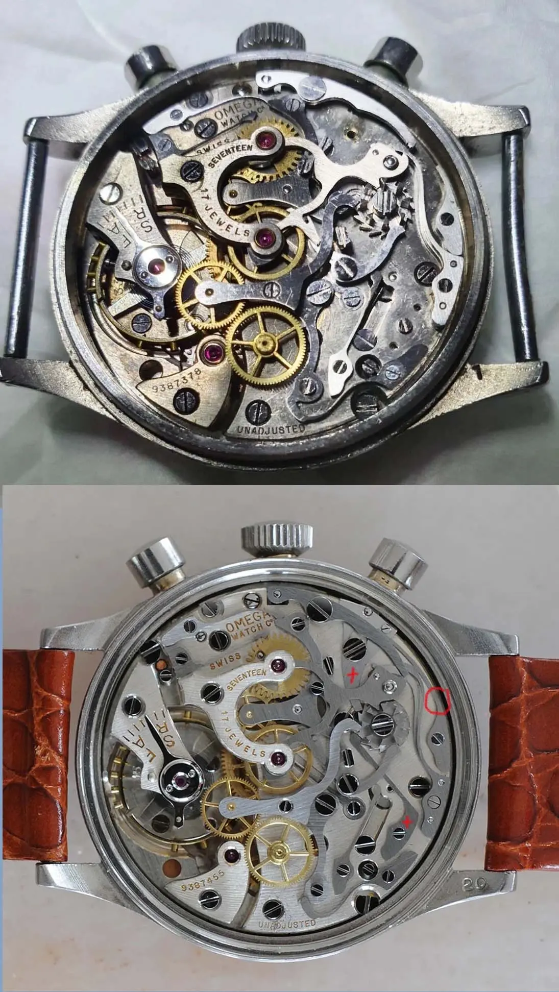

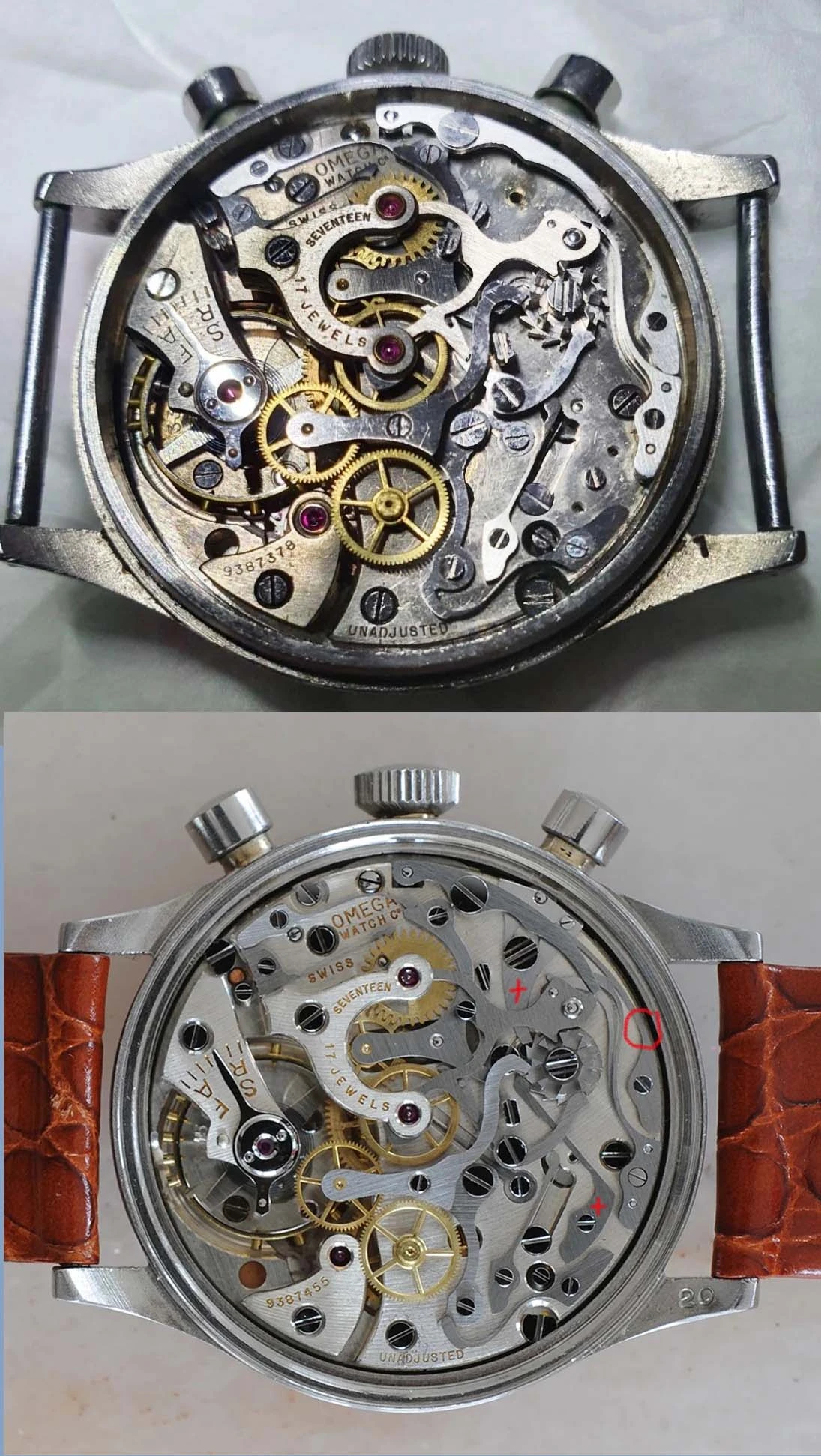

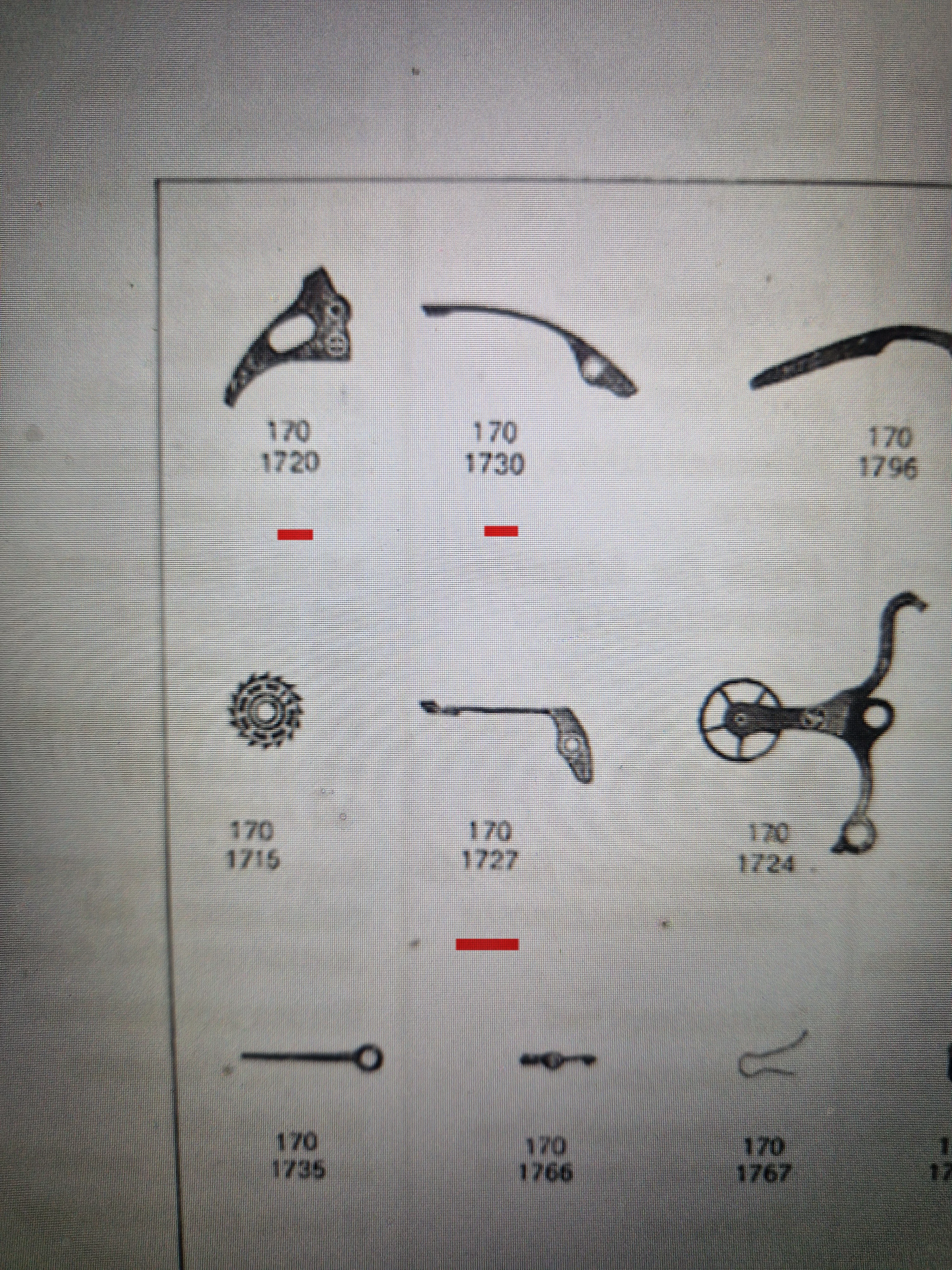

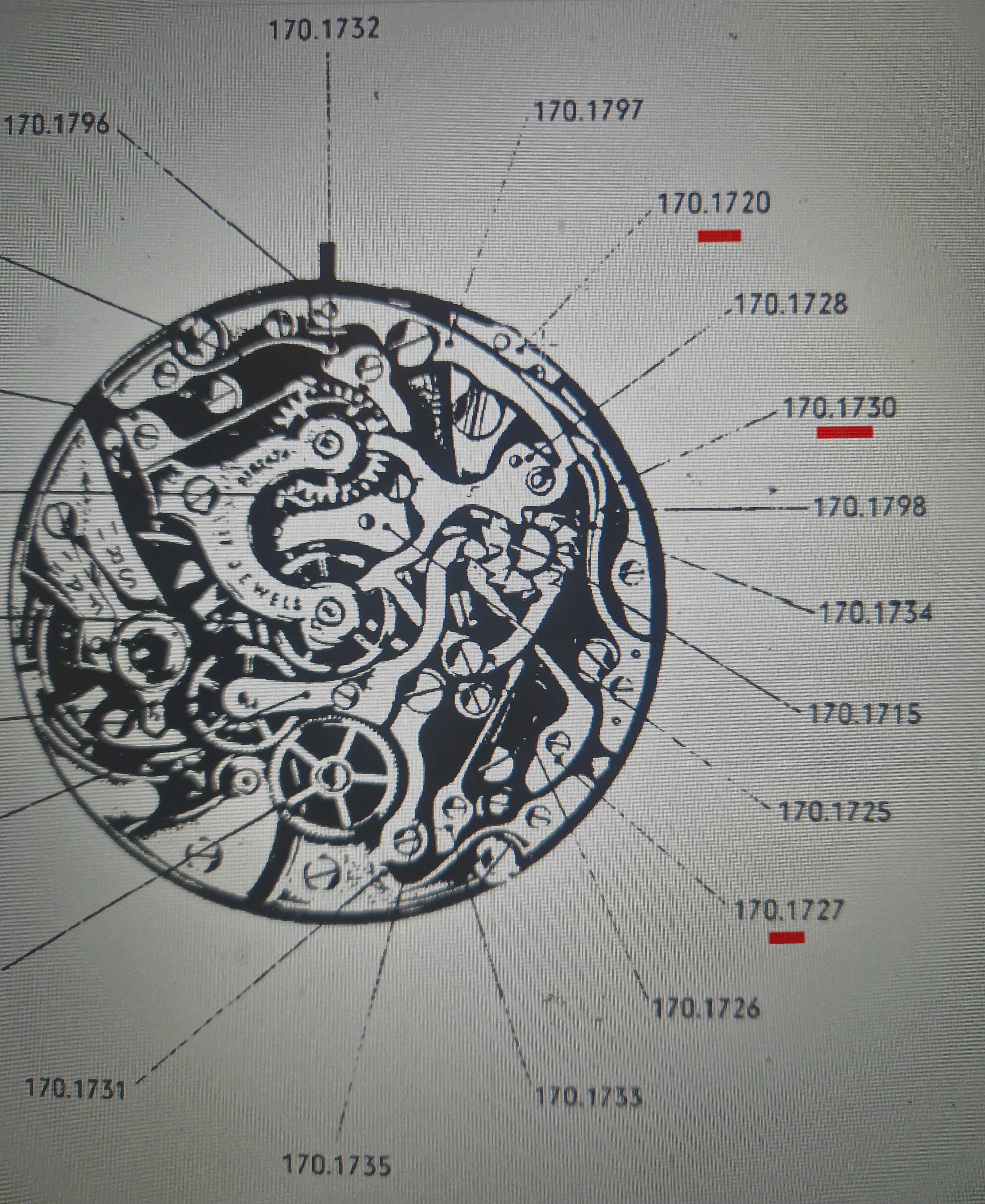

Its not that much missing:
the heart-shaped cam is not missing, its present!
I have photoshopped your photo a bit to make it better visible.
Here is the comparison with a well preserved and original movement - I have marked the missing parts with a "+" in red and the broken spring with a red circle. So you most probably will only need these 3 parts. But when working on the movement your watchmaker may find some more parts which need to be replaced due to wear or damage...

Ai a little way to go then! Thank you!

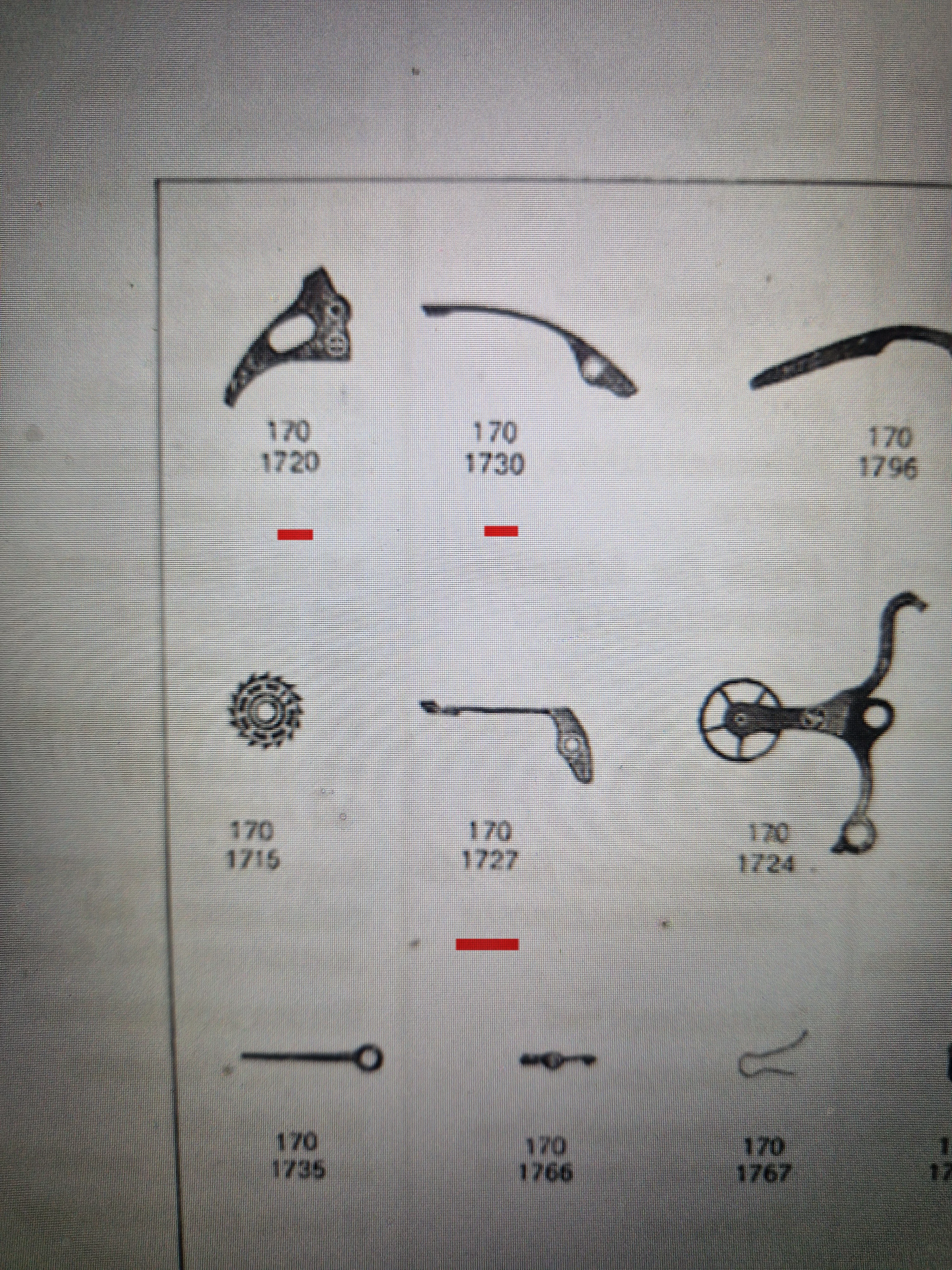

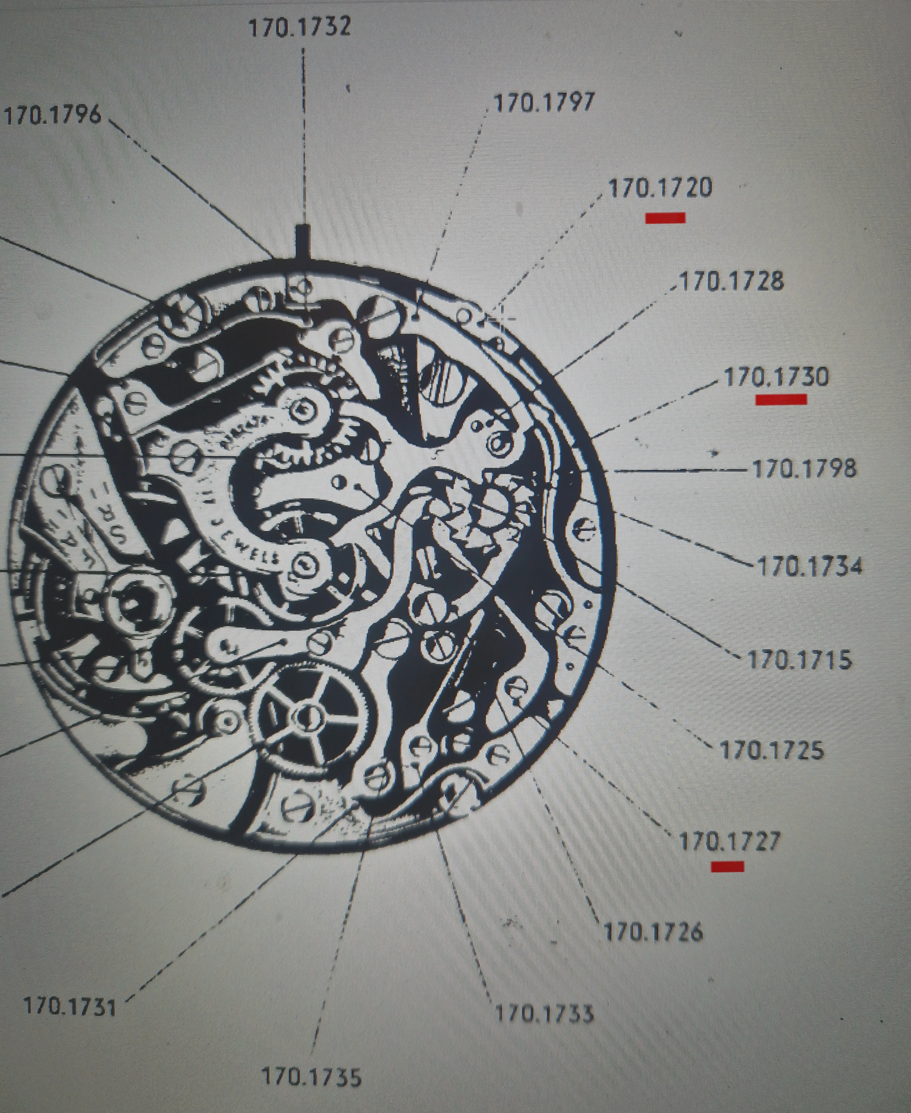

Based on @mac_omega s identifications looks like these parts:
170.1720 operating lever, mounted
170.1727 pillar wheel jumper
170.1737 operating lever, spring

Thank you once again both! We were here about 3 years ago! Crazy how the time flies. It is most appreciated. I’m off to a watch specialist on Thursday - 🤞
